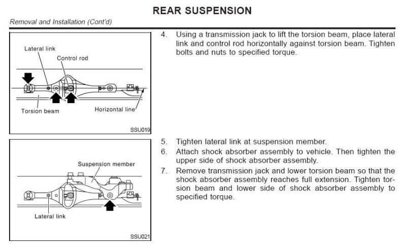

This is where there is a void in my understanding. The FSM says to raise the beam until the control rod and lateral link are on the same horizontal plane as the beam. But will they still line up properly if I have a lower than stock drop? Isn't that "calibrated" for stock ride height? Or will this leveling still be possible because you've loosened all connections for the components to reposition, thus the term "recentering" the beam? I'm under the understanding that there is only ONE way these components will be on the same plane, and that is at stock ride height.
Here's the diagram for reference.
Sorry if this will be obvious when I actually do it. But in the meantime, I'm sure others might benefit from this discussion.

My understanding (and this is where I need to be corrected) is that you are essentially raising the beam to where it should sit relative to the lower-than-stock suspension components and then resecuring the lateral link at that point in order to unbind the bushings and level the suspension components. Originally Posted by Larrio
You have to re-center the rear beam. Basically due to the linkage on the rear beam, our solid axle pivots upwards and to the right side under compression.Now the bushings and such were designed for a car at stock ride height. When you lower the car, you start to deform and constrict the bushings since the suspension angle is changing in relation to the chassis. In the FSM you will find segments on how to re-align the beam. Take a peak next time when the car is on a flat surface and you will see the bushings are bent sideways
On a less technical note, any suggestions on good, precise ways to measure the ride height? I was thinking after I pull the wheels off, I'd just measure the distance from fender to hub or something.

I did the recentering procedure today and was able to get the lateral link to be on the same plane as the beam, the control rod however, with my drop at least, went to the angle / once I had raised the beam to my measured ride height. This was what I was initially concerned about. From what I can tell, it is not physically possible to get the control rod to line up with the lateral link and beam AND maintain my current ride height.
For procedural notes, I put the car on stands took the wheels off, loosened all the appropriate nuts, raised the beam using two jacks on either side (because I didn't want to remove my RSB), measured both sides, and tightened everything back.
I haven't driven it yet, but I'll post again later if there are any differences.
Okay, this may be a worthless opinion but I went out for a quick spin and maybe it's the placebo effect, but the ride quality definitely seems to be better in the rear in terms of absorbing bumps and it actually feels like it is turning flatter.
The driver side tuck has not gone away (I measured to be doubly sure and it's about 3/8 to half an inch further in than the passenger side) but like I said, it doesn't bother me that much, so no, I will not use different sized spacers to make both wheels flush.
