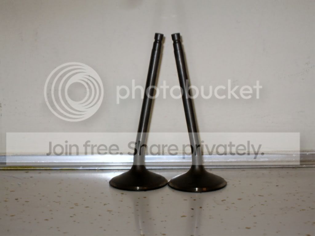

I just removed the two valves. Looks like I did have a couple of bent valves.
Should I simply replace the two valves or should I get new guides as well?

Nicely bent, there.
I'd get new guides just to be on the safe side, I've seen guides somehow catch a valvestem and bind it, keeping it from going all the way up or down, and it's possible that in the short time you've been running with those two bent valves (or not so short time, whatever), they may've ****ed up the guides.
In any case, like I said, better to do it now than have to pull off the valvetrain and head to replace the guide at a later point.

yeah, replace them, the valves being bent like that may have messud up the guides
