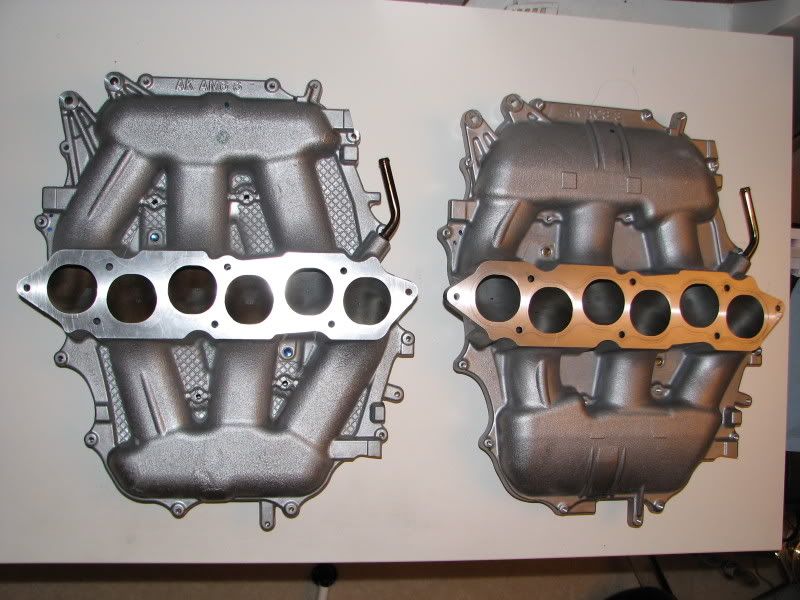

Old Aug 11, 2007 | 09:39 AM
Puppetmaster's Avatar
iTrader: (48)
Posts: 16,551
From: Fairfax, VA
Even though you've already established what the OP has, this is just for reference so that people can see the difference in designs...
Non Rev Up lower collector is left, Rev Up collector is right:
