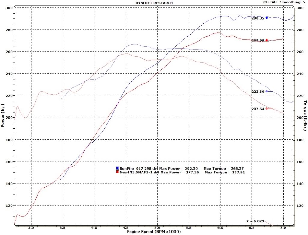

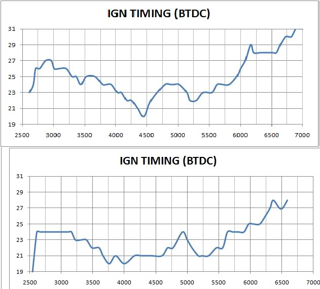

Back when I first put the 3" MAF in, (not even the 3.5") I had to add 27-30% correction for the car to even be drivable, and even then, it wouldn't drive right at all, only at certain moments, regardless of the AFR.
Then SR hinted me to try the IN/OUT setting, and after I did that, it was fine and has been ever since. On the Altimas forum that a member with a SAFCII changed the settings, and was able to run problem free with the 440's and 4" MAF.

Yes, strange, but it is is what it is.
My timing curve is the same when using 1:1 and 0% corrections and a 2.75" MAF. It (timing curve) doesn’t change when using 1:17, and a 3.5” MAF with 0 % correction.

Long story short,
WRT timing/dyno:
Best situation: 3” MAF, 335’s, 1:17, and -8 – 10% = 13.5 AFR /optimal timing
Worst situation: 3.5” MAF, 335’s, 1:17, and 0%. = 13.5 AFR / not optimal timing
Theoretical best situation: 4” MAF, 440’s, 1:17 and -8-10% = 13.5AFR w/ the correction pct's, should be optimal timing.
Reason: It is identical (injectors to MAF size) to the “Best” situation above.
Looks as if you mistook what I said earlier in that this new set-up is the equivalent as my 3.0” set-up, not the 3.5” set-up, which if this new set-up was the same as the 3.5” set-up (WRT inj/MAF), then yes, I’d just be futile.
