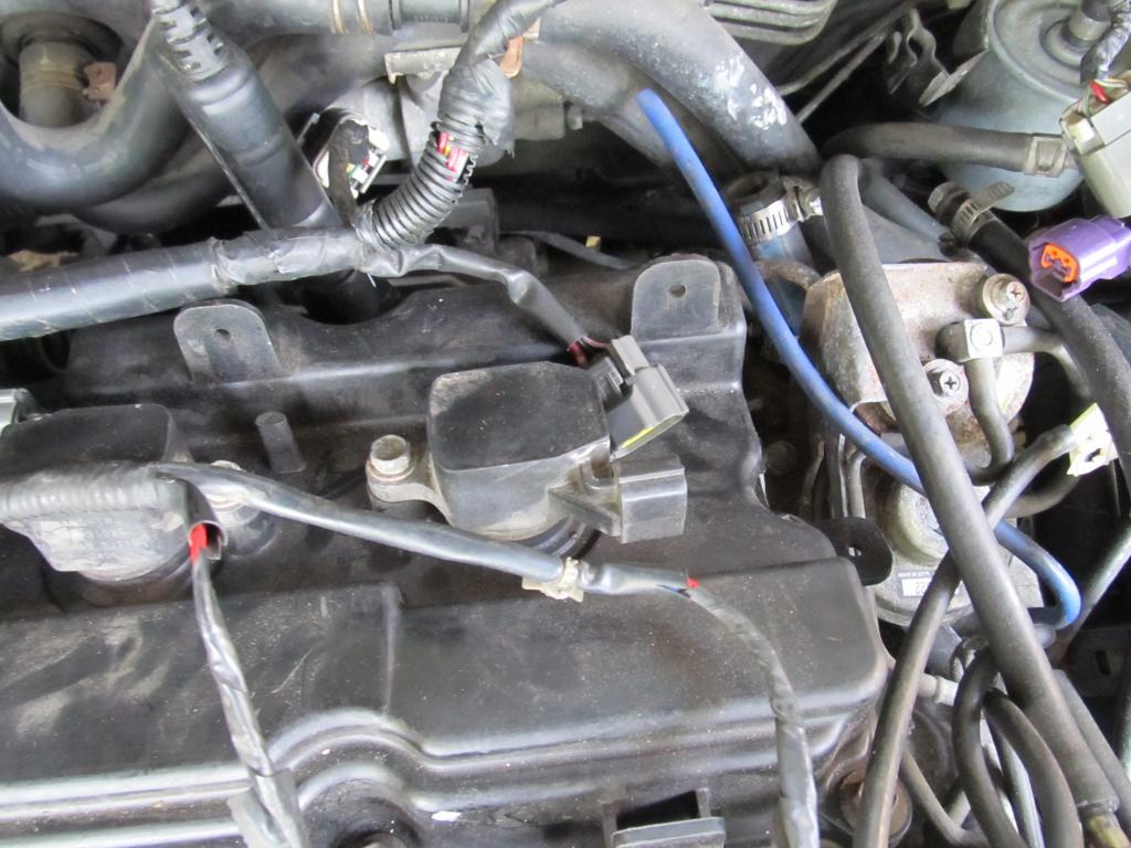

We tested power to the fuel pump. It would get 12v for a split second (not enough time to power up the pump) then the voltage would drop to zero. However, it would only get that split second of power while the connector was unplugged. When it was plugged in, it didn't get any power.
When we hard wired it, we had the MM hooked up to the ground wire, and again, it would get power for a split second then drop off. So there was no change in power when we hard wired it.
We checked it again for spark with a new tool and again, no spark.
A few people have heard a ticking sound coming from the front cam area when we try to crank the motor. This motor was pulled from a car that was t-boned and totaled, but it ran before it was pulled from the car. Is this something I should be worried about, or is that a "normal" noise for a motor that hasn't ran in a few years? Possibly a lifter that doesn't have oil? We put some oil down in the cylinders before trying to crank anything.

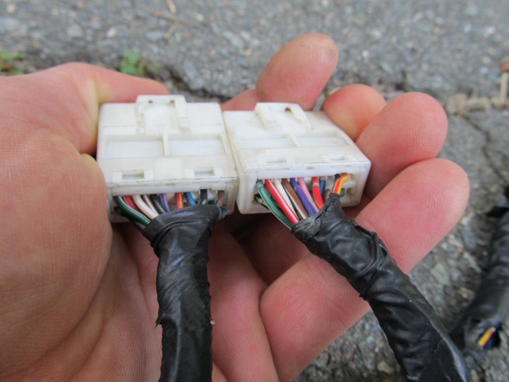

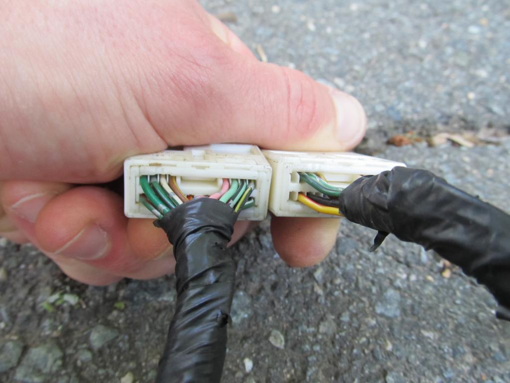

I think I found the problem! On a tip I decided to check the two smaller interior wiring harness clips and found the wires were in different location between my original Infiniti harness and both of the Maxima harnesses!

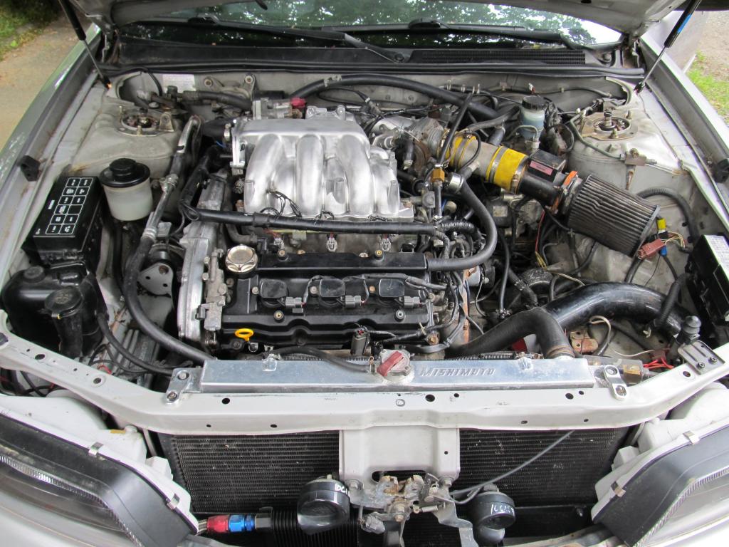

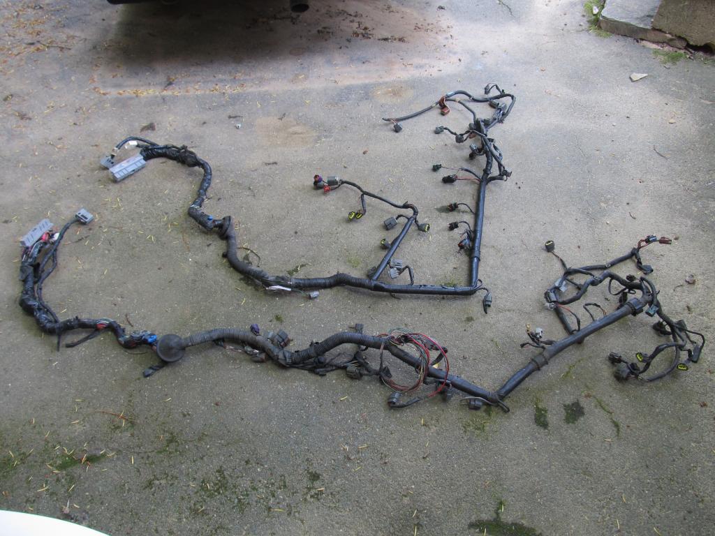

Of course, this is all after spending the time and money getting a fresh, unmolested 1996 Maxima wiring harness to match my 96 Maxima JWT ECU. Check it out compared to the nasty harness that came with the 3.5. I also put in two new crank sensors, but of course that didn't do anything either.
Although we did have to extend a few clips:
And in the end it looks pretty good! I spent a while with wire wheels on the UIM in the down time.

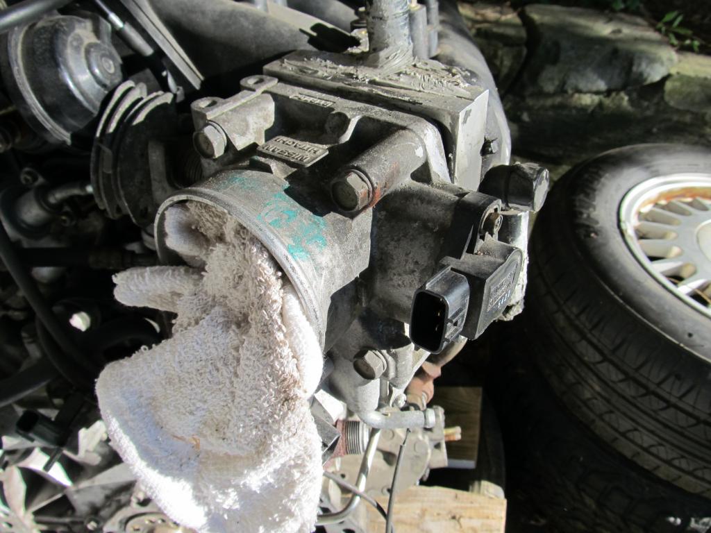

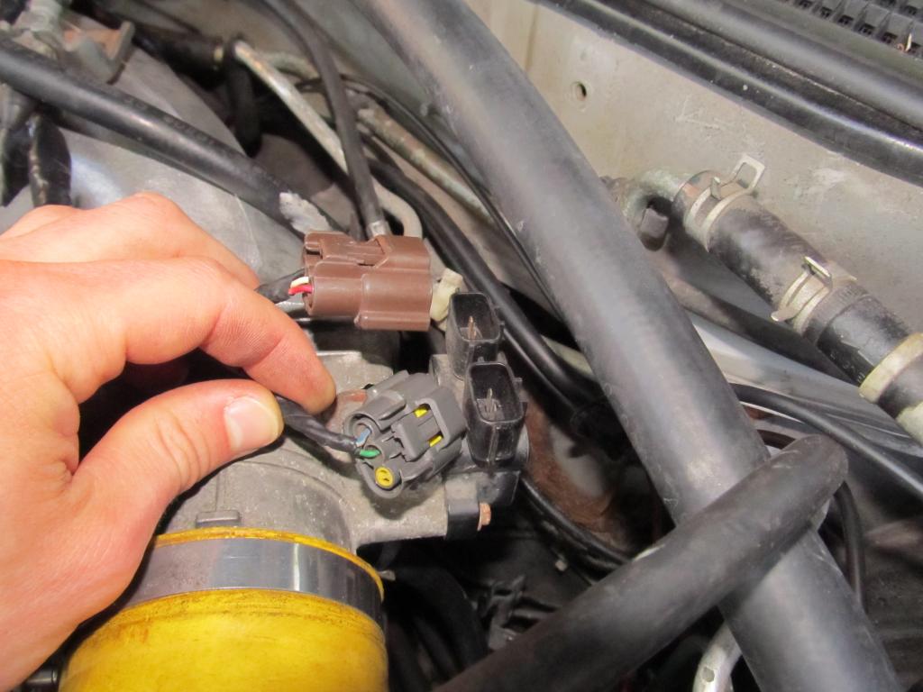

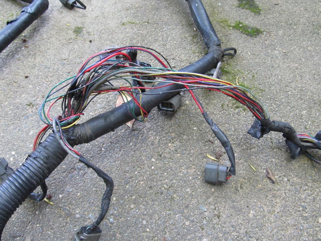

But right off the bat, I know there's a problem. The TPS on my old DEK's PFTB (and I assume stock) is the single plug style:

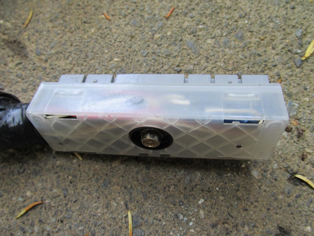

And the stock 97 TB on the 3.5 has two plugs:
I couldn't get one screw out of that TPS to directly compare, but it looks like my old TPS should fit in the same spot. Does anyone know for sure if both styles are interchangeable? I'm still waiting on a PFTB adapter for the 3.5 IM.
Anyways, so after all that, it looks like the problem is that the interior wiring is quite different between I30s and Maximas. Fantastic.

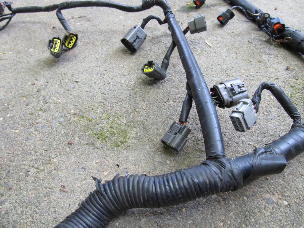

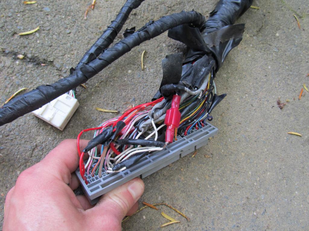

So today with the help of a buddy we got my original I30 harness ready for the 3.5. We rewired the injectors, extended wires for a rear coil pack and throttle position sensor, and bolted everything together. I was pretty confidant we had covered all the bases and the car would start. When I went to reconnect the negative battery terminal (battery in the trunk) it immediately blew the 250a ANL fuse in line running up to the front of the car. We looked everything over for any power wires touching ground and didn't see anything, so I threw a new fuse in a tried again with the same result. We looked things over once more, tried another fuse, and it blew again.
What are the possibilities here? All we can come up with is that the main power wire running from the battery to the distribution block in the engine bay is touching ground somewhere. But when we wired up the 96 Maxima harness two weeks ago and plugged in the battery, we got power to the distribution block just fine, and the car obviously hasn't moved since. This is all with no key in the ignition of course.
I feel like I'm so close to getting this to work, but something keeps getting in the way, and I really don't know where to look now. Can you guys think of something that I'm overlooking? The ECU is plugged in and both of the interior wiring harness clips are plugged in. Everything is ready to go, except......POP!

Well I spent a couple hours on the car today with a new mechanic buddy and I think we narrowed down the potential problems areas.
First, we tried to crank it. Nothing. WTF? It's always cranked over. So we start checking fuses, and the 140a battery fuse is blown. I have no idea when that happened, but luckily I had bought a spare online a while ago and we threw it in. It blew as soon as we reconnected the battery. Now granted, it was a 120a instead of 140a, but apparently the newer 4th gens came with the 120a, and it was all I could find outside of the dealership, and I read that plenty of people replaced 140s with 120s without problems. Anyways, we decide to temporarily "bridge" the blown fuse to do some more troubleshooting, since no parts stores sell either a 120 or 140.
By disconnecting wires from the distribution block, we determine that the engine harness isn't the problem since we unplugged the two main clips that feed it power and the 120 fuse still blew. We also disconnected the starter, but the fuse blew again. But when we disconnected the accessory wire from the distribution block, the fuse didn't blow. Which means that something down the line from that wire is shorting out pretty badly, and judging by the size of the spark coming off the battery when we reconnect the negative, the mechanic thinks it's a big short caused by a big wire grounding out.
Looking at the FSM, there are a number of smaller wiring harnesses in this car, including engine room, one for the cluster, one for the dash, etc. I'm not sure which one to start on, and I'm not confidant I will be able to tell if something is wrong or not just by looking at it.
