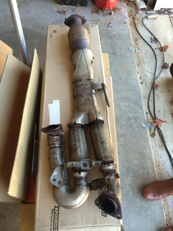

Stock y-pipe:
Current y-pipe: those are 2" that merge to 2.5"

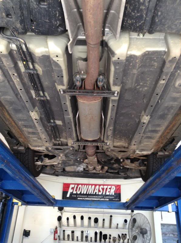

Tunnel before I replaced the resonator and pipe:
And the rear:

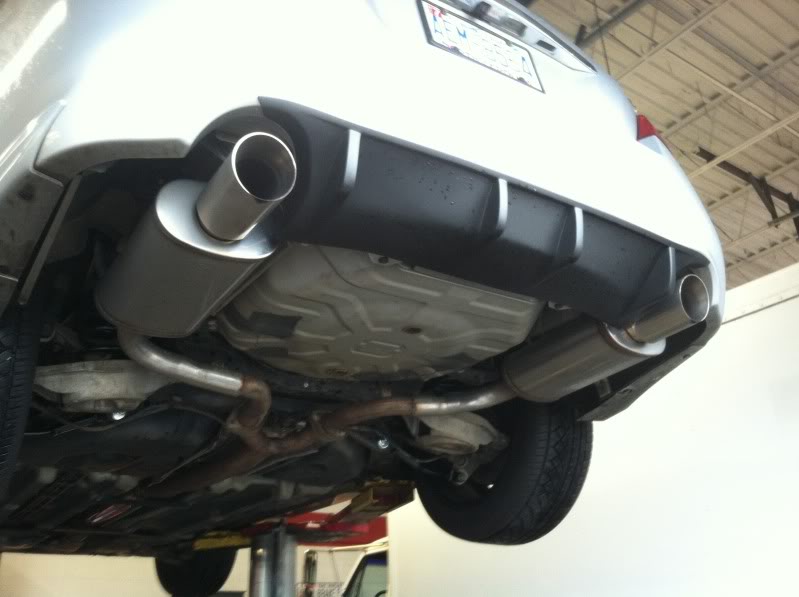

Trying to make something that more resembles this, but with a crossover pipe:

Stock y-pipe:
And the rear:
