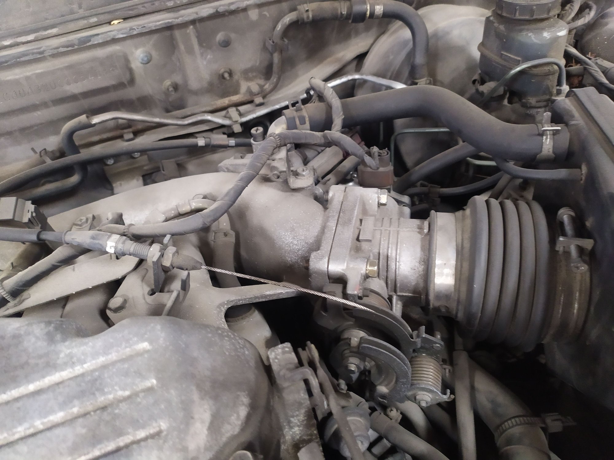

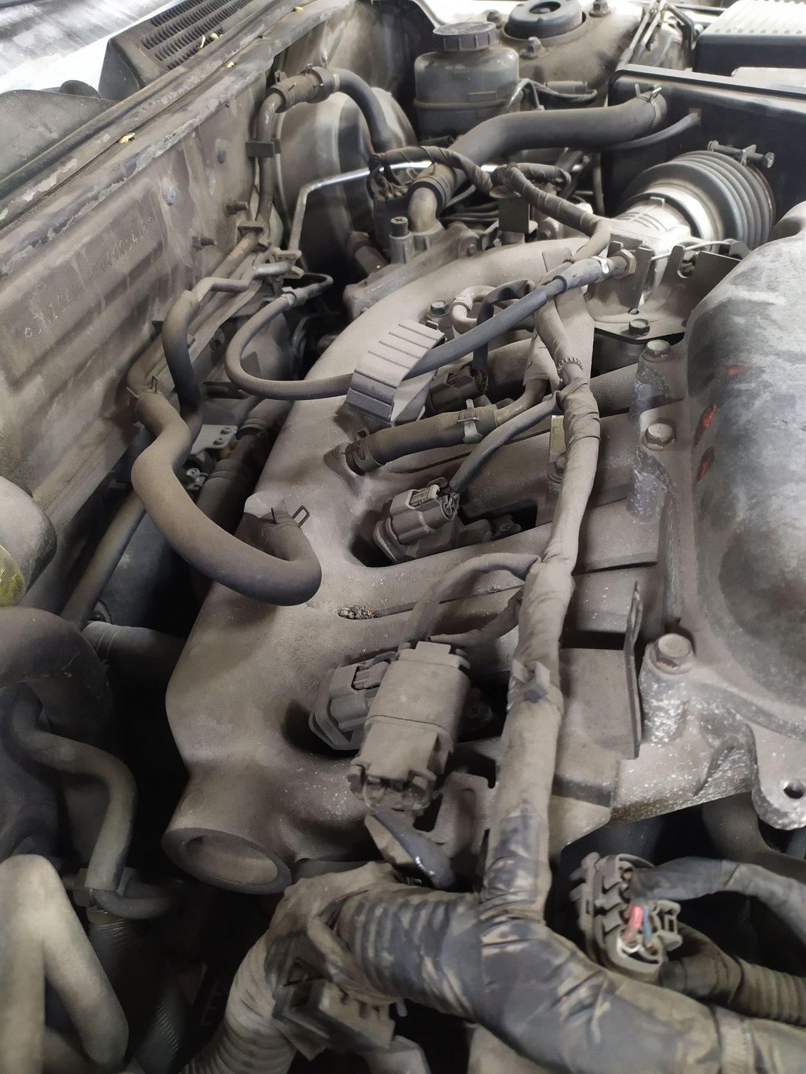

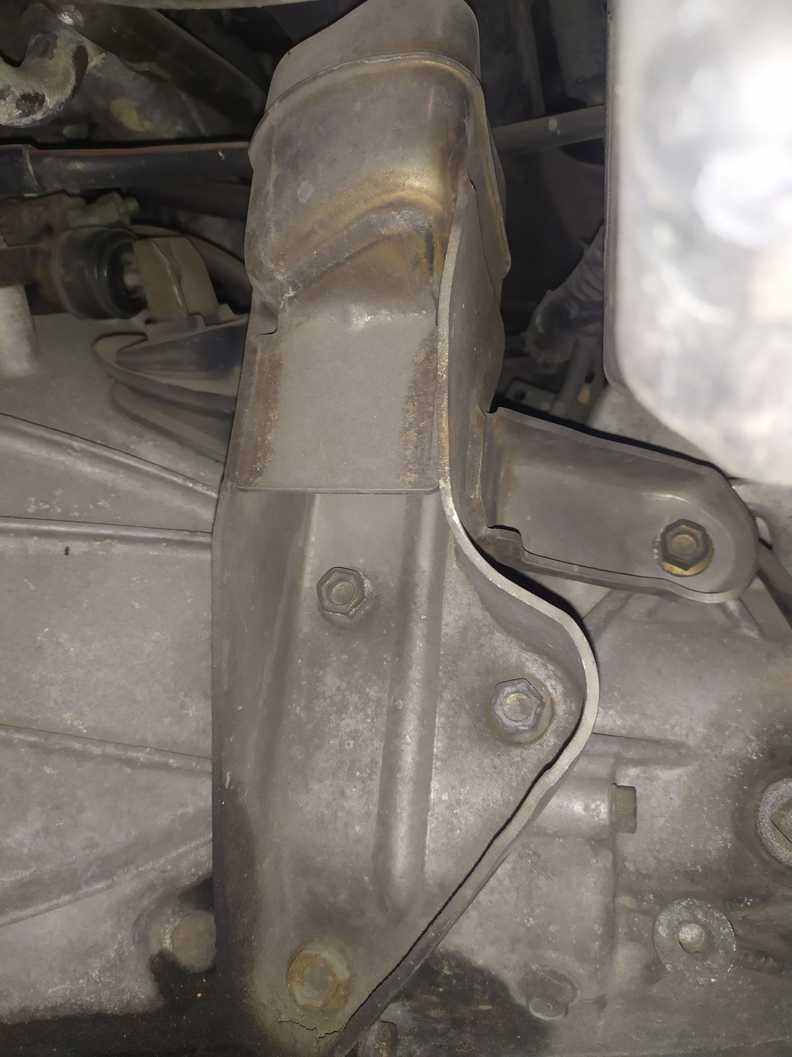

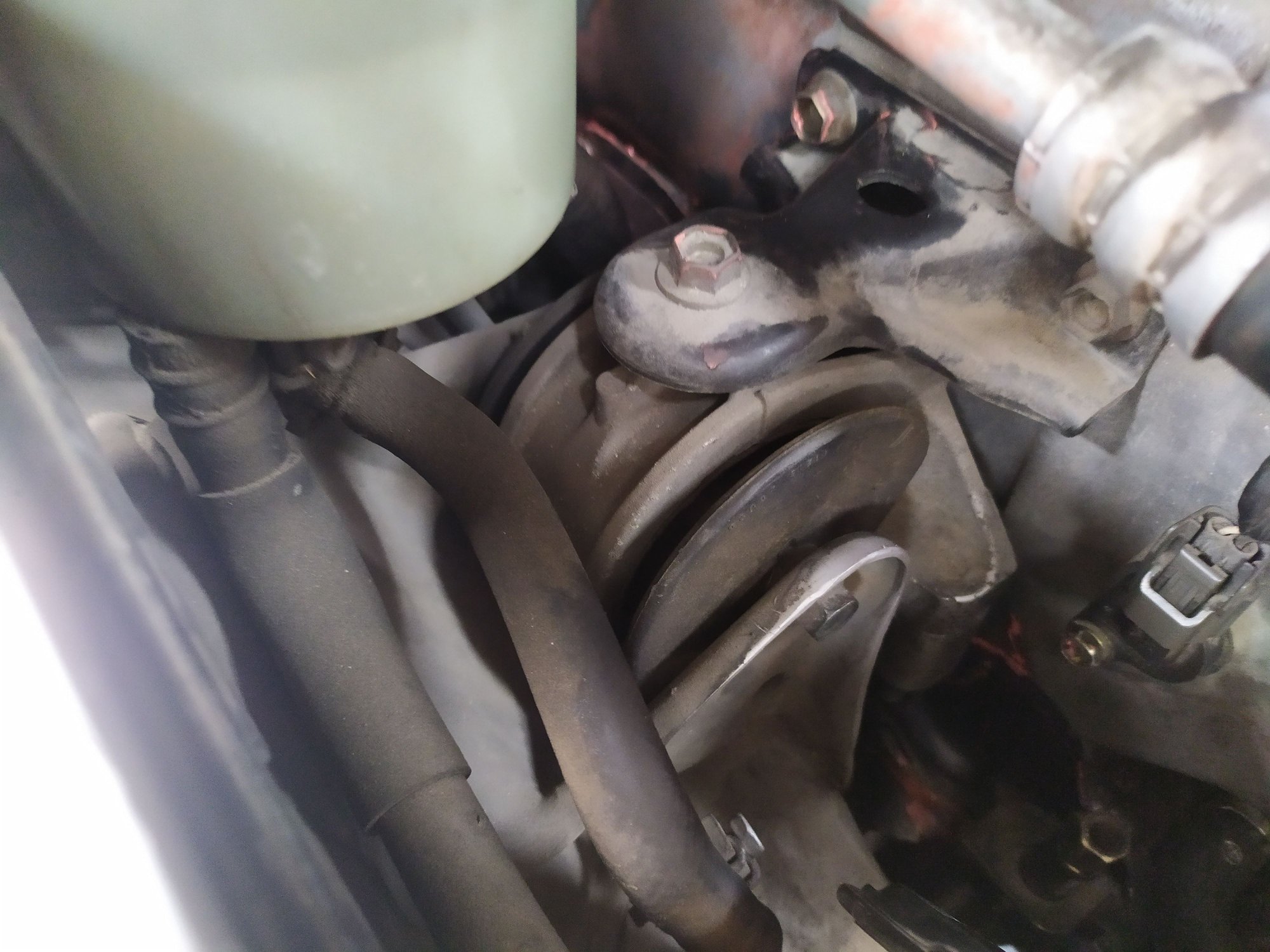

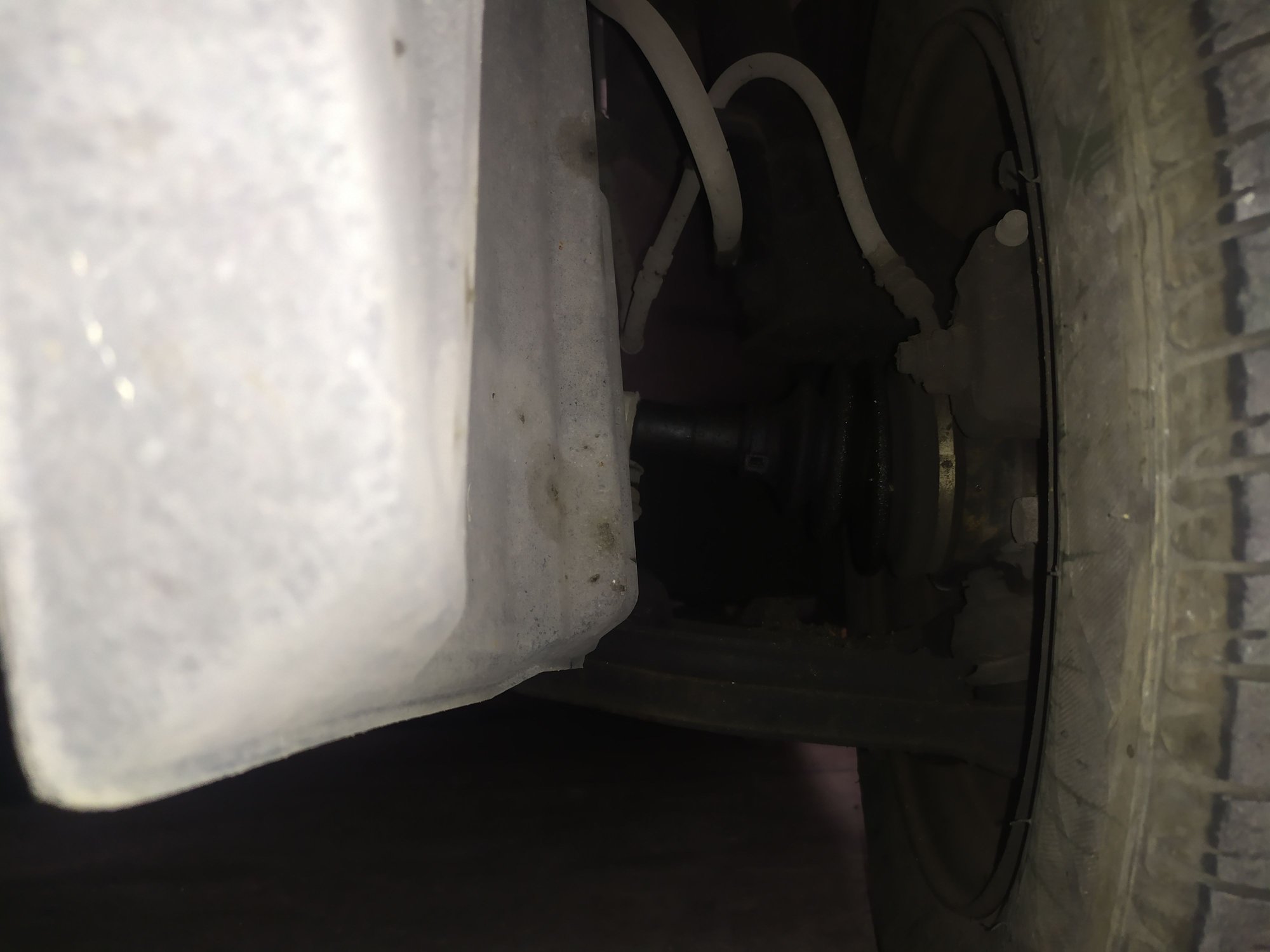

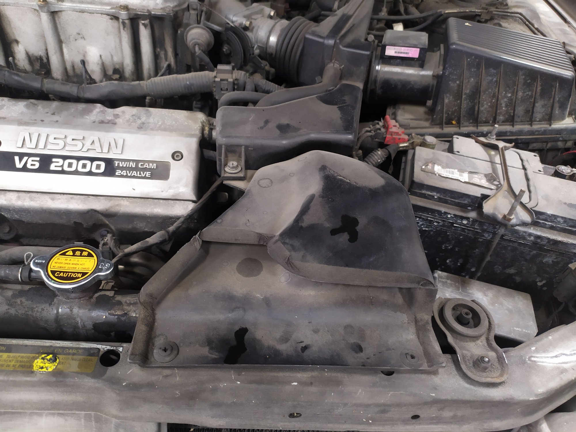

I've taken the chance of some reparations and I've taken some pics of my engine, tranny, maf... Just in case someone notice any difference

It's not much different than a US 95 and nothing that would be in the way. Where can you get a VQ30DE from?
Your car has an oil cooler (we didn't see that until the VQ35), no cruise control, mechanical EVAP (95 only) and the variable intake we call the MEVI (the 00-01 VQ30DEK intake, AKA 00VI, is better but a load of extra work).
What I have never seen is the metal thing bolted to the trans. Any idea what it is?

It's breather according to nissan4u (i thought it was another mounting)

Thanks for the photos! Can you take a photo off the VIN plate? Should be on the firewall, feel free to blur out the VIN - I just want to see the engine and transmission codes.
As JSutter mentioned, should be a darn near direct swap.
Is that a filter assembly that attaches to the transmission breather line?
If you get your 3.0 from another euro I have a hunch it will likely have the same intake manifold and probably an oil cooler as well.
  • If you get the 4th gen 3.0 it will be just about direct swap.
  • If you get 5th gen 3.0, itll have some more power (due to improved intake manifold), but youll need to do some rewiring and hose routing for the new intake manifold.
If you could share pictures of the 3.0 you get that would be great. I'd love to see if it also has an oil cooler and if that coolant line runs to the thermostat.
VQ35DE swap with stock 3.0/2.0 ECU will bolt up to the 5 speed trans but it is definitely a complex project and more expensive than the 3L route.
