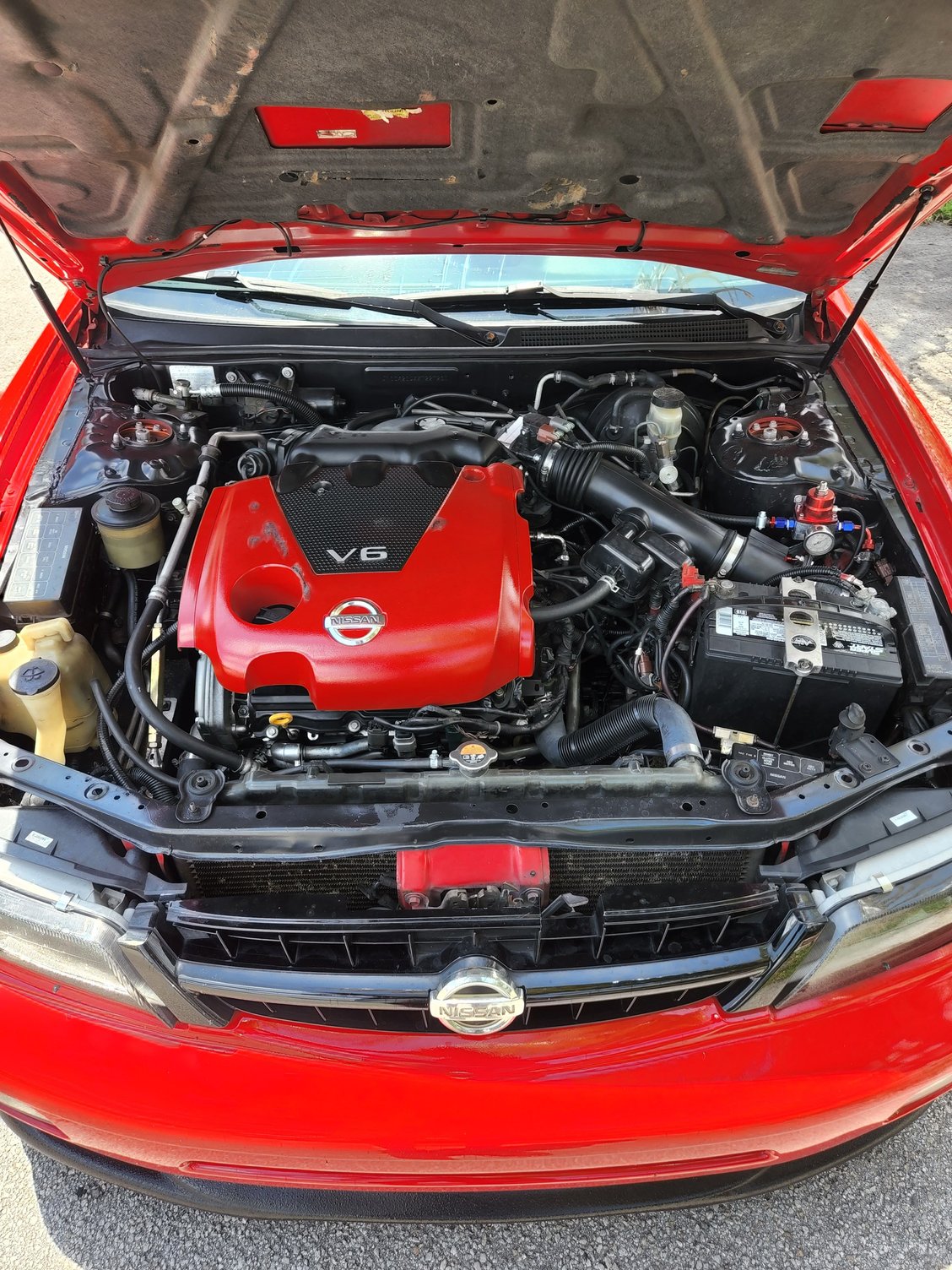

Check out the walk around.with the new engine and the upgraded brakes from a porche chayenne.

Looks like a clean ride.
How did you do the timing?

I made him a set of cam adapters using modified OEM cam gears.
schmellyfart is the man for the adapters and they fit perfect.

Man that a clean build. Looks like it came stock! Great job!

looks super clean. did you ever get around to dyno'ing this?

Great job on the swap! What ECU and throttle body are you using? What's your exhaust setup?
I am currently using my stock 99 ecu with a pathfinder throttle body. Headers with ypipe and straight pipe all the way back

How you manage to do that it was a known fact that 99 ecu won't work unless it was a swap with an 95 ecu 🤔🤔 maybe a pin bypass the ecu pins to make it work stock harness also ???
I never had an issue with my 99 computer and I had in the 2007 motor before this one. I did not change anything at all.
Nope, definitely not a fact.
99's have trouble extending the rev limiter with the emanage, but you can still run a 3.5 on 3.0 timing with 99 ECU as rich mentioned. 99's can also be more sensitive if you remove emissions components.
More difficult? Yes. Impossible? no.
