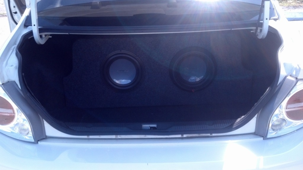

Well, just thought I'd let you all know what I ended up doing. I left the box sealed, at 1.25 ft^3 per chamber, running two Fosgate 10" (P2D2). I'm powering them with a Fosgate T600-2.
They sound very good, but sometimes the upper lows are a beat weak, whereas the low notes hit very strong - close to the sound of a ported box. After fiddling with the equalizer & crossover, I like the end result, although I'm still pondering whether to reduce the box volume a little; maybe closer to 1 ft^3. I might do a temporary reduction with some 2X4's, just to see what the difference would be.
Here's some pics...

yeah just try to reduce the airspace a bit...it'll help out with the upper bass response. what's your low pass crossover set at?
