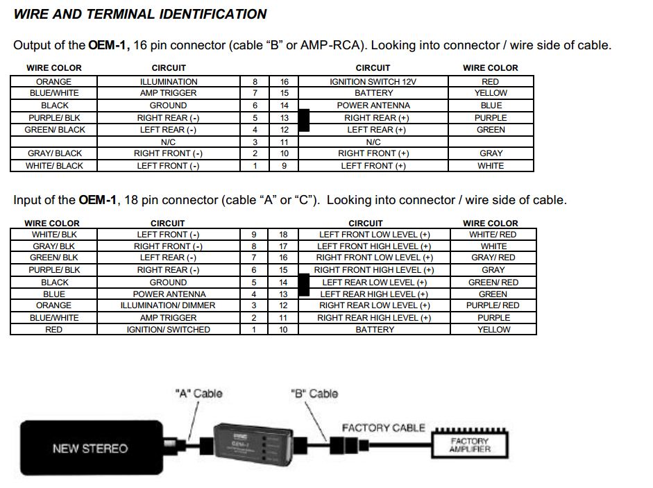

Ok, is wiring the PAC kit supposed to be as difficult as I am making it?

Installed the kit, and voila! It took me up to volume 40 to actually reproduce what volume 17 puts out with this kit. Needless to say, make sure your headunit is AT LEAST a constant 4V when installing the 70-7551 Metra Harness. The PAC unit was a little confusing at first, but all I did was wire it directly to the headunit harness, color for color. About as plug and play as you can get. I am pleased with results, I finally have good sound after a week of quiet music and feedback throughout the system. JL components this summer, but this will hold me over til then . Thanks for the input and feedback guys. Like I said, sometimes it's nice to just talk to some people instead of pouring over thousands of pages of threads
