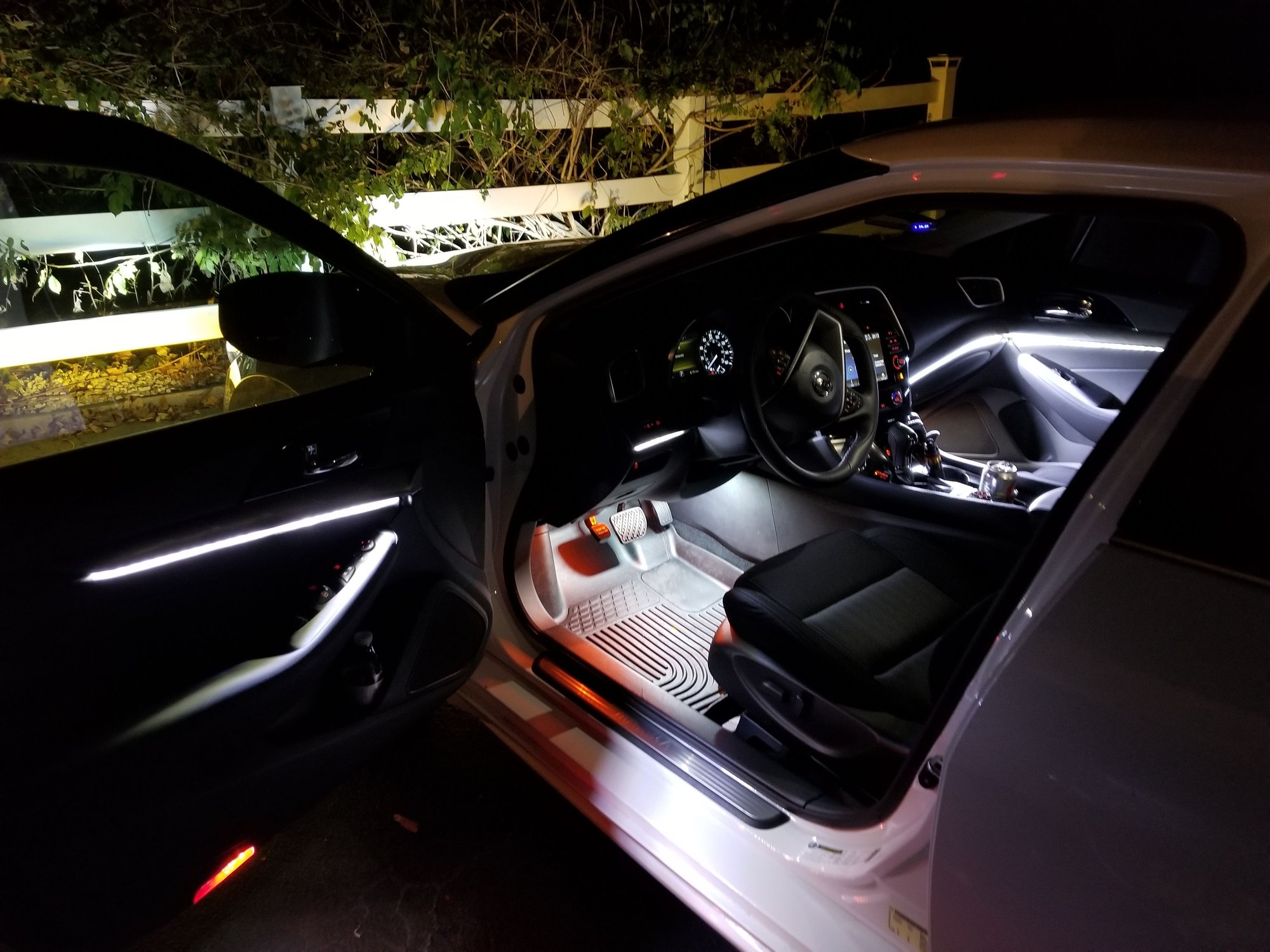

Hey guys, new here and thought I would show people a cool mod that can be done with a little know how to our Maxima s. I got these 50cm led strips from Diode Dynamics, they fit just about perfect in the doors and glove box and if you can solder you can cut one down to size and put them on either side of the steering wheel like I did. I got the Nissan accessory connector and wired these to the dome light trigger so they fade in and out with the dome lights.
