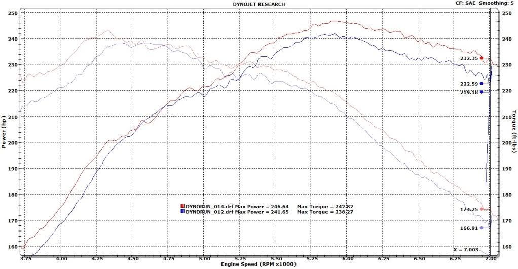

Actually, 246.64 w/ a smoothing factor of 5
Did some runs after a 4 year hiatus. (5-4-07 was my last session)
The differences are the intake, spacers and Cattman 3", and fast cat.
My last dyno was LRMAF (fully screened, 82mm( strapped directly to the cone filter, ub3r short and no velocity stack and a test pipe with Cattman b equipped with the moroso spiral flow race muffler, cherry bomb 18" resonator and stock muffler.
This new intake incorporates the stock Helmholtz, custom 3" ID MAF housing (no screen and 76.2mm vs 82mm ID) and JWT POP (3"ID).
And the spacers, except I do not have the elbow to manifold spacer installed because of my SSIM, haven't had the time to shave the center section.
I think that's it.
In my experience, I've seen that the stock Helmholtz + POP gives the smoothest power delivery curve. Tomorrow will prove or disprove this theory. (no 5200RPM hump).
I also seriously feel like it has more pull with the new PUR engine bushings. Tires lose traction even easier than before the bushings at about 6000-7000RPM.
Threw on my lightweight 17's this afternoon to keep things similar and remove any variability, by the way, compared to the Z33 tracks, it looks like shyt now.

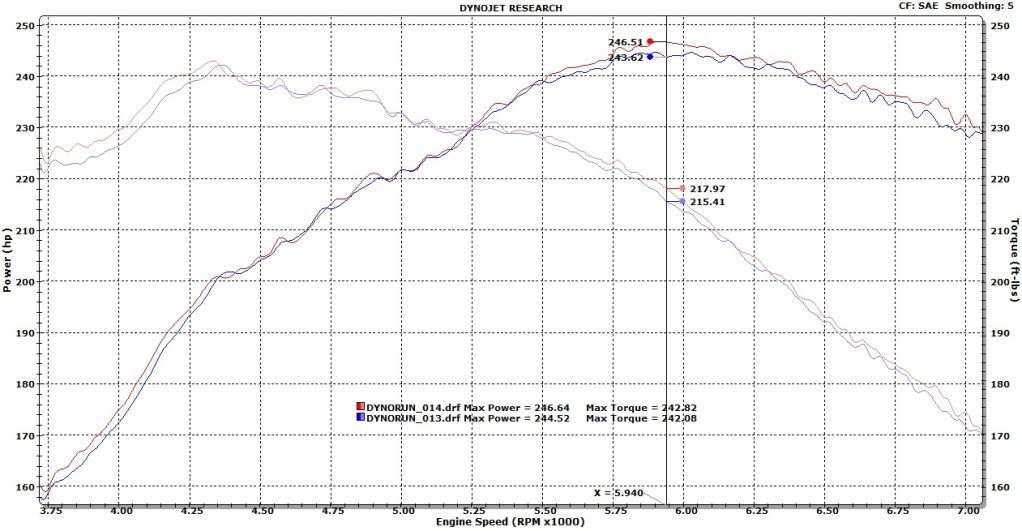

Long story short, ran out of time, only got 2 runs in, she's got more in her with some finer MAF conditioning.

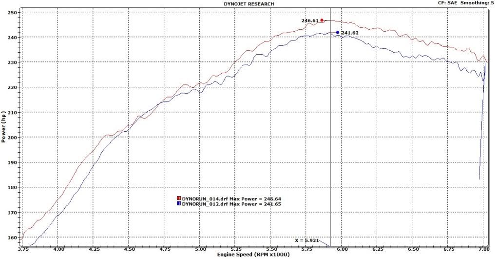

Good news is that I gained an average of 10 ft/lbs from 3700 - 4400 and 3-5 whp from 4700-5500 and 5-8hp from 6000-7000. Peak #'s weren't very different than last time.
246.64@ 5911 RPM / 242.82 @ 4336 RPM. Taking out 12-14% fuel early on from 4000-5500 then gradually down to about -7% from 5500 to 7100.

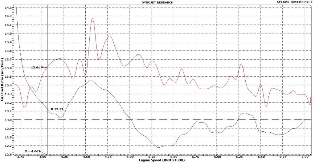

AFR was 13.5 or so then down to 13.2 towards 6000 - 7100. It likes being leaner. Gained about 3 peak whp on the second run from removing fuel globally about -2-3%. I think going -5% all around (total, so 2-3 more % from this run) would put me at around 250.
It sounded amazing too
I want to go a bit leaner next time
Average hp difference from 6-7k (+):
6000 5.97
6050 5.14
6100 5.6
6150 5.51
6200 5.95
6250 7.23
6300 6.79
6350 8.26
6400 6.91
6450 8.8
6500 6.47
6550 5.32
6600 4.32
6650 6.97
6700 5.62
6750 6.01
6800 5.82
6850 8.04
6900 9.79
6950 6.47
7000 9.86
AVG: 6.7

Averages across the board were about +4.8
Comparison to my last best regarding the differences between them re: info above:
Both hp & tq
HP only:

Today's runs:
AFR (hi res, check the scale)

Strong numbers. Go to direct IGN/INJ control.
Old Apr 23, 2011 | 09:37 PM
ajcool2's Avatar
Joined: May 2004
Posts: 10,550
From: Baltimore, Md
Nice. Get the a/f around 12.8 and you'll definatly gain more hp.

Seems to like the "leaness" though. I'll post a comp vs my old best vs my new best. Old best was around 12.8 or so.

def think youd make better #s with a richer tune, my 4.5 and my buddies 5.5 both liked the 12.8s-12.9s ober 13s , while on the dyno
Old Apr 24, 2011 | 12:32 AM
NmexMAX's Avatar
dot dot dot ...
Posts: 34,576
From: Santa Fe, NM
I go rich and the **** goes down in powah. Doesn't anyone remember Matt's theory?

i guess timing can come into play, maybe me and my boy had some slight knock which was mitigated by the richer mix
