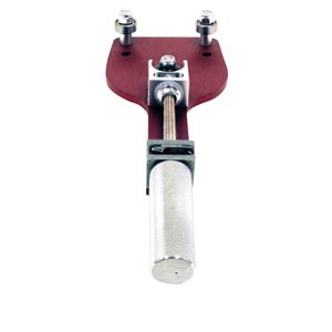

What do you guys use to cut up the old oil filter? A good old Dremel?
Oil filter cutters are available from some on-line racing shops...they seem to be popular with small aircraft engine mechanics as well. I have one made by KRC...it will cut a filter open in the matter of seconds without mess or metal shavings. It works similar to a can opener, where the filter canister is pushed up against a cutting wheel, just above the base plate. http://www.summitracing.com/parts/KRC-1201R/?rtype=10
There's others available from different sources, but Summit Racing has several models available...some more and some less expensive than the KRC

I use this oil filter cutter, but the VQ oil filters are too small (VQ30DE and VQ40DE use the same filter as far as I know).
