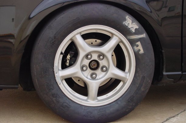

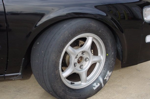

that particular combo was 3rd gen rx7 wheels with MT 26 x 10.50-16. weight of those wheels were 14lbs, but rx7 wheels range anywhere from 14-16lbs depending on year i think. 16x8, +50 offset. i used a 10mm spacer to clear my coilovers. discount tire can special order MT slicks for you.

the minimum width requirement on the 10.5" slicks was 8". they mounted up fine, i didn't even need to use tubes. they'll fit your brakes with a big enough spacer(dunno what size though).

No they wont fit over ZX brakes.......I tried. Sold my RX7 wheels for 250 and got some N/A ZX wheels. 16 lbs piece.
