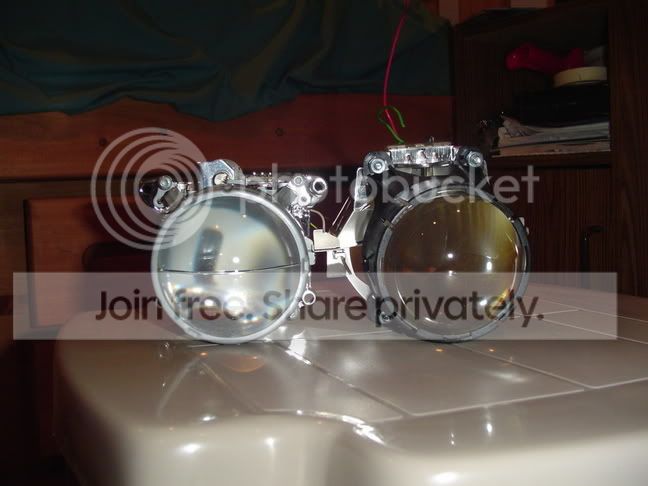

So I found some pretty usefull projector measurement info...
Courtesy of EunosTT on Hidplanet forums...
So, I've been sick for a past few days and been going crazy with my digital caliper. Here are a few dimesions of different projectors that I have kicking around. Hopefully, this will be useful for others to determine if a specific projector fits. PS: Length was measured with a D2S in there and is measured to the end of the bulb. Diameter was measured for shroud fitting purposes and is a measure of a housing right on the edge, closest to the glass lens.
Hella 2nd Gen Bi-Xenon (aka E55):
Diameter = 79.80mm
Height = 96.95mm
Width = 106.15mm
Length = 163.35mm
Length(seat of the lens to mounting holes) = 58.80mm
Length(mounting holes to end of bulb) = 83.90mm
Width(between top mounting holes) = 77.25mm
Width(between bottom mounting holes) = 93.25mm
Height(between mounting holes) = 58.90mm
Stanley Bi-Xenon (aka TL):
Diameter = 80.25mm
Height = 95.95mm
Height(with solenoid) = 117.15mm
Width = 111.60mm
Length = 171.85mm
Length(seat of the lens to mounting holes) = 56.90mm
Length(seat of the lens to end of solenoid) = 89.25mm
Length(mounting holes to end of bulb) = 95.80mm
Width(between top mounting holes) = 82.55mm
Width(between bottom mounting holes) = 90.85mm
Height(between mounting holes) = 71.40mm
Bosch Bi-Xenon (aka E46):
Diameter = 78.30mm
Height = 84.10mm
Width = 105.00mm
Length = 166.95mm
Length(seat of the lens to mounting holes) = 66.65mm
Length(mounting holes to end of bulb) = 80.70mm
Width(between top mounting holes) = 82.00mm
Width(between bottom mounting holes) = 95.10mm
Height(between mounting holes) = 62.10mm
Valeo Bi-Xenon D1S:
Diameter = 82.55mm
Height = 96.00mm
Width = 106.20mm
Solenoid(sticks out by) = 9.40mm
Solenoid Length(from mounting holes) = 69.05
Length = 156.20mm
Length(seat of the lens to mounting holes) = 49.45mm
Length(mounting holes to end of bulb w/D2S) = 84.25mm
Width(between top mounting holes) = 72.20mm
Width(between bottom mounting holes) = 70.95mm
Height(between mounting holes) = 78.20mm
Hella Low Beam Only (from pre-2002 Audi A6):
Diameter = 71.90mm
Height = 103.65mm
Width = 110.55mm
Length = 159.00mm
Length(seat of the lens to mounting holes) = 55.40mm
Length(mounting holes to end of bulb) = 84.45mm
Width(between top mounting holes) = 67.85mm
Width(between bottom mounting holes) = 82.35mm
Height(between mounting holes) = 87.95mm
Old Feb 16, 2005 | 08:03 PM
Rowan's Avatar
Joined: Nov 2002
Posts: 1,634
Here are some more lense shots:
Since I had a few in my pocession, I thought I take a few pictures so people can distinguish them. These were taken exaggerated such that the lens finish could be seen. I have also measured each lens on four parameters: Overall Diameter=Dt, Curved Diameter=Dc(dia. of the curved part of the lens, without the flat edge), Center Thickness=Tc, Edge Thickness-Te. All Measurements are in Millimeters. I have not measured focal lengths, unfortunately, as I may need an optical bench for this. Why the measurements? May be someone wants to make super clear custom lenses?
Hella Bi-Xenon Lens:
Dt=74.67mm
Dc=69.96mm
Tc=22.69mm
Te=3.65mm
Bosch DOT Bi-Xenon Lens:
Dt=73.70mm
Dc=70.46mm
Tc=21.41mm
Te=3.00mm
Stanley Bi-Xenon Lens:
Dt=74.64mm
Dc=69.88mm
Tc=22.28mm
Te=3.36mm
Valeo Bi-Xenon Lens:
Dt=76.71mm
Dc=71.95mm
Tc=26.96mm
Te=3.33mm

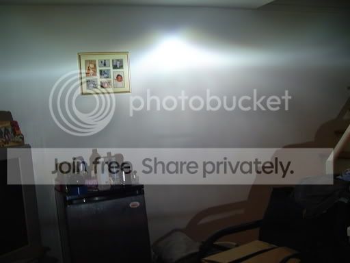

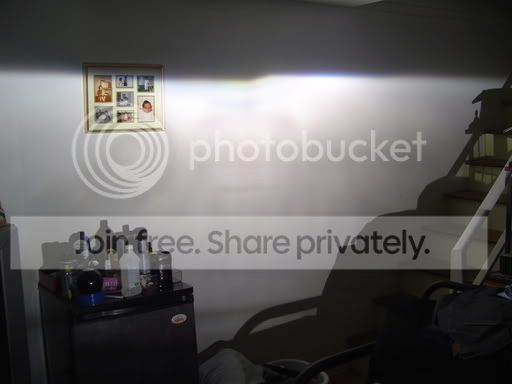

e46 bixenon cutoff pic
or
highbeam e46
old (left) vs new e46. The new one is slightly bigger, has a different solenoid design, a sharper cutoff but slightly less impressive high beam.
new e46 pics:
