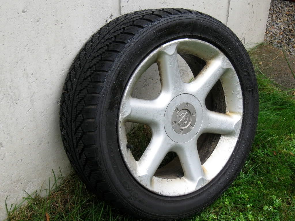

I bought them for $200 and refinished them. See finished pics further down.

Maybe worth it for the tires but those rims are TRASHED! wow.
Definatly trashed but it will be a good project for me to refinish them before winter hits. I figure I've got about a month or so, to get em lookin half decent, I'll update my refinishing with picts. I'm gonna pick them up tomorow and get started on fixing the nastyness. They WILL look good before they go on my max...lol

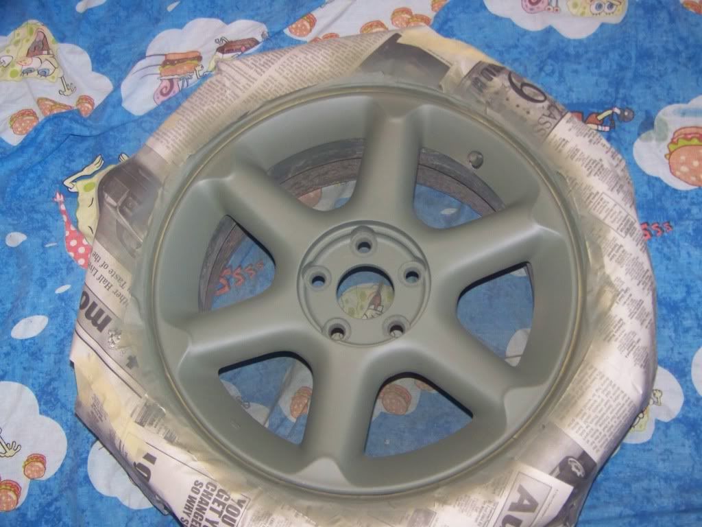

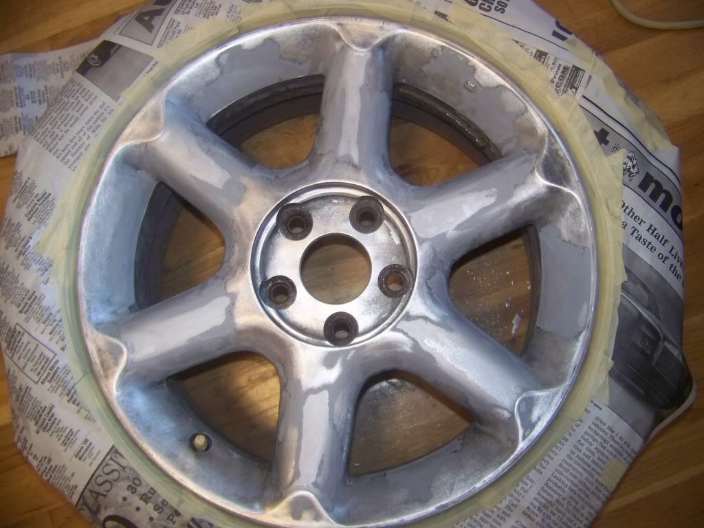

Just an update picked em up today got the guy down to $200 due to the nasty rims. I started preping them for paint, it took me about 6 hours to get 2 of them ready to paint. It took a lot of work with a drill and wire bit and lots of 60-200 grit sand paper. I just need to give them a good rub down with some fine steel wool before primer and paint.

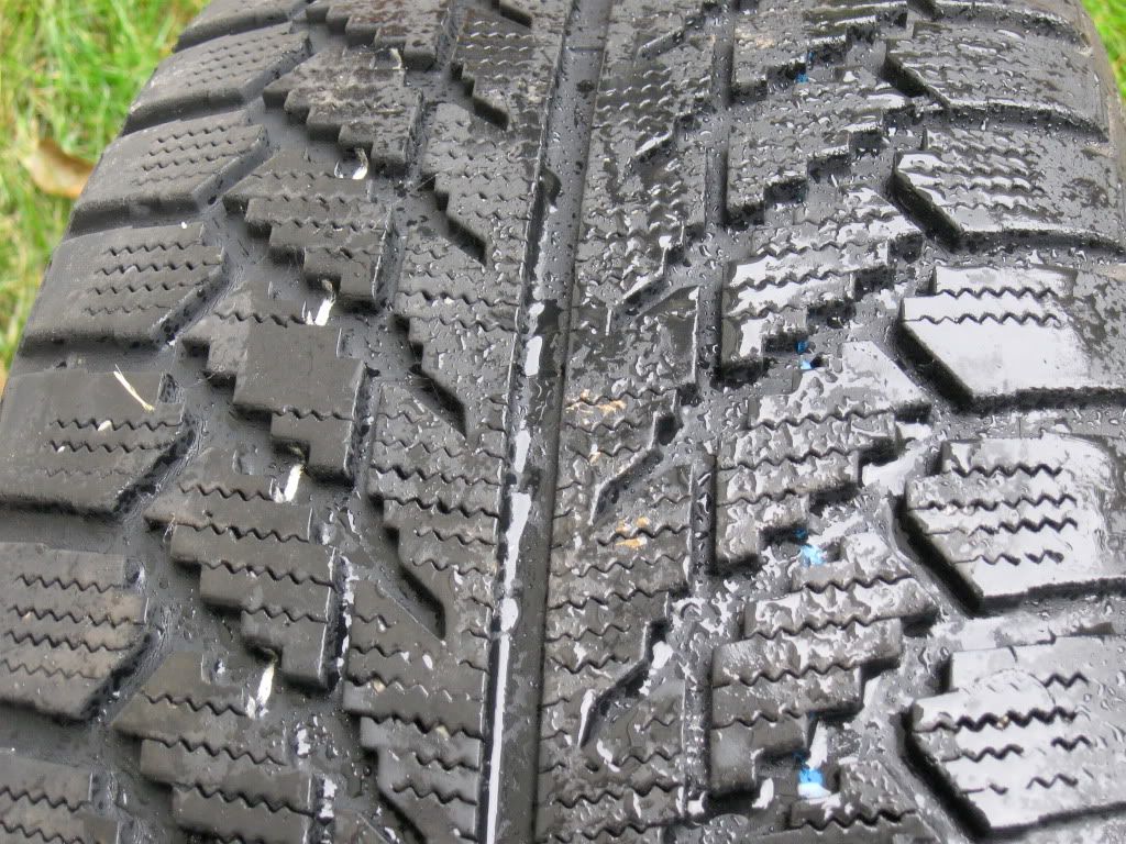

if you look clost at the tire pic you can see that they are weathered. there are cracks in them

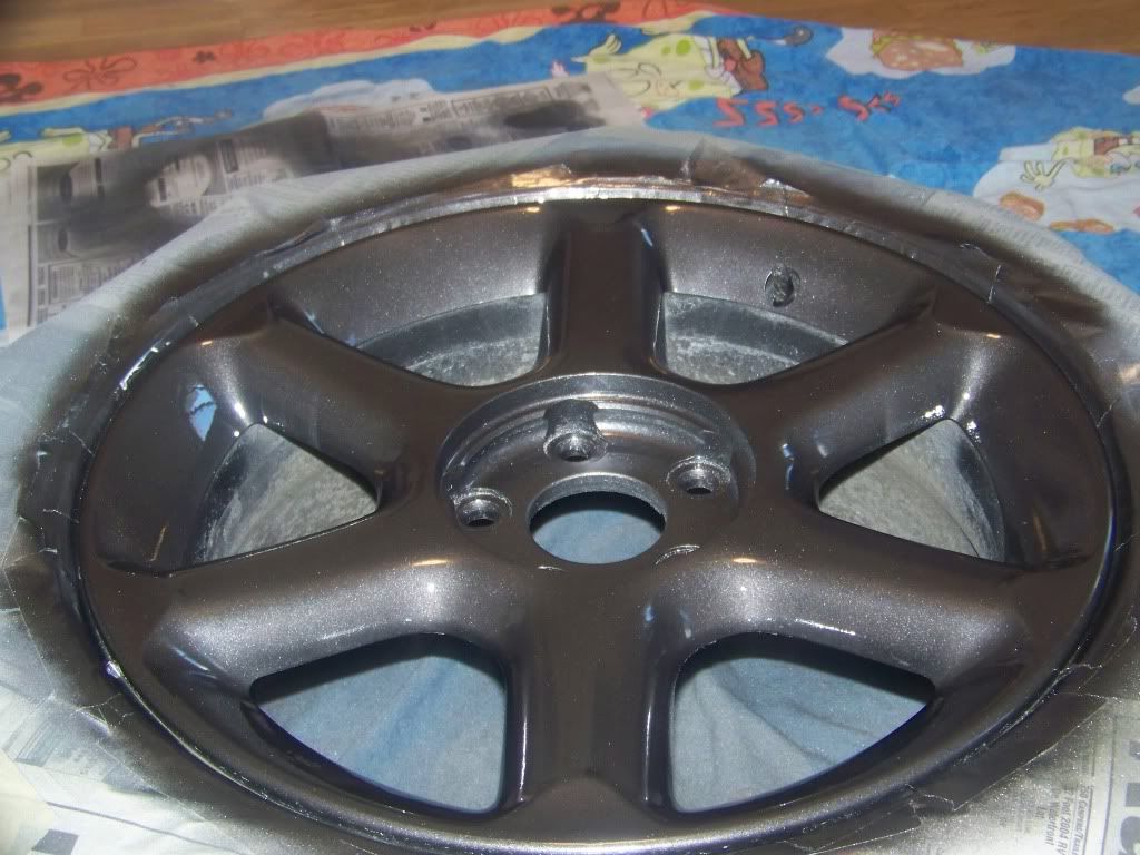

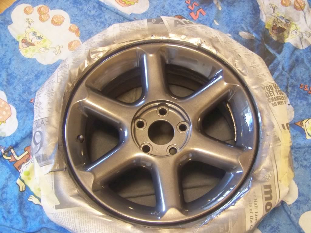

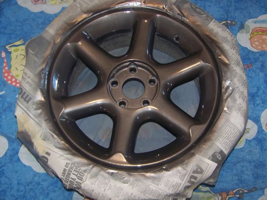

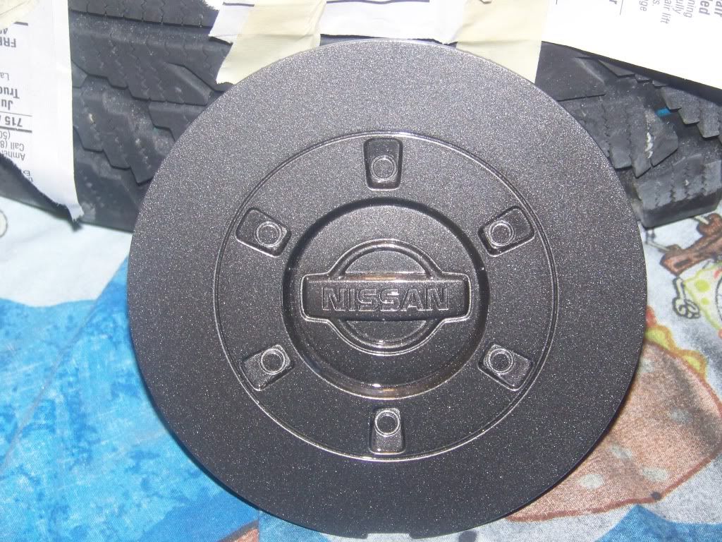

So I finished refinishing the wheels, I used Duplicolor Wheel Paint/ Clear and self etching primer. Came out pretty good, I probably spent a good 10-12 hours grinding and sanding to get them preped for paint. Anyway here are the finished picts. I'll post some more with the newspaper off later on after the paint cures a bit.
Preped
Primed
Painted and Cleared

Those look great! Nice work refinishing those rims!

Oh come on now its not that hard your G35s should be in much better shape than my AEs were just a quick sand with 320 prime 2 coats paint 2 clear and you're good to go. Unless of course you want to fly me out to Seattle then I'd be more than happy to do yours for you...lol
