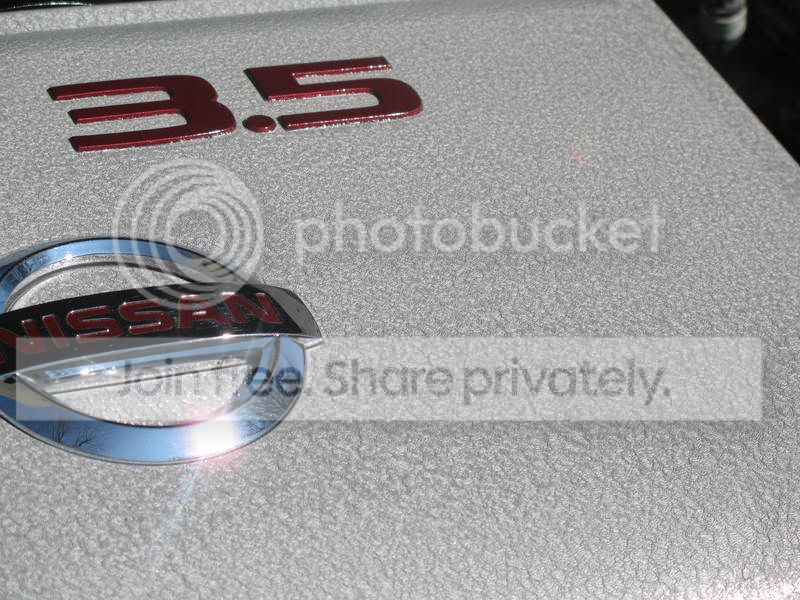

I used Rust-Oleum Plastic Hammered paint. It's the same stuff I used for my engine bay.
It's labeled straight to plastic no primer needed. I did however, sand and adhesion promote my engine pieces. After two days of curing, I used Rust-Oleum Crystal clear for gloss.

Looks great KC
