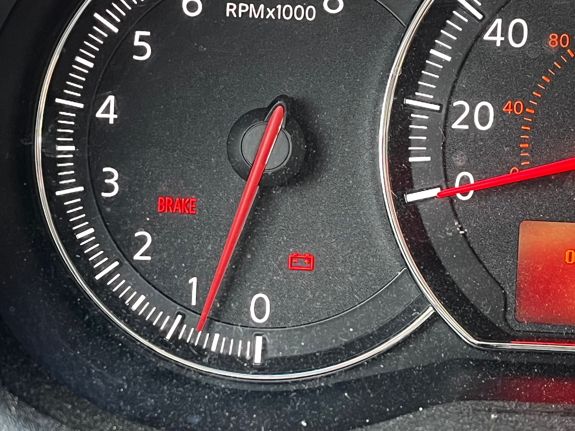

While driving on the highway, I pressed the brake to slow down, then pressed the gas pedal to accelerate, but the car didn’t increase in speed at all. The dashboard displayed the emergency brake and battery warning lights. The engine didn’t rev. I turned the car off but couldn’t restart it. Eventually, I had to get a tow truck to jump-start the battery, and I was able to drive back home. The car passed AutoZone battery and alternator load test, but got the following codes:
P0826 - Up and Down Switch Input Circuit
P0868 - Transmission Fluid Pressure Low
I haven’t used the car since. Any ideas what might be causing the problem?

Question: Do you have the parking brake on? Usually the combination of the Brake and Battery light means the alternator is dead, so it's strange it passed the test. The fact that the car only started after a jump indicates a weak battery. Here's what Google says about the other codes:

Basically, unless you have a fancy scan tool, you're probably best to just take this to a mechanic so they can do a proper scan of the ECU and figure out what's going on. I'm not sure how to check the fluid on a CVT, but if it has a dipstick you could check that and see if the CVT fluid is low and top it off if needed.
