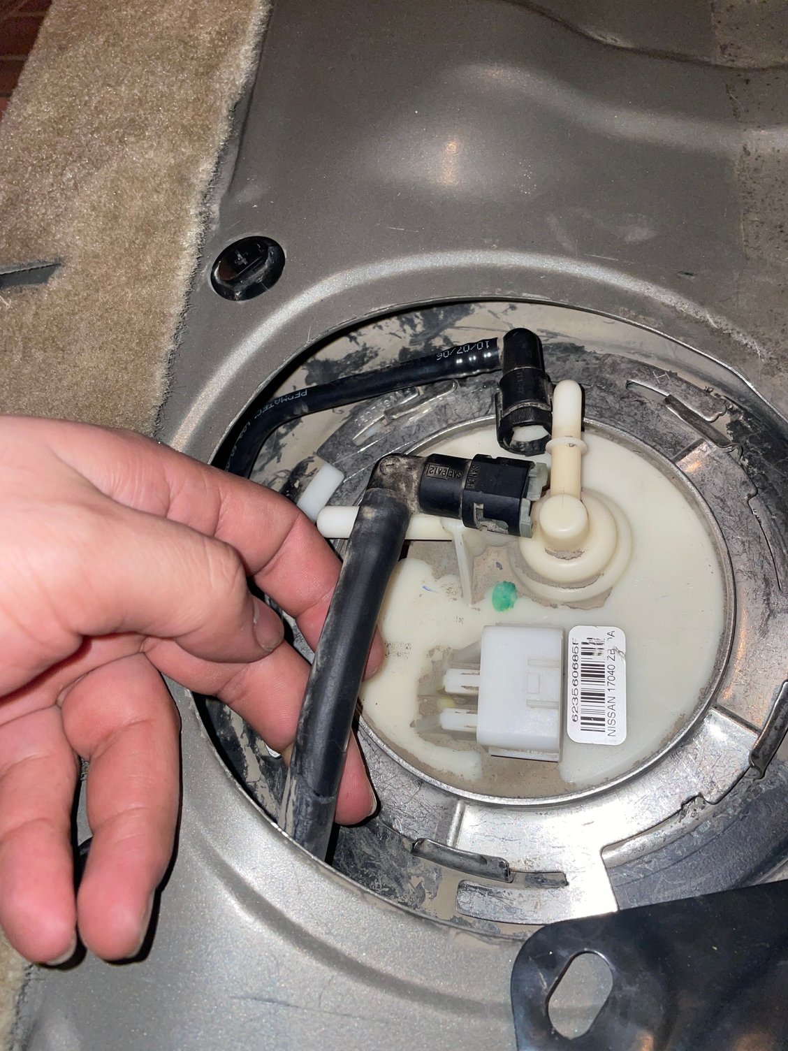

Hi , im a new user i have a 07 Maxima i was replacing my fuel pump been having issues where my car would die out on idle
so as im not a very patient person i just so happened to break my fuel pump feed line if anyone has a link to a replacement hose or a any suggestions or diagram on how to fix / replace i would very much appreciate the help. i can post / add pictures of the hose i need

I had to make a similar repair on my truck. I got a S.U.R.&R. fitting from O'Reilly.
See page 24-25
https://www.flipsnack.com/6CF8C699E8...full-view.html
