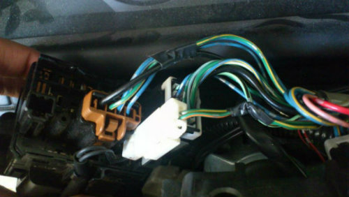

Now it’s time to work with the ballast. It is important for the ballast to be safely secured and as far from the water as possible. There are three ways to secure it good and one way to secure it bad. The bad way is to use 3m tape. I tried it and next day it rained, I found one of my lights not working and the ballast resting on the splash guard. Now good way, best way and the hardest way is to secure the ballast with screws. Second way is to use zip tides, but this one may cause the ballast to move around. Keep in mind that some ballasts don’t come with brackets or any way to secure them with screws. Here is what I did, I used 3m tape, but I used super glue on them. You can see exactly what I did looking at the pictures.
Don’t wait too long, after you put super glue on the tape, attach it to the wall. I attached it next to OEM HID ballast.
Now that your ballast is in place and your fog assembly is ready, take the wire from ballast that is to be connected with the stock wiring and make beautiful connection with the stock wire. I would recommend you to splice the stock wires right next to its connector. Put the connector back on cap to keep dust and other bad stuff from the cap. As always, for the connection you can use wire nuts or crimp cap. Some people use other connections, but these two work best for me.
So now we have powered ballast with AMP connectors and fog assembly with AMP connectors sticking out of the cap. I hope you know what to do now. If length permits you, connect the AMP connectors while the fog assembly is out. Don’t pull on wires too hard. When I worked with mine, one of AMP connectors broke off. If your connection broke off, you can always splice the wires and make connection with a wire nut or crimp cap. Now when the AMP connectors are connected, connect the corner light and put whole assembly back. If your wires are not long enough to make connection while the fog assembly is out, you can make connection when the assembly is in. Just be careful when you connecting the wires, they are not too strong and you can accidently disconnect or even worse, brake connectors.
Before you secure the light with a screw, you can check it out to see if it works fine. Try to turn the light on and off couple times to make sure it’s all right. I am not sure if you know how HID works, but it takes a lot more juice to start the HID light and once it’s started, it uses about three times less power than regular halogen would use. So it your light started one time, it does not necessarily mean everything fine, double check it couple times. Also, VERY IMPORTANT, check it out when your car is running. If you will trigger the HID couple times, you will run out of battery pretty soon. If you do have some problems, feel free to write it down here, I’ll try to help you.

UPDATE: During heavy rains, the setup might fail, even if you have your ballast feet higher than splash guard. I did now perfect installation, brought 2 1m amp extensions and installed the ballast under the hood.
Also, I used posi-tite connector to connect original wires to my relay (you can connect them straight to your ballasts if you don't have relay)
That way, even if you in a 3 feet pond, your HID fogs should be okey (for some time )

So as I explained here before, theoretically speaking, it is the best and safest setup. But there is a problem, that's what happens when dealing with Chinese sheet. The wires are BS, they look like they strong enough, but if you splice the wire, you will see that they are VERY thin. That causes lights not turn on all the time. The shorter the wire, the more chances you will have for lights to work every time you turn them on. But if you will have short wires, your ballast and all connections may get wet because your connections and ballast will have to be close to fog light. The longer the wires, then your lights will not work all the times because of the thin wire lengh.
Anyways, here is what I am planning to do, find another HID kit with bigger wire and long too (so I can have connection from fog light to behind headlight) OR find strong extension AMP wire.
The problem with second option is that if there will be 6 inch of THIN wire coming from ballast and then 3 feet of STRONG wire going to fog light assembly, there might be electrical problems and possibly SHORT wire will burn.
So I am looking more towards better and unfortunatelly more expensive ballasts.
P.S. my passenger side fog light lights up about 90% of the time
and my driver side fog light lights up about 98% of the time (drivers side wire about 1 feet shorter)

+1 on that xentec is pure garbage, i am on my 3rd ballast and hopefully this one won't go out.. ohh and btw i have a question about the fog light, i installed my HID's the way you should me but they won't turn on.. i have all the necessary equipment like the turn signal stock, relay.. but it seems that there is no power coming out of the factory fog light harness.. when i plug the hid kit into the sidemarker harness then they turn on with no problem, plz help
EDIT: after weeks of no sleeping and headaches, i finally figured out why my fog lights didn't turn on.. and it was the simplest and dumbest mistake ever, lol.. so all the fuses relays and wiring was correct, it was the STALK that i messed up on.. i forgot to plug in the little connector to power the fog lights on, it is the smaller white one with the two wires next to the brown connector in the picture
everything worked for about 5 minutes and then my fuse started blowing left and right, so my conclusion is that pahanorlando was right, the xentec ballasts are the major cause of any electrical faults that you might have with HID's.. i'm going to order my DDM tuning kit right now! thank you for the help guys!
