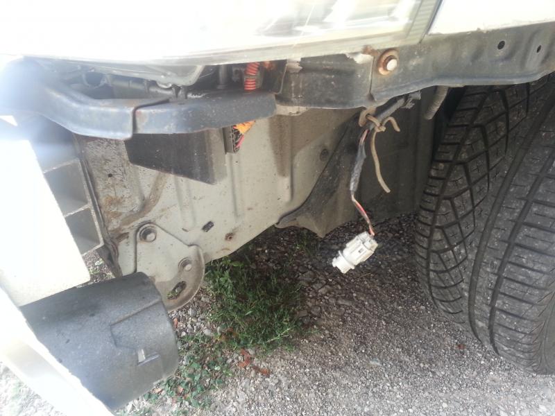

fog light wiring
Has anyone had to replace the wiring from the fog light? My car was wrecked before I purchased it and I'm assuming they opted out for the new 1300 dollar engine harness. So the wiring for the fog light is missing. I want to hope that the wiring is just cut and not completely removed because the other side fog light works. I also have the service manual with diagram but I can't make heads or tails of it. Any help is greatly appreciated.
I went with the Kensun kit on Amazon for around $65 and after reading the reviews about thin wires I decided to drill the caps rather than splicing. Problem is the wholes are about 5/8 diameter. Any one know what that rubbery stick substance that can patch the hole or have any other suggestions on how to fill the holes. I was thinking of finding some other plastic and using some epoxy to cover the hole.
Attached Thumbnails HID fog lights installation (sticky?)-20140806_134237.jpg
