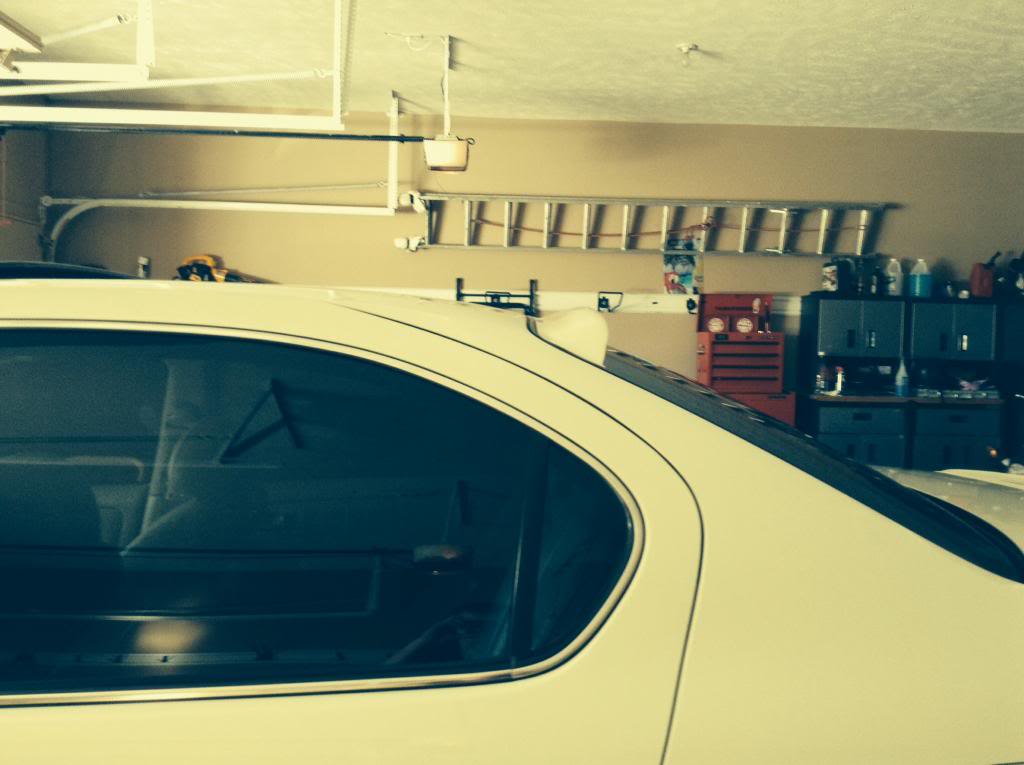

Hello I removed my spoiler to reinstall and thought of showing anyone that's interested in buying one and seeing how it looks / installation so here ya go!

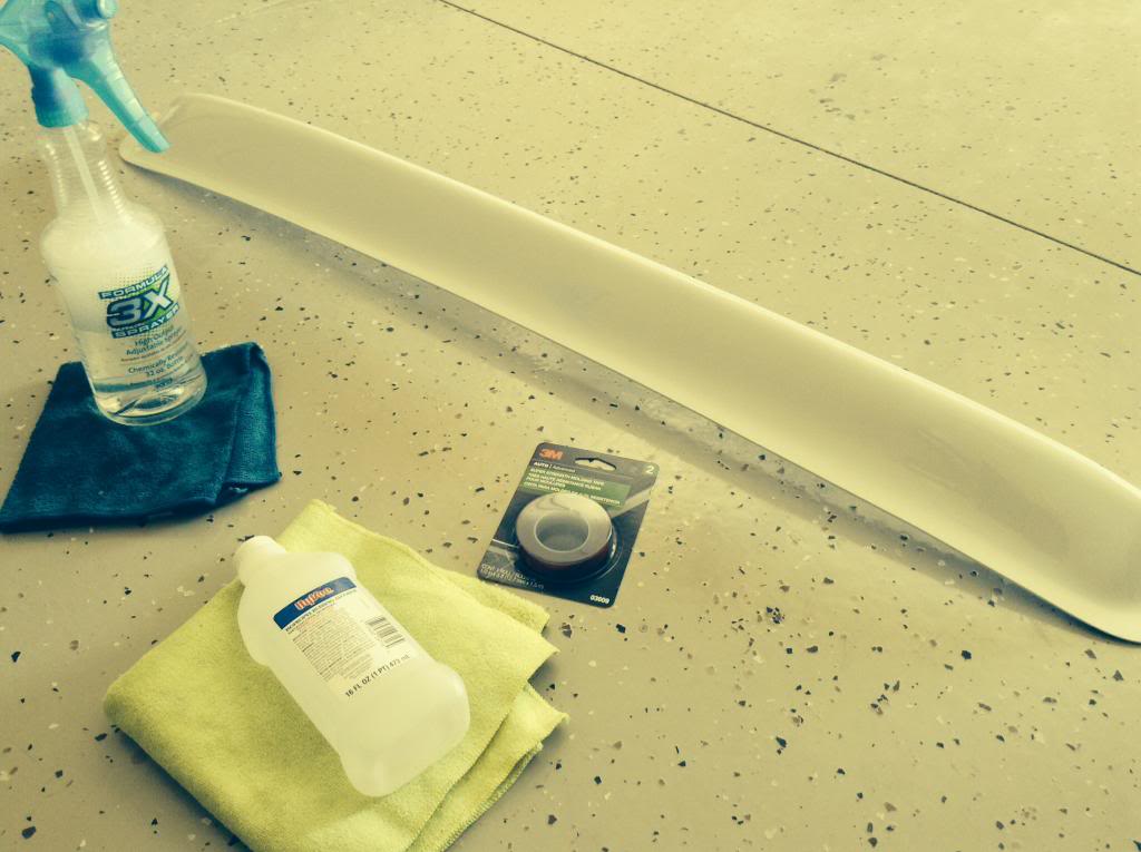

Needed items:
Roof spoiler - mines ionic dynamics
Rubbing alcohol -to clean spoiler/ surface for clean and good stick
Microfibers
And lastly red 3M double sided tape.
1. Put the rubbing alchohol onto a window surface and spoiler flat edges where tape meets window.
2. Apply 3m tape to spoiler flat surfaces.( I put two .5 inch ones of each side and a single long one across the top)
3. Get another friend to help you line it up and set down(don't press down in tape until it's perfect) then apply pressure.
4. Have it sit in 60-80 degree weather for 24 hours for best bond.

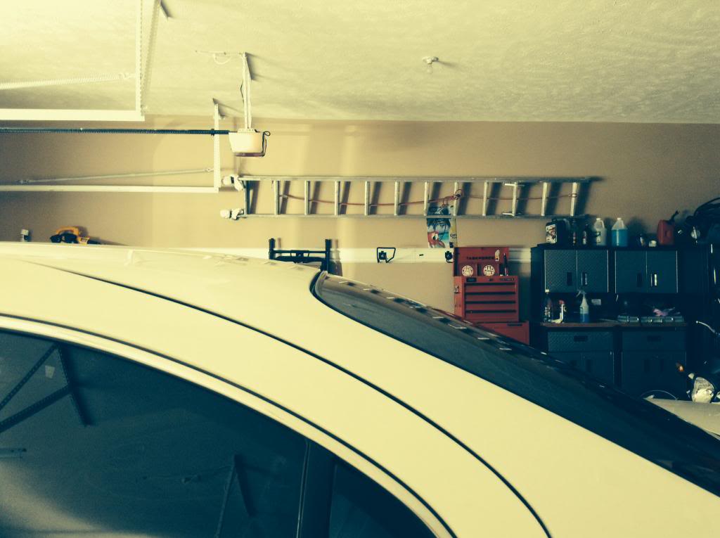

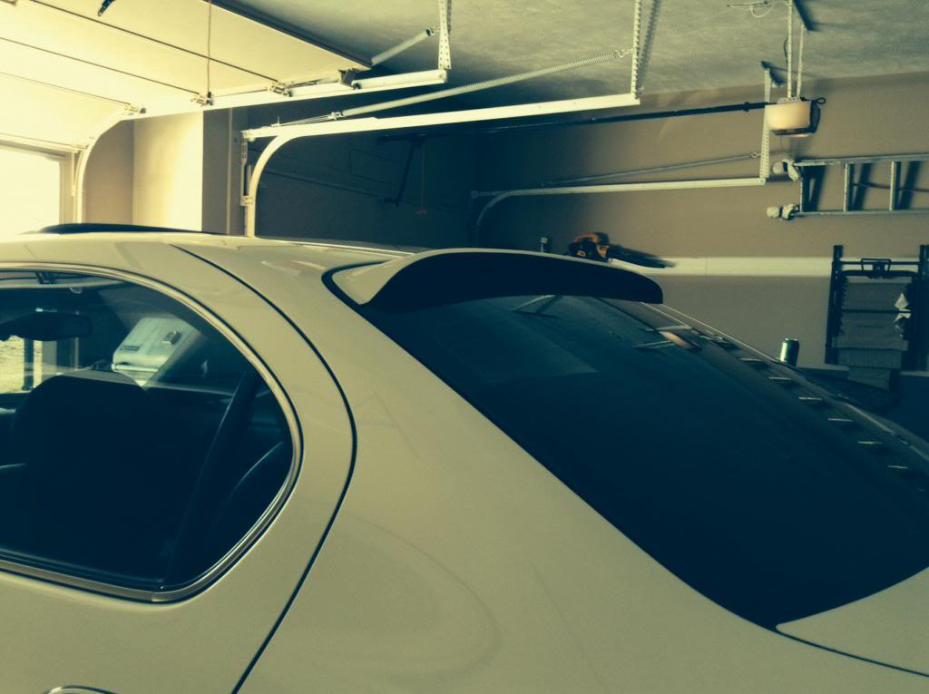

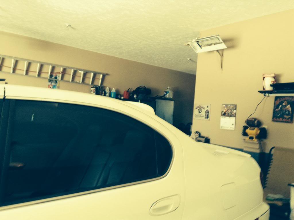

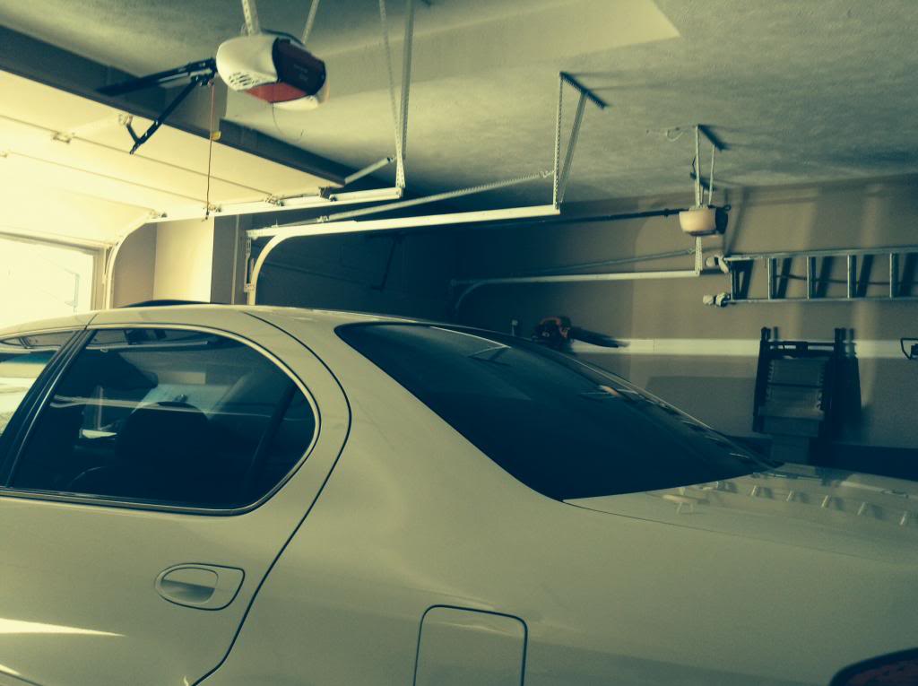

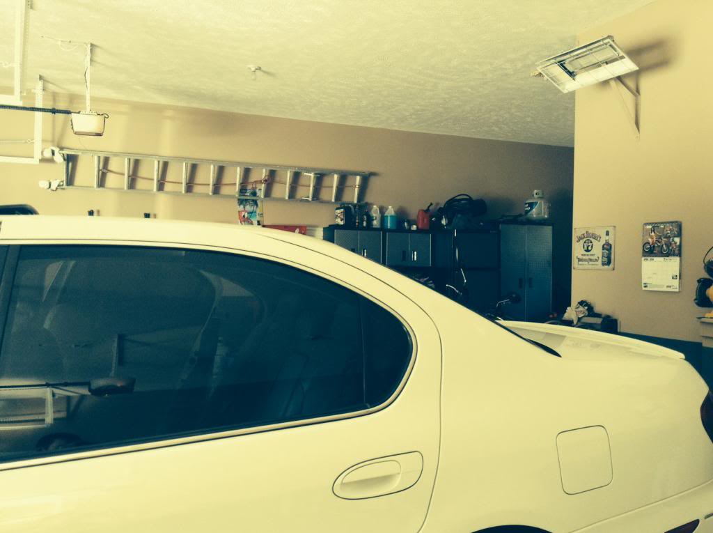

BEFORE AND AFTERS
