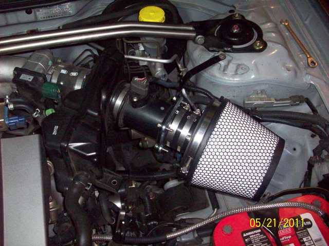

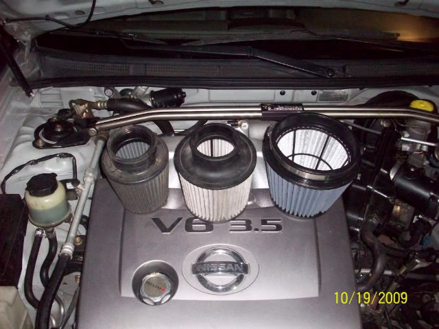

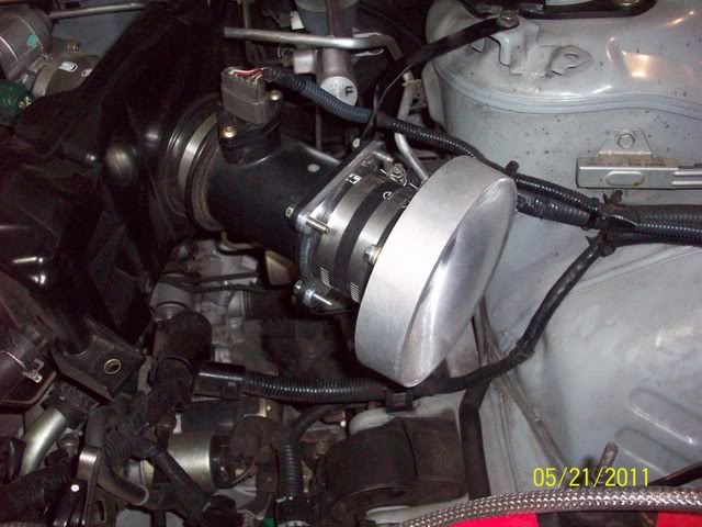

Here's some of my Intake setups, but remember the OEM intake is short! Look inside your airbox, that small velocity stack is where it all begins!!!! You can construct your own but I would definite incorporate the 6" air filter design! They simply flow better!!!!
Setup No.1 (AEM DryFlow/ MAF Adapter)
Setup No.2 (AEM 6" DryFlow filter/ Vibrant Velocity Stack/MAF Adapter)
Setup No.3 (JWT Popcharger/R2C DryFlow Air Filter)
6" Air Filter flows Easier!!!!
