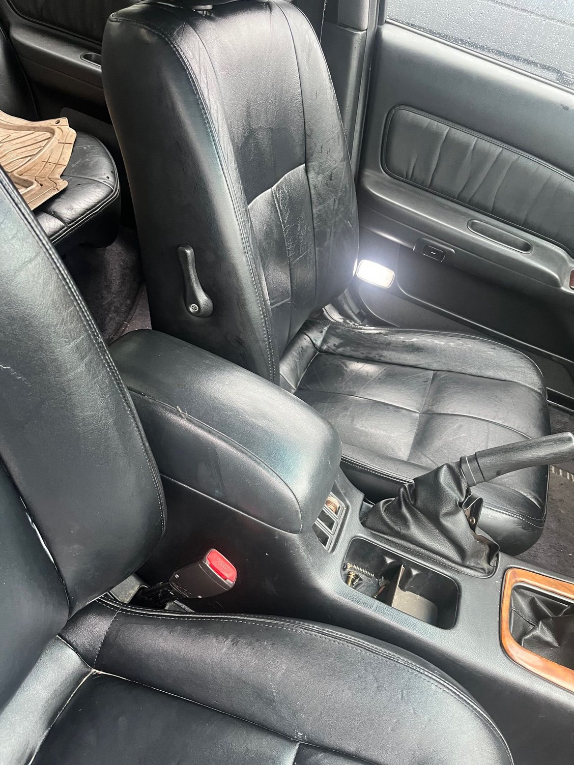

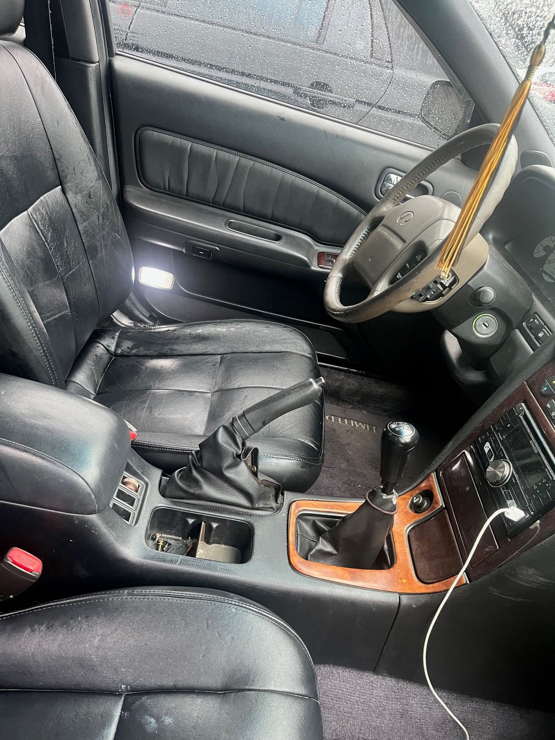

Finally found Black leather seats
Hi All,
Did some work on the car this weekend because a 1996 I30 finally showed up at the local yard. It had decent black leather seats (heated). So I grabbed them and the switches and wiring for the heating elements.
Put them in yesterday and cleaned and conditioned them today, they need some more work but it is on step closer to a complete black interior. I just need to put my steering wheel in. (I need to convert from a 1996 to a 1999) And put a matching shift bezel in.
The passenger seat has some dents and imperfections but its pretty decent, they are much better than the torn beige seats. I also grabbed the plush A pillars, now they all match.

Did you wire up the heated seats yet? It's on my to-do list for my car but haven't gotten around to it.
Not yet, I need to go get some longer wire, I only cut a few inches of the wire from the connectors.
