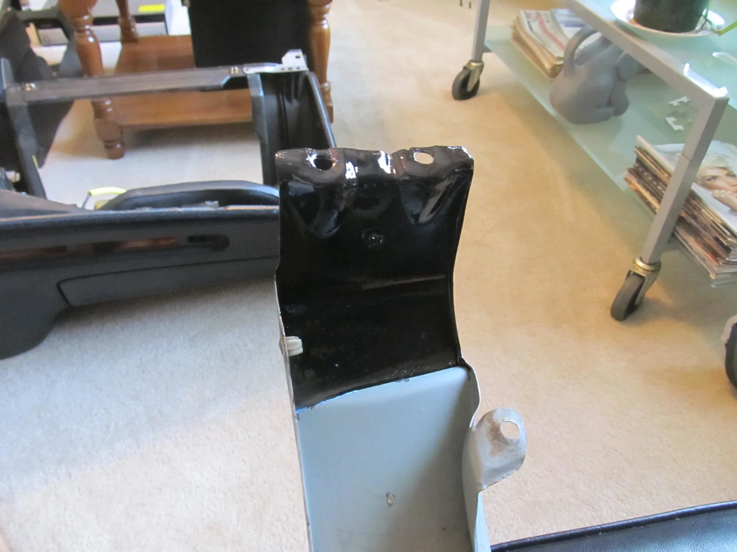

Went to the yards today. Unfortunately my quest for a bumper and fender alluded my once again. Both cars were the wrong color so I decided not to grab them right now although one does have the spoiler but the rest of the trunk is damaged.
anyway I finally found the I30 front and rear mud flaps. Although I couldn’t get the passenger side because it was missing. But I got the rear ones and that’s what I was looking for. The car looks pretty neat with them on.
I also grabbed a new AAC unit to see if I can get the illumination to work. As well as new blinker housings because my ones had no rubber around them anymore. That is an I30 specific fit part different from the maxima so they are hard to come by

So I have been having water intrusion for years on the drivers side A pillar and floor. So today I pulled the mud flaps off and pulled back the fender liners and there was loads of mud and leaves in there. It was caked up all the way up the finder. Water was having a hard time escaping obviously. Cleaned it all out and put the flaps back( now they can actually do their job. When I put them on last year a neglected cleaning it out beforehand.
I still might need to pull the headliner and clean the sunroof drain tubes, but we will see. I also put some silica granules inside to wick the moisture out of the cabin.
my passenger side fender is completely rotten where all that dirt was. The trapped water just ate through the fender.
This was just the first scoop. I pulled out piles on both sides.

Washer Fluid Indicator Light...
So I swapped out the dang washer tank for one with a fluid indicator. Wire and plug are already there. it is nice to see an indicator light for this, but it is not worth the hour I struggled getting the stupid top bolt out. It would not turn.
I was already in there today replacing my dang fender, I will post about that, but I am frustrated as you will soon see.
Oh and I have a massive oil leak I need to address, I guess 200k will do that.
My moment of victory dashed by the pesky CEL with Evap codes I cant pin down
