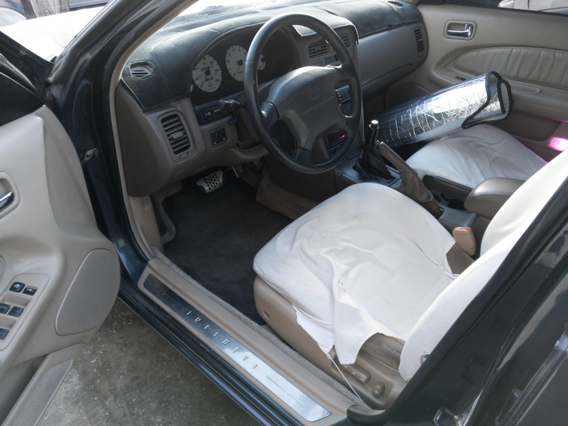

Some pics of the car below, I'll be sure to add more soon! I'll be updating this post with a imgur gallery in the future with up to date pics with the I30 along with some (hopefully) beauty shots of the car!

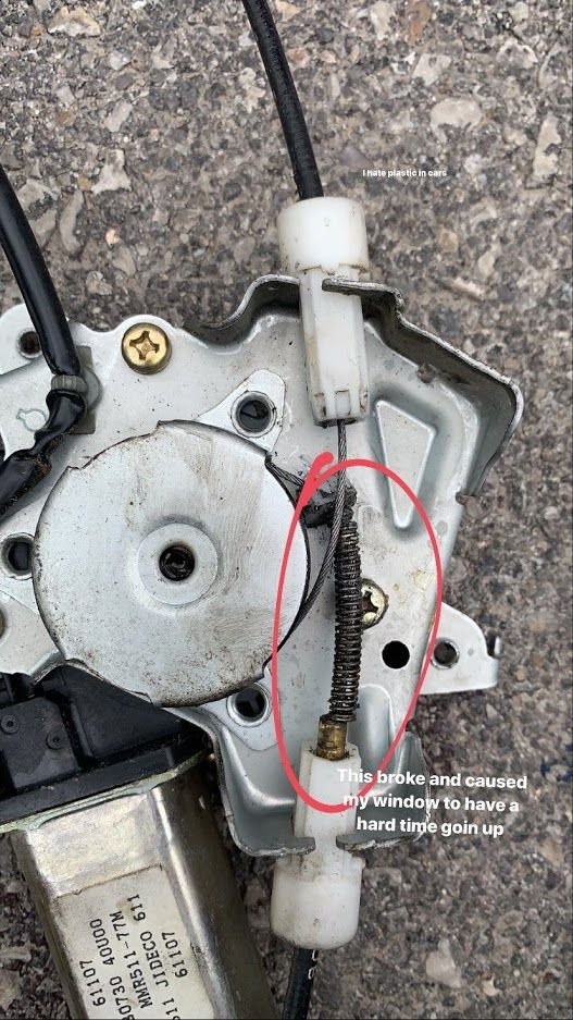

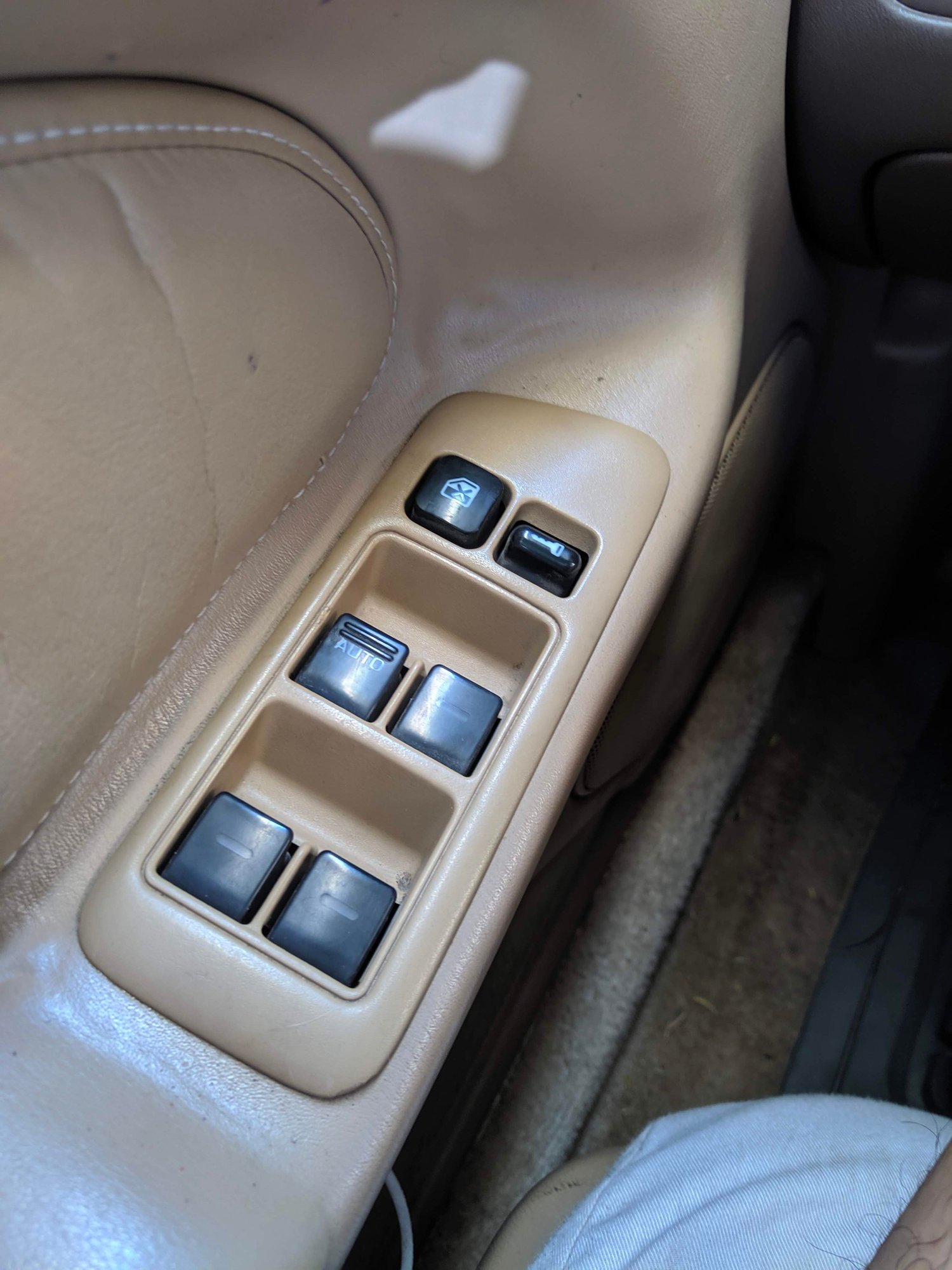

Well not much of an update but I just recently replaced a broken window regulator and got one for the front passenger window. This is the second window regulator I've put in for this side, plastics keep breaking and what not. Anyways, here's a pic of the broken piece that was part of the regulator, window motor was fine, so I could reuse that. Pic is from my Instagram, same as my username here :P
Did also learn recently while going through the forums here to lubricate the regulators with some silicone grease to help with wear and what not.

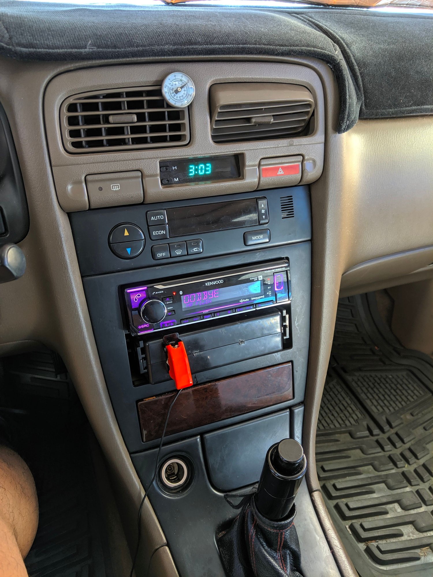

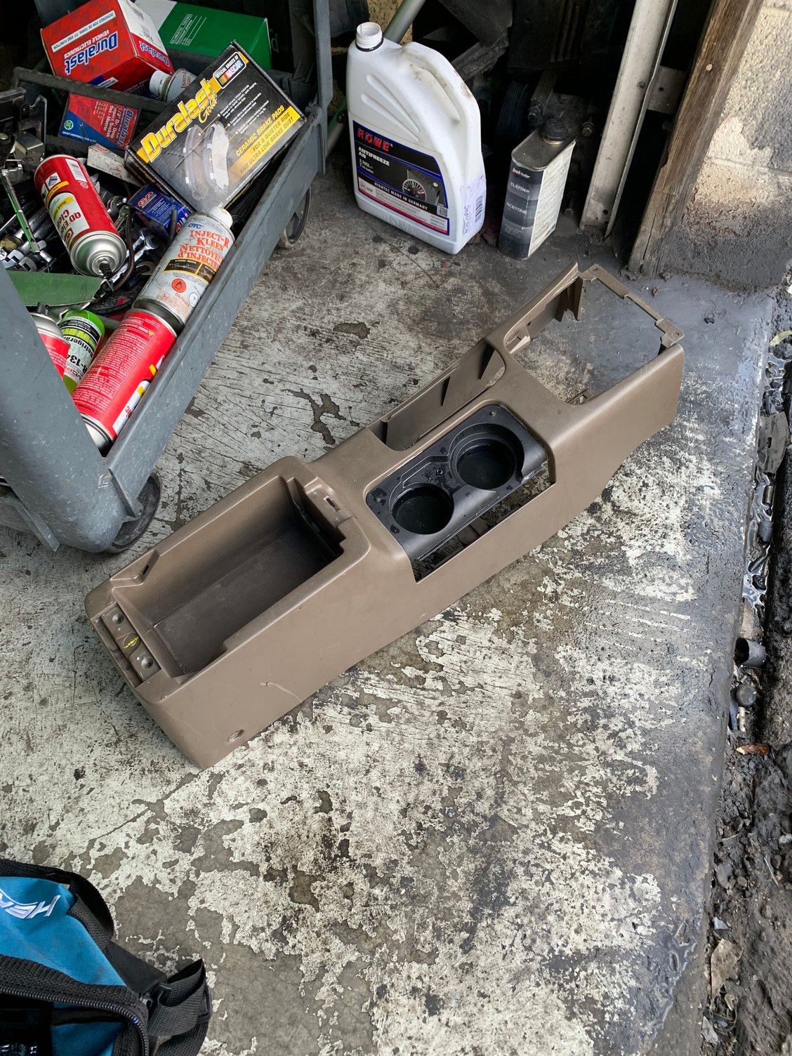

Picked up a new center piece that surrounds the shifter and handbrake. Couldn’t find a decent arm rest from the junkyard that wasn’t ripped, so I used the old one. Don’t have heated seats so it doesn’t bother me too much.
EDIT: Forgot to mention my old one didn’t have the flip cover for the cup holders.
Got some pics:
Old Mar 22, 2020 | 08:14 PM
schmellyfart's Avatar
Posts: 3,816
From: AZ
I like how you flipped the single DIN pocket around to mount the switch, very clever!
Thanks bro, pretty much I didn't want to drill into any of the other pieces and it ended up being a really good place for it.

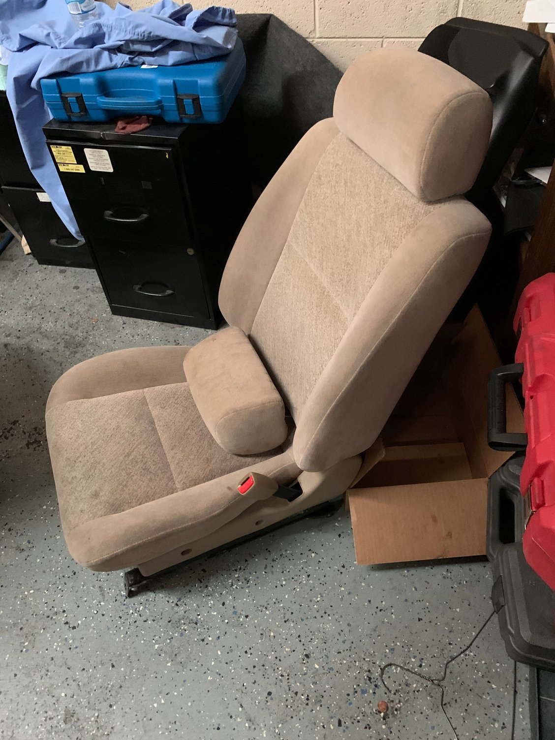

Stumbled on a standard i30 at the junkyard today and managed to pick up the passenger seat and both headrests. The i30 had cloth seats with headrests on the back, but as I did not own the proper seat covers, I decided to leave the rear seats and just take the passenger seats.
Will post pics on here later when I get the chance
EDIT: Added pics. The driver side headrest is in the middle. Haven’t installed them since I want to clean them up. Aside from that, I’m curious if it would be possible to transfer the cushions from my old seats in to this one. Only reason is so that I don’t have one front seat with a pocket in the back of the seat and one without. I have the SE power seat for the driver but manual for the passenger.

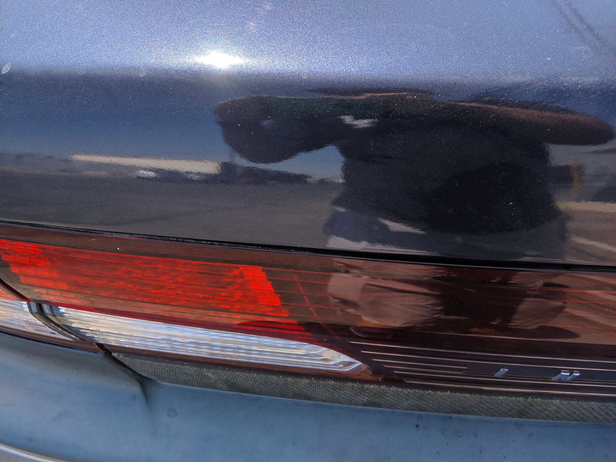

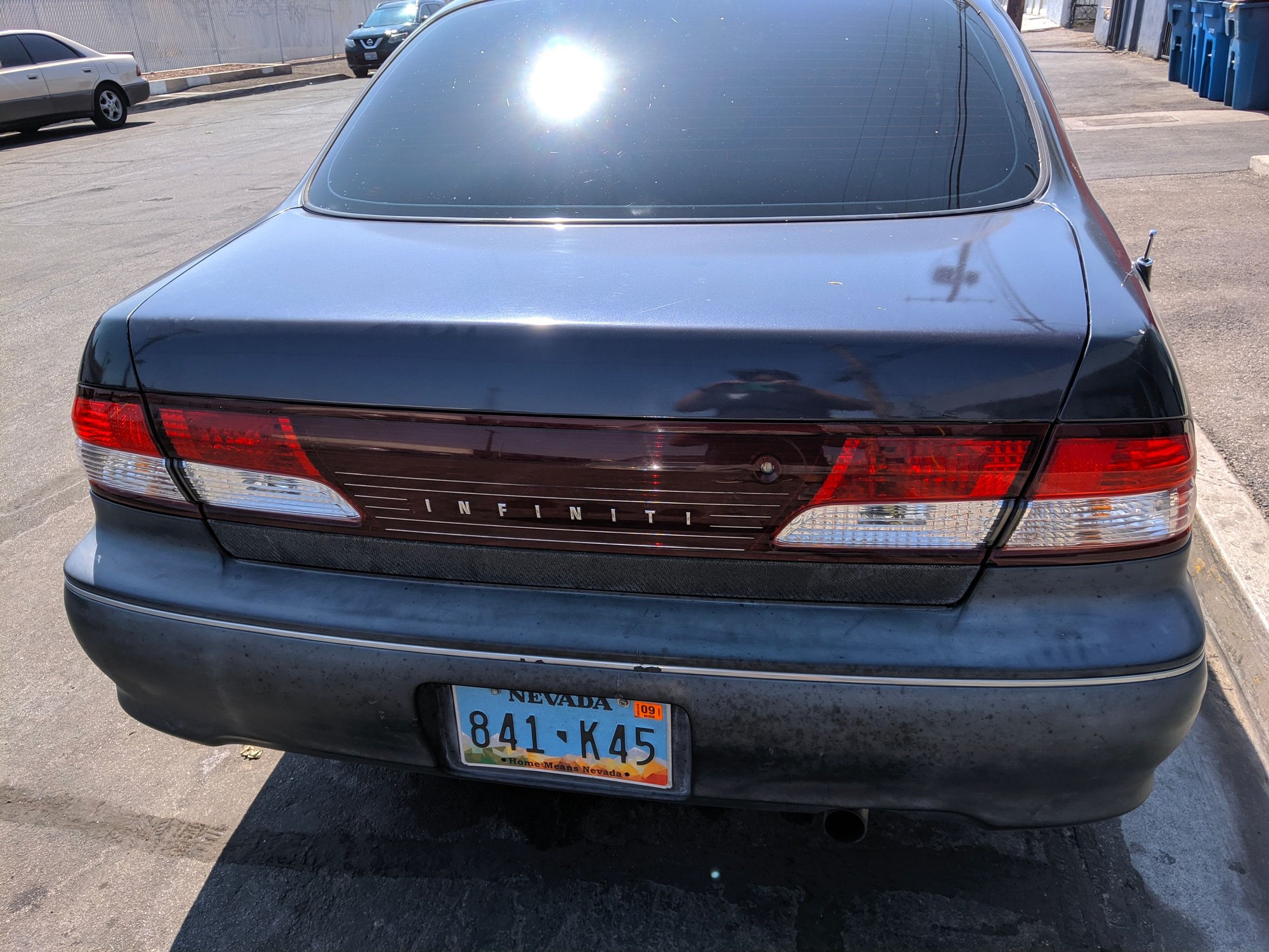

New trunk tail lights
It's been a while! Anyways, went to the junkyard today to pick up a new mode door actuator since mine kicked the bucket and found a really good condition 98 i30 that just arrived. Headlights were already taken but I managed to get the trunk tail lights.
I gotta say, it really changes the look on the back of the car and all I really want now is the i30t trunk with spoiler. At this point just finding one is good enough since my paint code is super rare.
Just one small issue and I'm not sure if it's just me not installing this correctly, but the light looks like it bulges out a little bit and the keyhole isn't flush with the lock. Any input is appreciated!

Wait a minute! Those tailights just plop in! I was wondering because I have passed up so many spoliers and trunks because I thought they wouldnt fit the 97. I am glad I know this now haha. and as for the buldge its not bad, but its there. How do these go in, maybe there is some room for ajusting
Sadly I don't believe there isn't too much room for adjusting them as they are clipped in before screwing down the nuts. As for taking them off, it's very straightforward:
There are 4 nuts on the outside of the trunk on the edge and 5 nuts under the lining. They are easy to see and get to using an 8mm socket with an extension. After that, all you really need to do is unclip the tail lights by prying them, although be careful bc they could crack. Using an angled pry tool would be the best way to remove the tail lights, although if they haven't been taken off before, those clips are gonna be on there very tight.

The 98-99 I30 center tails are known for having that problem. All the ones I see in junkyards have the same issue. If you compare them to the stock one you pulled out, you will see that the outer portion (rear portion) of the light is bowed out. I had to fix the one I got when I installed them in my car like 10 years ago. I fixed it by heating them up and pressing the front and back together. You have to be careful to not crack the lens when you do this, it's thin and won't take much pressure. I was able to find a before pic of my light:
You can see how the little tabs are no longer in their pockets. You need to squeeze them back in there. It's probably too big to fit in an oven, but depending on how hot it is out there, sticking them out in the sun on some tarmac plus a heat gun may suffice. Just be careful to not crack the lens!
I see, in that case I'll definitely take another shot at installing it again on the weekend while I work on getting my mode door actuator replaced. It gets pretty hot here usually still 100+ fahrenheit, but I'll have a heat gun just in case that isn't hot enough. Thank you for the tip! I appreciate it a lot!

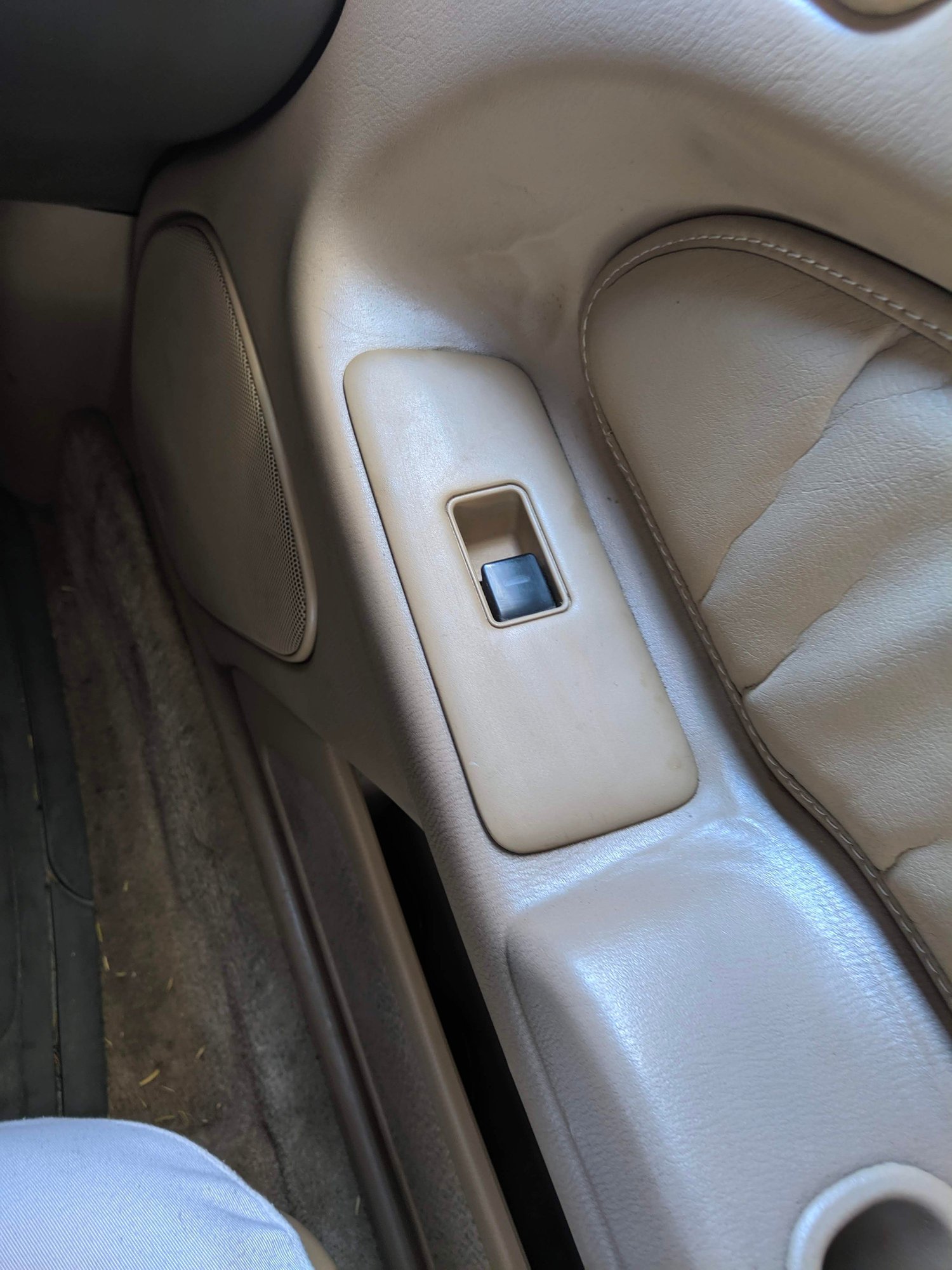

I had no idea that the AC controller had bulbs in them to light up the buttons as I found out. I’m planning on swapping them out with LEDs but I’m not sure what size they are. My4dsc says Neox 4mm bulbs but they showed the 98-99 AC controller so I’m not sure if they are interchangeable.
I also grabbed all the window switches as well since I was in the process of removing the wood trim pieces. All that remains is a new steering wheel again :P
The pics (completely forgot I didn’t show off the new steering wheel):

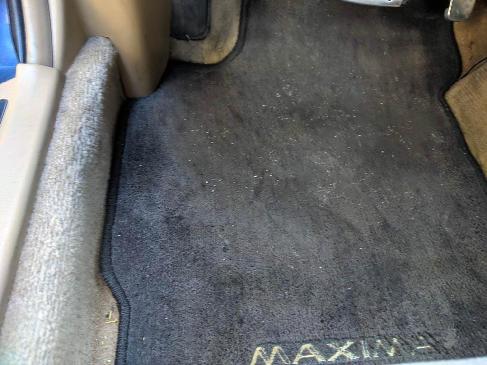

I also got Maxima floor mats in black which I was not expecting to match with the dash cover I’ve had since owning the car. I got the full set so it’s really nice, especially after giving them a good clean. If I ever find I30 carpet floor mats in black I will probably pick them up. The only carpeted floor mat before these were the rear I30 ones. I just put the Maxima ones over them to go with the fronts.

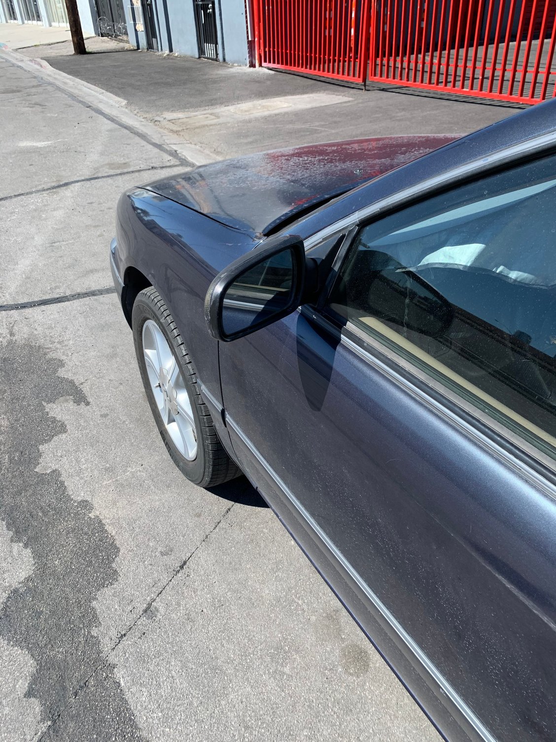

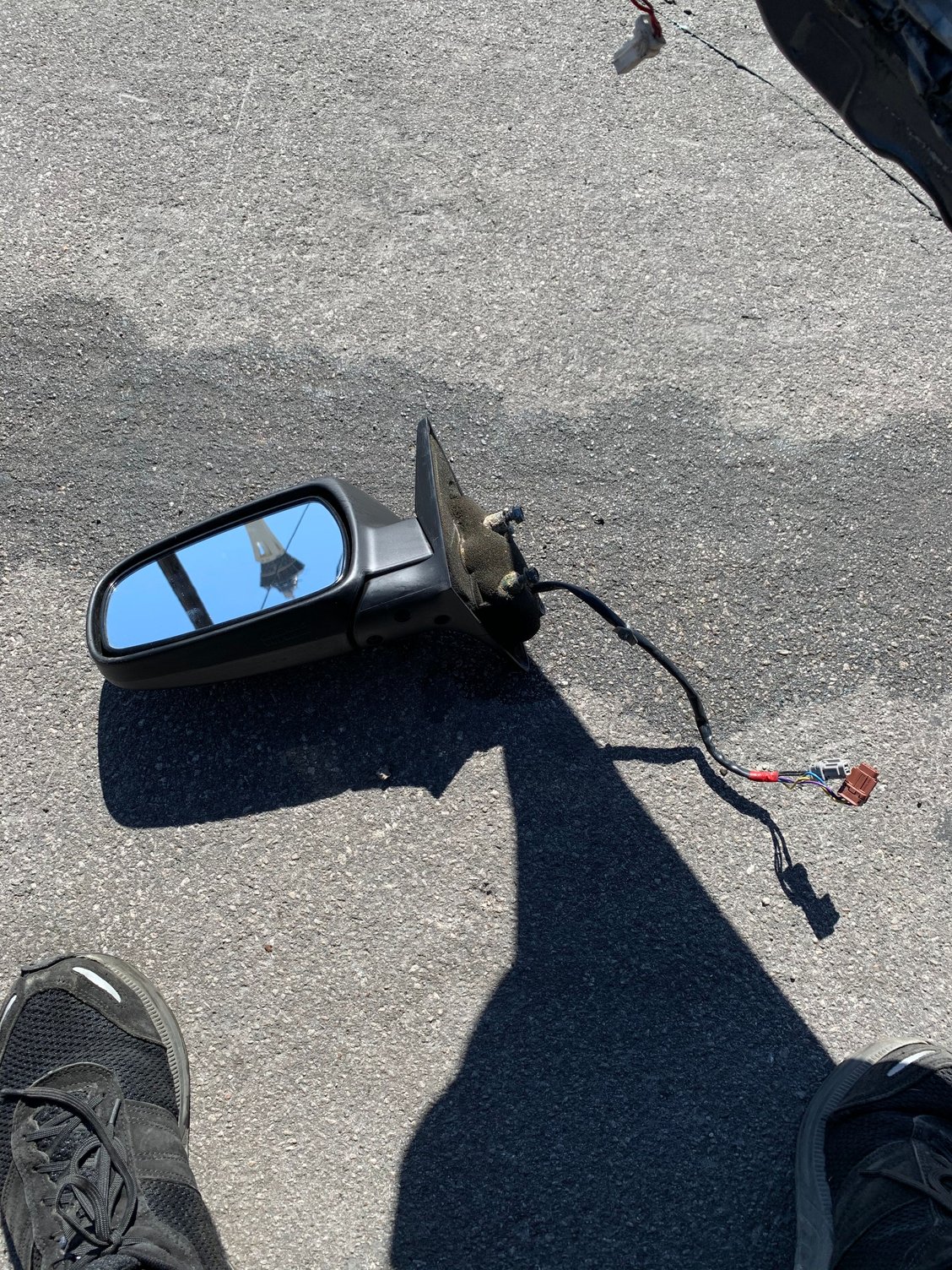

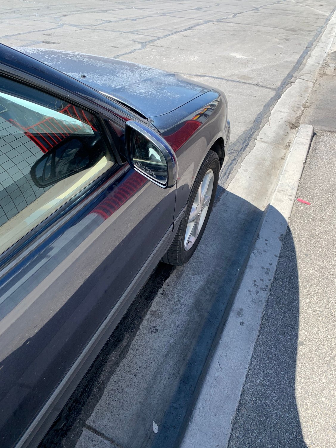

[QUOTE=FQuimson23;9219234]I recently managed to stumble on a couple Maxima’s and I30’s at the junkyard with the cold weather package. Most of the Maxima’s and I30’s had their heated mirrors removed already but I got a matching passenger side mirror for my I30 from a Maxima and I also got the driver side from another.
From what I saw from other I30’s and Maxima’s, it seems that the all I30’s are prewired for both the heated mirrors and washer fluid indicator (Maxima’s only prewired for washer indicator).
The only thing I didn’t get were the heated seats. I prefer the cloth seats :P
Pretty much plug-and-play with all the things I bought.
here are some pics:

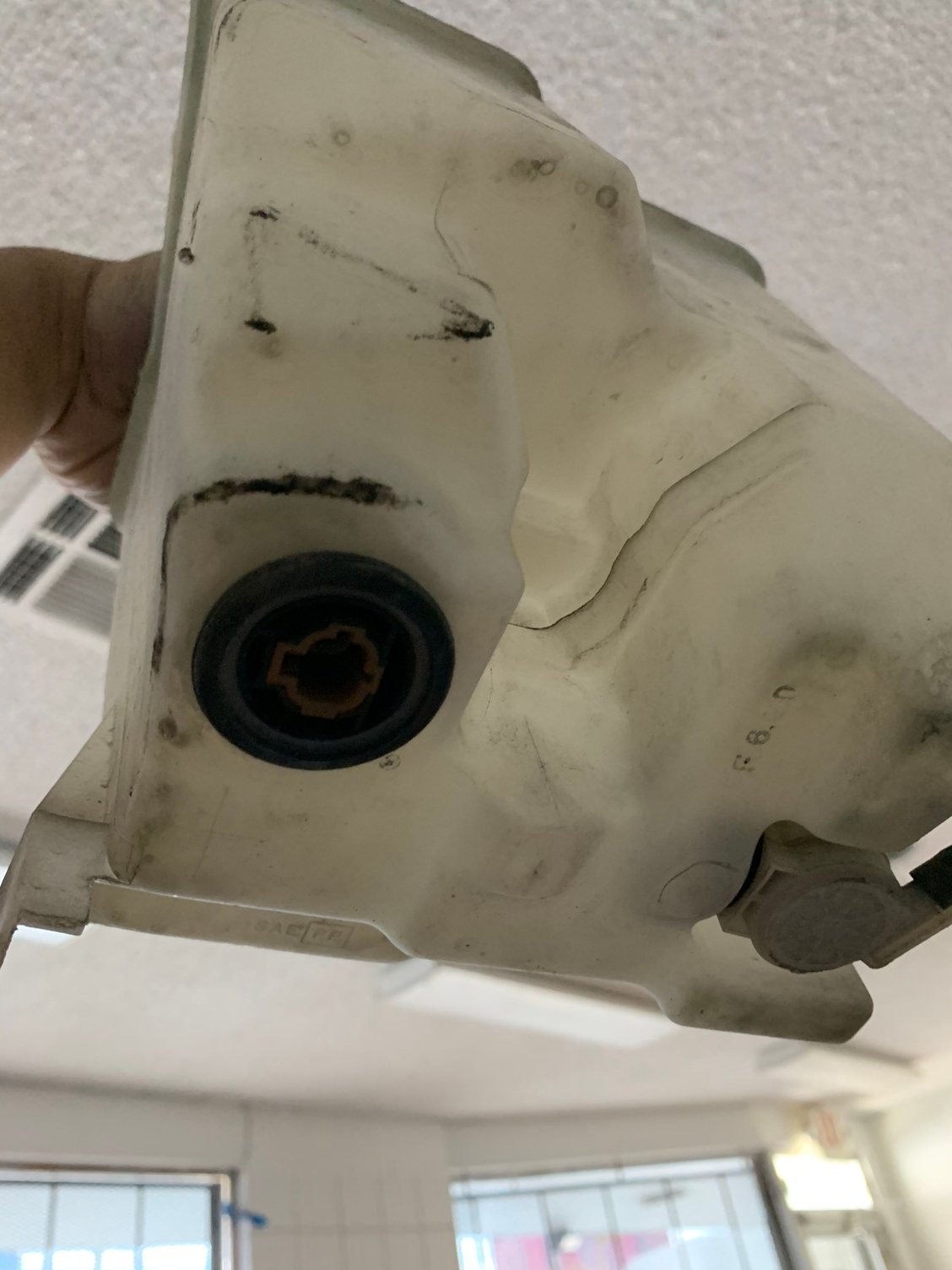

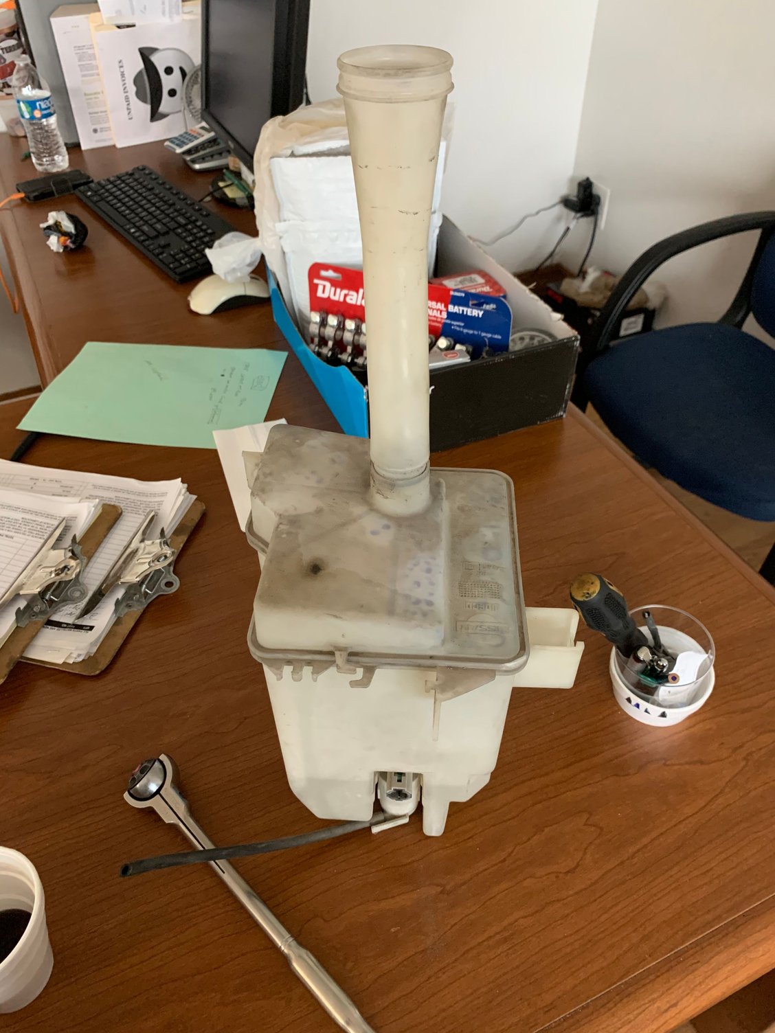

I have yet to find a washer tank with a fluid level indicator, albeit I dont think to check often. Are the wires just tied up near the tank?
Yes, the wires for the washer fluid level indicator is taped up nearby. IIRC, all Maxima's and I30's are prewired for this, regardless of trim level. I do not have a picture, but there will be a wire that is taped on itself with the connector at the end. You will also most likely need another instrument cluster bulb holder as I did for the indicator, it's the same one as all the other lights for check engine, abs, etc. Don't think you need anything else aside from that, however I will note that I have yet to see the indicator light up as it doesn't appear to light up when the ignition is switched on. I would strongly advise keep the new washer fluid tank empty with the sensor connected and with the proper bulb installed to see if it lights up before filling it up.
My cluster has a bulb there for it. Maybe I already have a tank there that has the indicator. Never checked
Maybe. It is possible that I could have used the bulb in another slot or cluster before since I have 3 of them, and that's why it was missing on mine. But its never a bad idea to have spares

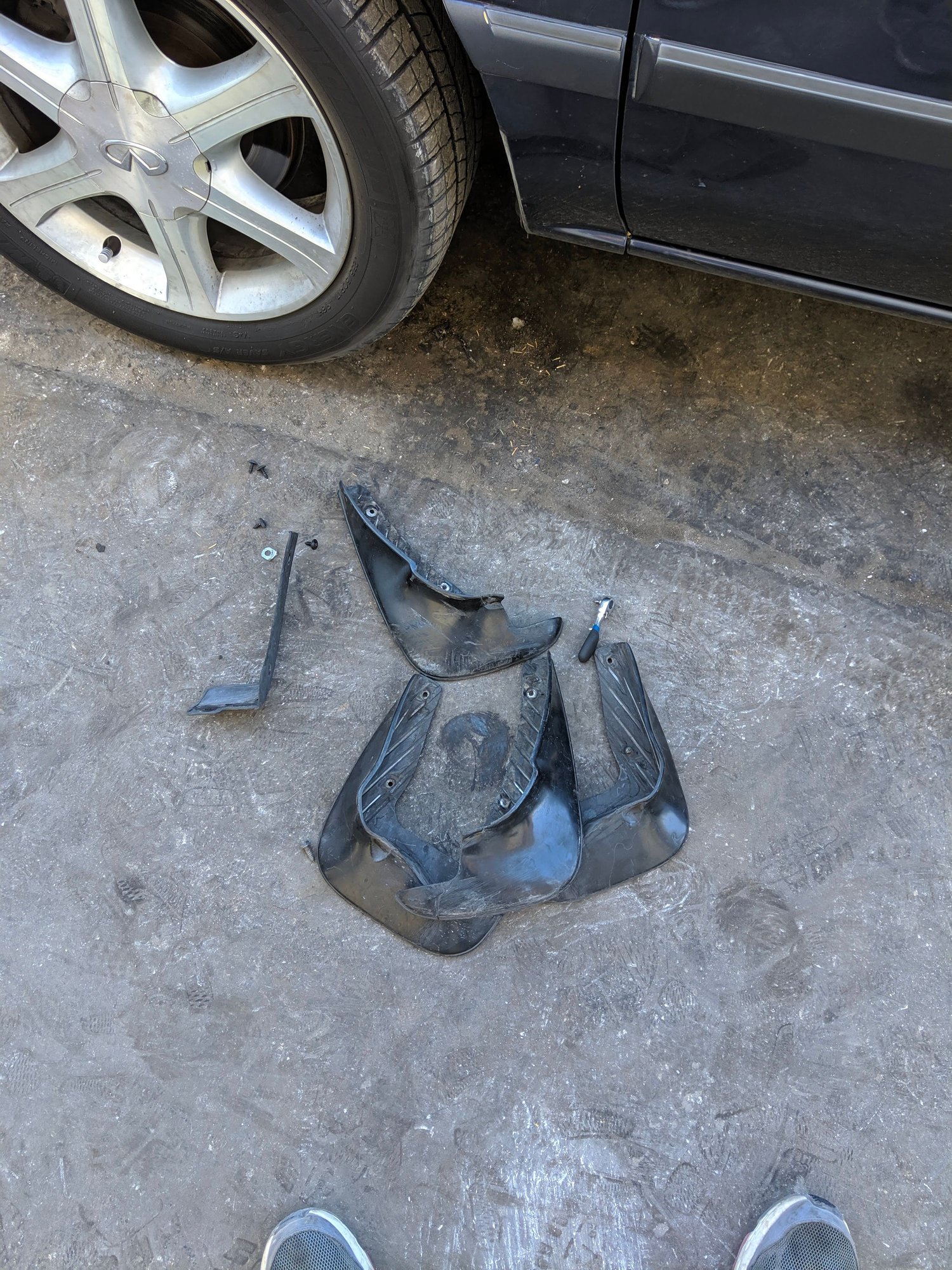

After that whole mess, I also picked up new floor mats (again) and mud flaps. There was a 95 I30t Manual with pretty much every option on it in the black interior. Gotta say I was surprised to see that there, although unfortunately the trunk was mangled because someone tried to get in from the outside. The floor mats are about on par with condition of the Maxima ones I picked up, maybe a bit better since the "Maxima" on the floormats are really worn, but the rear floor mat is amazing, I can't wait to replace my tan ones with this one.
And finally the last bit and most recent pickup was the mud flaps for the I30. Mounted very easily on the fronts, rear was a bit awkward since the holes were not present on my bumper for whatever reason with the exception of the bottom screw. Maybe aftermarket or something? (Update below) But anyways I was able mount them perfectly after drilling the holes in.
