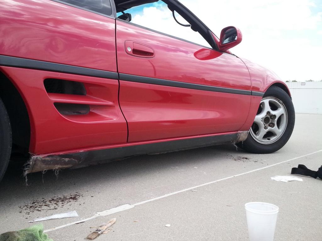

So if I didn't post a picture of it before, there has been rust developing on the passenger side rocker panel of my car. It's decided take big bites out of the front and rear of it. Fortunately, my friend Dan was nice enough to help me apply fiberglass on top of it. We just finished this 10 minutes ago, will go back in 40 minutes to put black plastidip on it.
Looking forward to how it turns out!
MMmmmmmm YUM
Cutting and test fitting:
Finished the front, grinding down the rear to the bare metal:
Fiberglass applied:
As it sits now.
Should harden soon, then plastidip time
MMmmmmmm YUM
Fiberglass applied:
As it sits now.

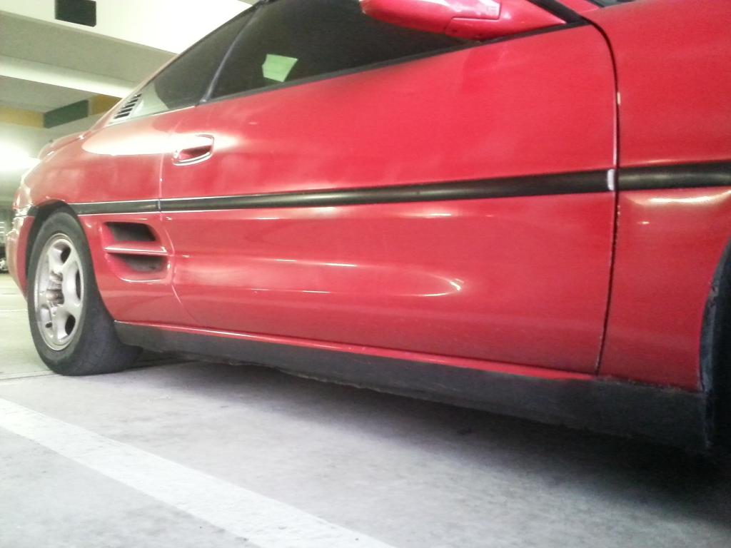

Finished it just now. Sanded them down, and sprayed plastidip over it. MUCH better than what it used to be.
Huge thanks to Dan for giving me his fiberglass and his time.
Sanding it down:
Sprayed:
Sanding it down:
Sprayed:
Done:
Before
After
Definitely one of the coolest things I have ever done to a car.

as cool as that is, will it prevent rust from coming back? def cheaper than cutting up the car and cutting in new pieces. too bad you can't sand it down any flatter, looks better than the rust for sure. i would paint the whole section so it matches better.
Time will tell but we did a through job of grinding that area and the surrounding to the bare metal and doing several coats of rustoleum. Yeah I should paint the whole thing eventually but I've been lazy. Besides it's not too noticable
Hope that is the case for my car as well. There is a little bit over the rear wheel wells, so I will get some clear rustoleum and apply it on their using a Q-tip
i just wouldnt wash it with high pressure where you fix the rust, we fixed the rust on my Silverado at the same time and if i use a pressure washer too close to the paint where the repairs were it flakes off a bit
