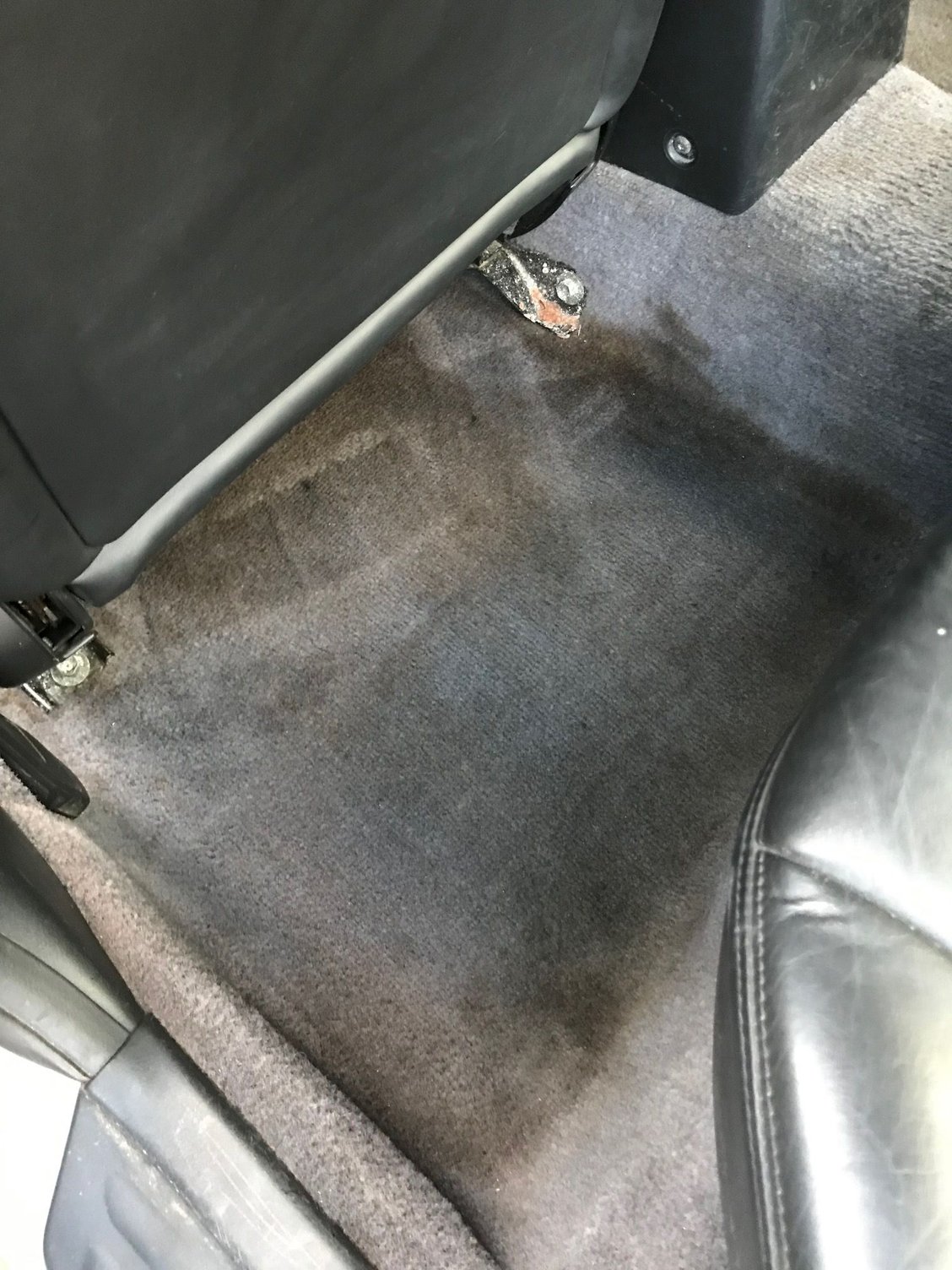

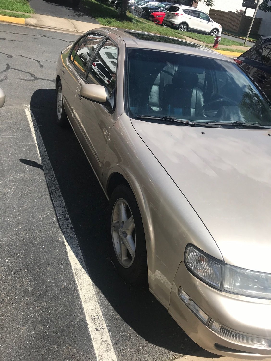

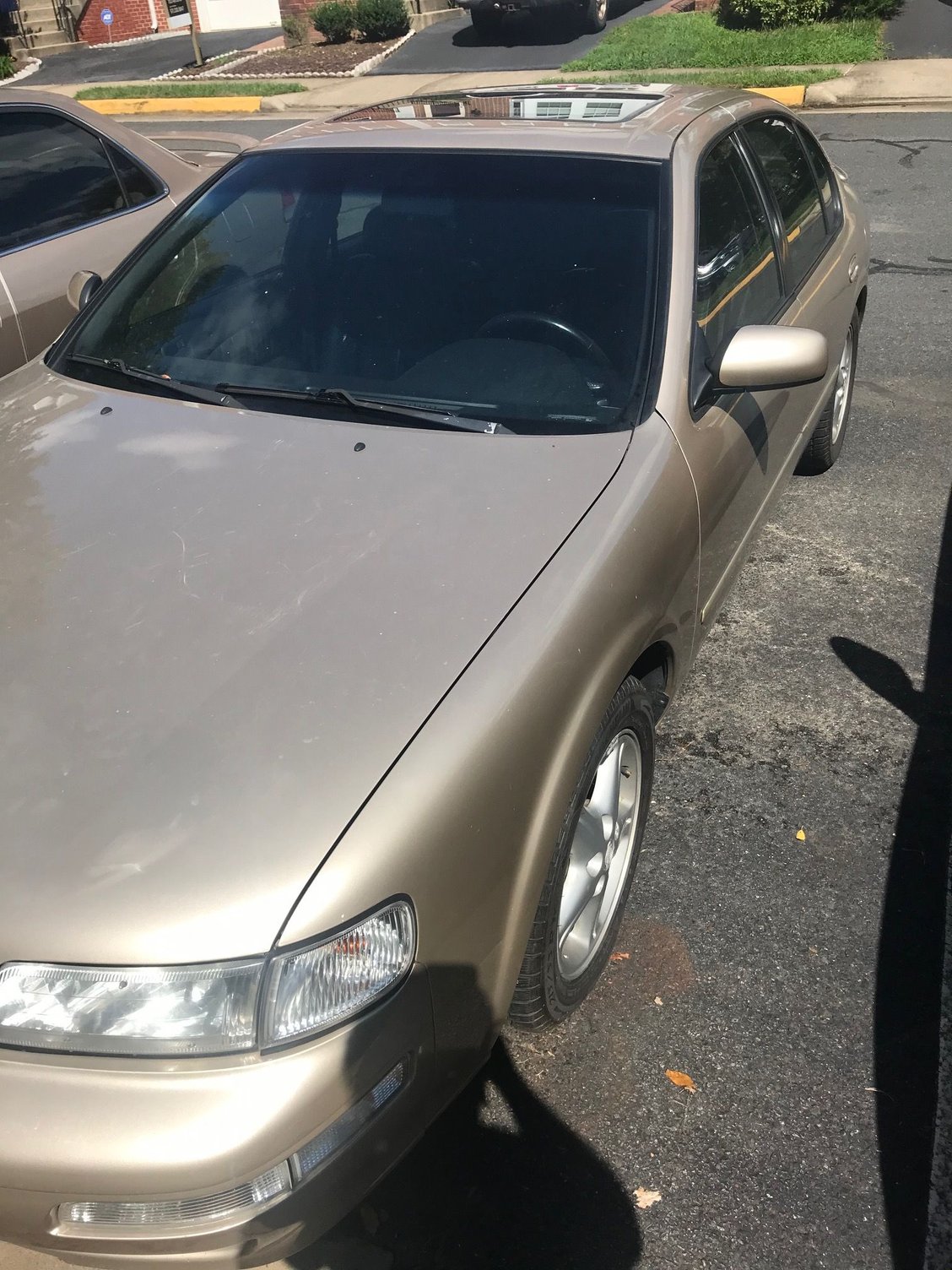

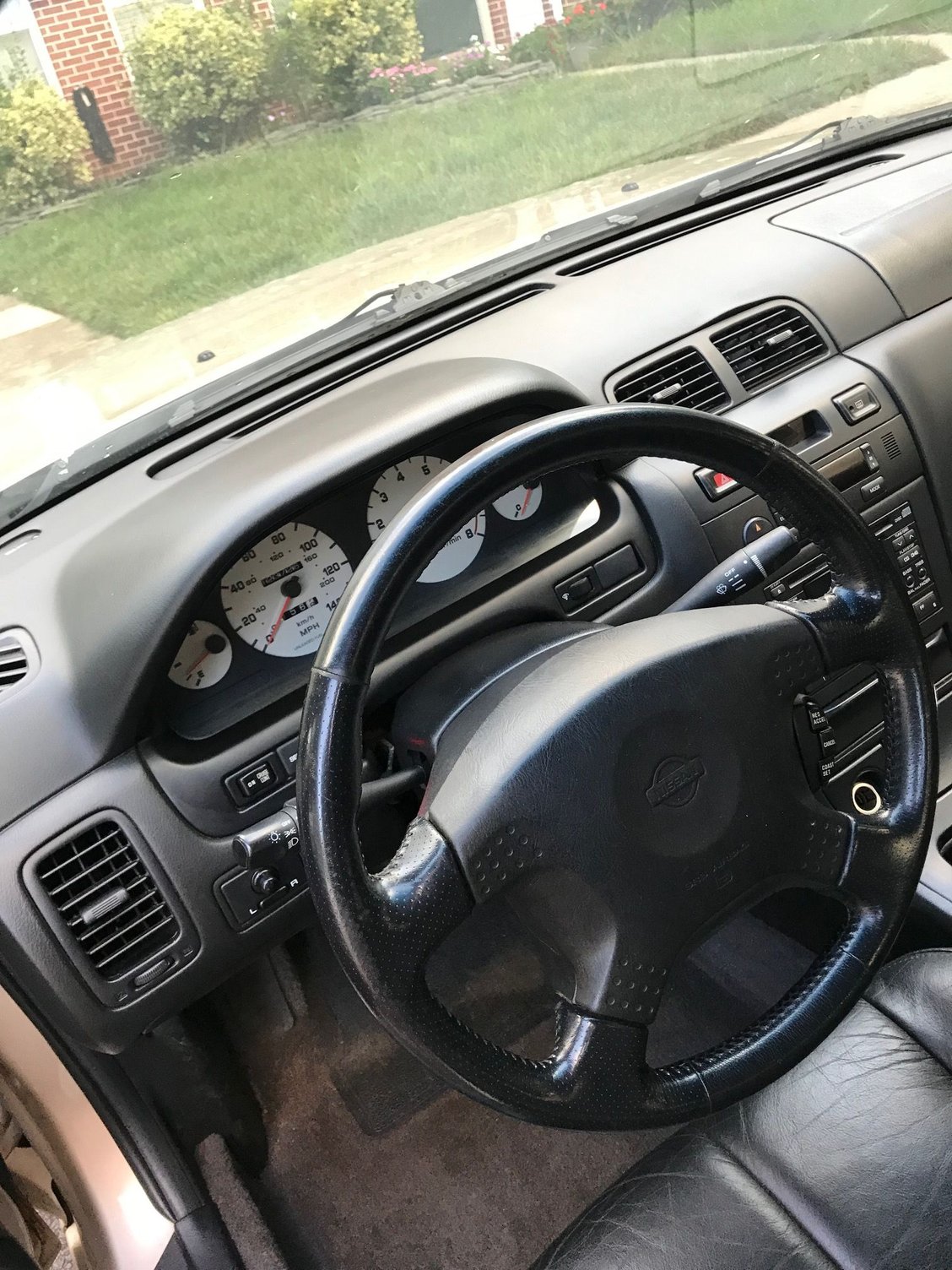

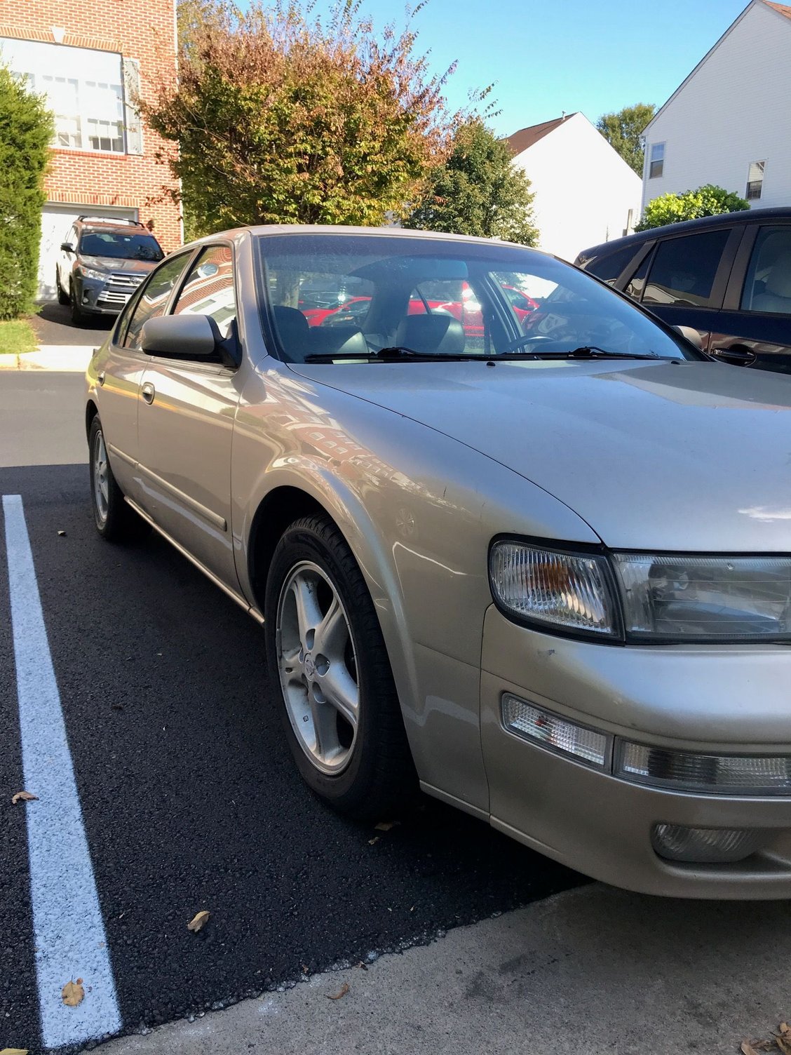

This is how I got it

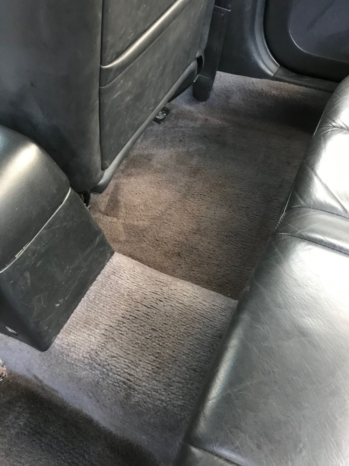

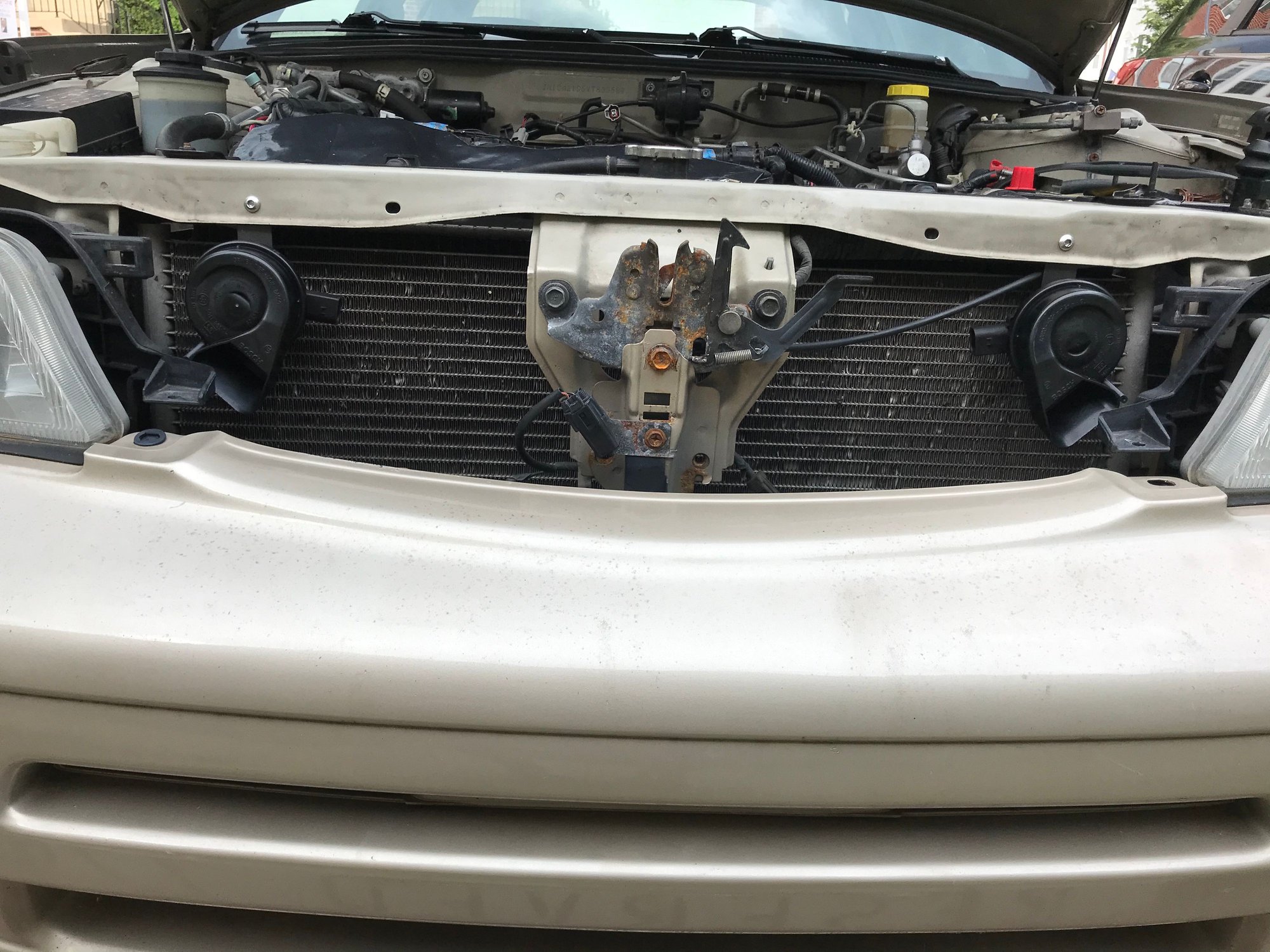

Test fitting front lip

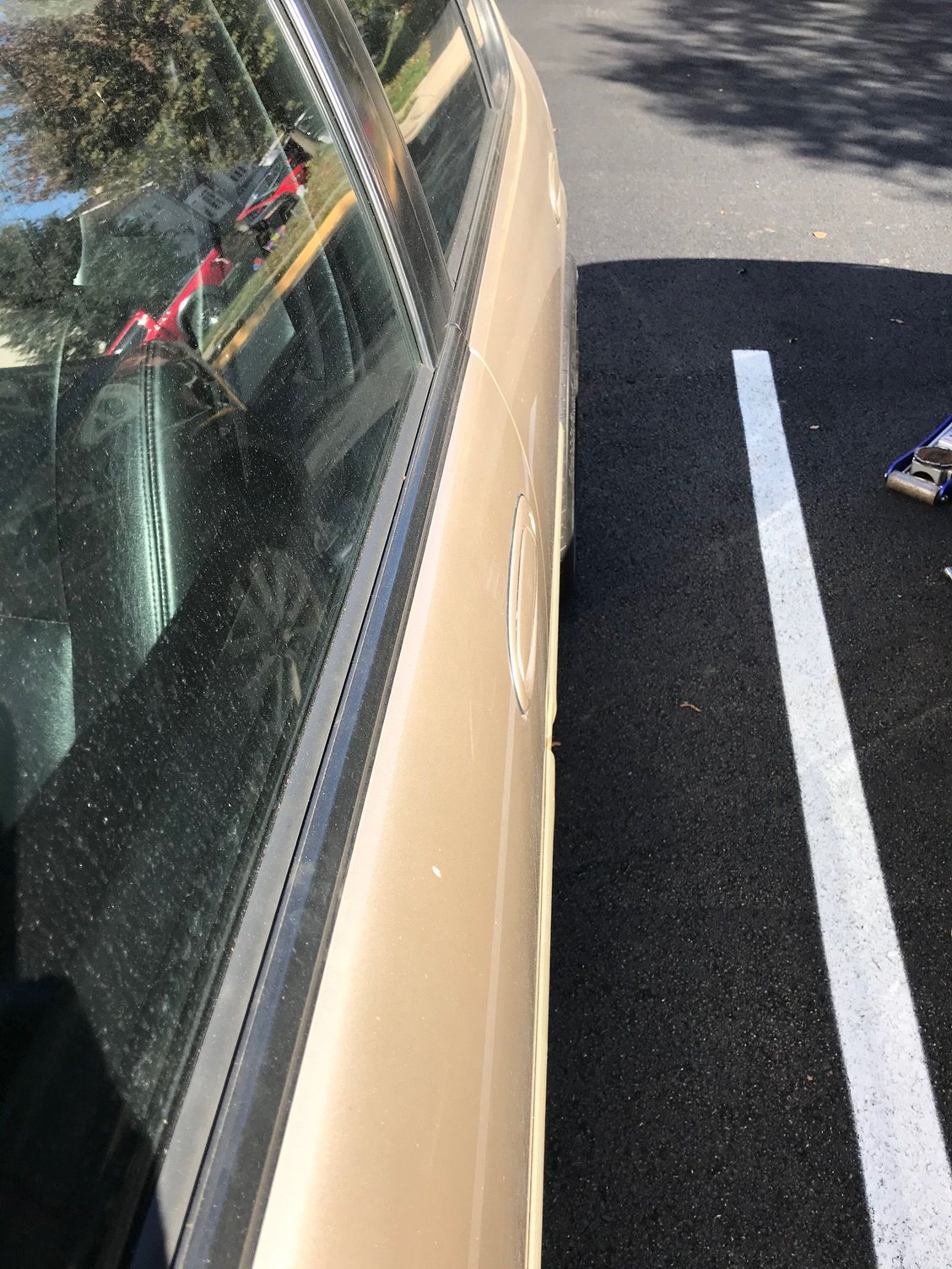

Cleaning it up
Cleaning it up
Cleaning it up
Cleaning it up
Cleaning it up
Cleaning it up
Cleaning it up
Replaced antenna
Cleaning it up
Still need to shampoo

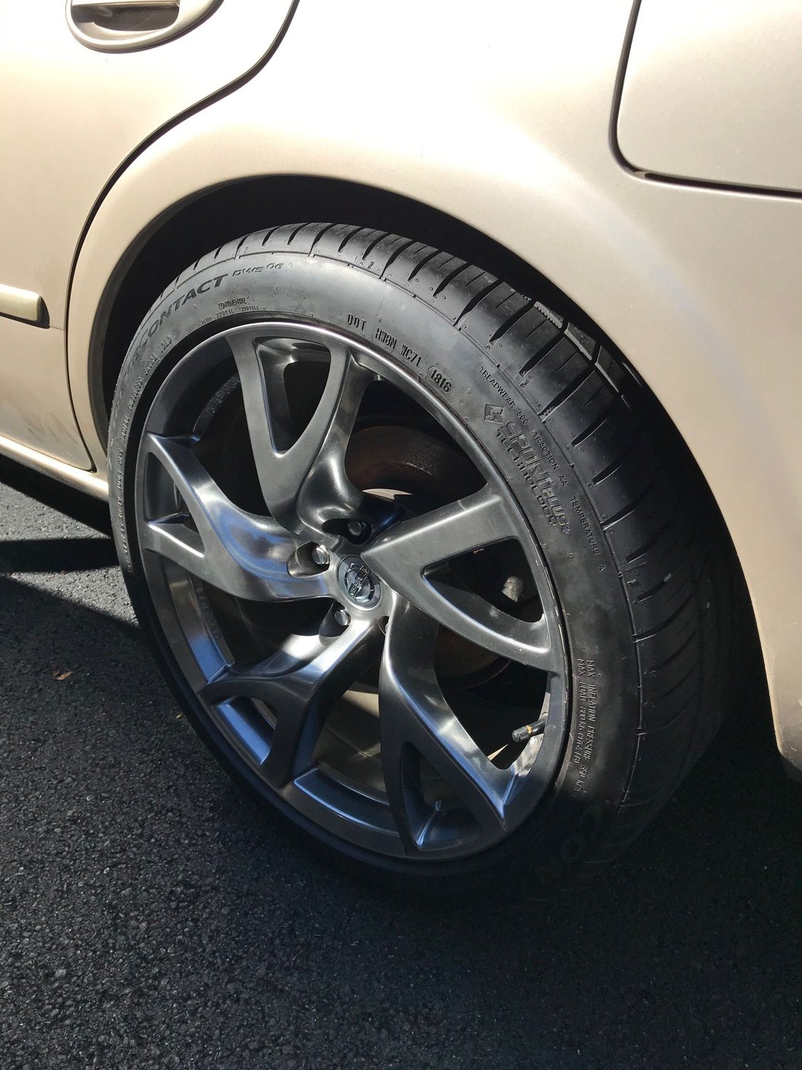

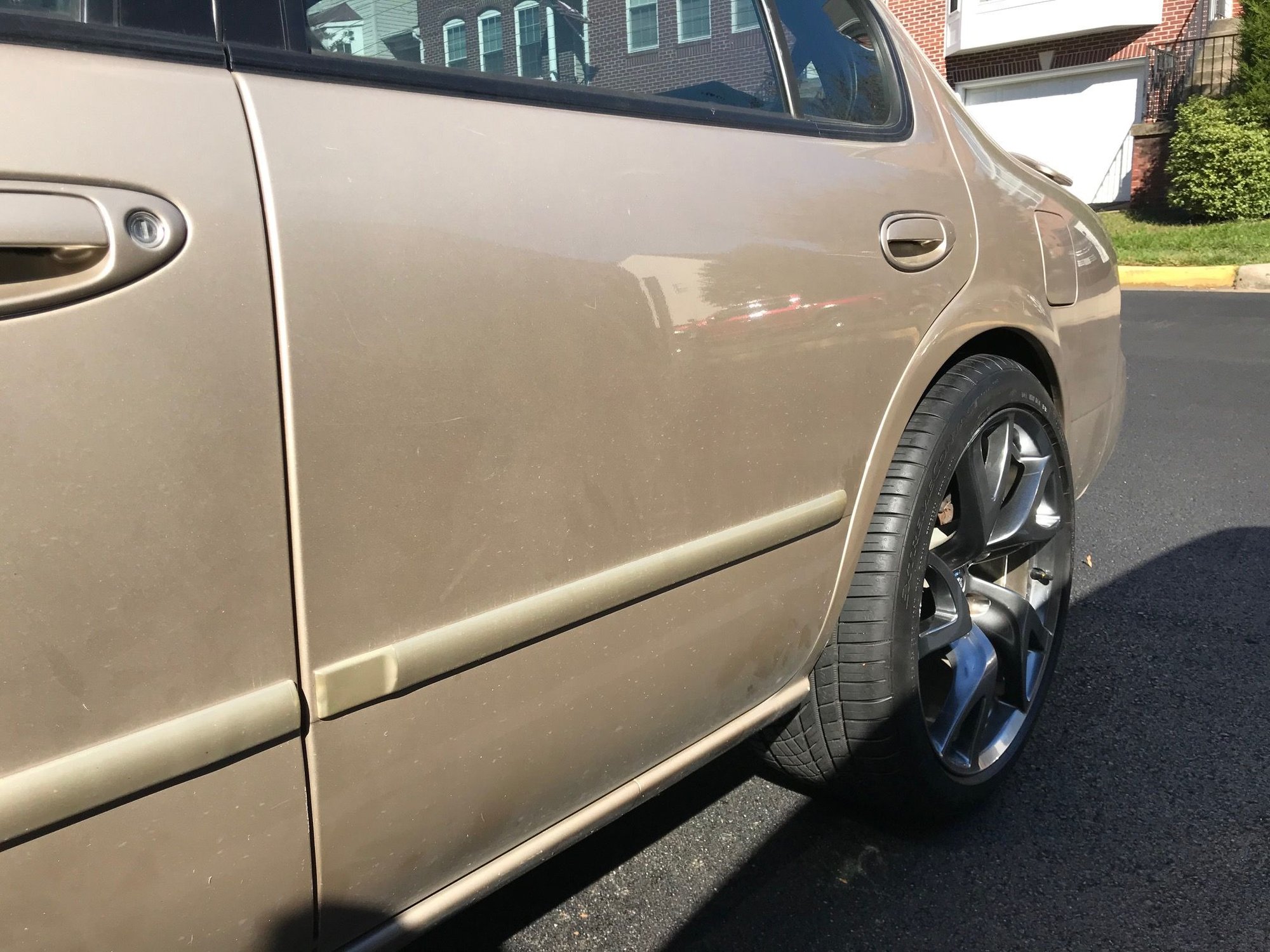

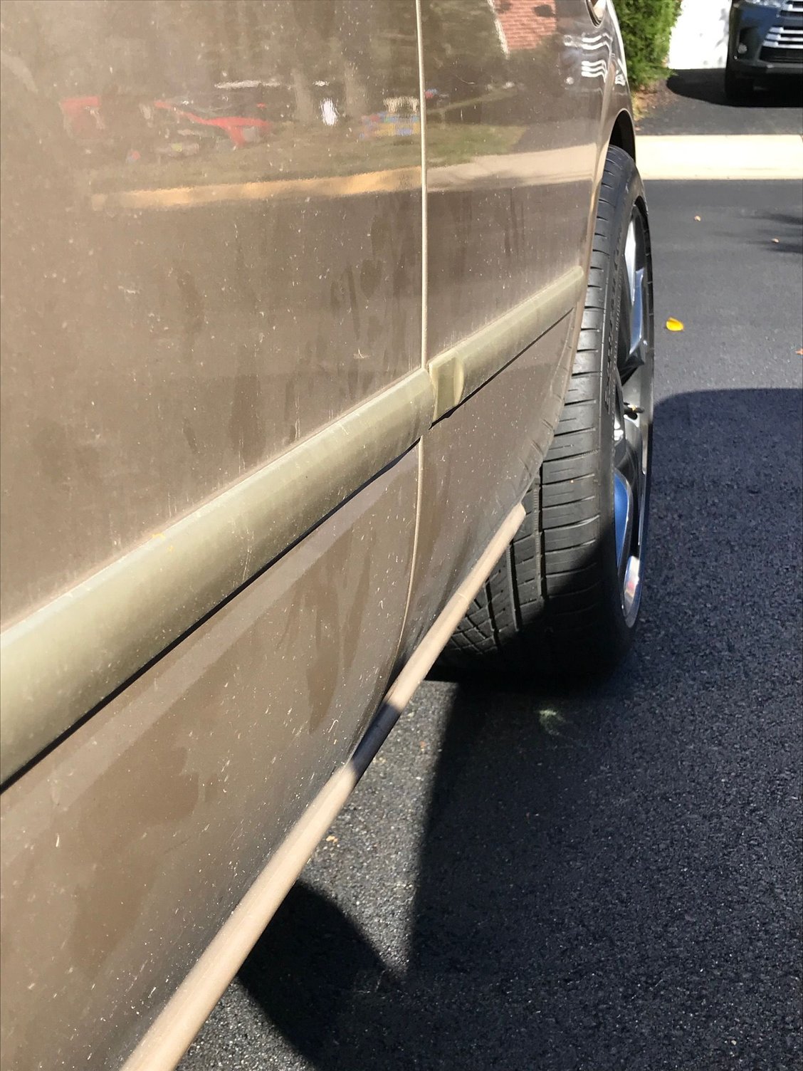

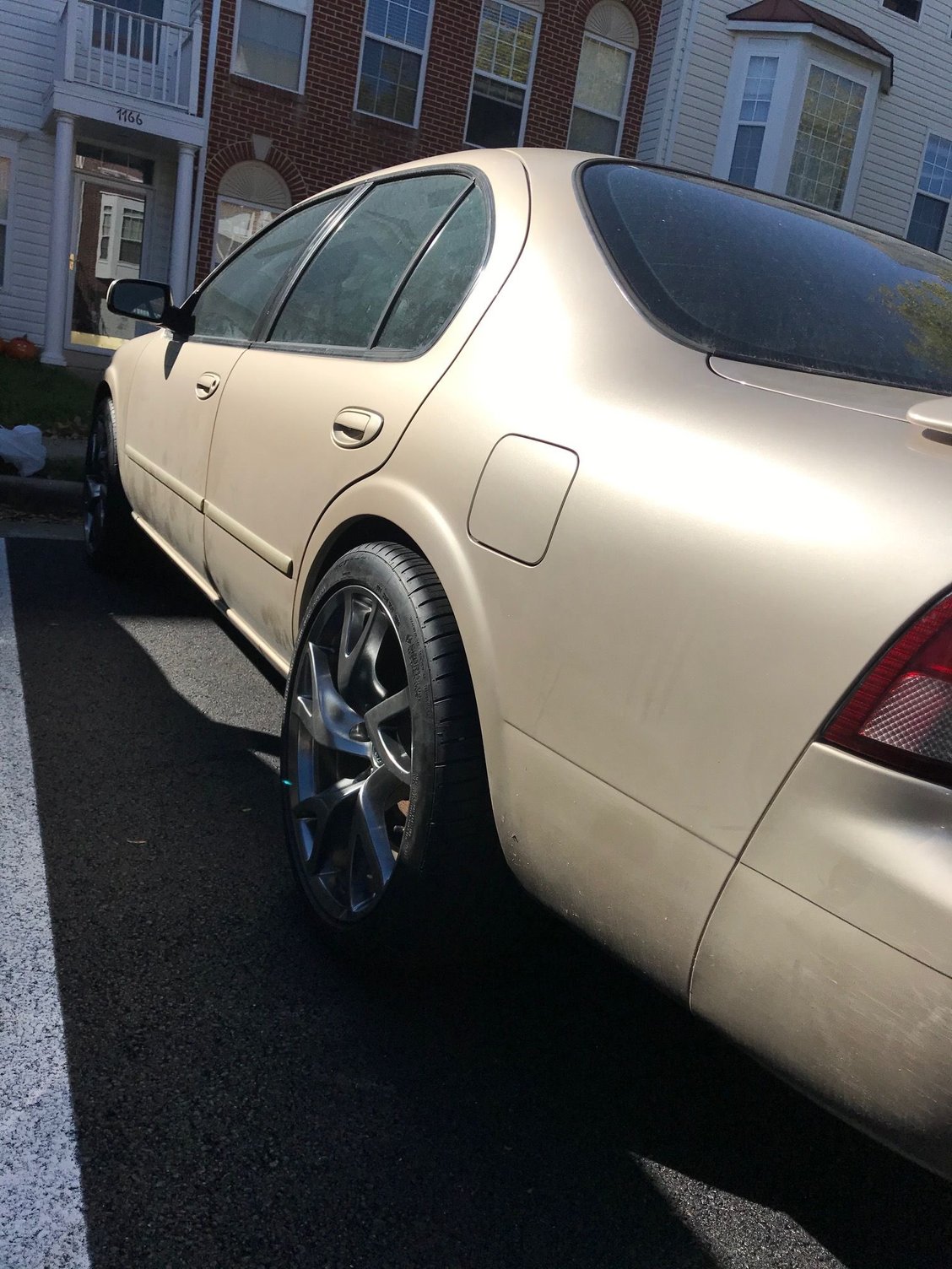

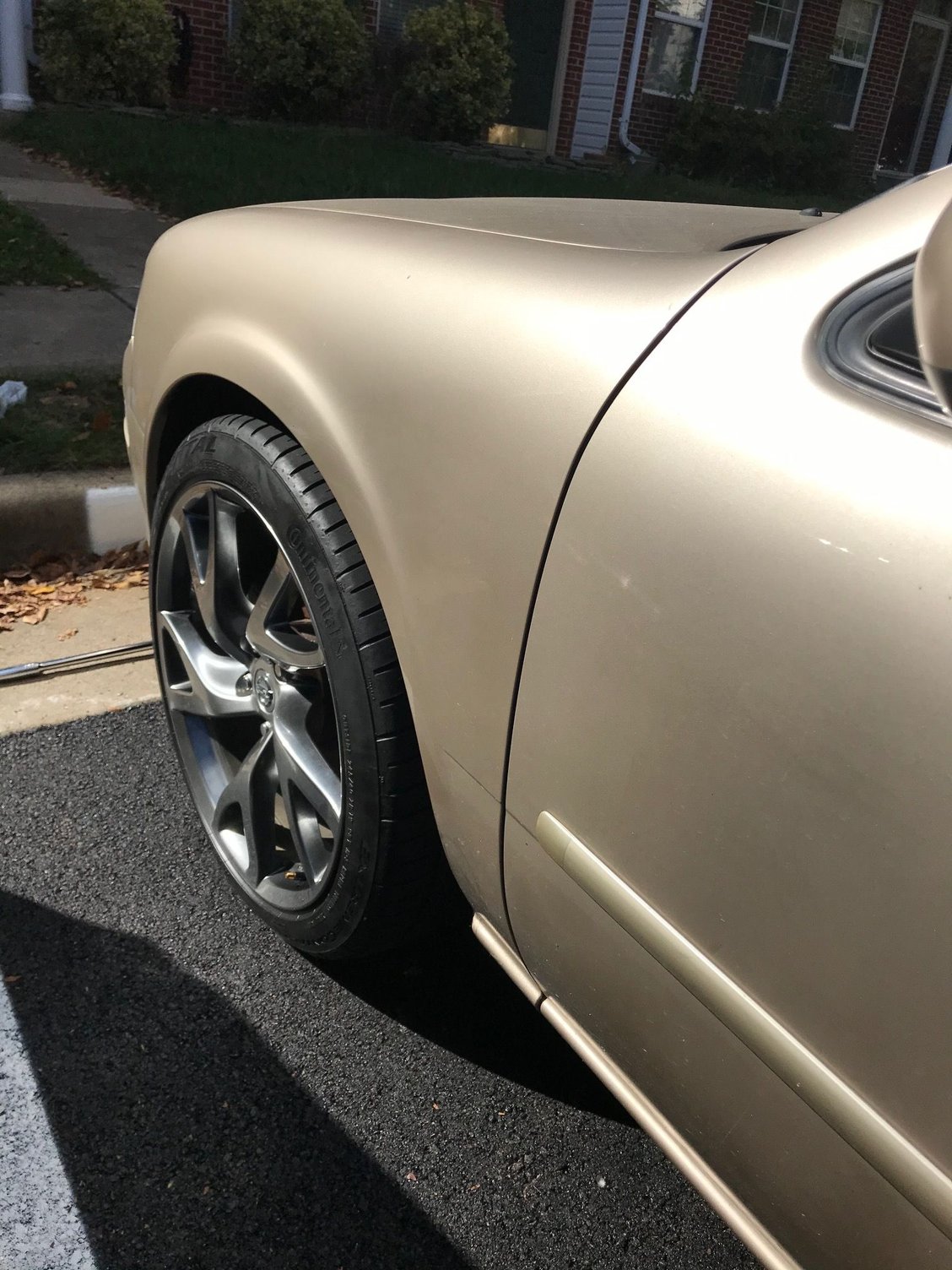

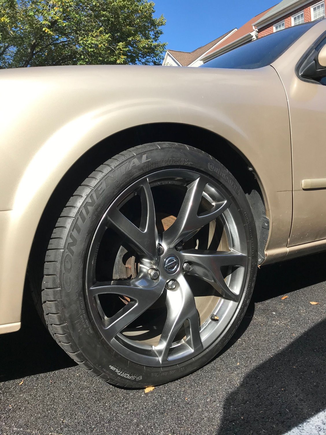

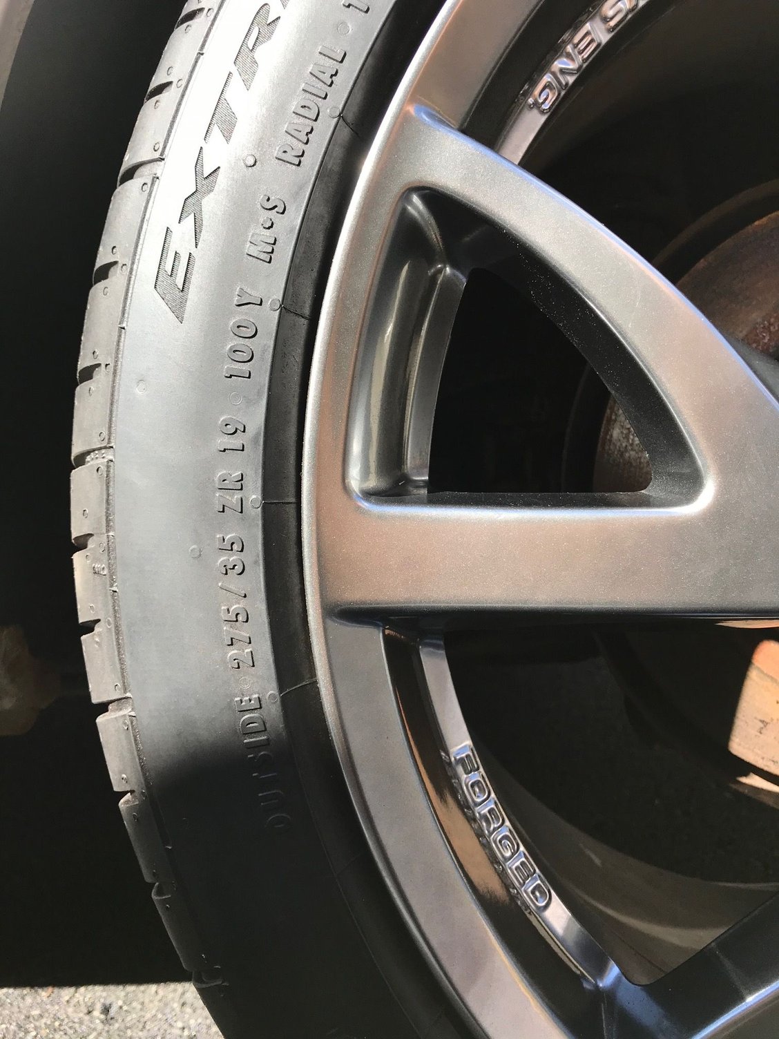

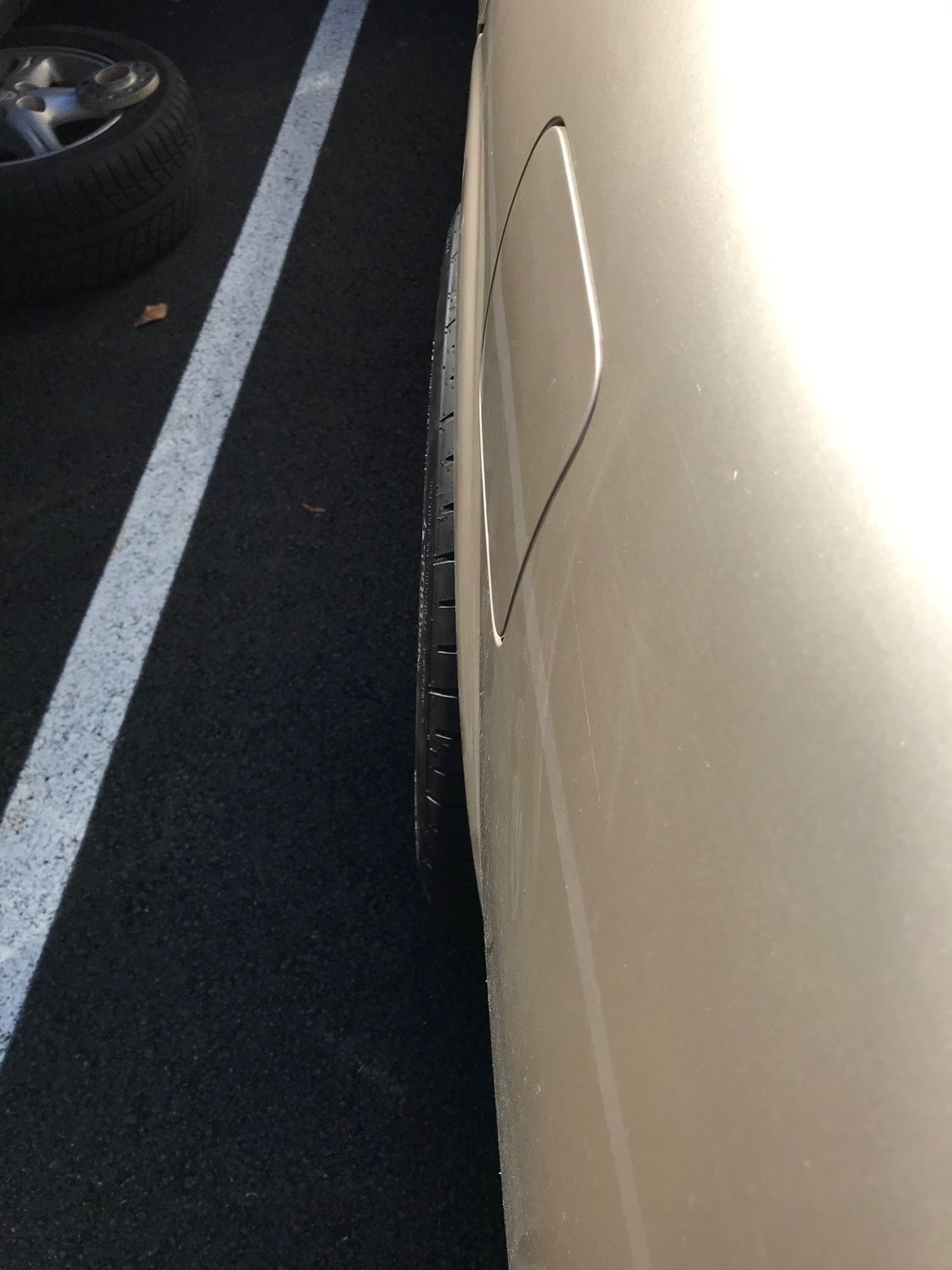

Had some time to test fit the 370Z wheels. Still need to roll fenders.
F 19X9 - 245/4019
R 19x10 - 275/35/19.
Ferhan
19" 370Z wheels/tires
Before
After
Nice and flush
Nice and flush
Almost there
Almost there

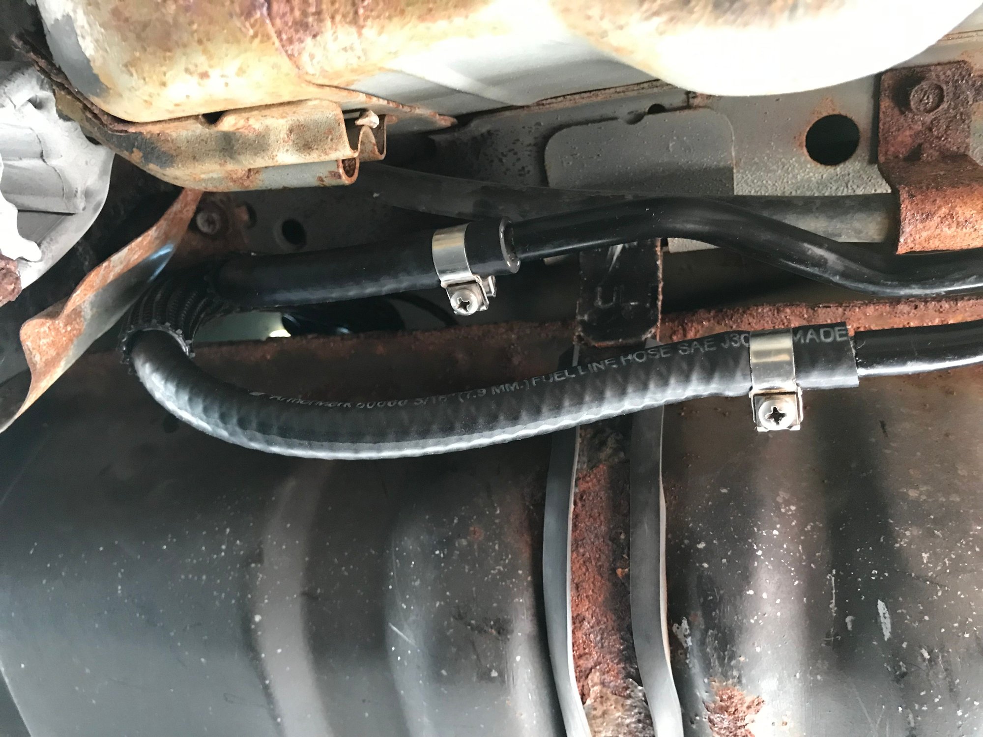

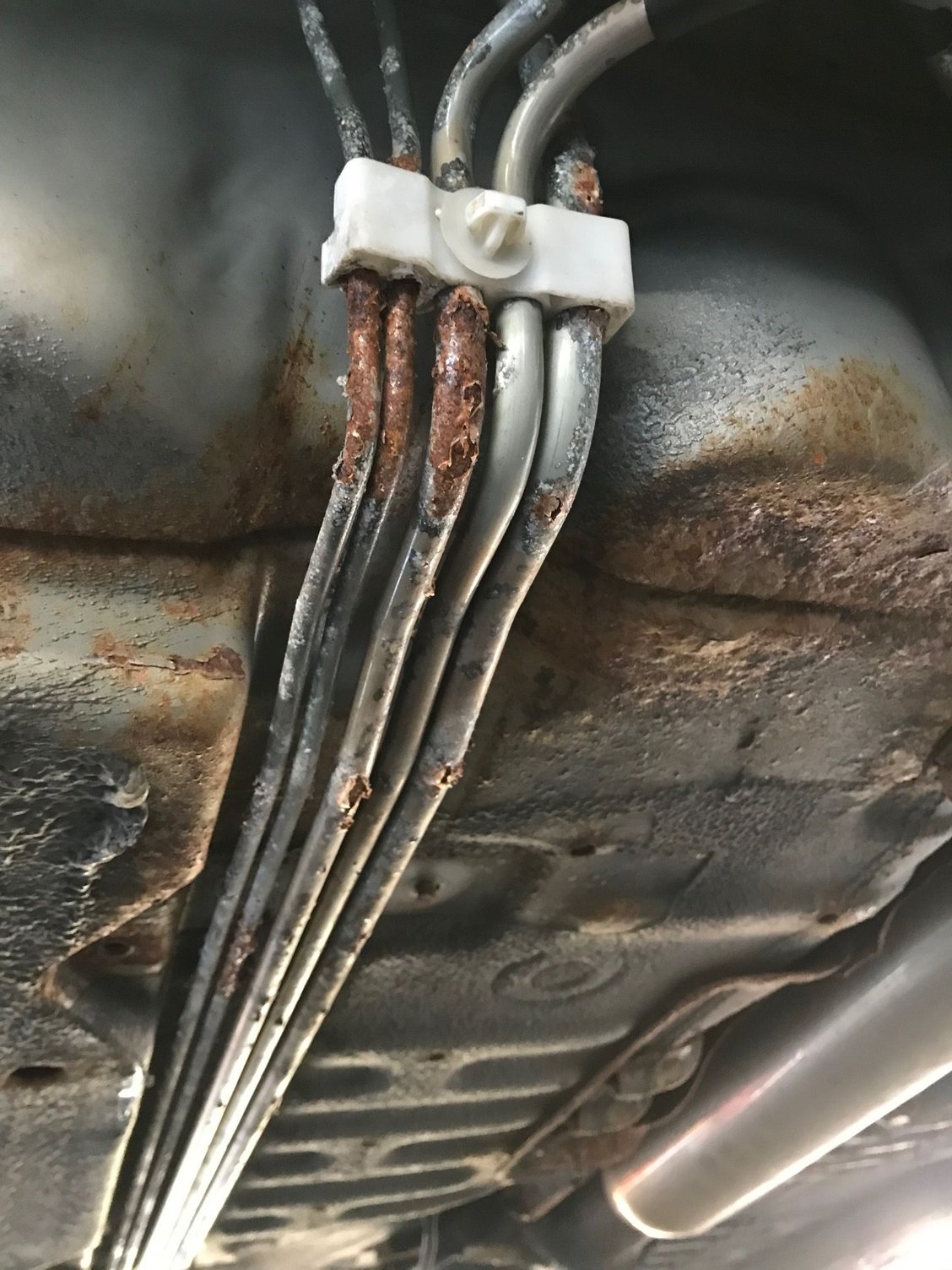

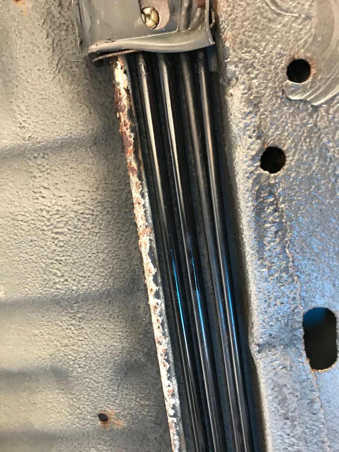

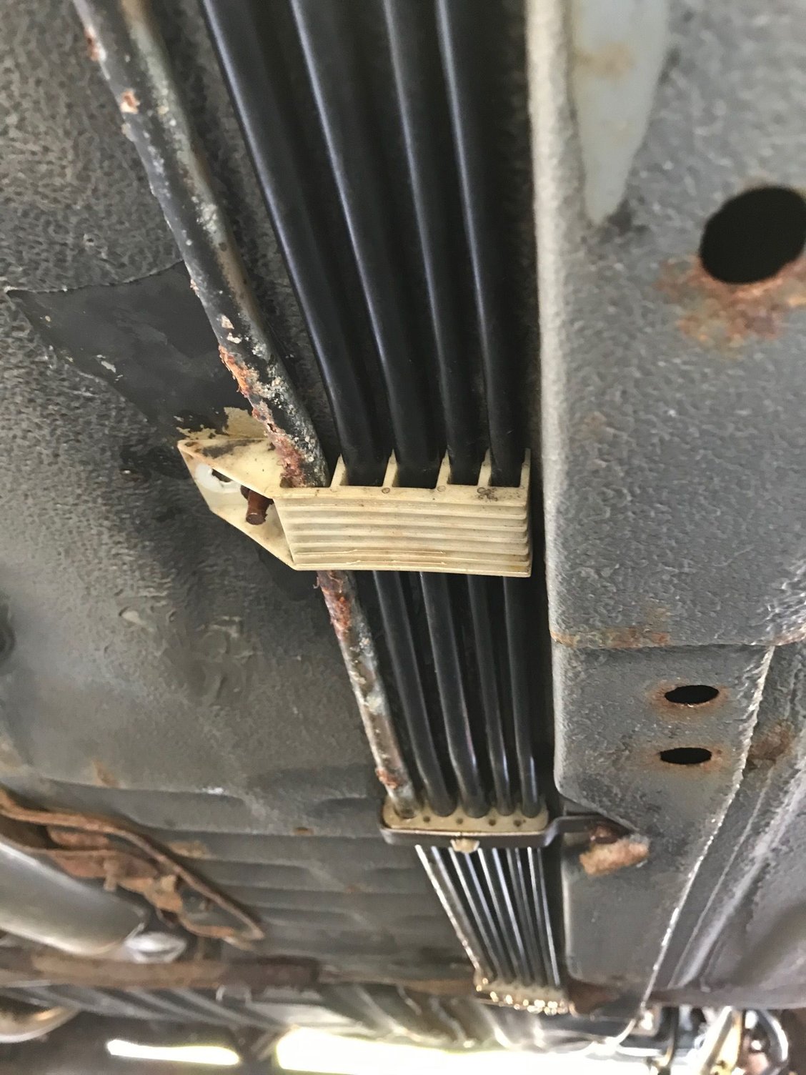

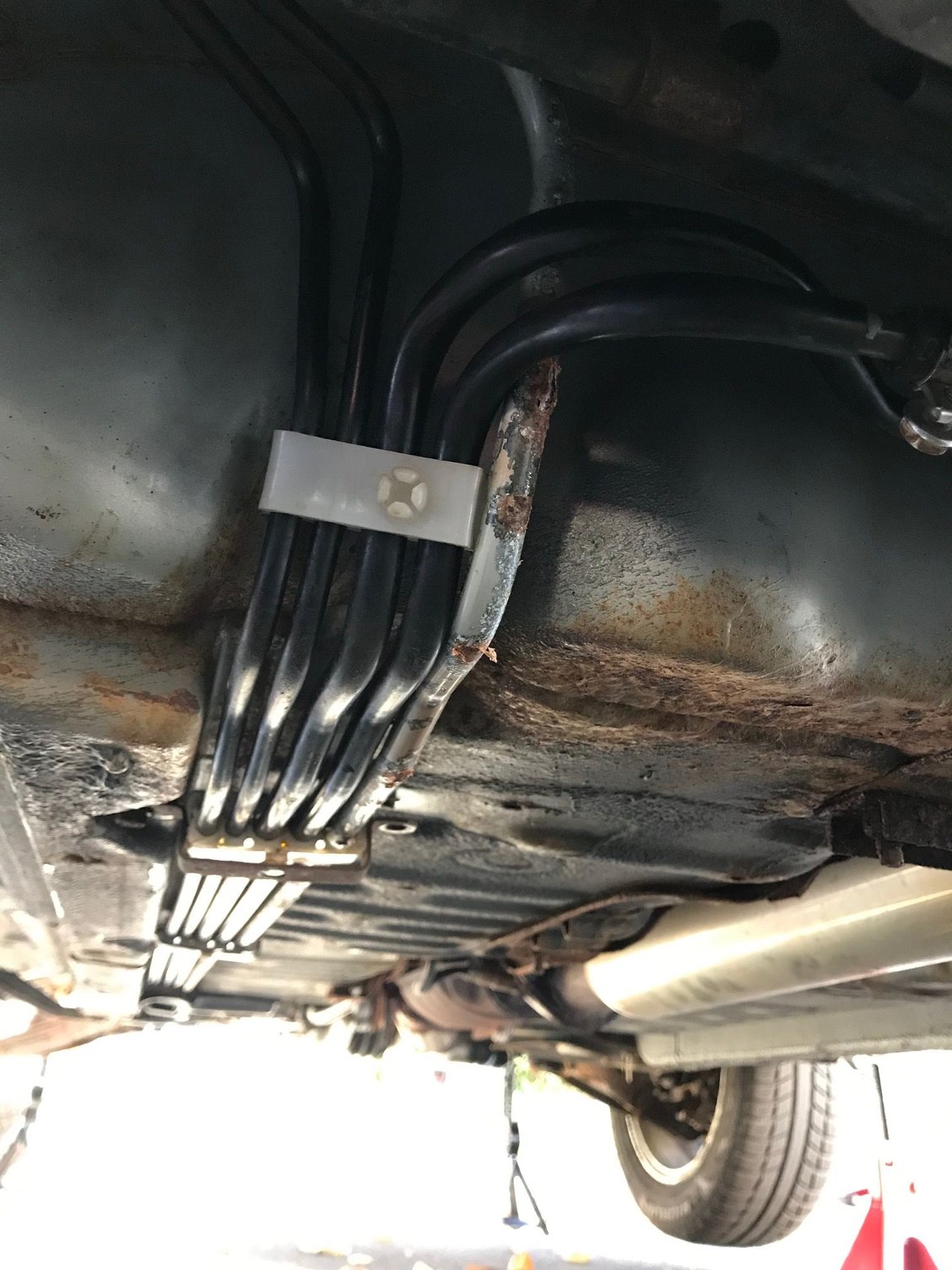

Update: Rear brake and fuel hard lines
Well, had some time to finally work on the car. Removed the old rusted out brake and fuels lines and replaced with with newer OEM lines I was able to find at the junkyard. The EVAP line was damaged on the donor car, so I was not able to replace that at the same time. Still need to bleed the brakes and test everything out before working swapping to the BBKs.
Did have two Org members come by to lend a hand. Thanks!
Before, just before fuel tank
After, just before fuel tank
Running to the back
Running to the front

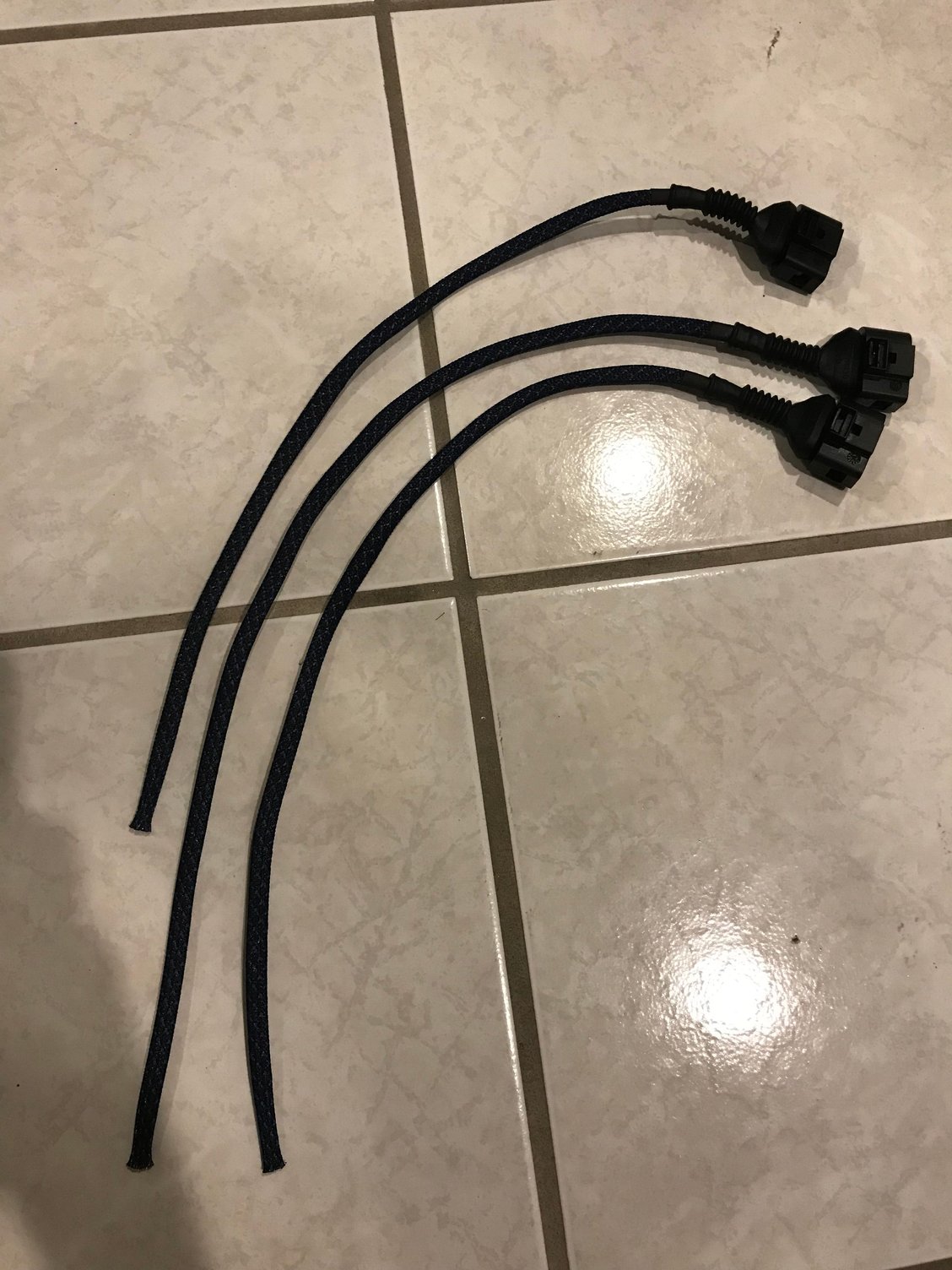

Also started on the Audi coils conversion, so should be able to get some pictures up that soon as well.

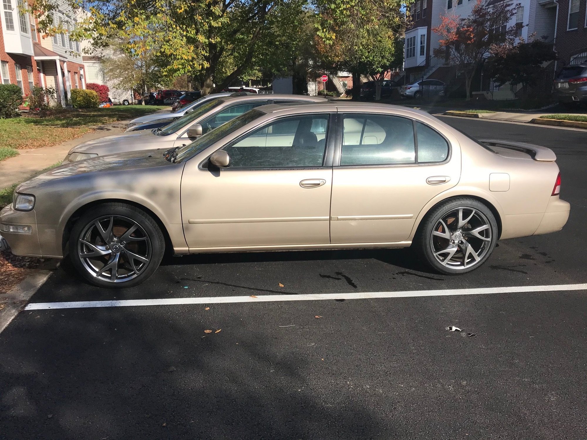

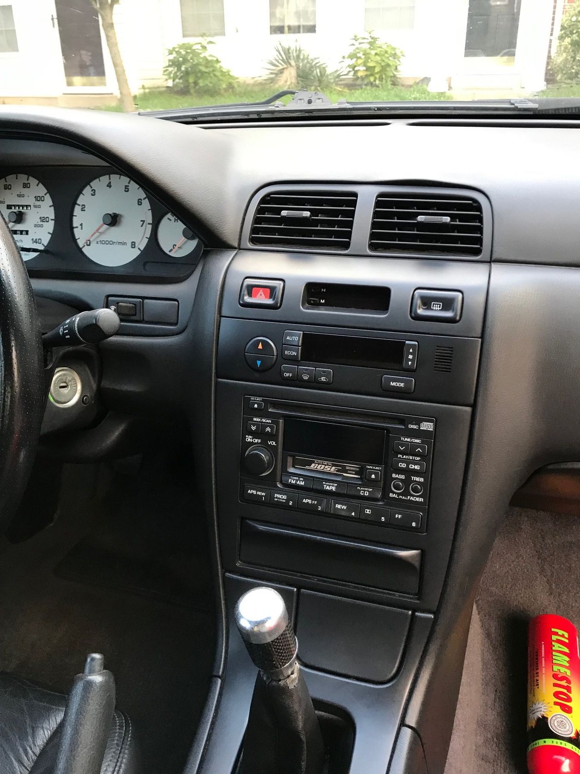

Finally took a few side view shots.
Ferhan

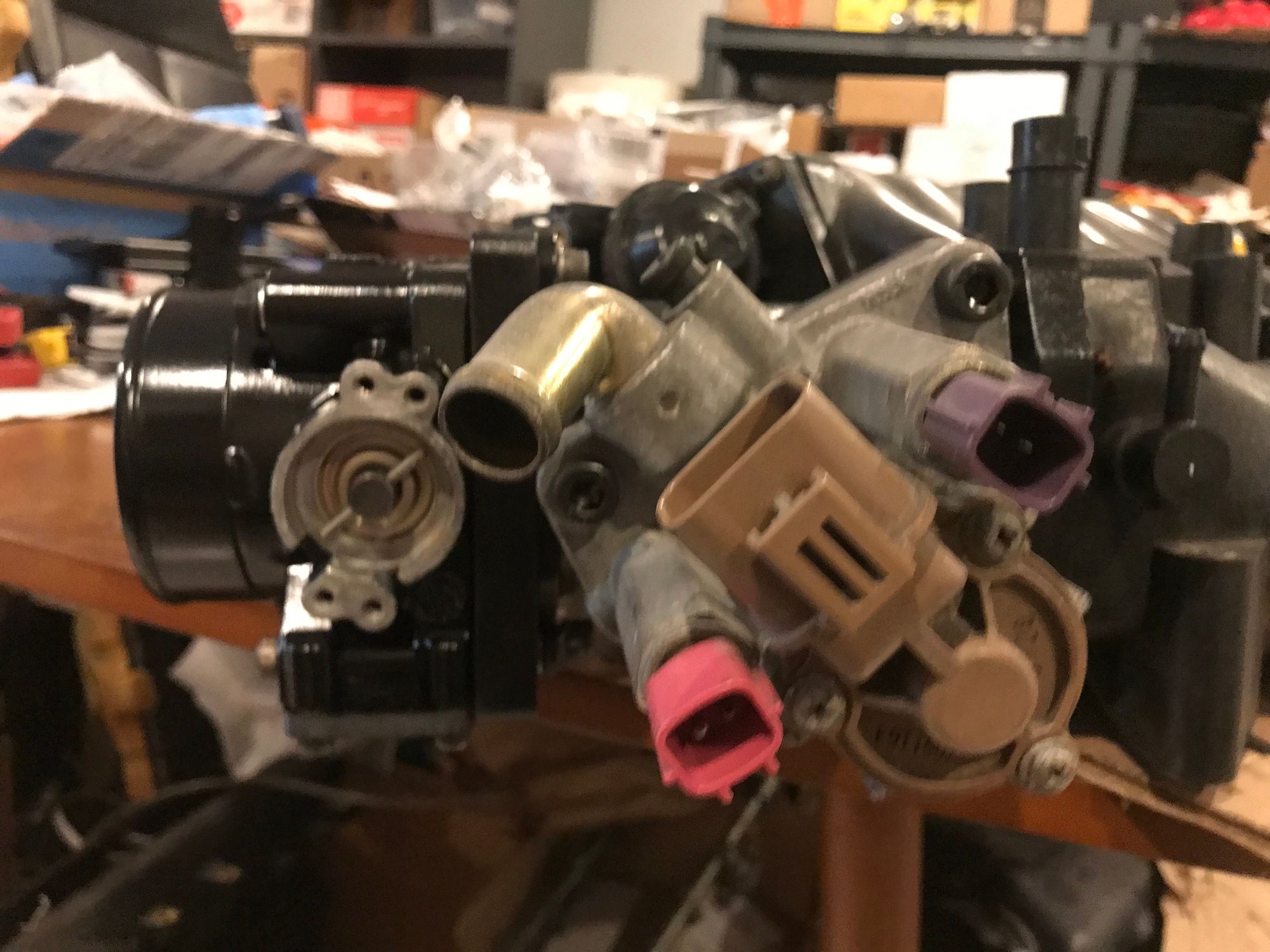

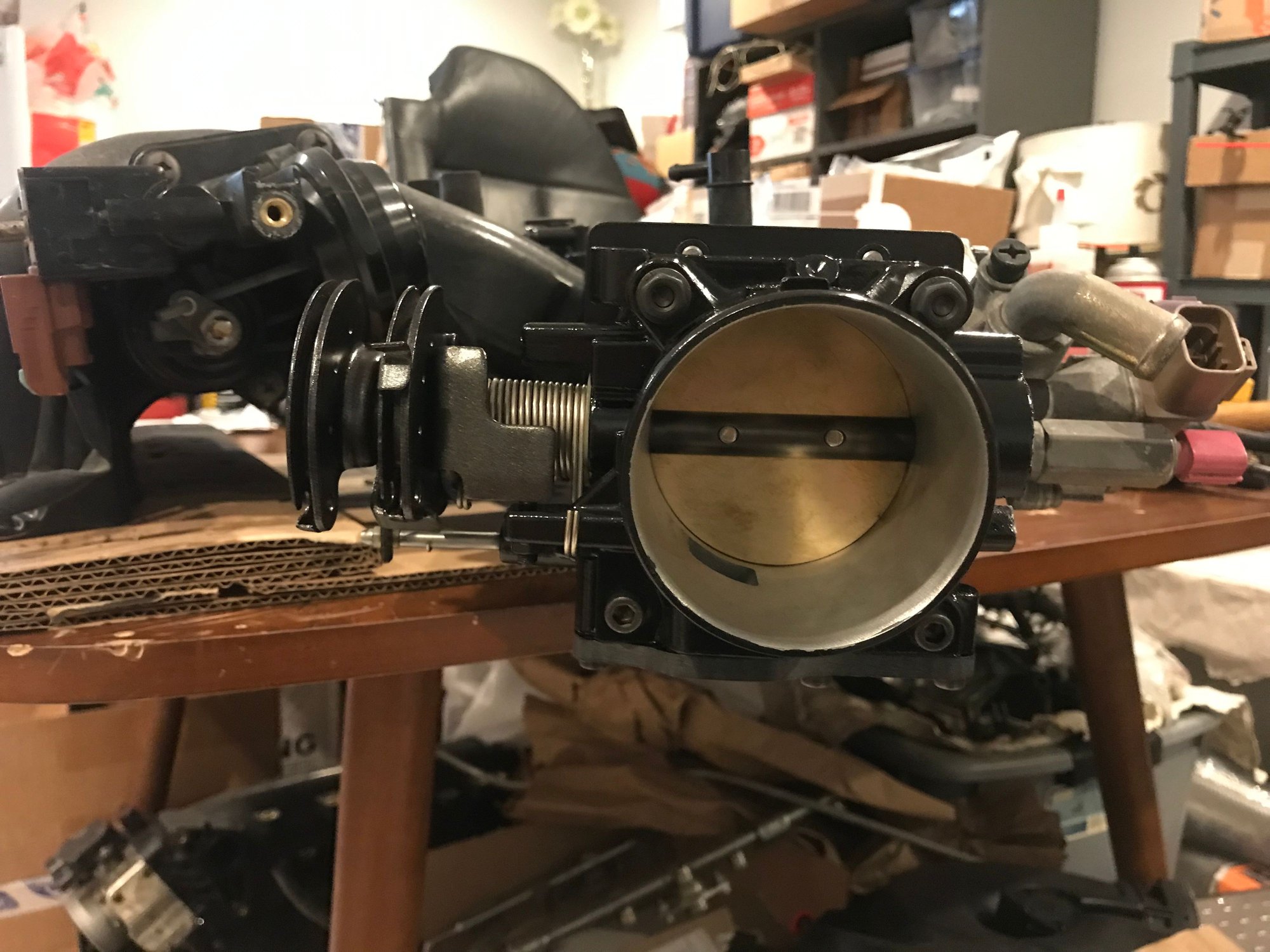

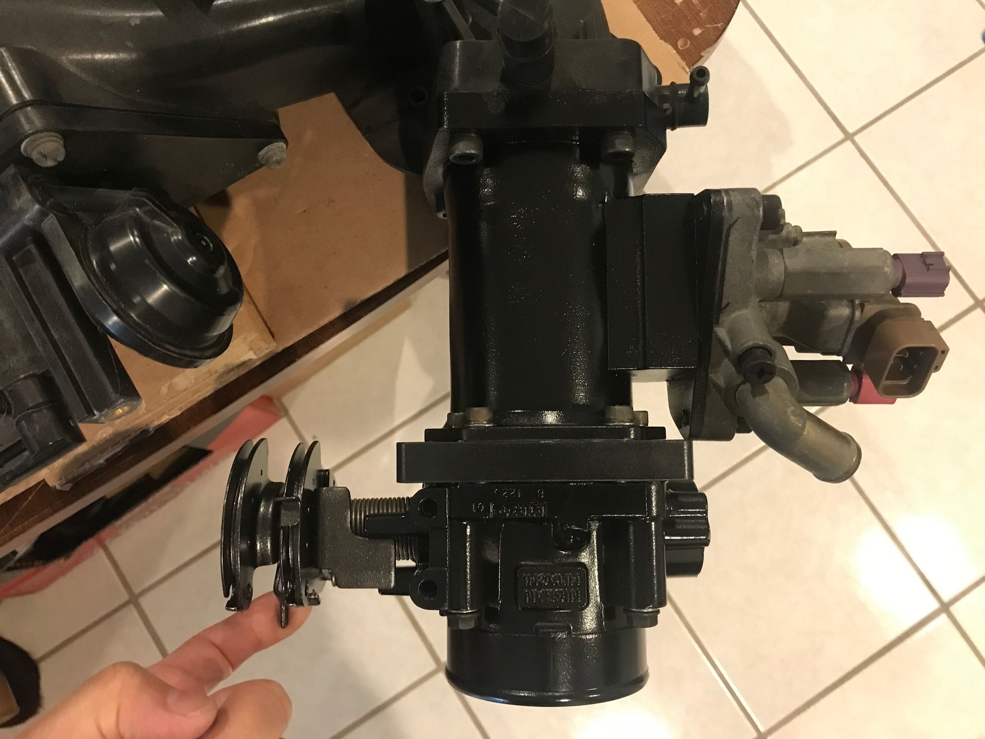

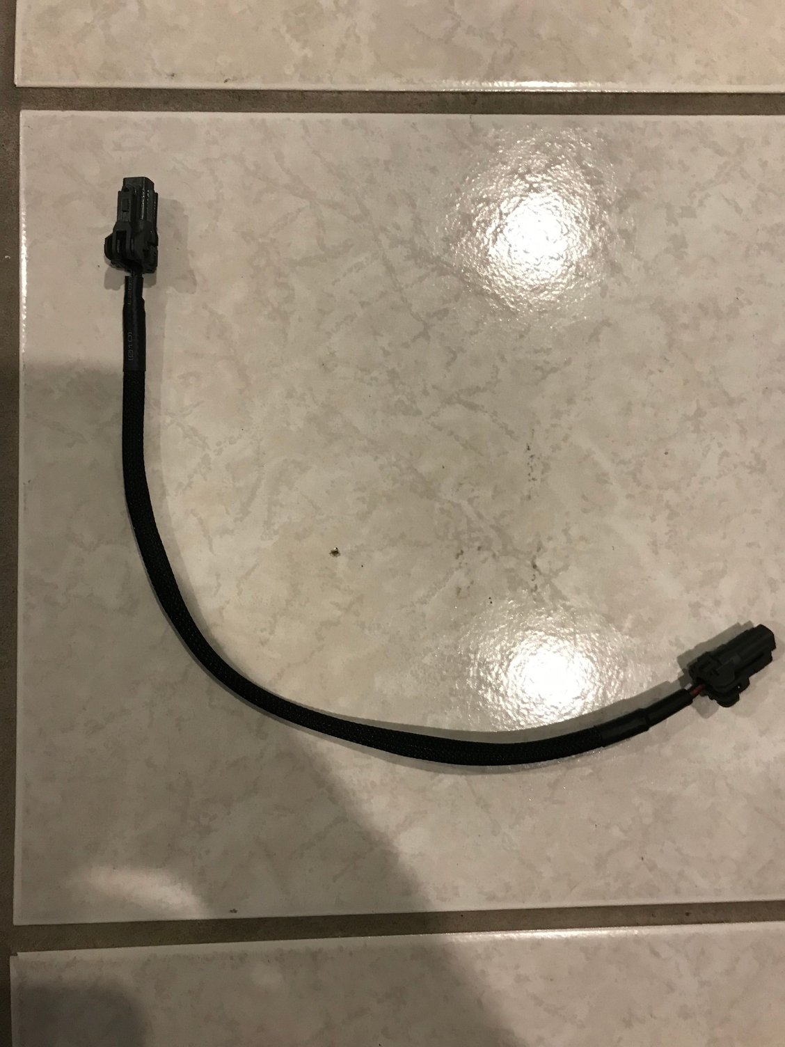

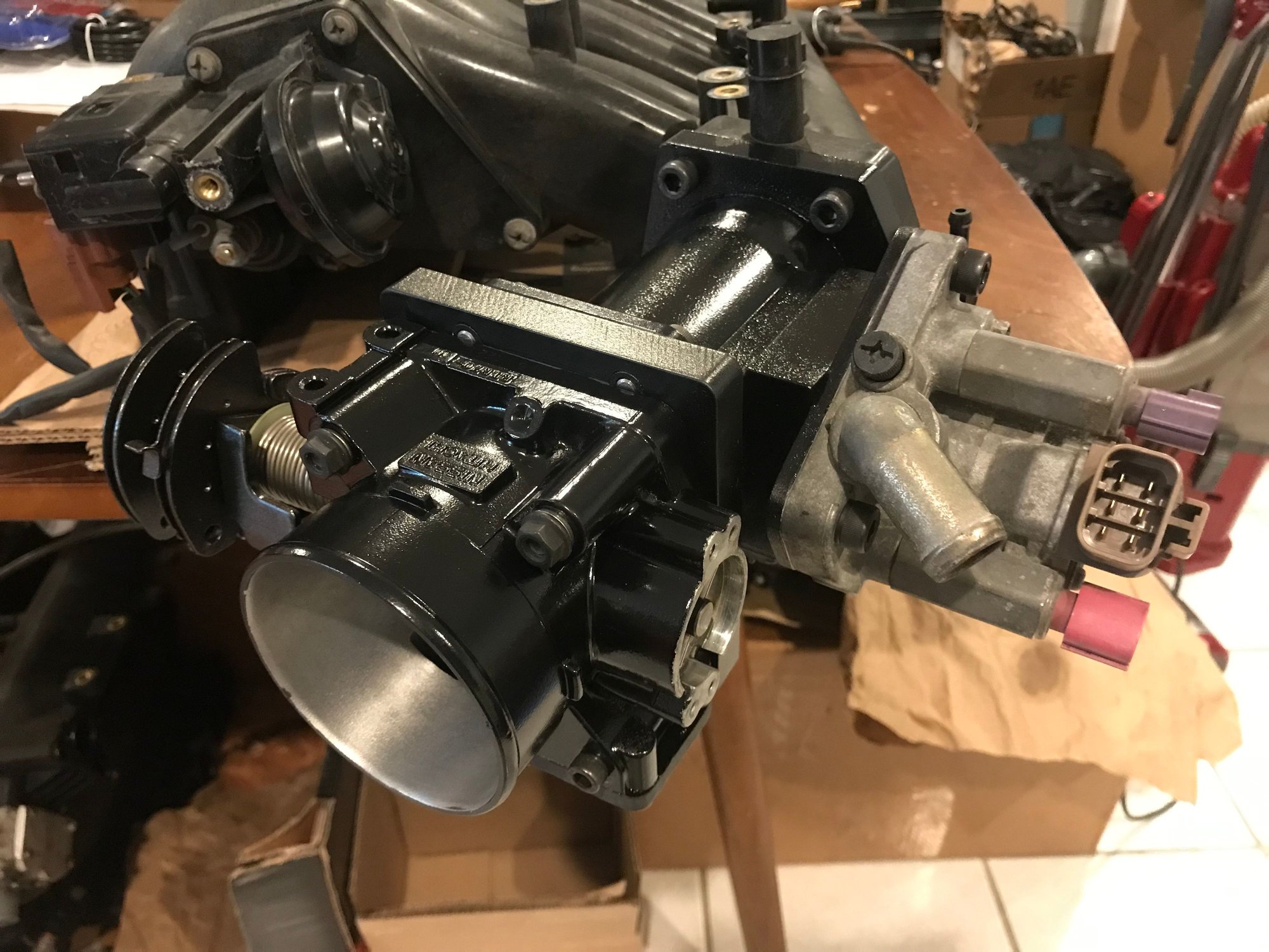

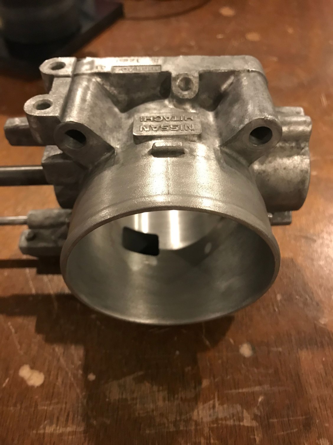

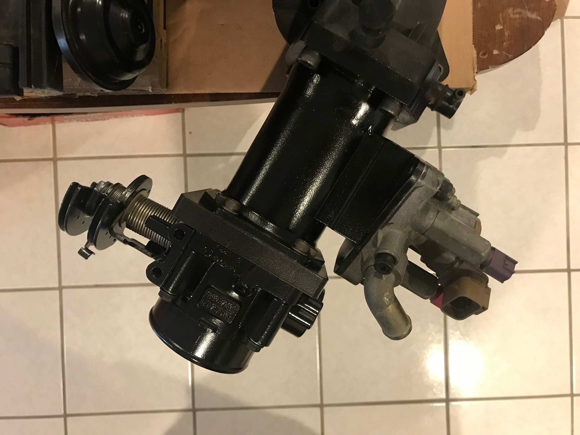

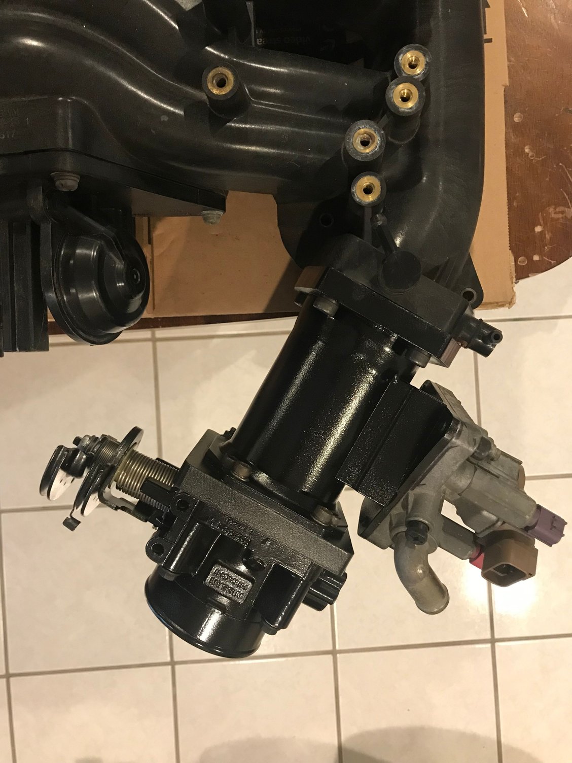

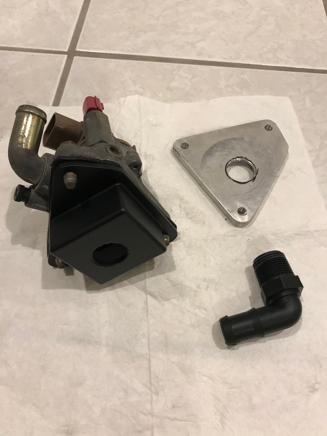

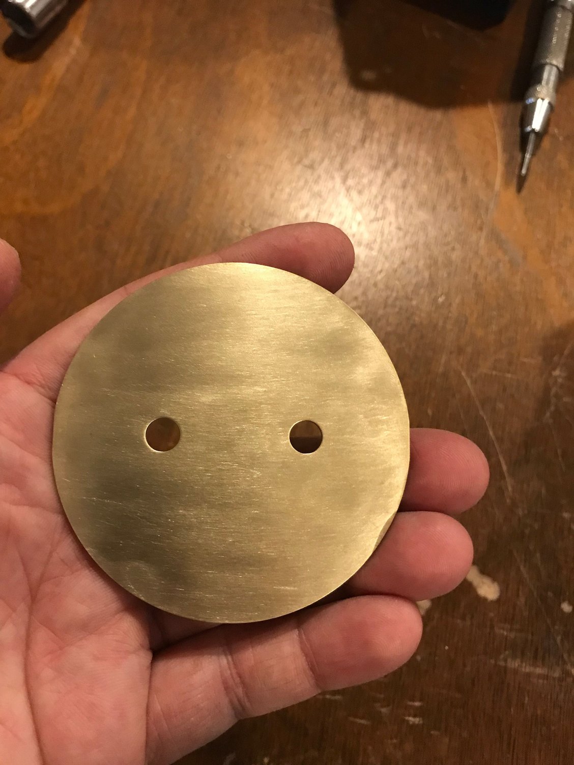

Update: IACV adapter and 00VI

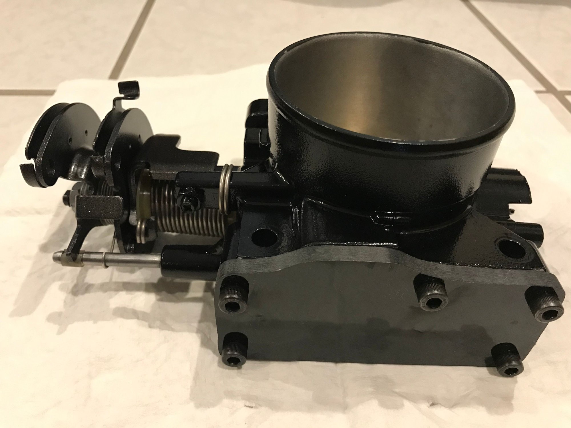

Prepped the IACV adapters and fitting for the 00VI. Still undecided if I will be putting it back on or not. Adapter made using JSutter idea.
Old and new adapter with 3/4" fitting
Ferhan

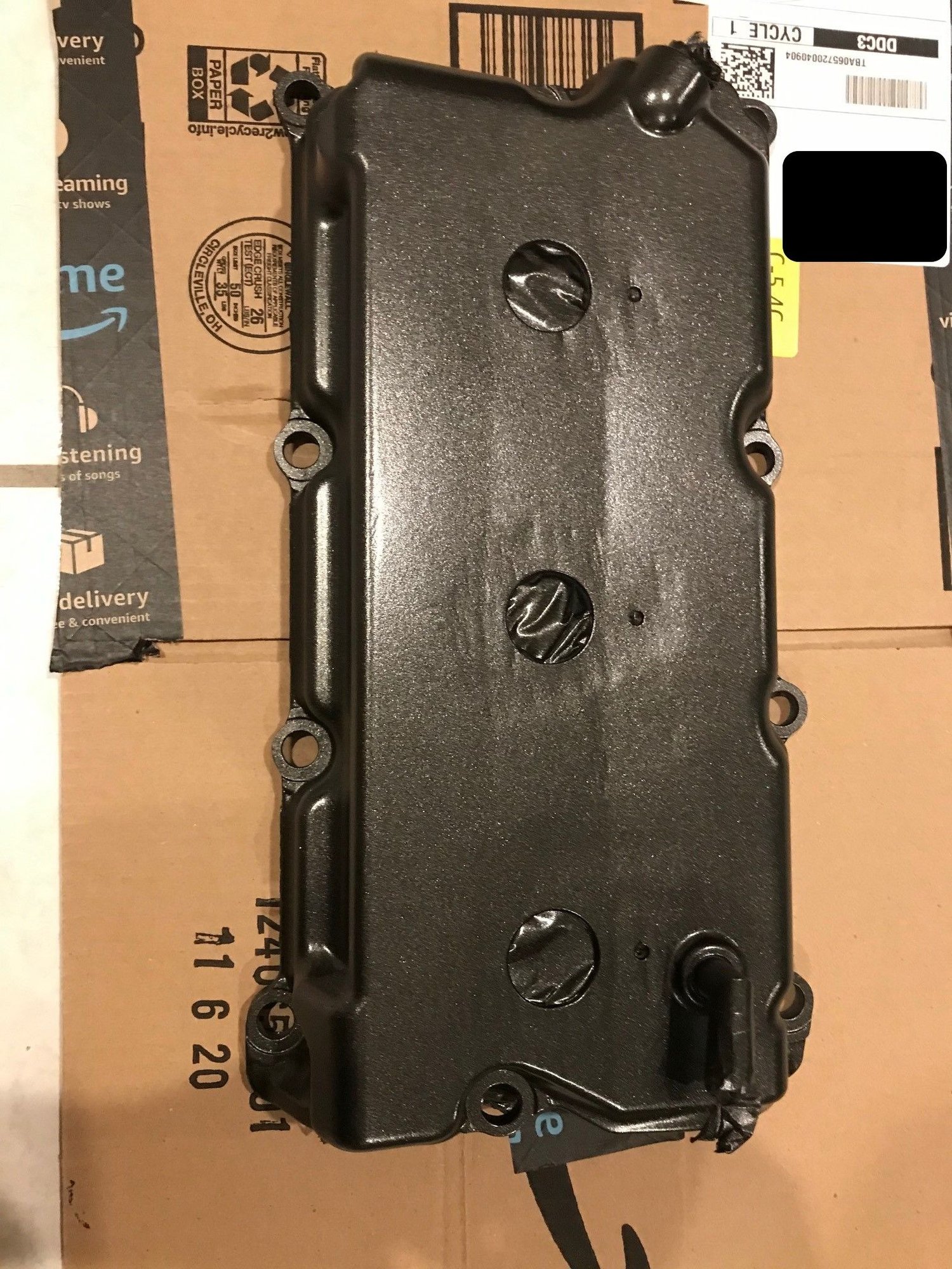

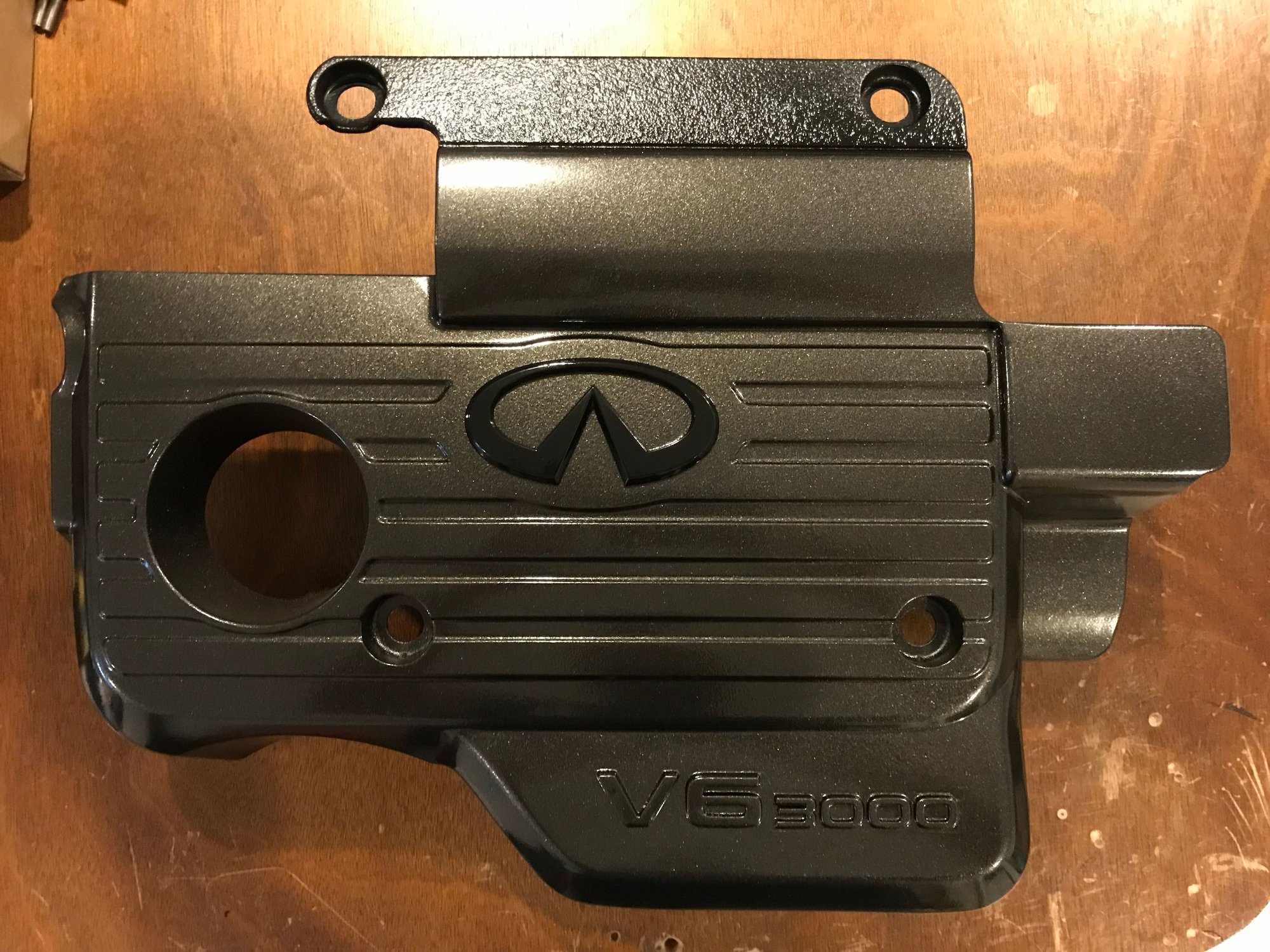

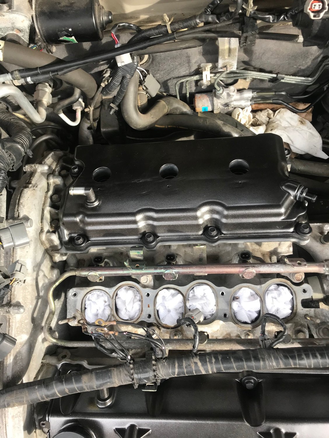

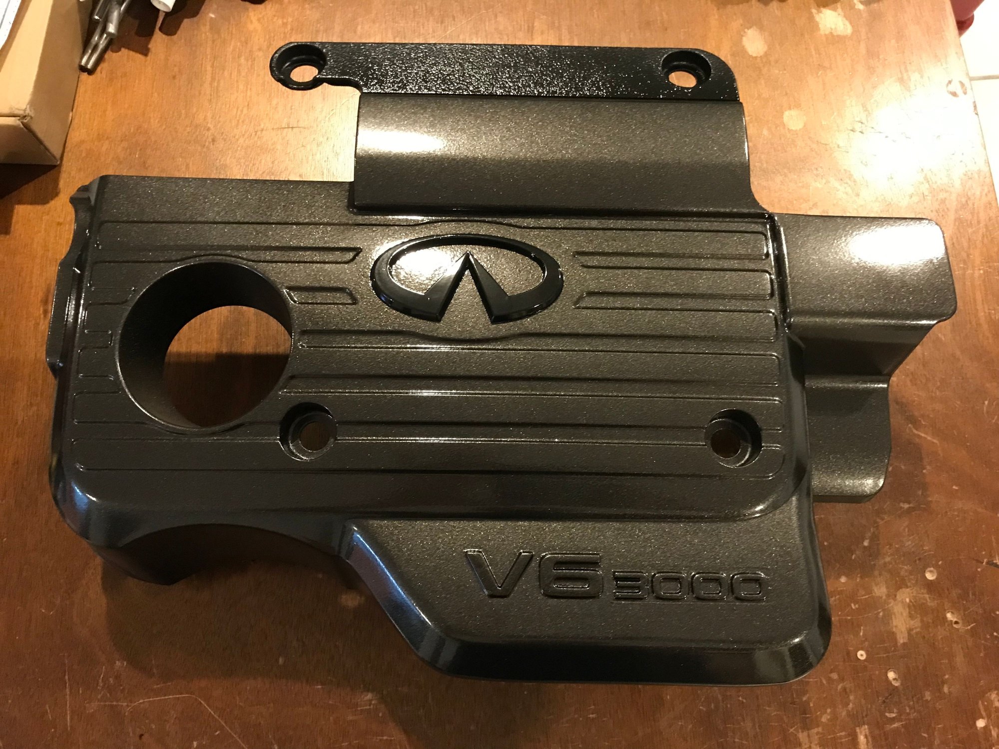

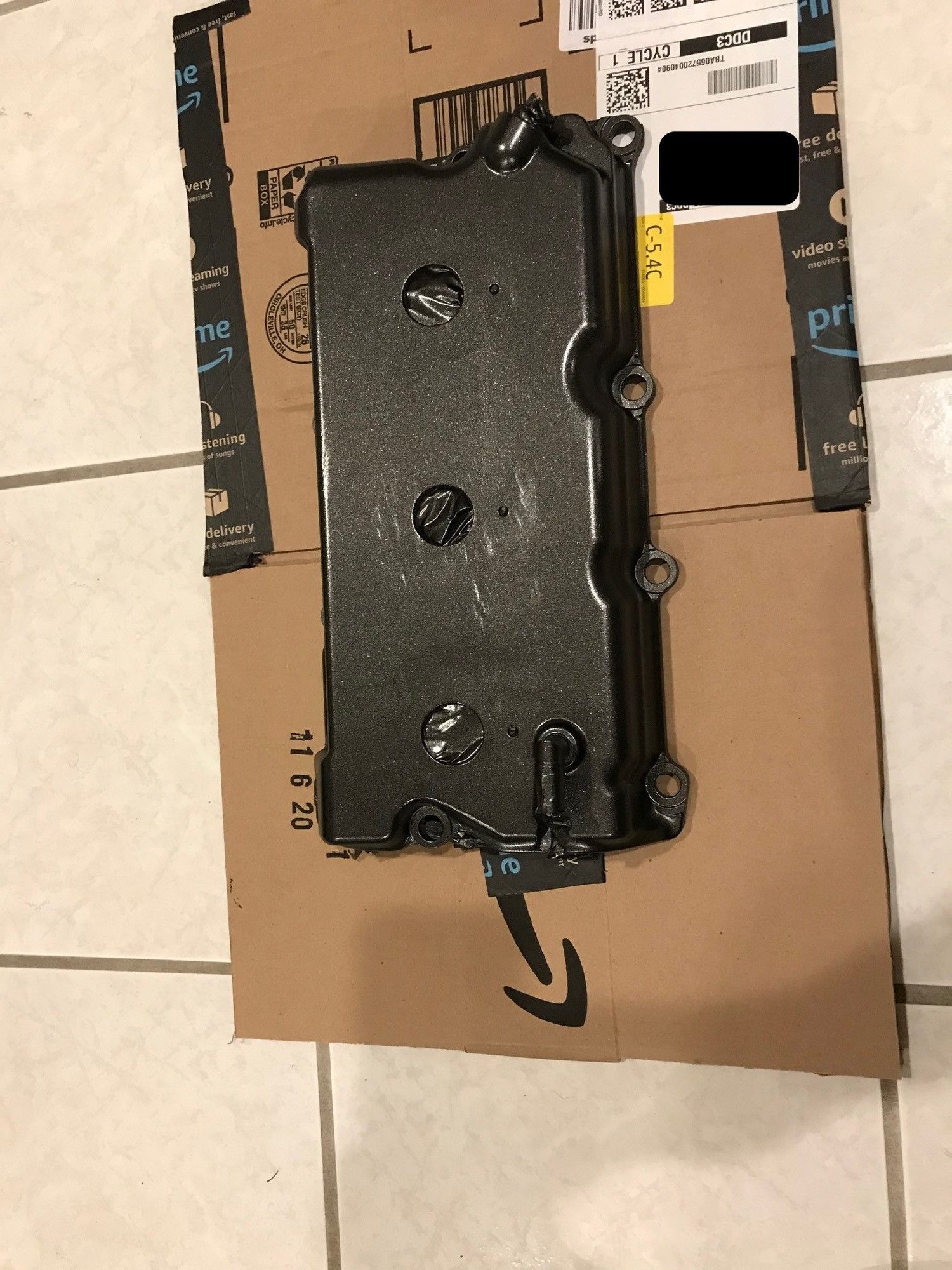

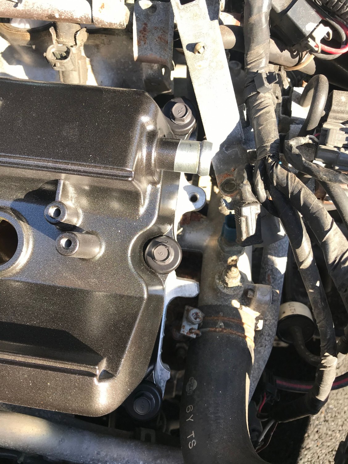

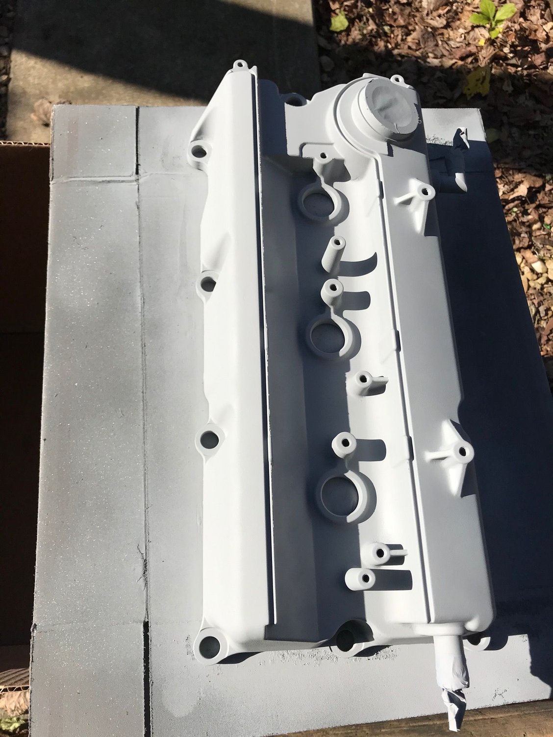

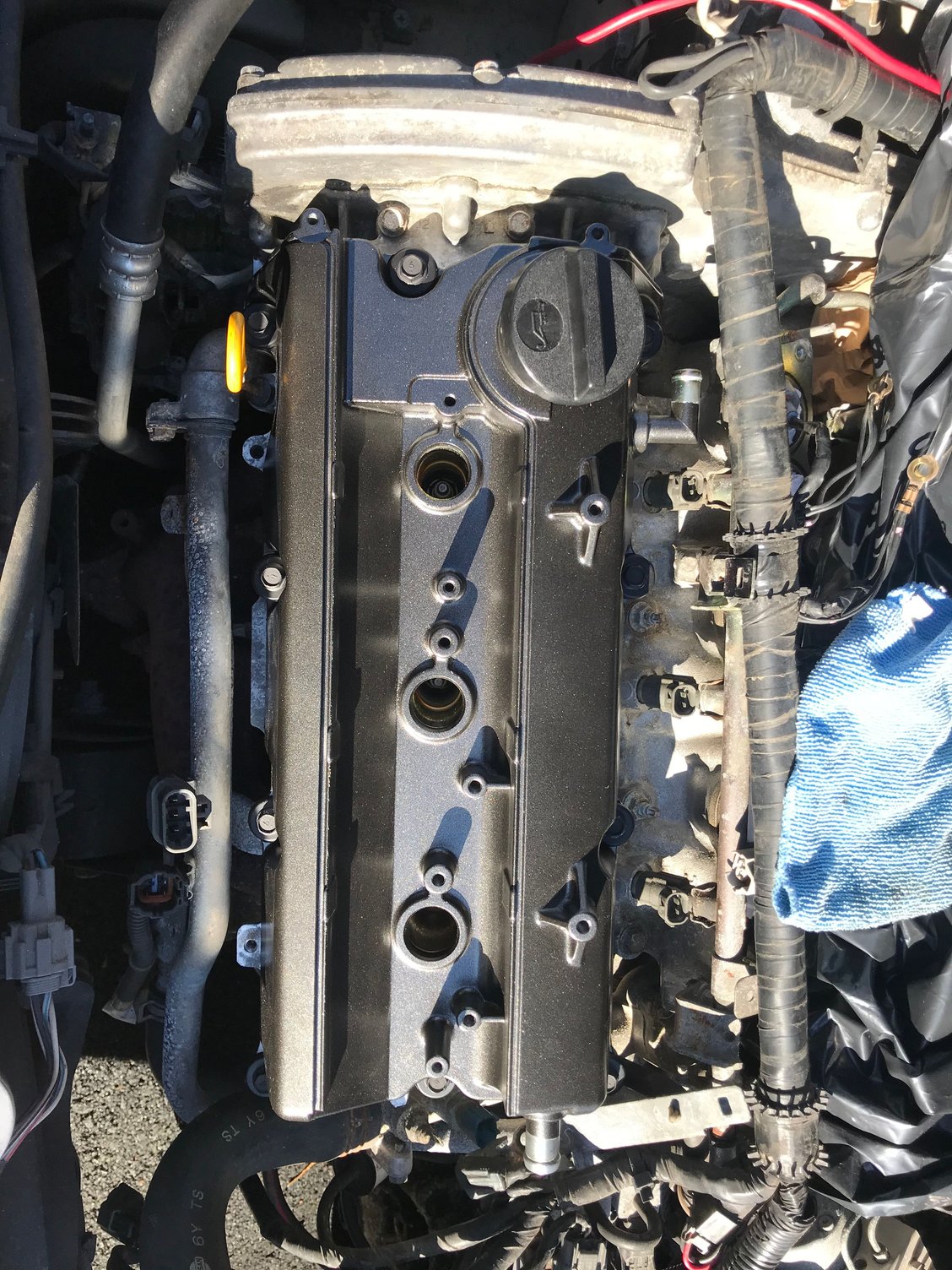

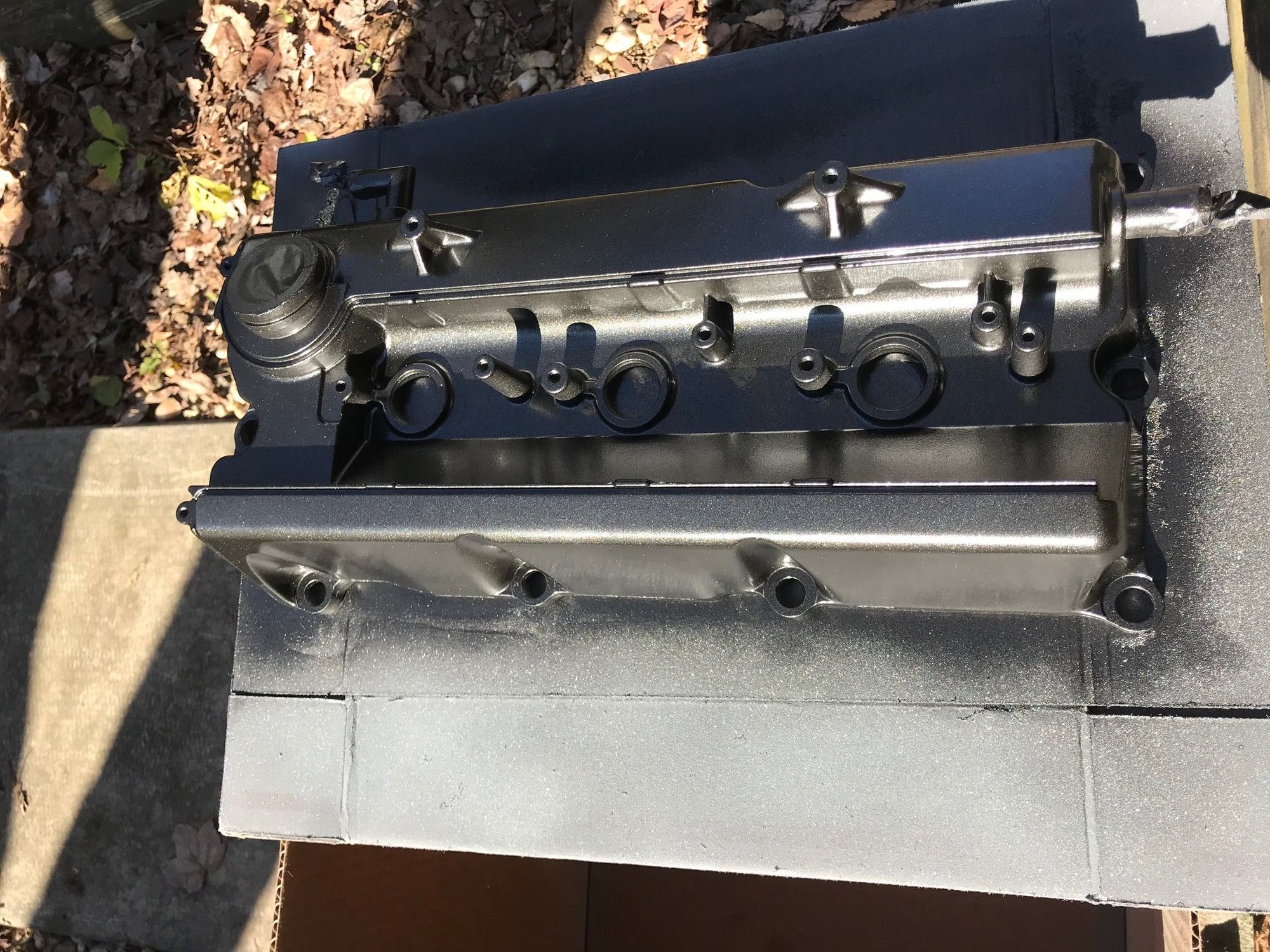

Update: Rear valve cover modified/both painted and UDP
I was able to get the rear cover modified, but unfortunately did not have the proper cutting tools so ended up removing more material than needed. I was going to fill it back in but the weather is getting cold and I am running out of time to get the engine closed back up. May come back to fix the rear cover latter. I did fill in the large scratch on the front cover though. Also installed the under drive pulley. Will get the CV gaskets and seals replaced as well as the spark plugs before installing.
Still nice and clean on the inside
Front cover before painting
Filled in the scratch on the Front cover
Front cover primed
Front cover painted Metallic Gray
Modified rear cover (not smooth due to cutoff wheel)

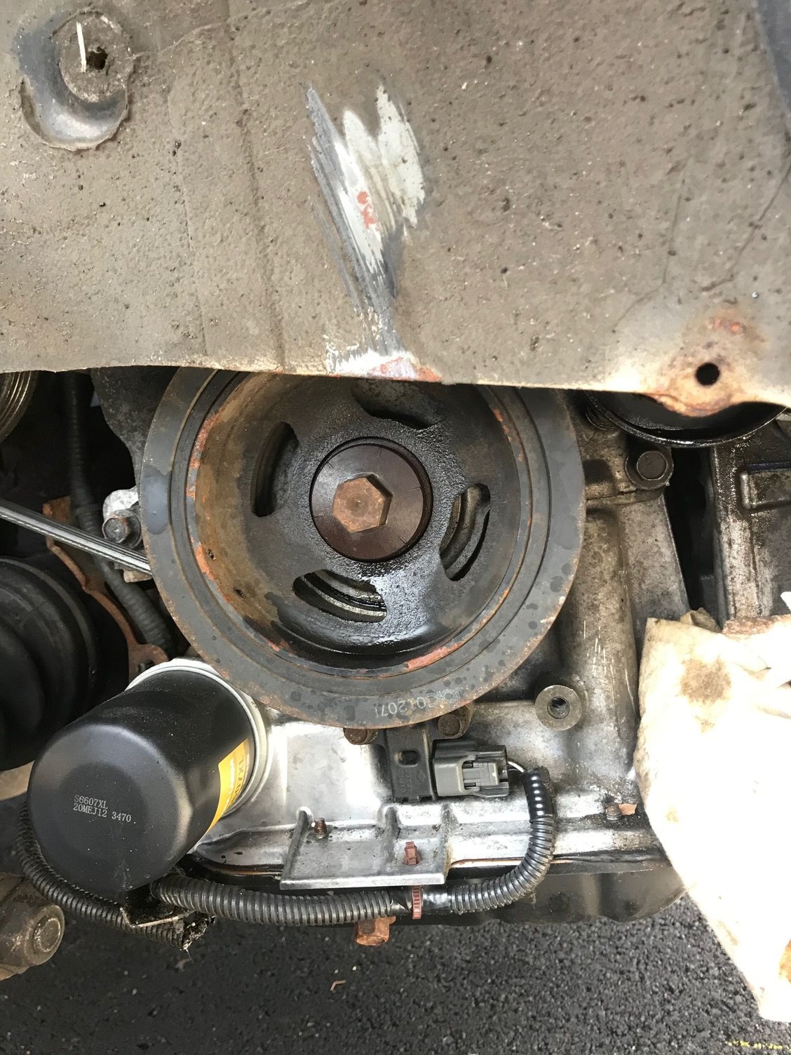

OEM crank pulley
New under driver pulley
I will try to getting the covers and manifold back on before Thanksgiving and post pictures.

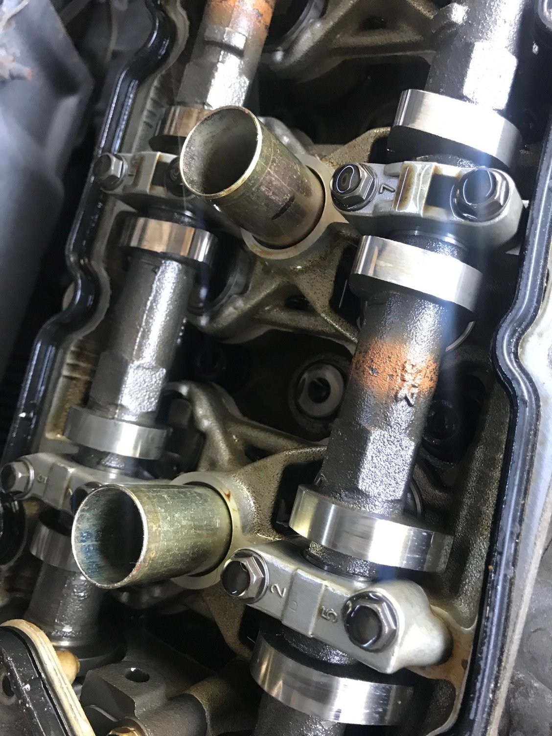

Update: Valve Cover pictures and some other things I have been working on
Apologies for the delay here. Timing to get anything done has been tough but here are pictures of the valve covers. Additional, pictures of some other things I have been working on. Horns, lots of wiring and adapter for pftb to 00vi. I will provide more details later on.

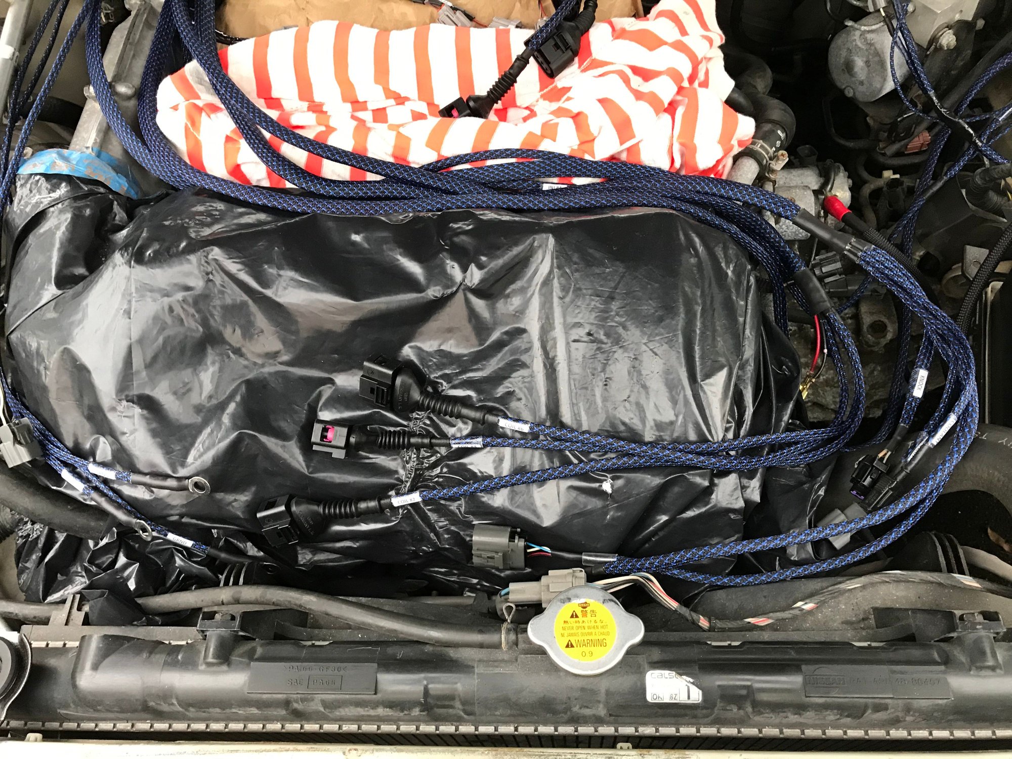

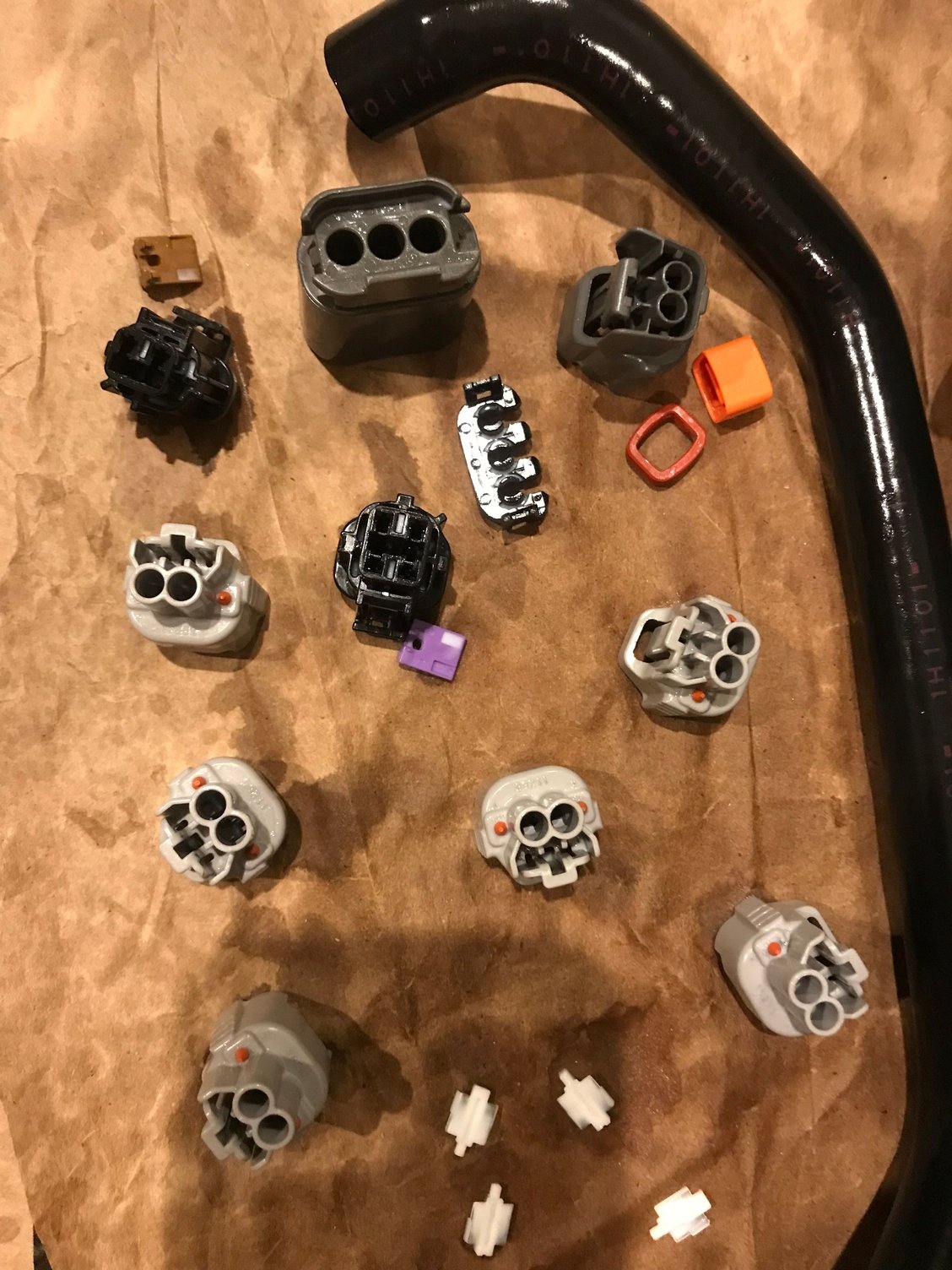

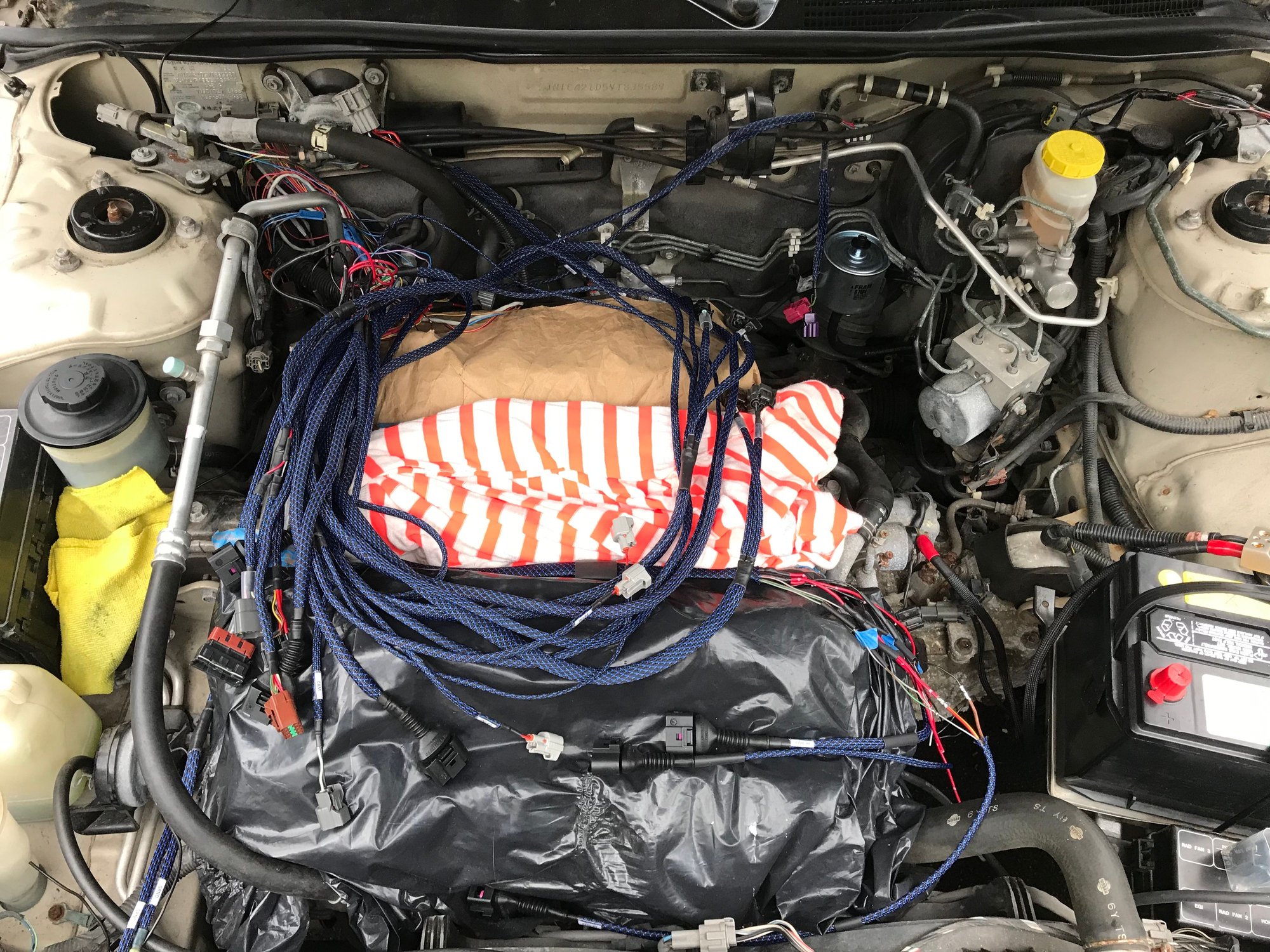

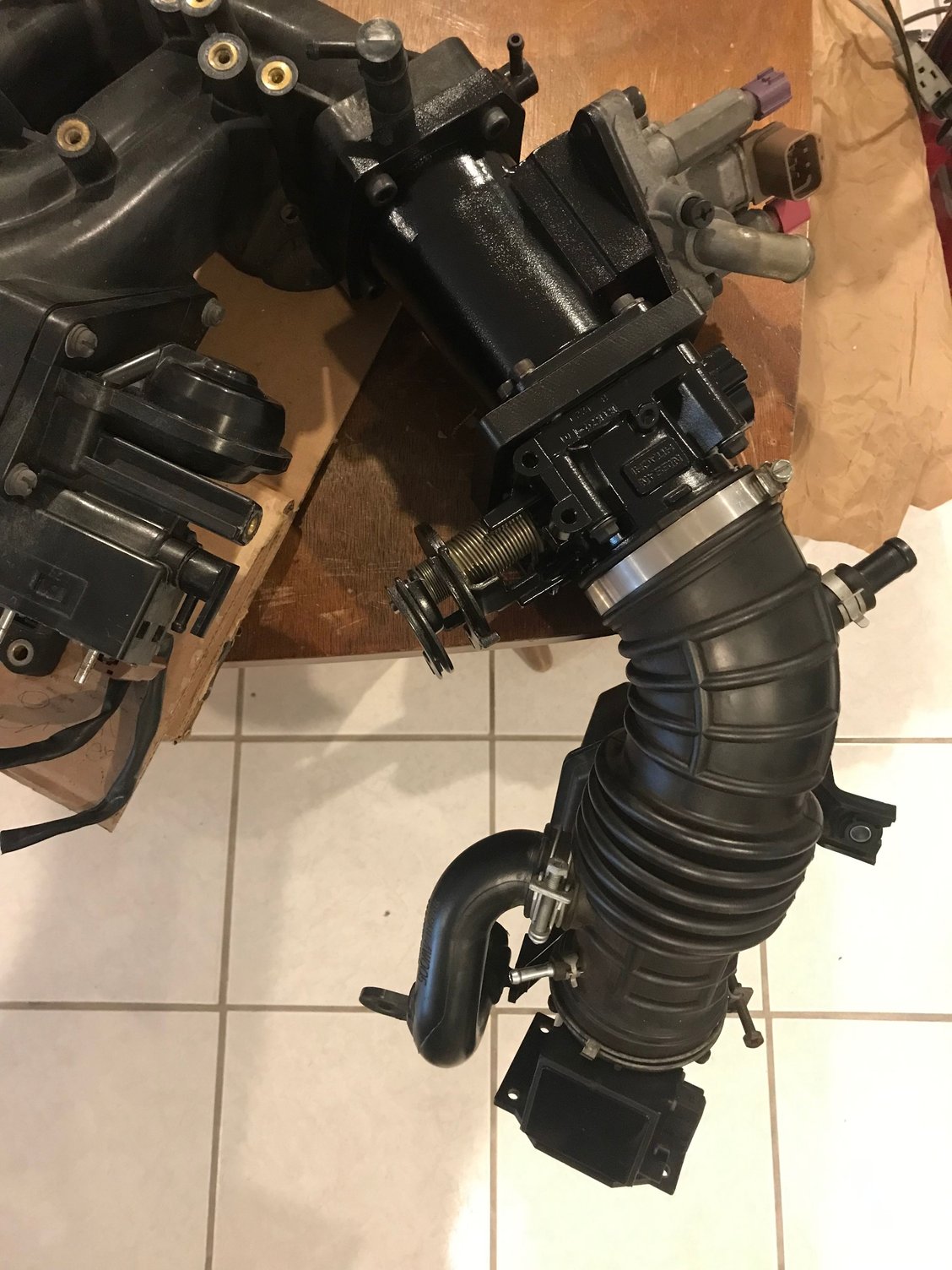

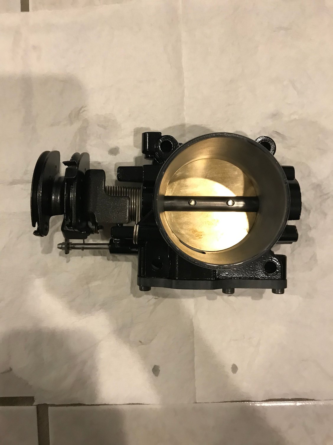

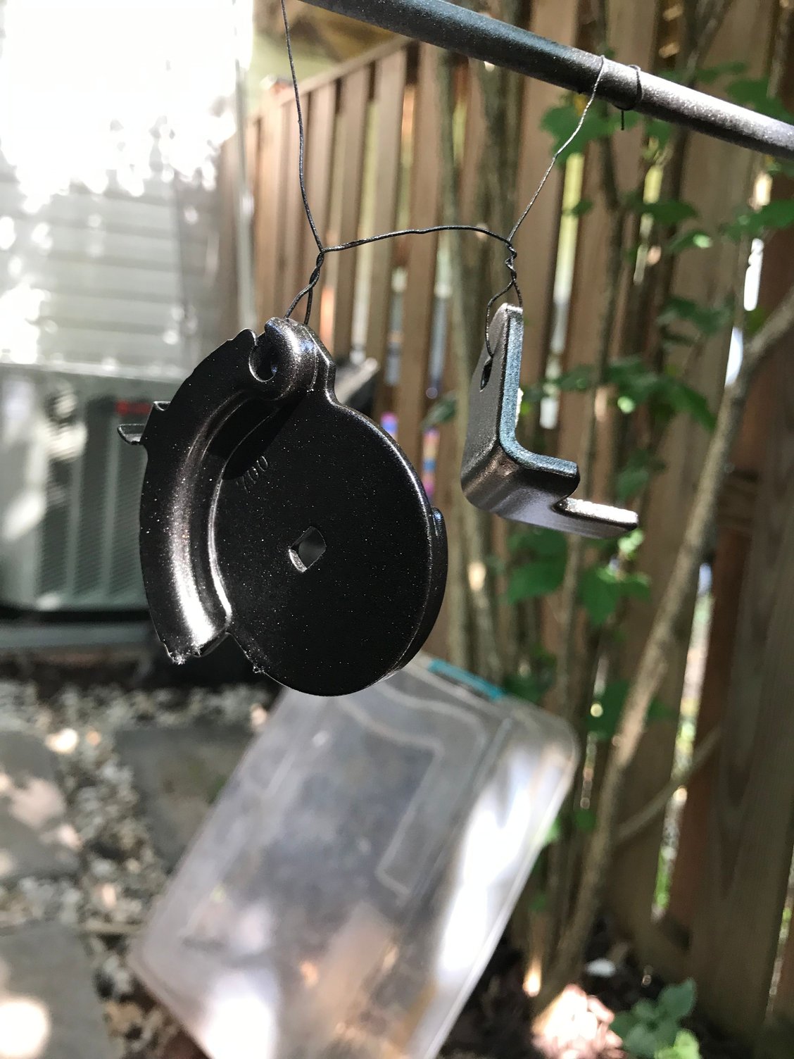

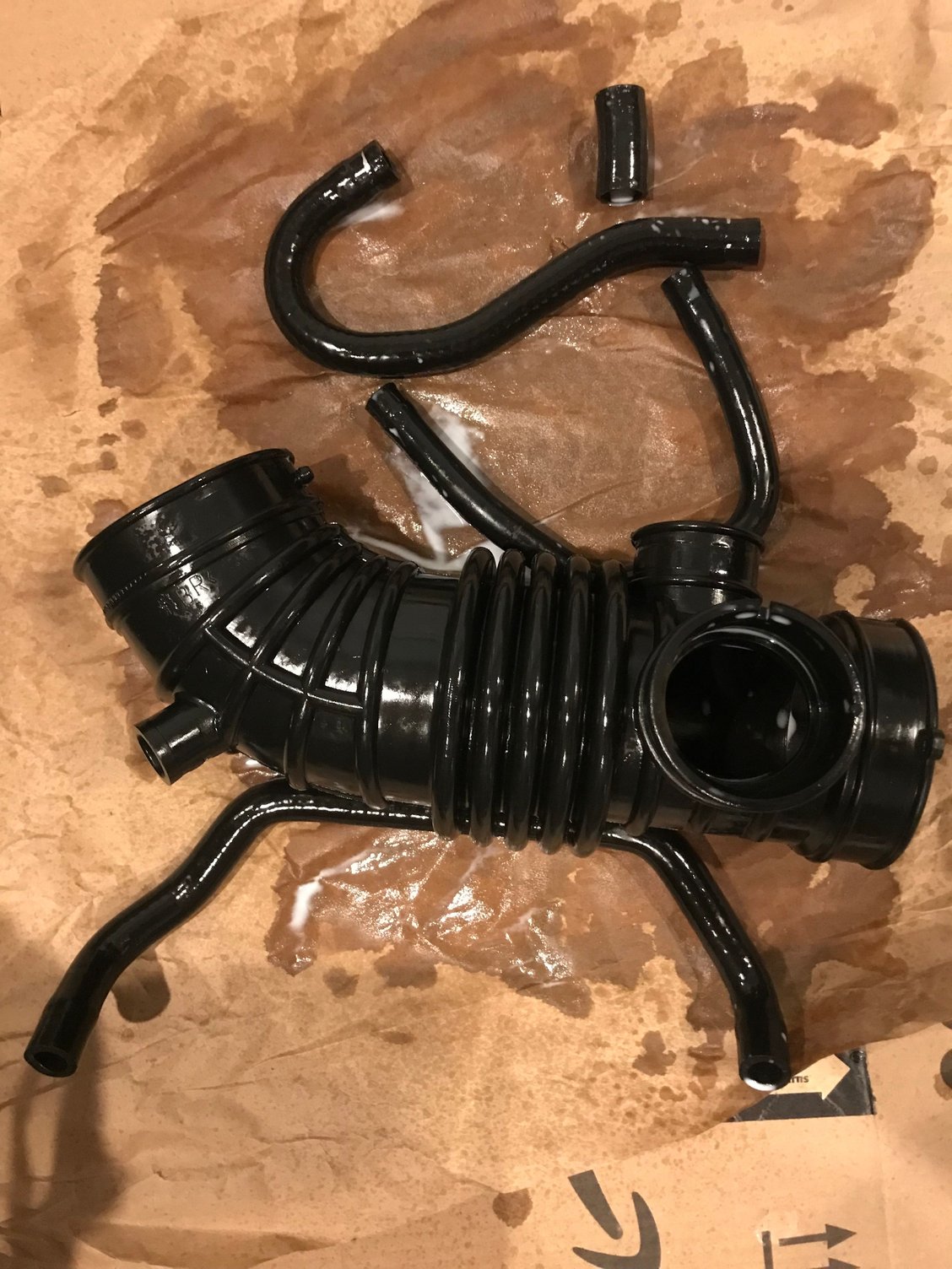

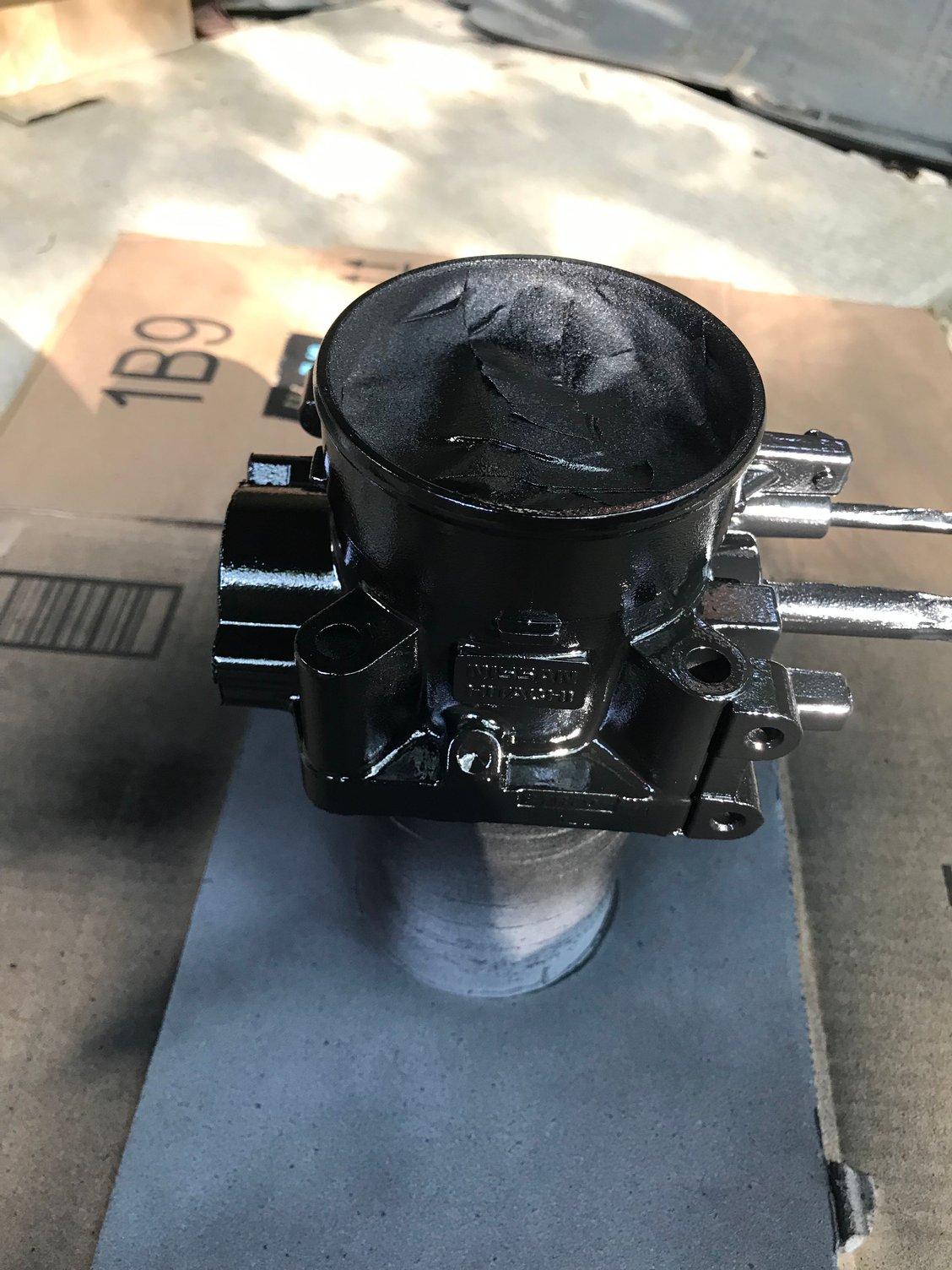

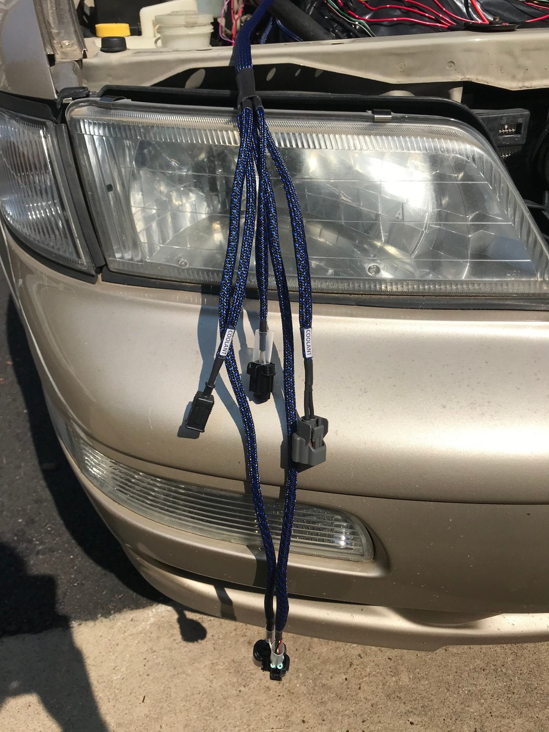

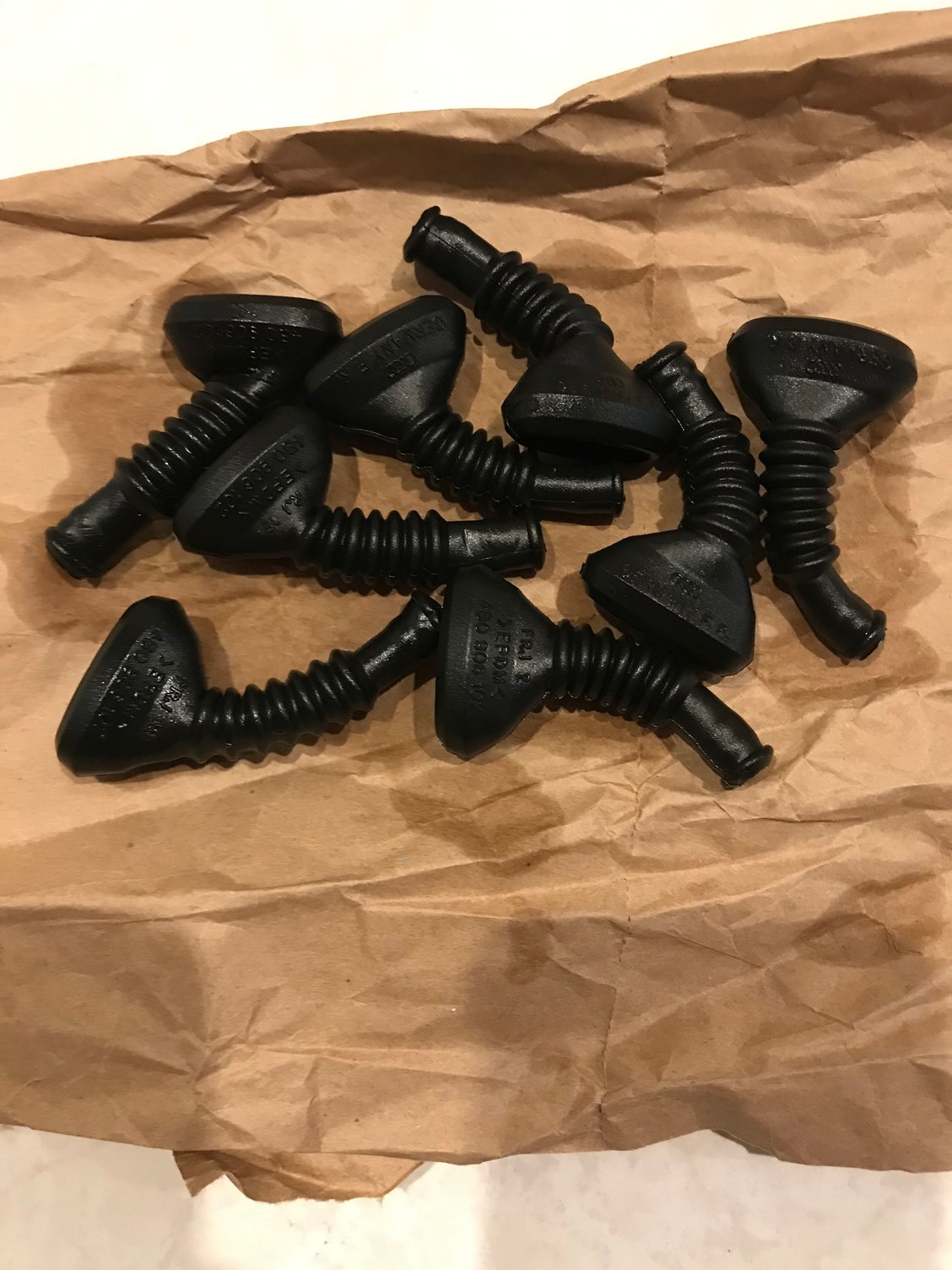

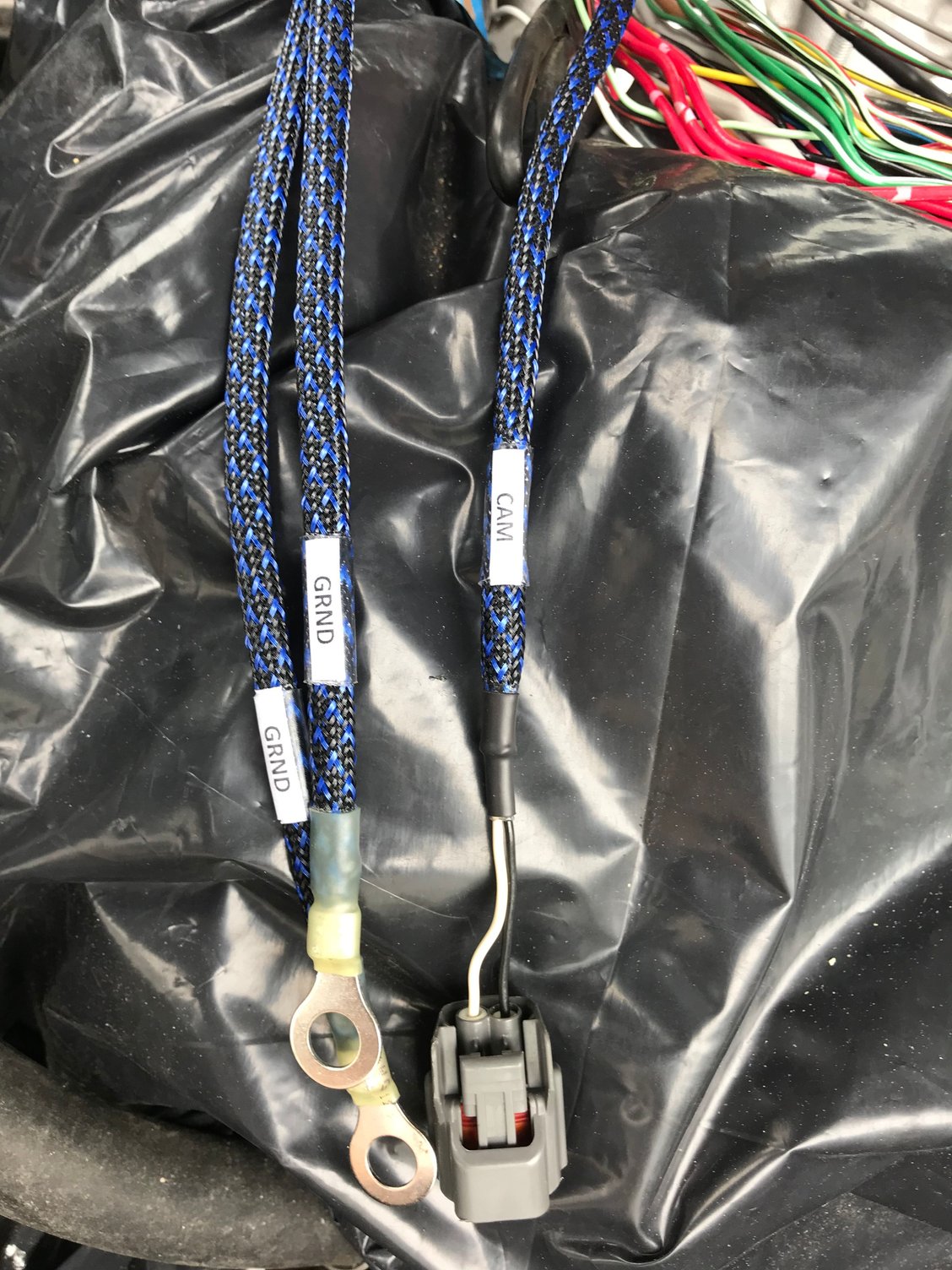

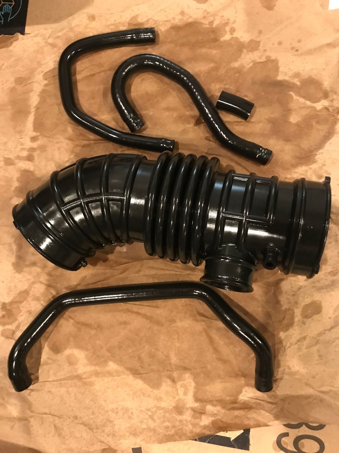

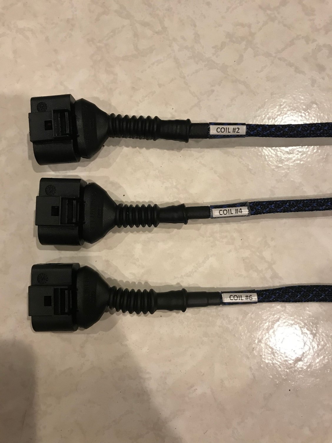

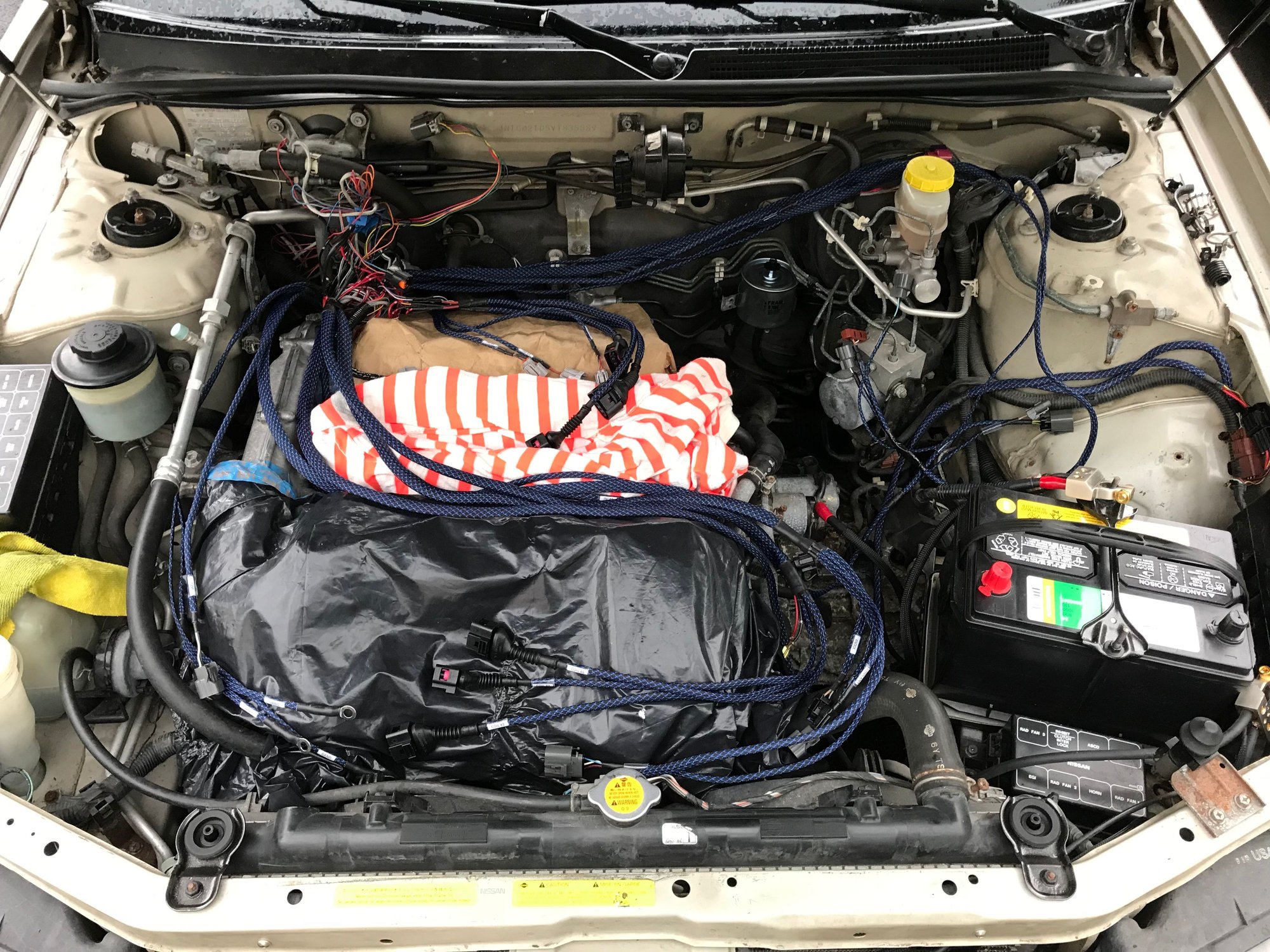

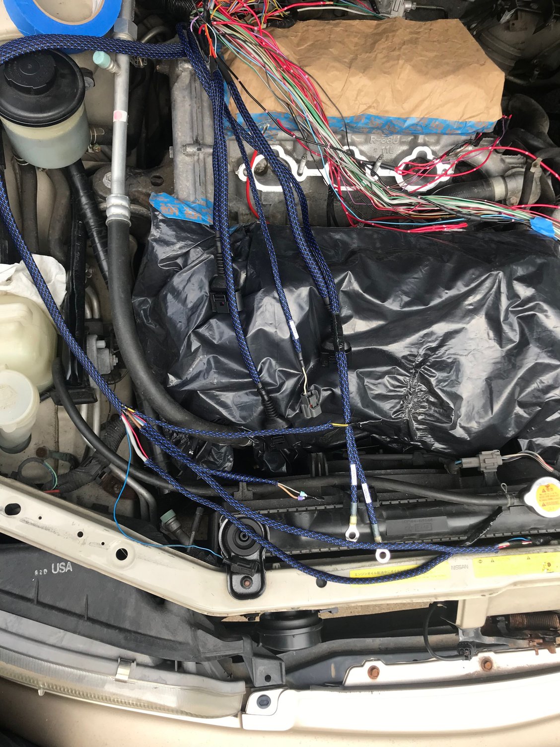

Update: Wiring and intake prep

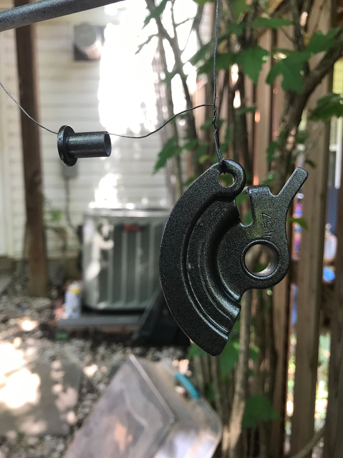

Test fit everything on the 00VI. More pictures of redoing wiring and prepped some parts with 303 treatment.
Ferhan

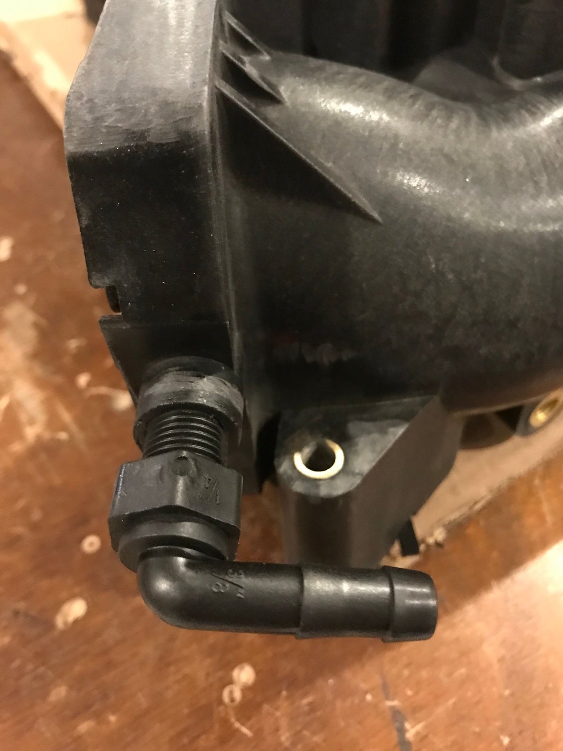

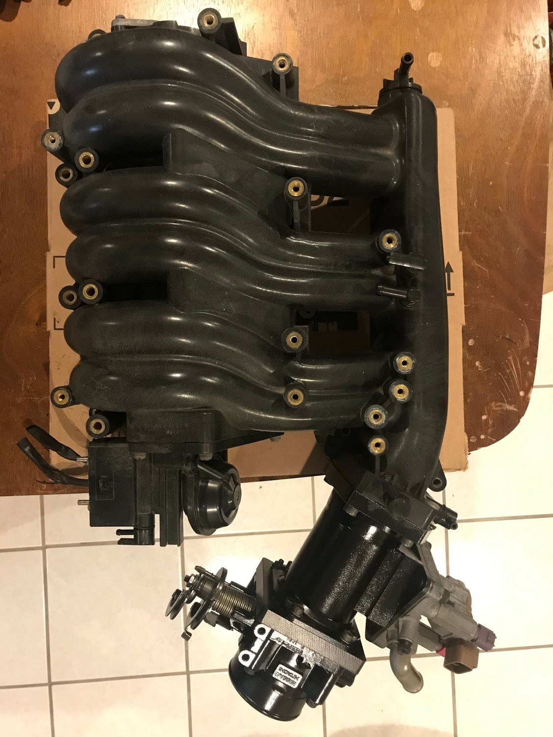

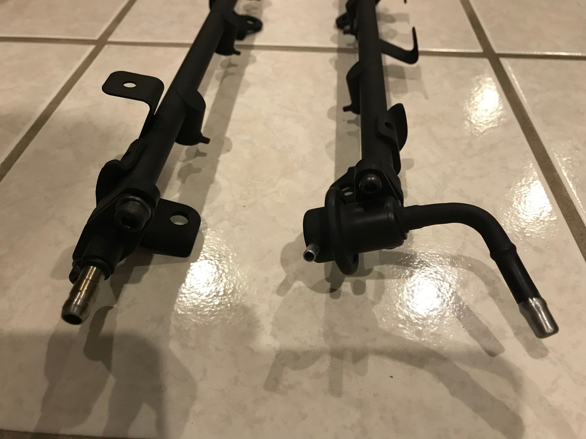

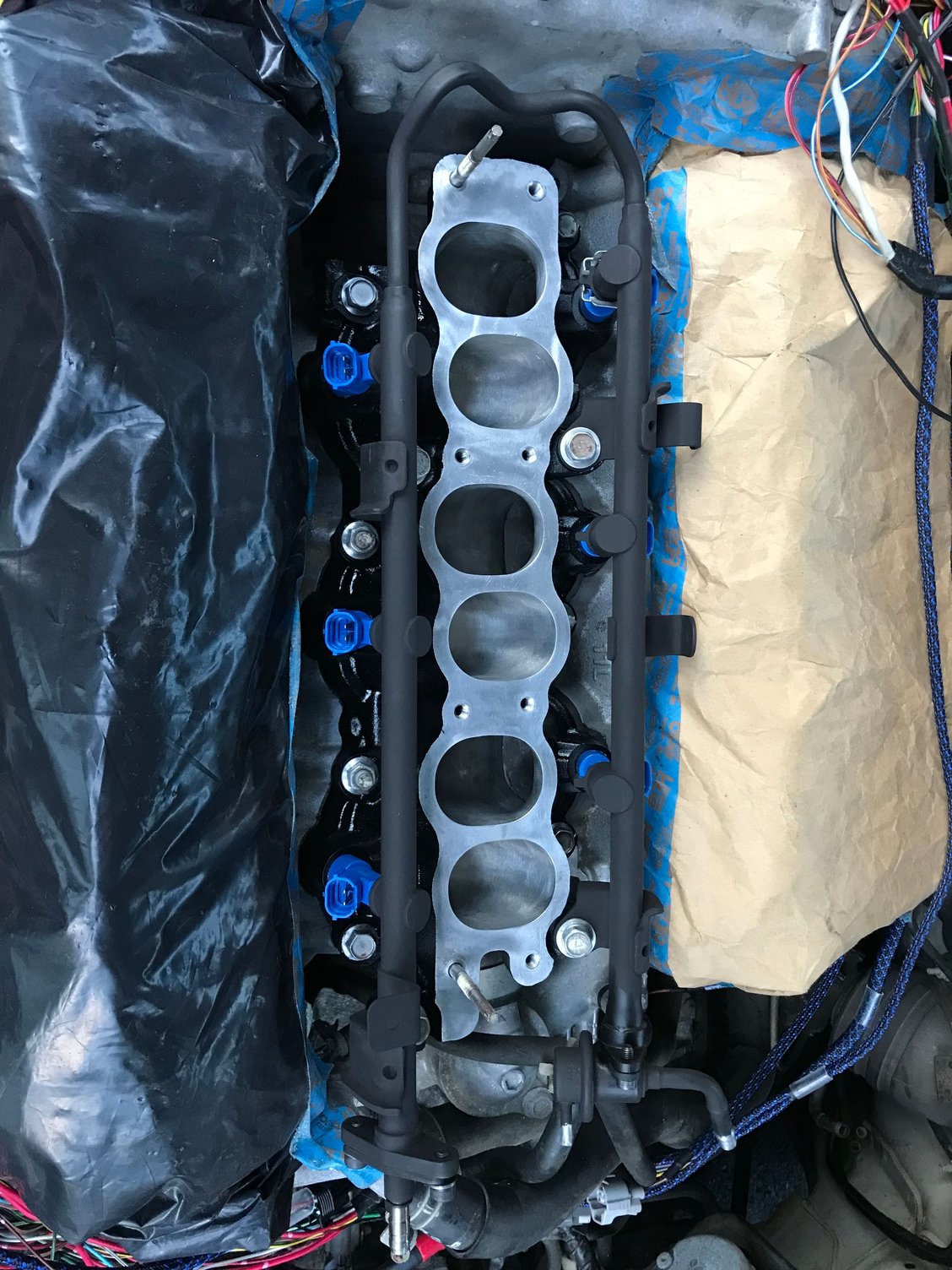

Adding more pictures

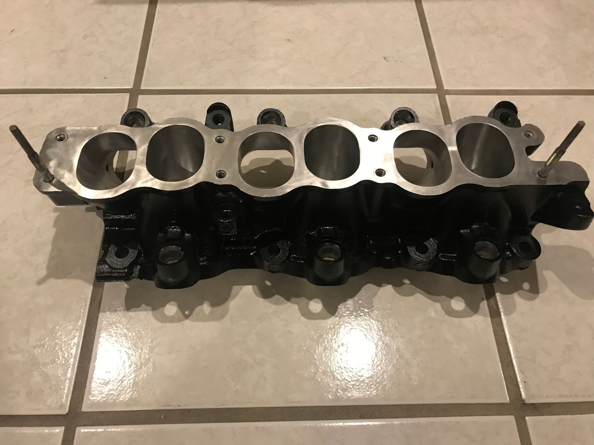

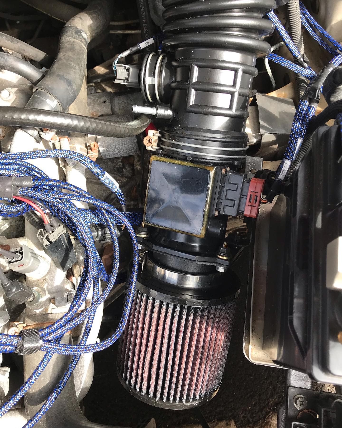

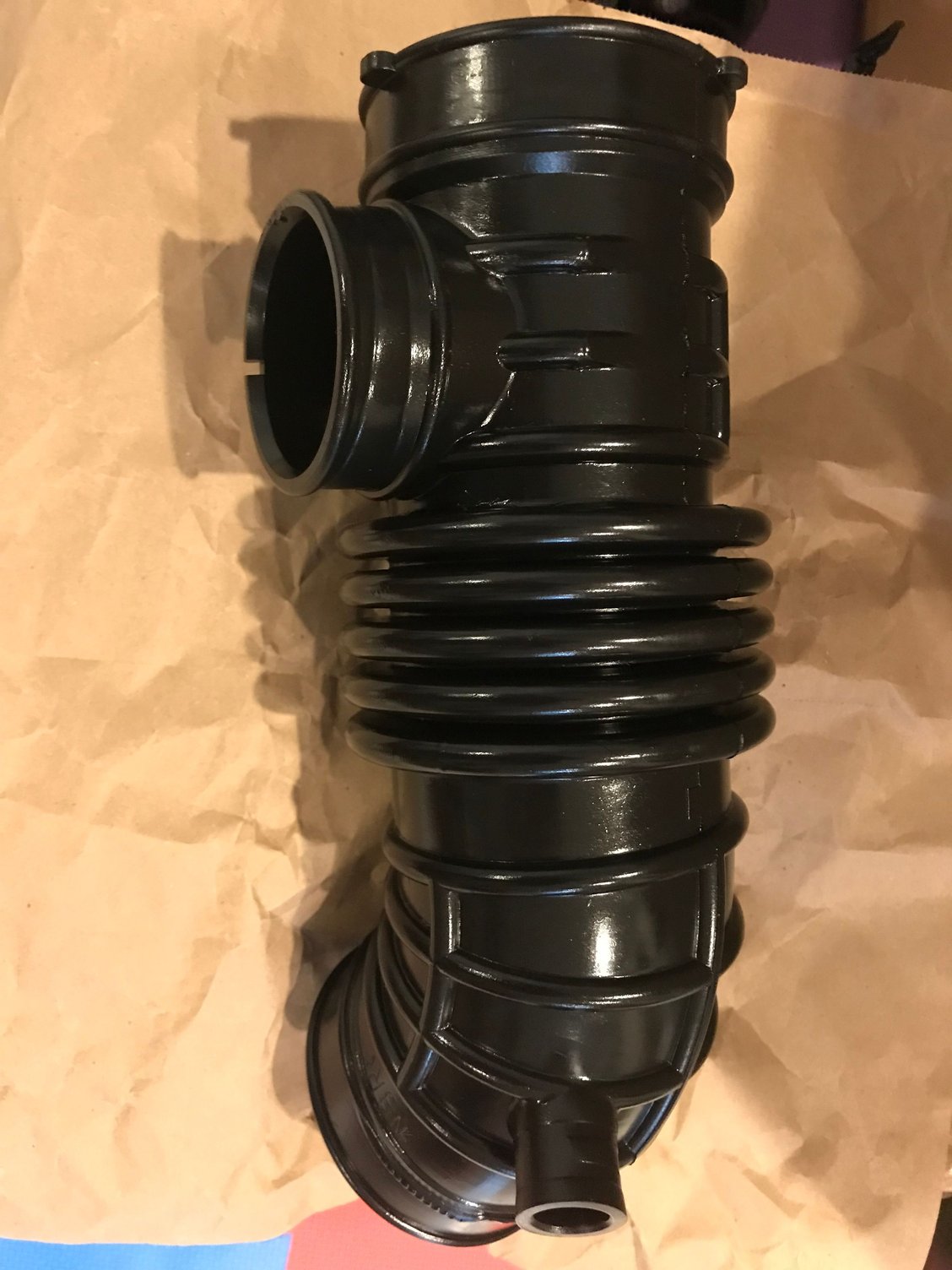

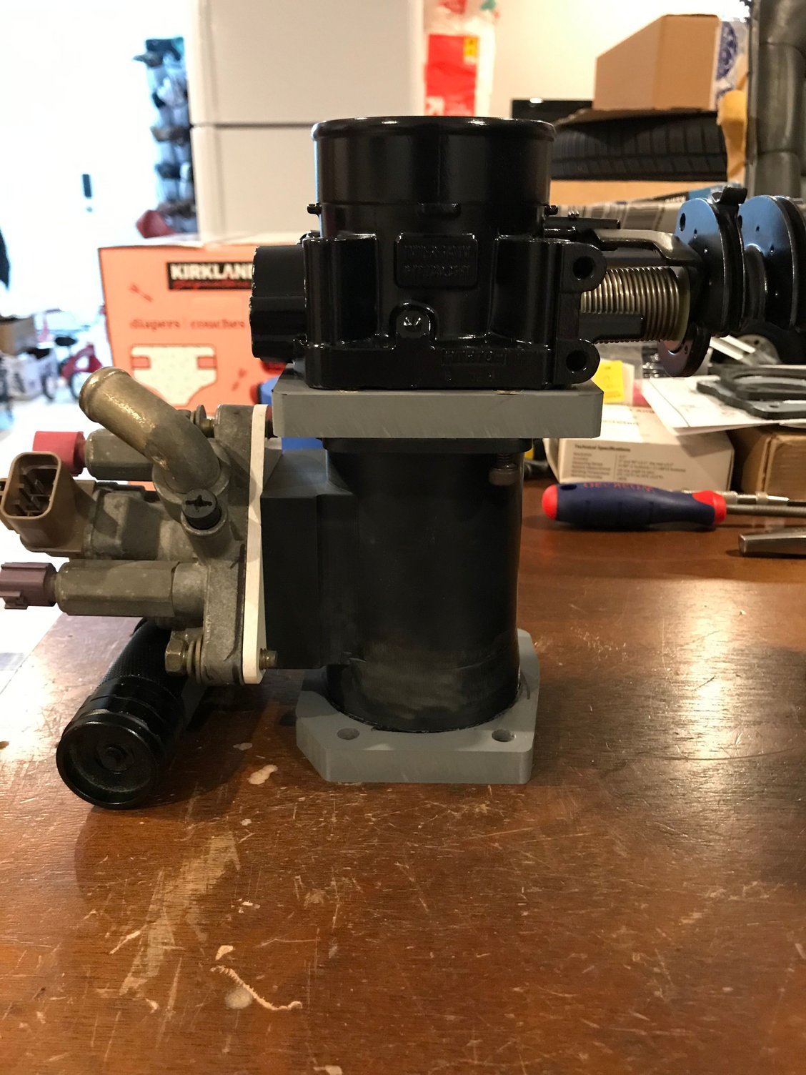

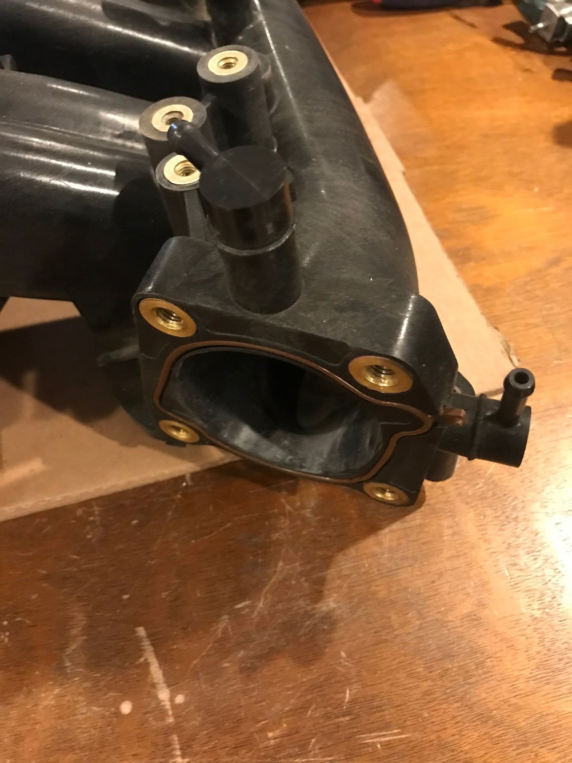

Most of the wiring is done. Just need to wrap it up. LIM with NWP spacers is now on and fuel rail with 550cc injectors as well. Pre-wired plug for Z32 MAF. Finished up with the engine cover, removed fittings off the 00VI and tapped on a larger one. Cleaned up top of fuel tankard plugs, replaced fuel lines and applied dielectric grease.
Ferhan
Old Oct 6, 2021 | 07:21 PM
RA030726's Avatar
I'm nutty for Nissans
Posts: 9,311
I'm glad to see the extra effort and little details going it to this.

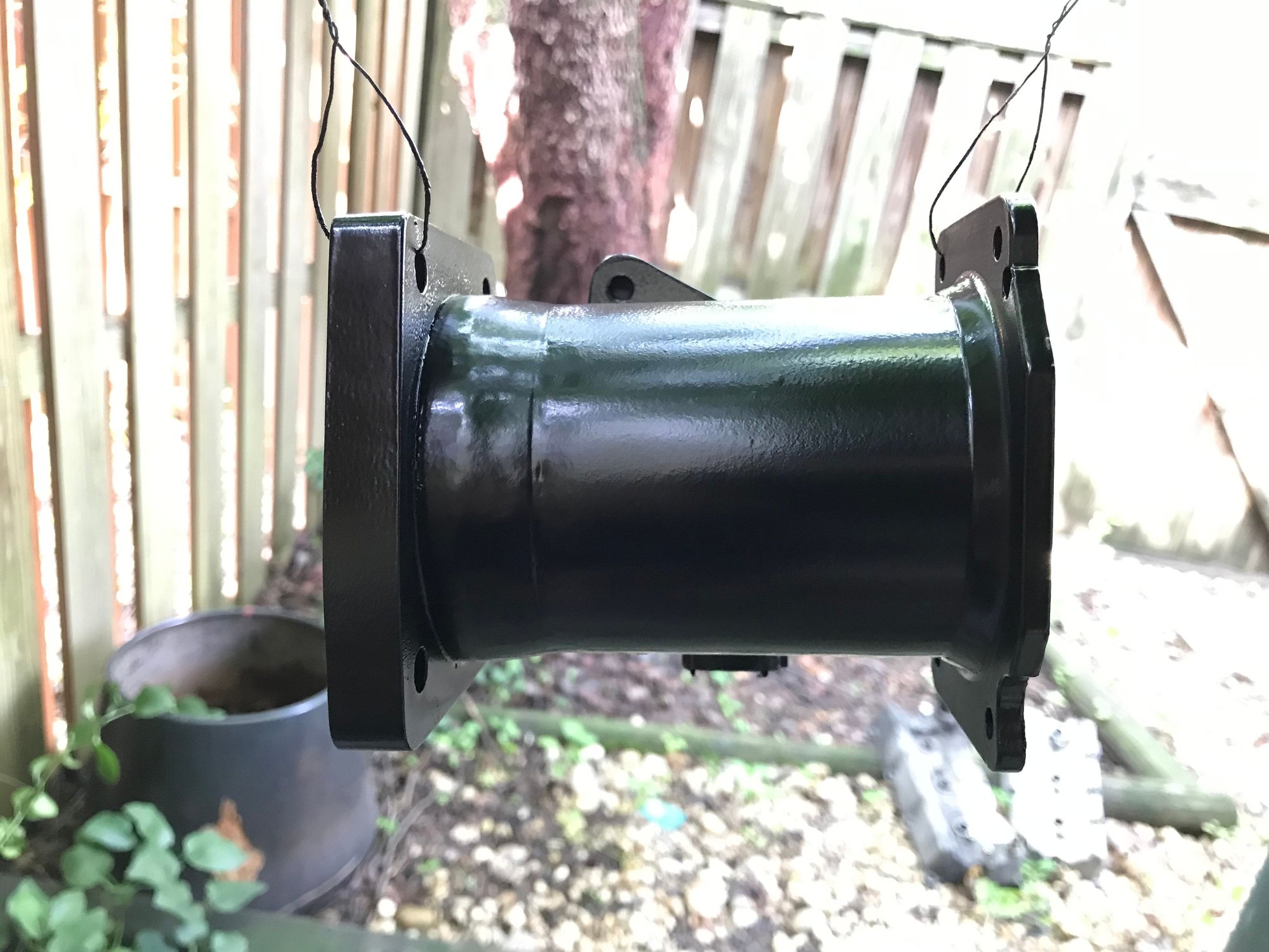

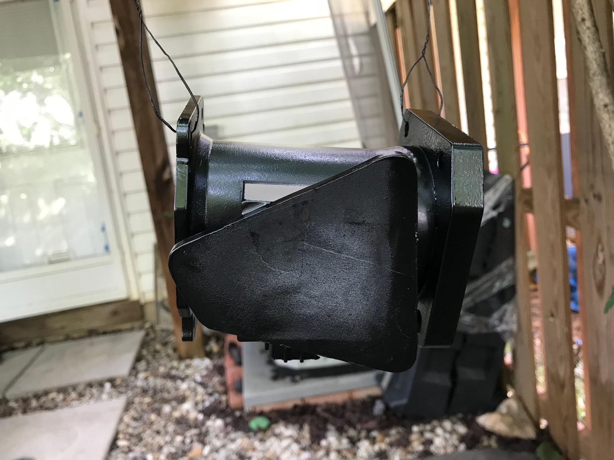

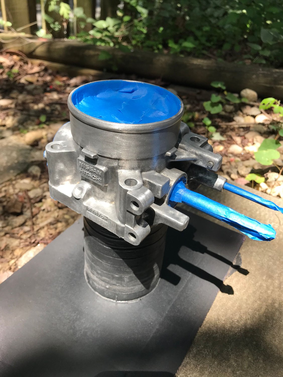

Is the IACV adapter made from a MAFS?
How long does the 303 last? Does it dry or stay wet?
Old Oct 7, 2021 | 07:26 AM
furbiss112's Avatar
Posts: 891
From: Vernon Hills, IL/ Alexandria, VA
Thanks.
Yes, I used a bad MAF to make the adapter. It basically allows me to use the PFTB and mount the IACV in one go. Also increases the air volume of the intake manifold. Though I may not be able to use it as is. I ended up changing plans and made this off the car without rechecking my measurement. This is a bit too long and interferes with the ABS module. Either I have to modified it or start over but no big deal. I picked up another MAF tube to play around with incase I decide to sell this one to someone with no ABS.
The 303 last for a while, at least several months if not longer. It's is used by NASA so has to be good. LOL. I use it on everything I can. It will be absorbed and dry. The surface will be a bit oily/slippery when it is. A lot of people use it on their tires to make them last 2 to 3 times longer than they should.
Here is a picture of the intake pipe as of today. Still a little wet and shiny. The previous picture was taken 08/18.
Ferhan
Old Oct 7, 2021 | 08:02 AM
95maxrider's Avatar
Lightly modded
iTrader: (32)
Joined: Nov 2001
Posts: 7,742
From: Herndon, VA

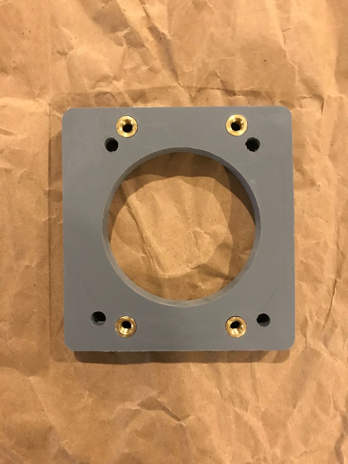

Wow, so how did you make the parts for the IACV pipe and assemble them all? That's pretty ingenious. And yeah, that loom work is incredible! That's going to be one sexy engine bay when you're all done.
Old Oct 7, 2021 | 08:55 AM
furbiss112's Avatar
Posts: 891
I ended up using PCV to make the flanges. Countersank the MAF housing into it and used epoxy to hold it altogether. You could also use JB Weld.
Ferhan

Maybe I'm late to the party but is this just a stock DE-K going in? Or 00vi swap?
And have we cracked open either of these motors and done some work or just dropping it in.
Just wondering.
Old Oct 7, 2021 | 09:17 PM
furbiss112's Avatar
Posts: 891
Full DE-K swap with 65K miles. Just playing around with it for now. The LIM was slighted port and polished along with the intake side of the heads. I also ported out the 00VI a bit so it is not as restrictive. I have a bunch of parts laying around from a previous Maxima build but not sure what I will do with them just yet. The built motor is my other project car.

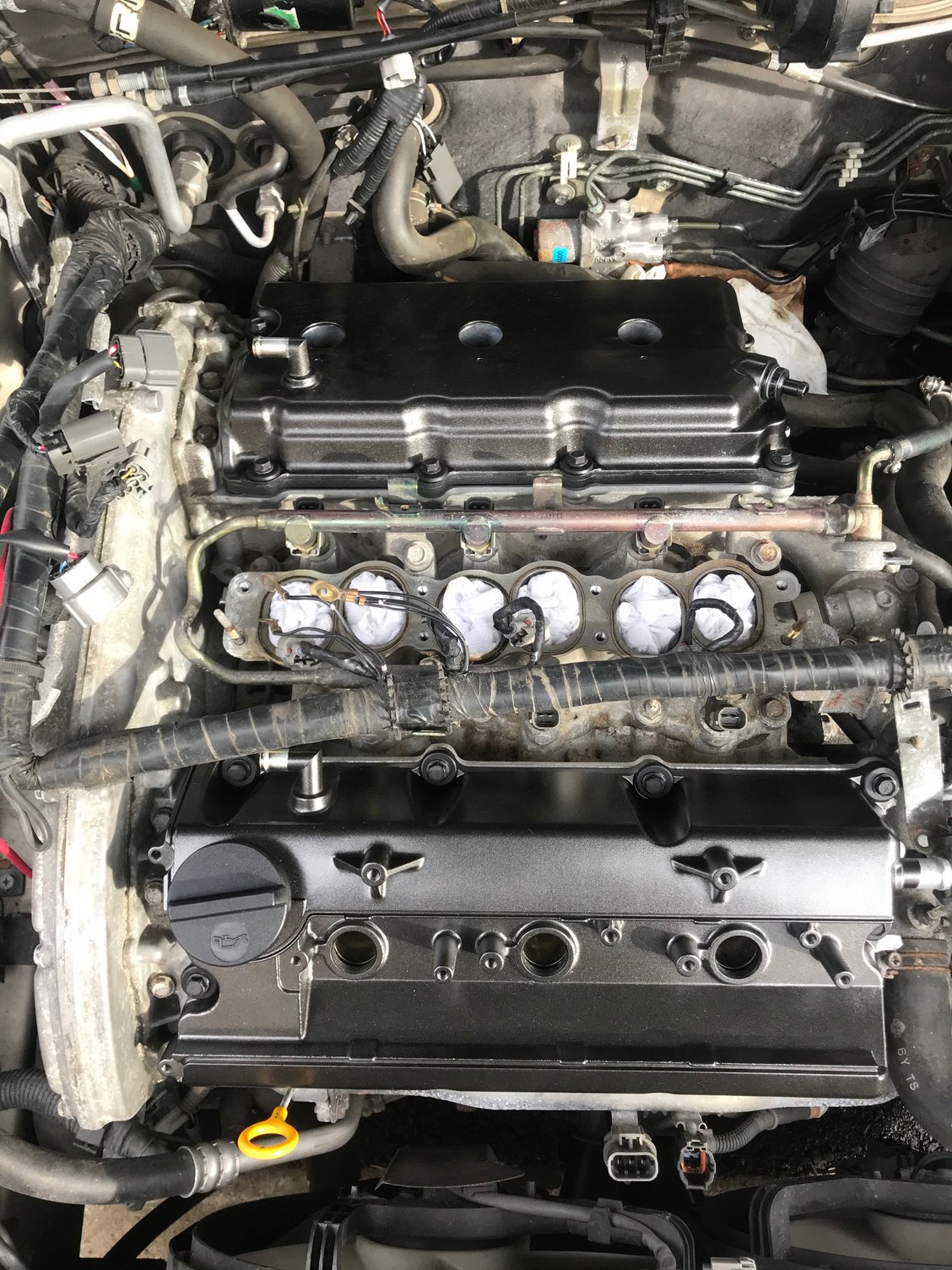

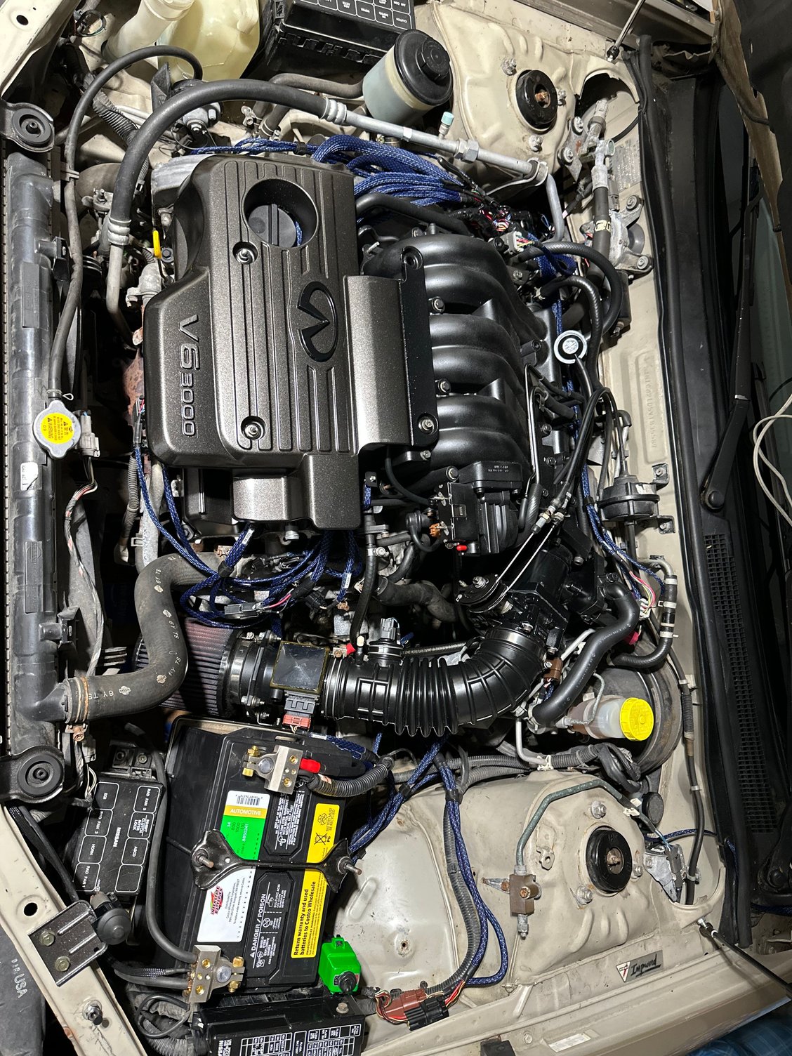

Engine bay is pretty much back together now. A few minor things to wrap up but she is now ready to be started.

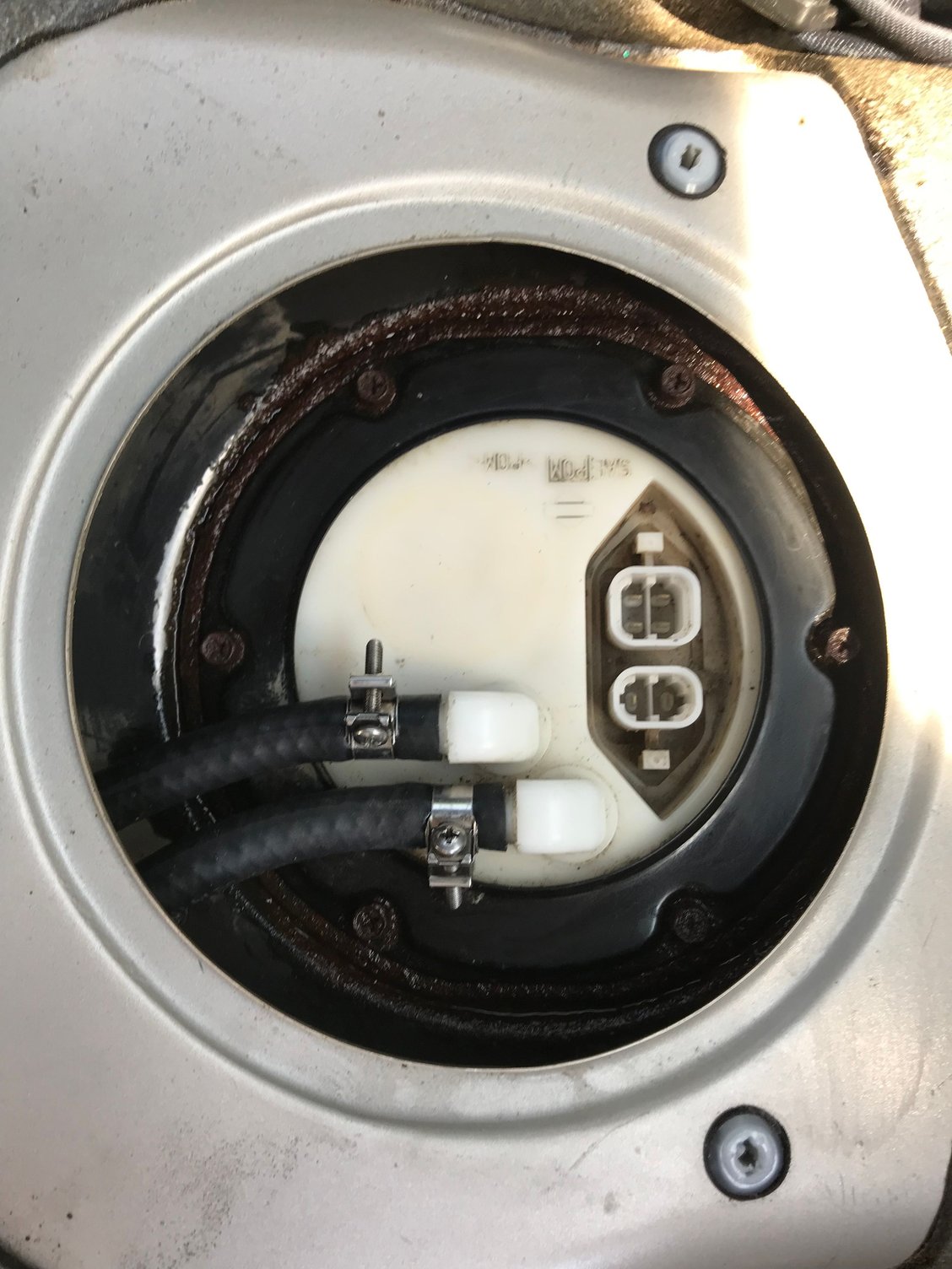

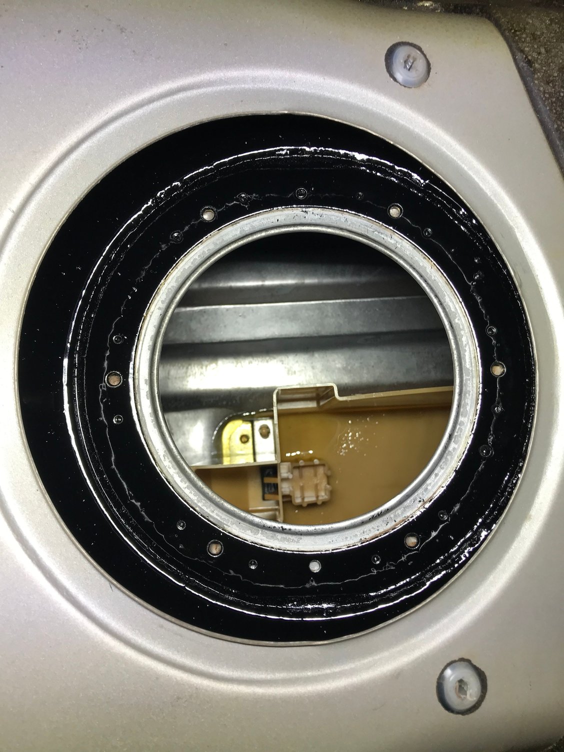

Adding pictures and update

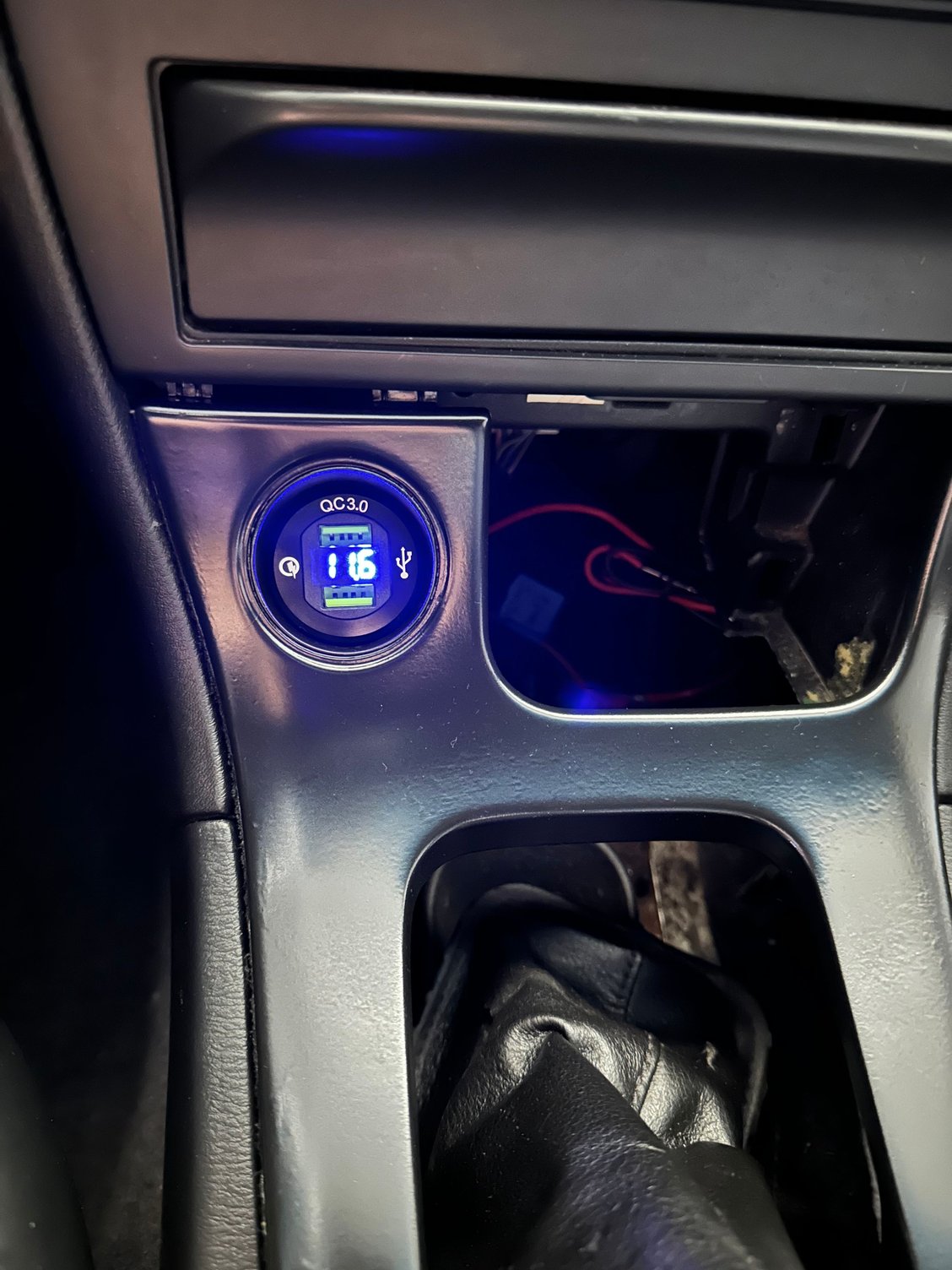

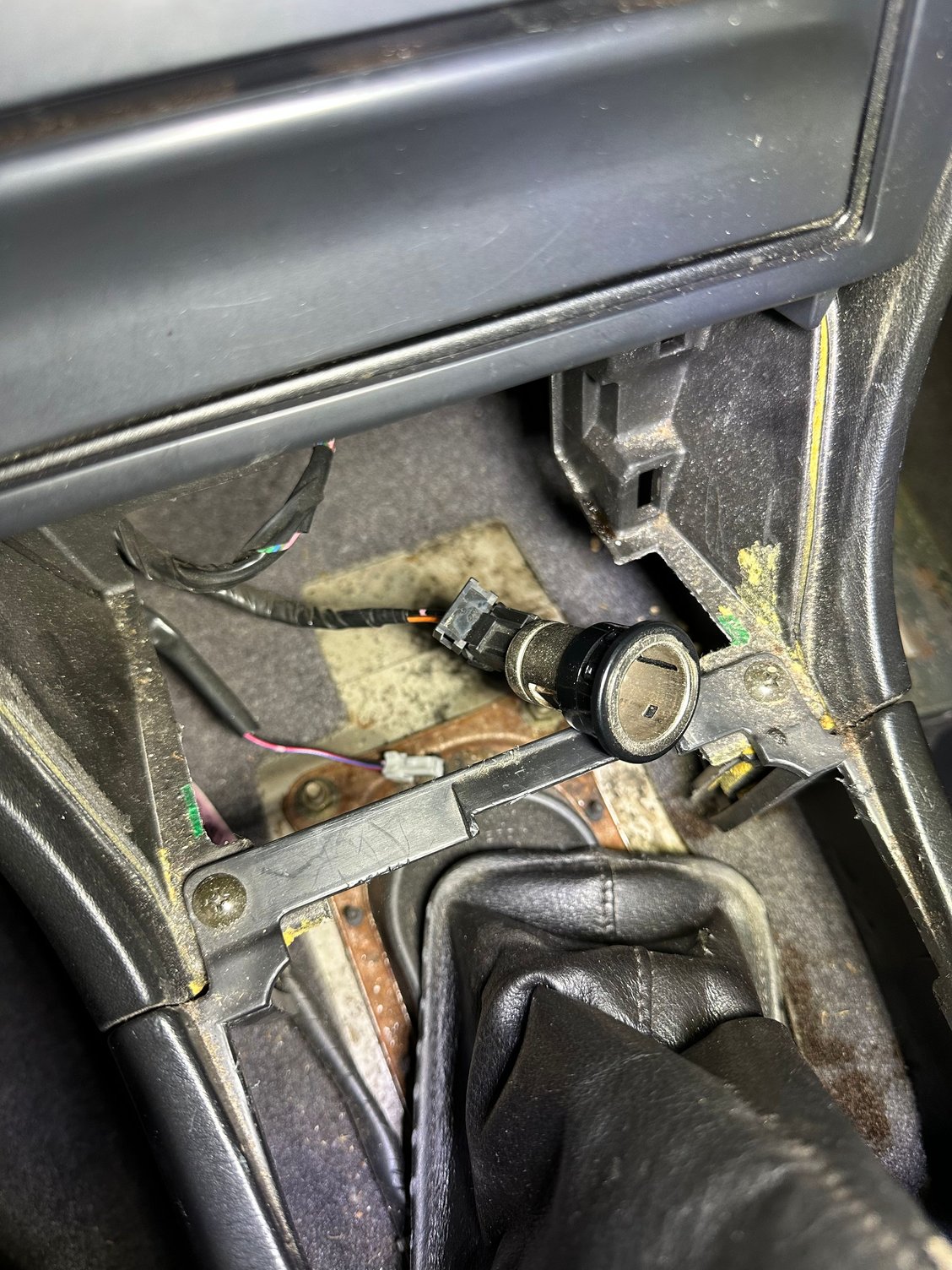

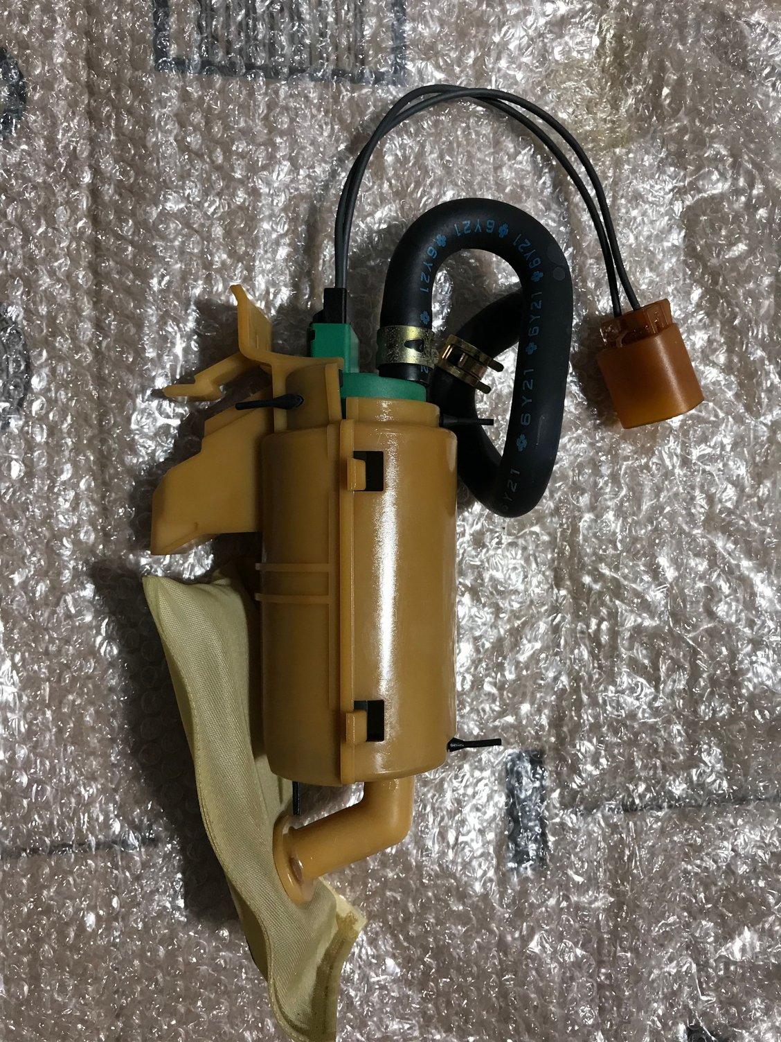

All buttoned up and running again.

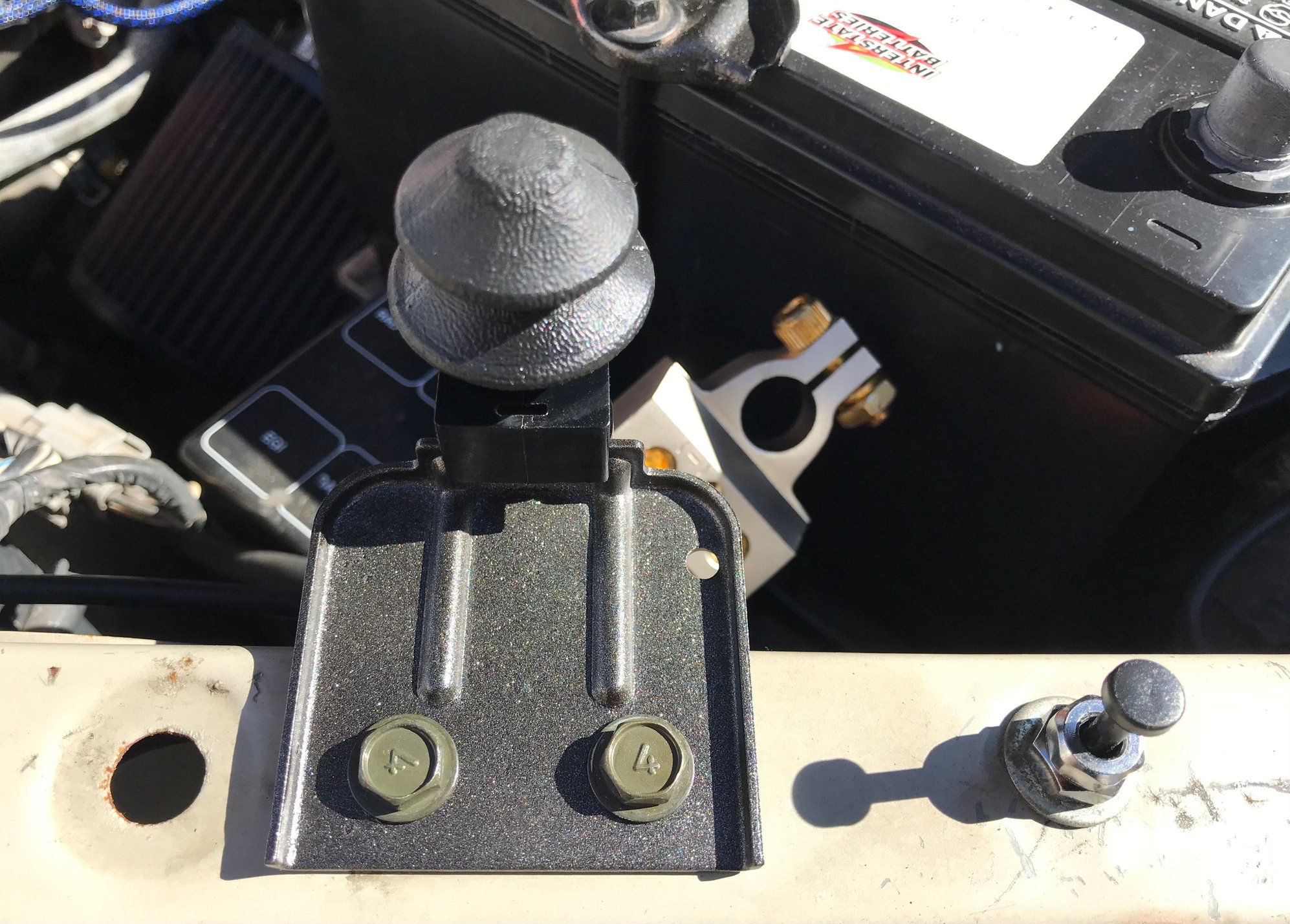

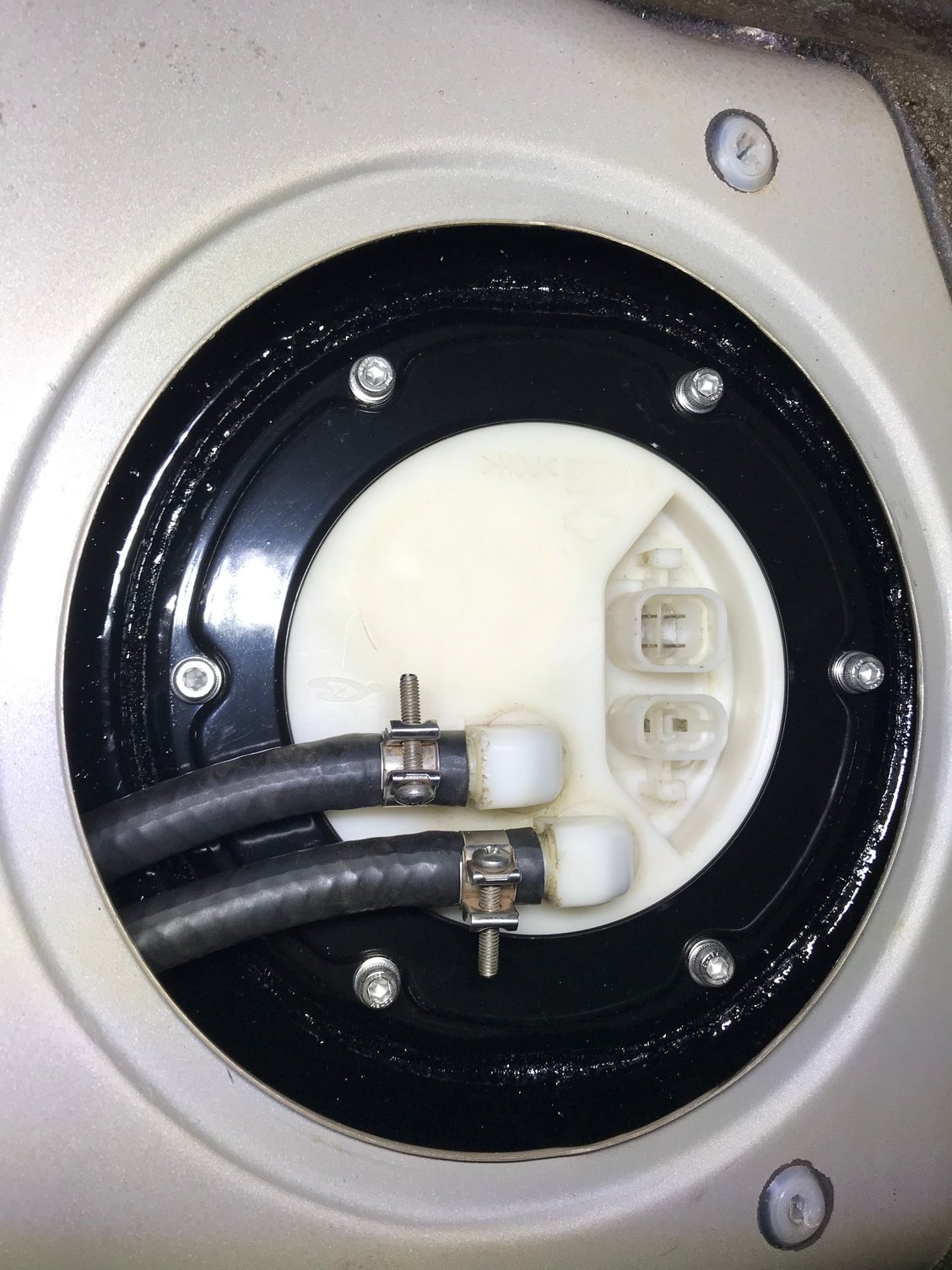

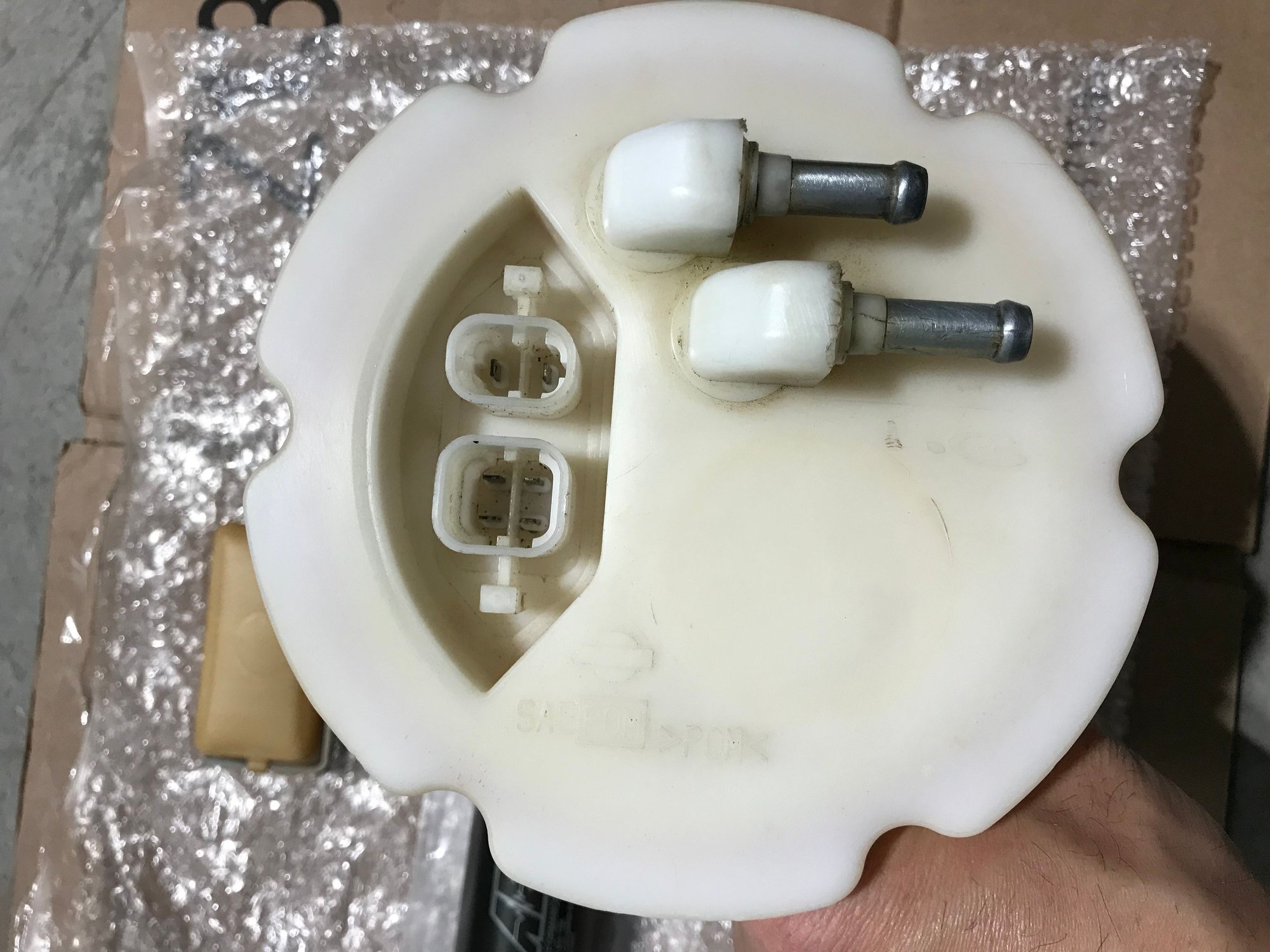

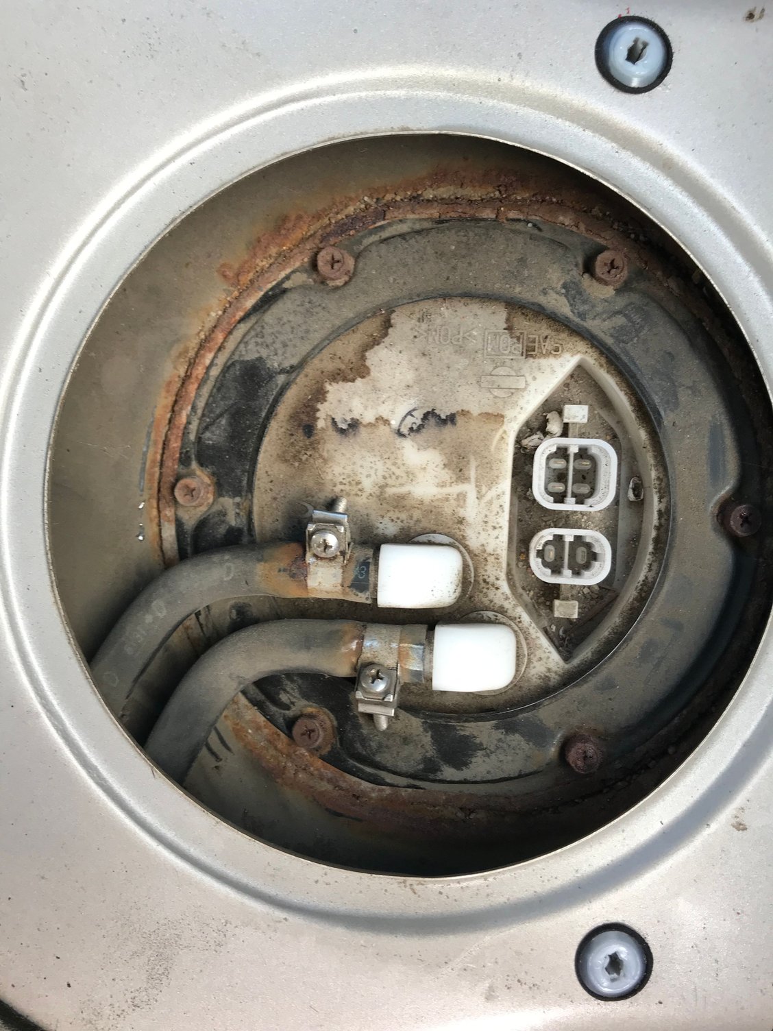

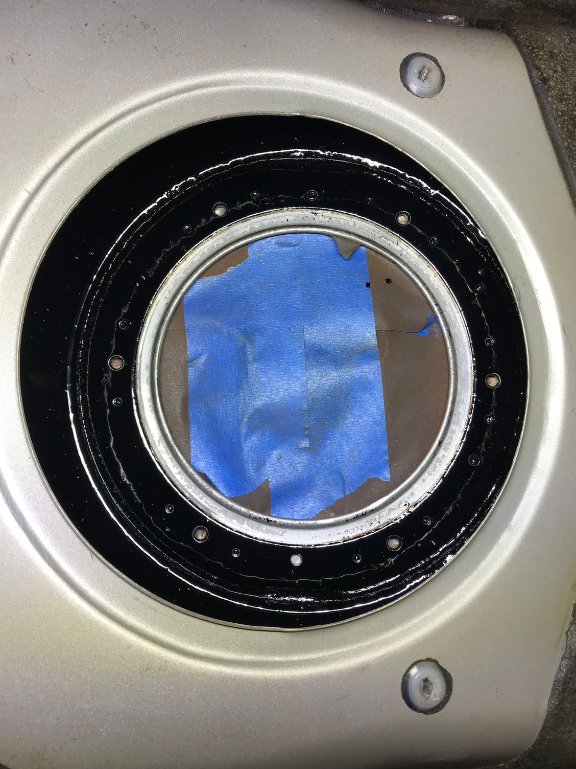

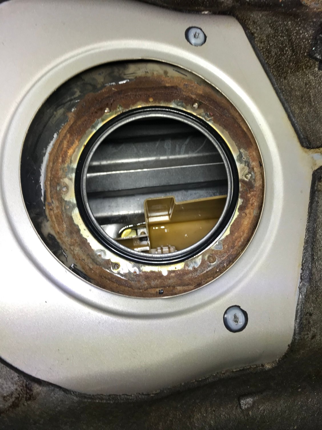

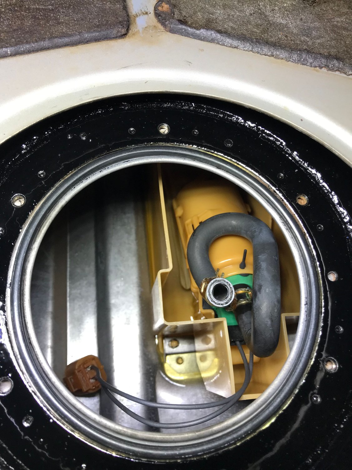

Finished cleaning up the fuel tanks and installed new fuel pump.

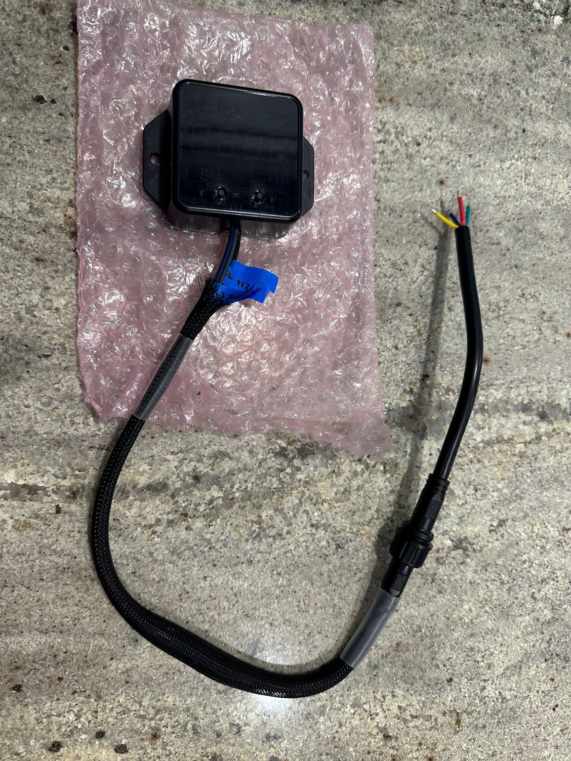

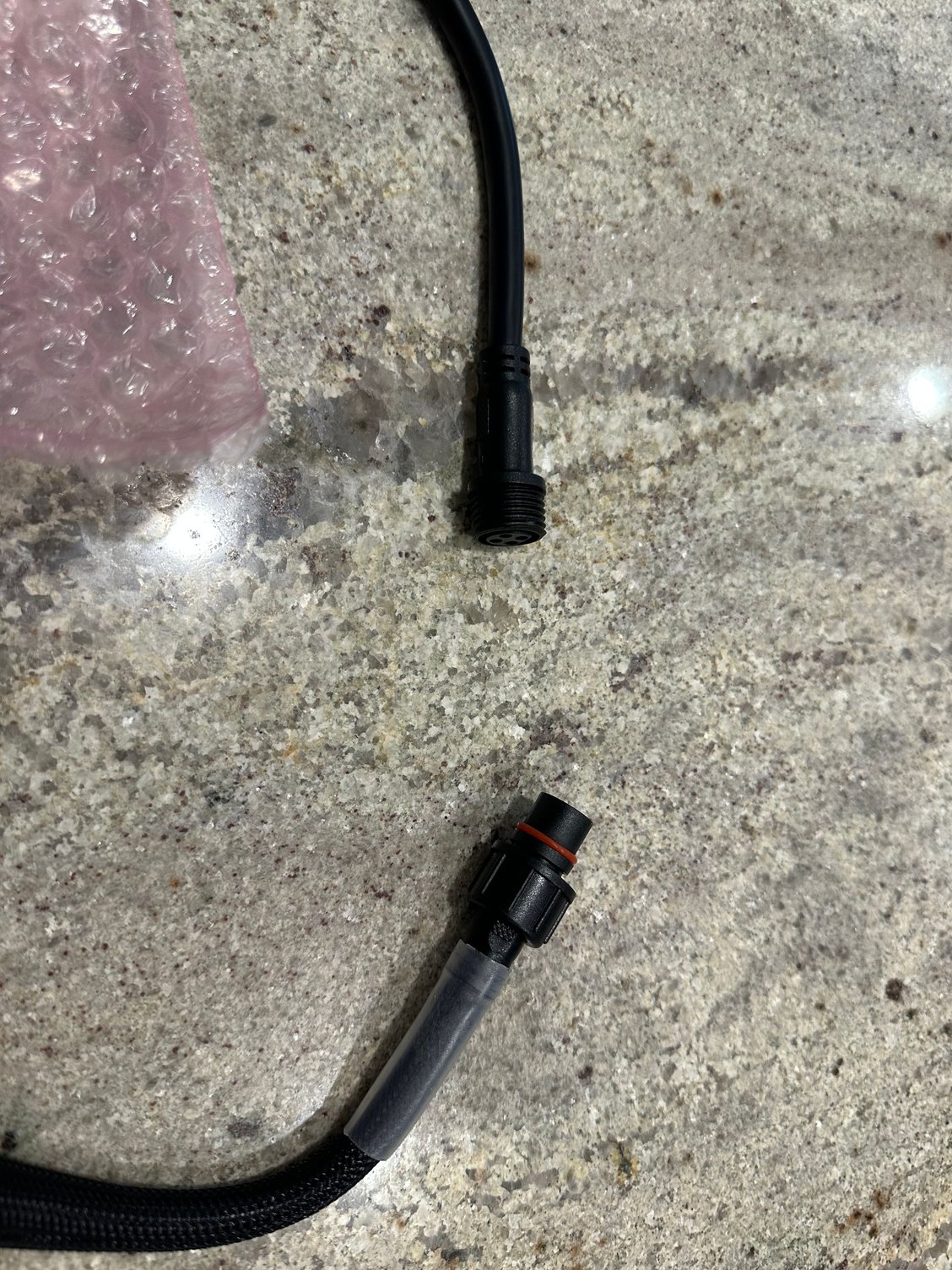

under hood light setup to work on open/close or by a switch.

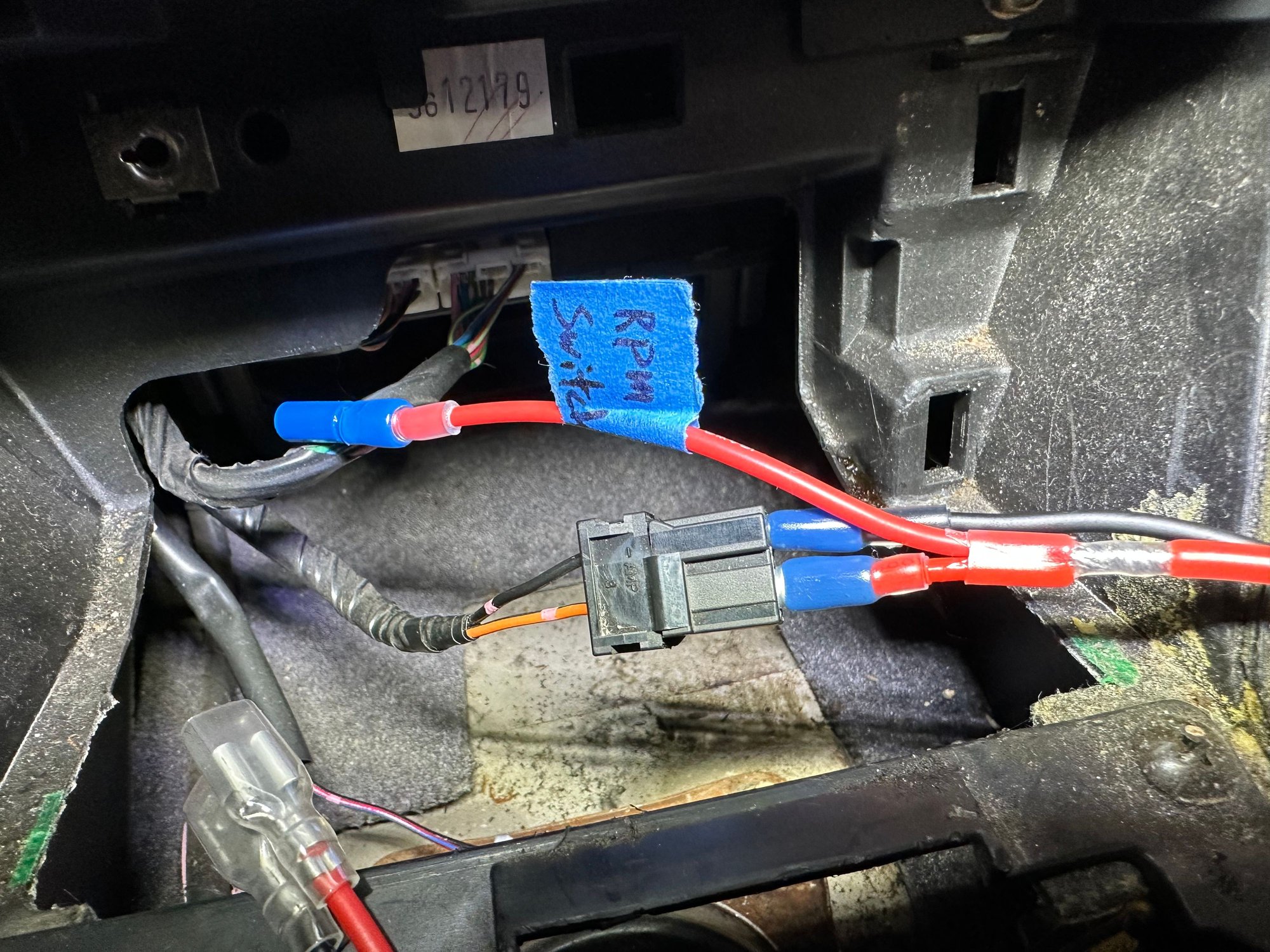

Almost done with wiring the rpm switch for the 00vi.
Ferhan

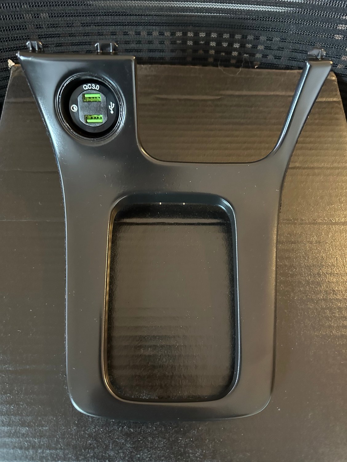

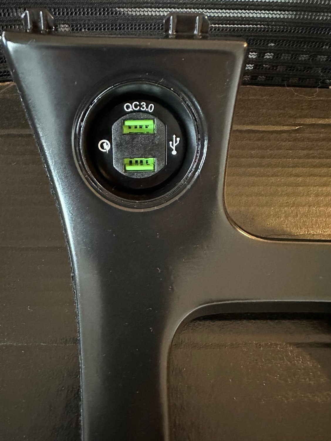

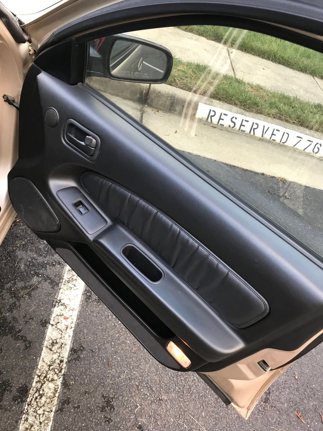

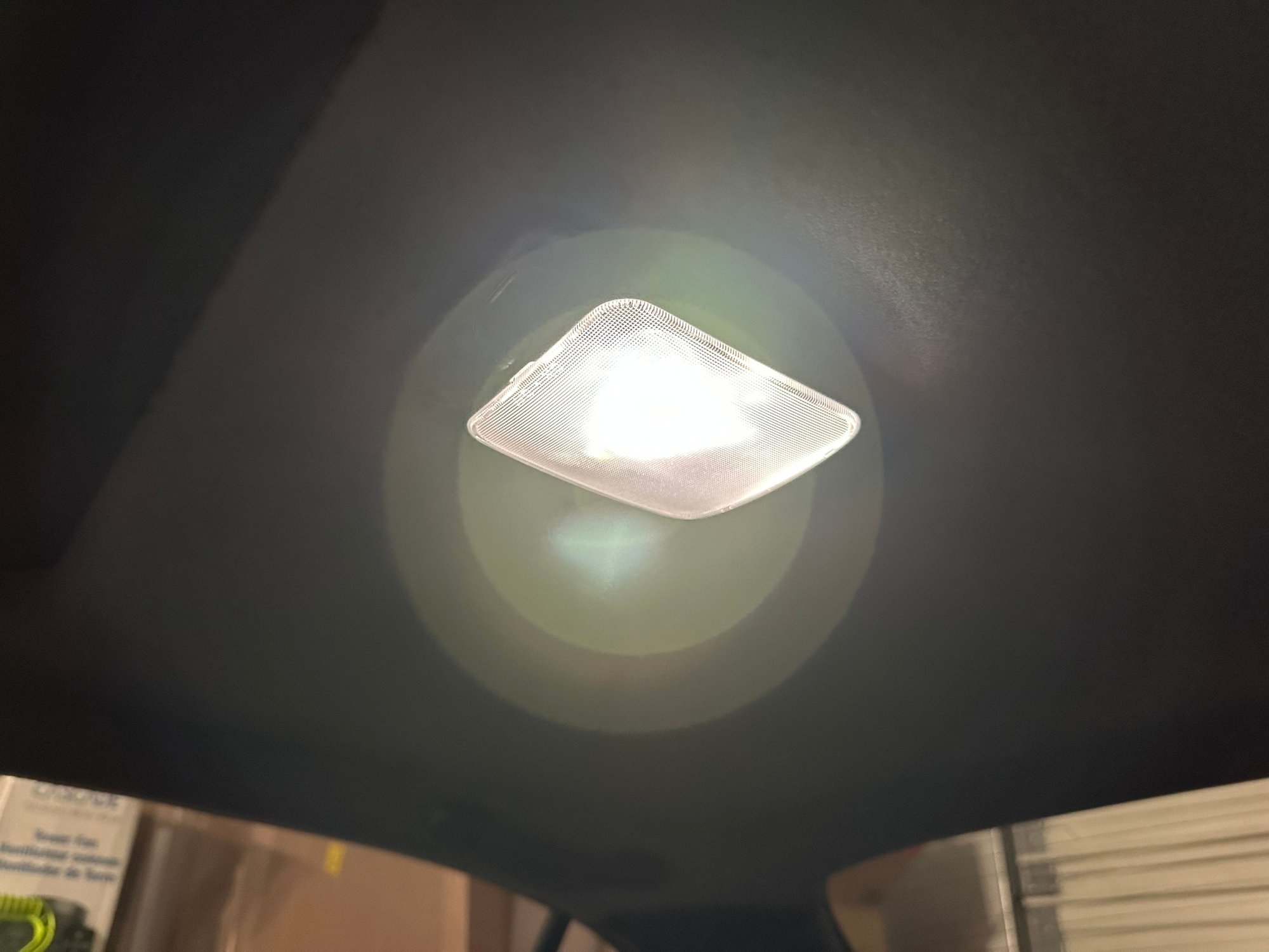

Pictures and updates
More pictures.

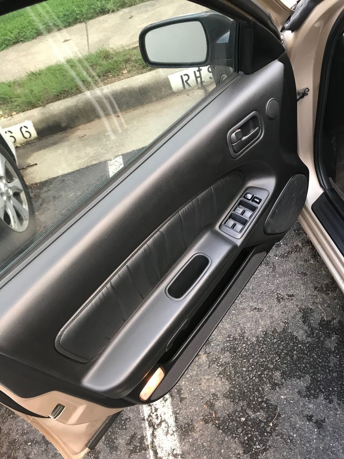

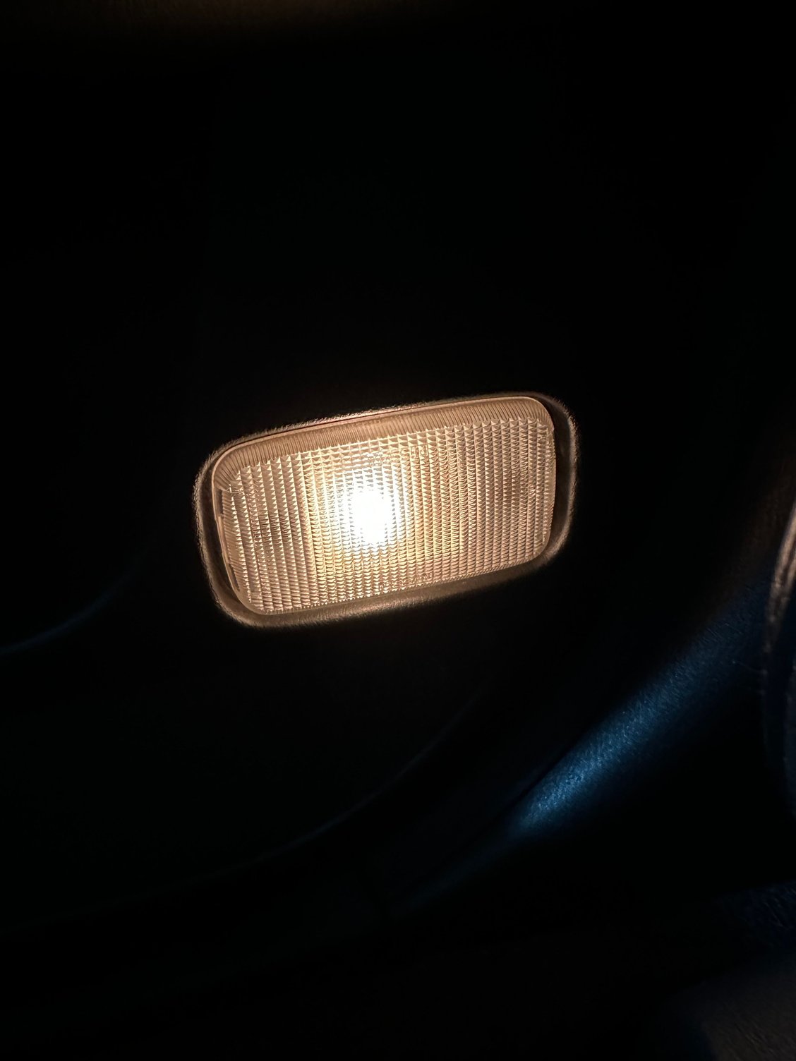

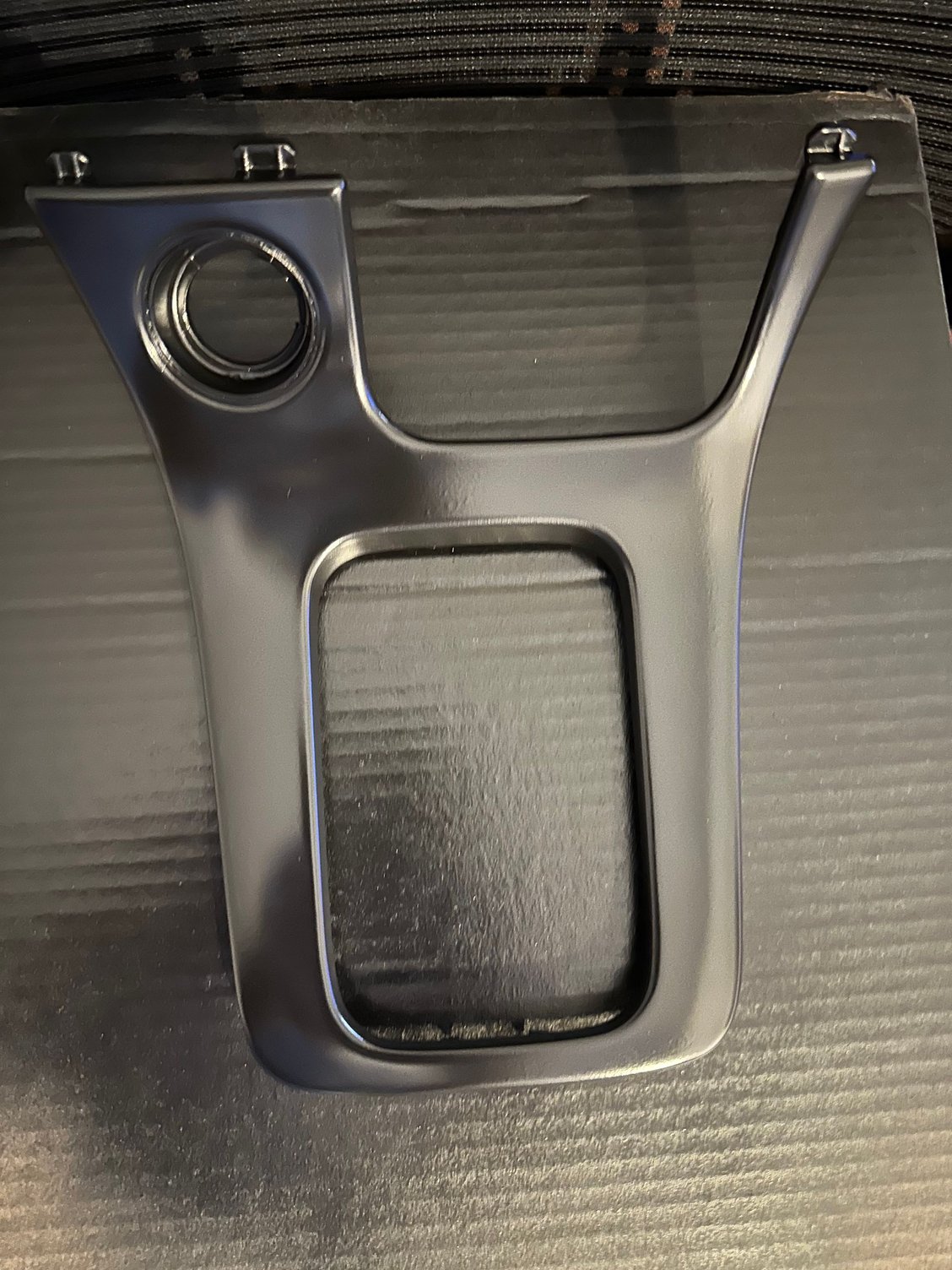

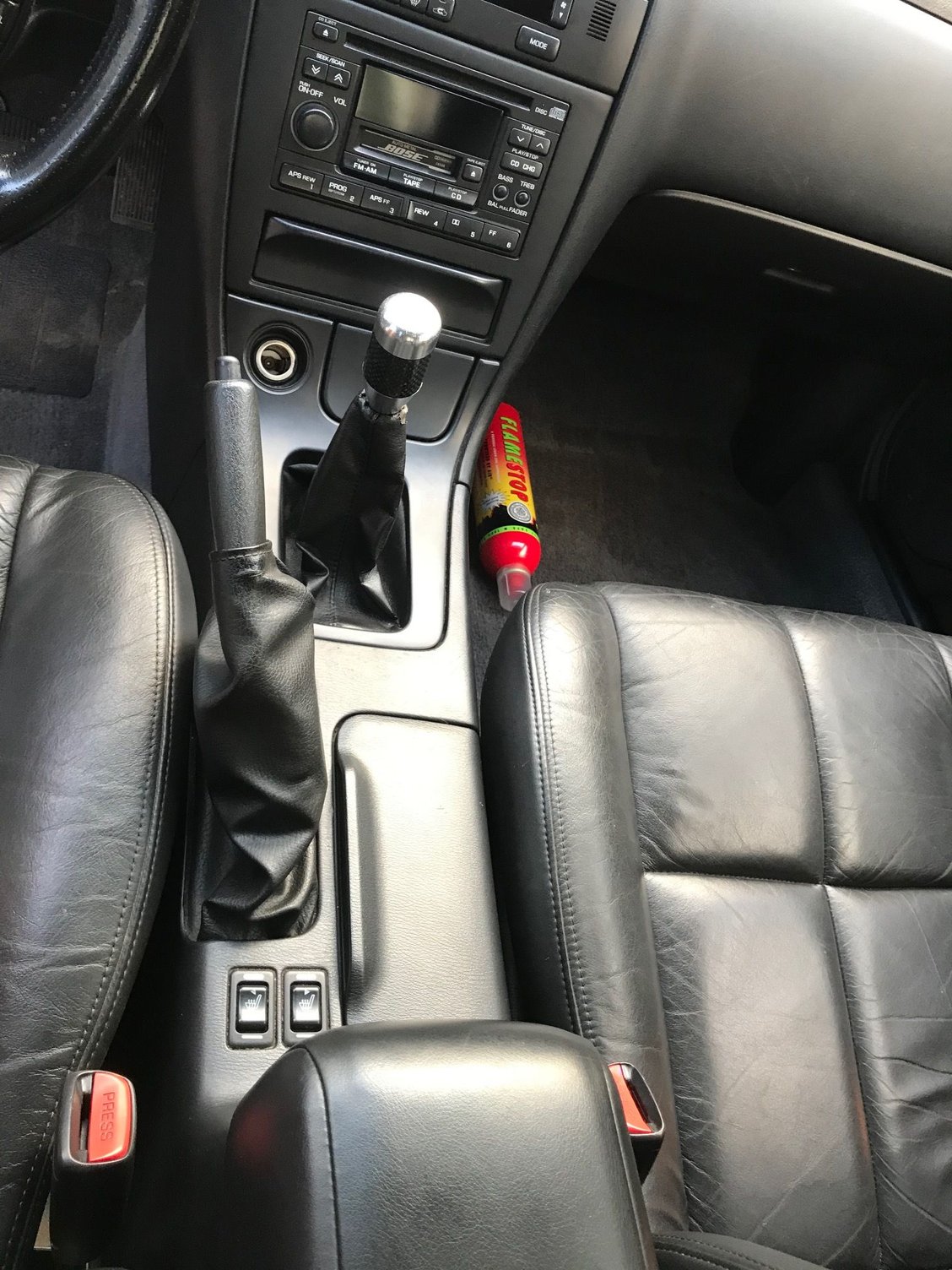

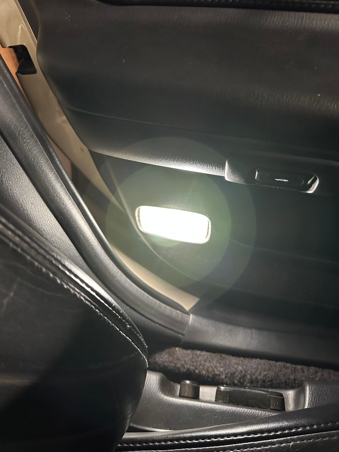

Painted the shifter trim.
Replaced all interior lights with LEDs.
Ferhan
