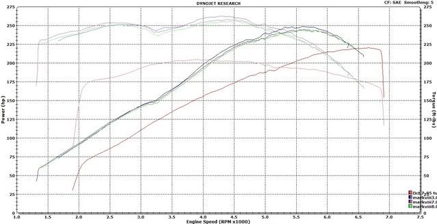

Old Feb 19, 2007 | 04:41 PM
KRRZ350's Avatar
iTrader: (29)
Joined: Oct 2005
Posts: 4,572
From: Middleboro/Carver, Ma
hey that's cool, was that your dyno chart? I'm actually building a 700hp blown mark8 motor, well '96 cobra motor, same thing except forged crank, different cams, upper-intake. That's cool though, I swear just the other day I was saying to myself "I wonder at what rpm's the additional high-rpm ports open up". looks like 3250, never thought I'd find that out on the .org........
Old Feb 19, 2007 | 04:50 PM
NmexMAX's Avatar
dot dot dot ...
Posts: 34,576
From: Santa Fe, NM
I'm kind of a dyno psychopath/junkie. I have literally hundreds of DJ runfiles.
