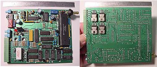

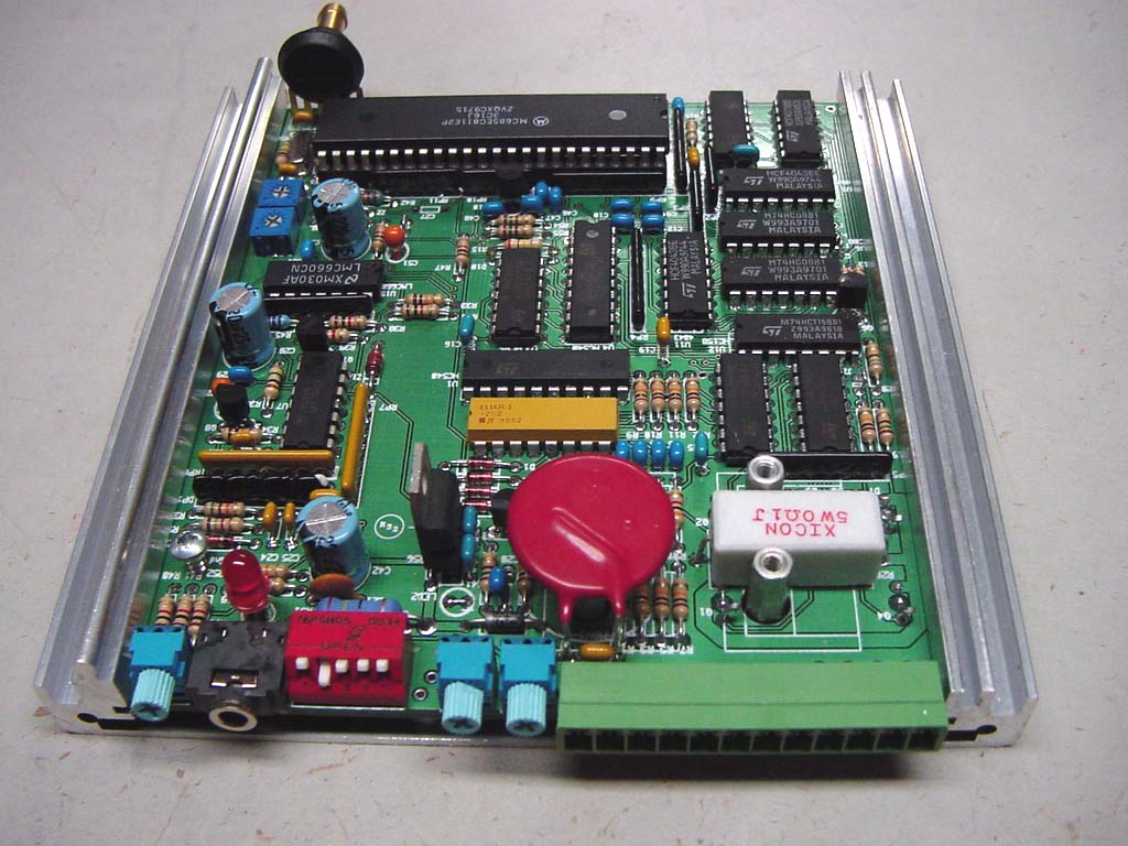

Waste spark on a six cylinder only requires three channels. There just wasn't enough room on the circuit board for six channels. All I could squeeze in was four.
The AEM standalone has five ignition channels, so it also requires waste spark operation on a six cylinder.
Photos here:
http://www.jandssafeguard.com/images/4ChProto.jpg
http://www.jandssafeguard.com/images/4coil.jpg
