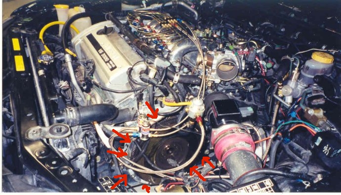

does your fuel pump turn on briefly when you turn the key to the ON position? have you recently removed your transmission? if so, check to make sure the mating surface between the tranny and engine is clean, as it grounds the starter.

Sx: Yes, the fuel pump (stock and auxiliary) turns on. You know what, I did have my transmission bullet proofed and 'VBed', etc. shortly before all this. So where exactly do I need to look to see if the mating surface is clean?
mating surface would be where the bell housing of the tranny bolts up to the engine. see pic below:
