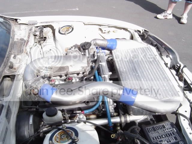

Just for interests sake a VQ30DET in a S14 Nissan Silivia .. guy in local club is building
