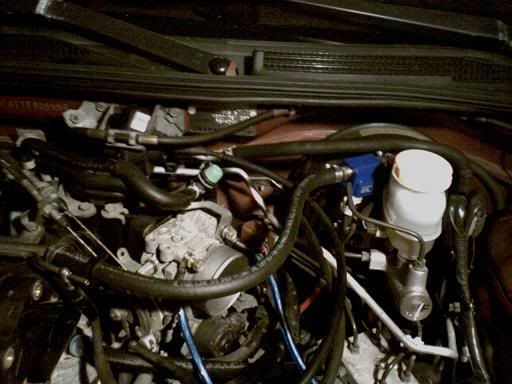

In the past couple of weeks I've removed the SRI (WAI), Removed the battery and tray, changed the platinum plugs to NGK 1 step colder (Gapped to 0.037") plugs, installed a B&M Supercooler Transmission cooler "stand-alone" from the stock radiator cooler, and began sourcing all of the little things for the build.
In the next week or two, I will be replacing the horribly aged PCV valve with a new one, along with a Home Depot (Canadian Tire) Blowby catch can, I will be installing a WOT Drop Resistor Mod, replacing the in-tank fuel filter (Strainer), then beginning the build.

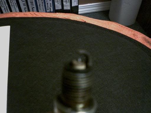

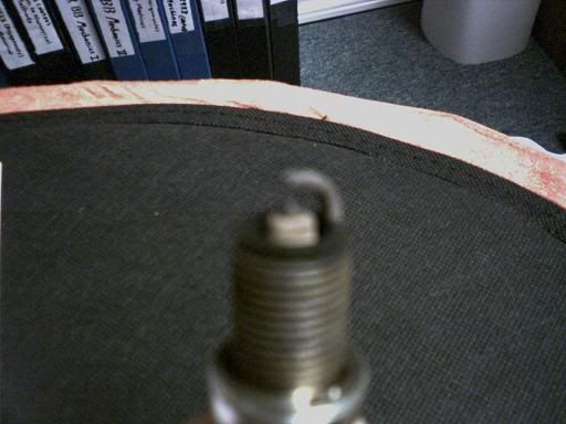

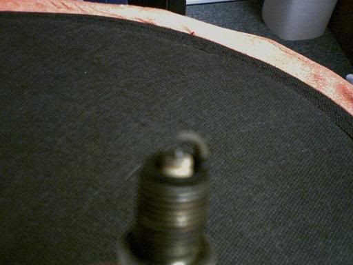

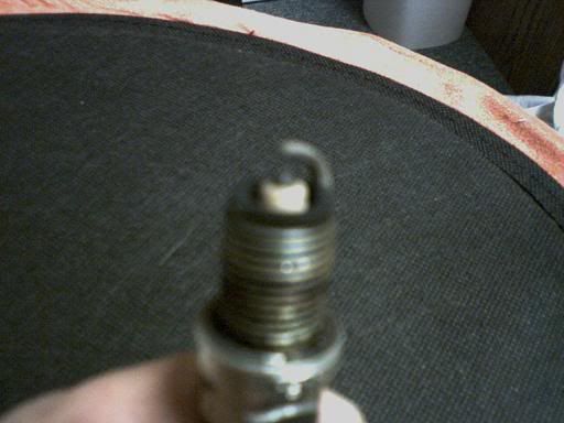

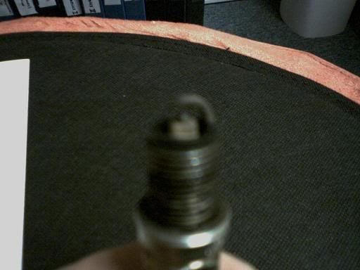

I removed my stock (Platinum) plugs this weekend. Getting at the rear coils is a PITA as advertised, but with the right tools & some finesse, it's not really all that bad. A little history of what these plugs have been through.
They've been in the car for ~95K km (~60K miles), and I would imagine that they have been subjected to 87 Octane for the majority of their life. I wasn't told what the original owner ran for octane, but the used car dealer made no mention of running premium gasoline when I bought it, so I assume that it had never seen the correct octane.
I actually unknowingly ran 87 for a few months when I bought the car, before I began reading up on things on this forum and Nicoclub (The original forum that I had been a part of last summer). Last July-August I ran a can of seafoam through the IM and dumped a can into the gas tank (I had fantastic mileage while the can was in the tank, probably due to the increased octane maybe?) then switched to Premium (Which is 91 from Esso here in Newfoundland).
Just to note, my mileage was typically around 16MPG city driving, and was about 20MPG with the Seafoam in the tank. I've been running Premium ever since.

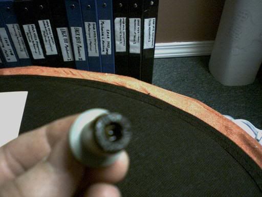

The spark plugs looked good when I removed them, and all 6 looked very similar in appearance. I have some pictures below, but they aren't the best quality, so I would say that it is closest to #16 on this webpage:
http://www.dansmc.com/Spark_Plugs/Sp...s_catalog.html
The plug has black (carbon) deposits on the threaded area (the shell), and the extended metal part that makes the spark with the electrode appears to be slightly brown. The electrode looks excellent, and there is a bit of browning on the white (insulator) part of the electrode.
Judging by the images on the above website, the plug is in the "best" range, so I am very happy with it.
Here are pictures of plugs 1-6 (Identified by firing order):
Plug 1
Plug 2
Plug 3
Plug 1
Plug 2
Plug 3
Plug 4

Plug 5
Plug 6
They all look fantastic......:_)

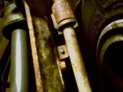

Next I removed my PCV valve to install the Home Depot (Canadian Tire) Blow-by catch can. This is how it looked (Horrible):
Note: It did not "click" at all when shaken, and appeared to be completely blocked.
Notice the discoloration where the valve was inserted into the engine, obviously from all of the oil blow-by.
Plug 6

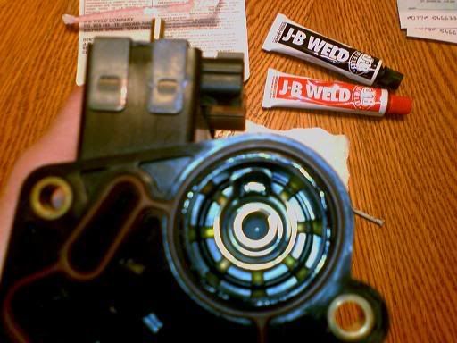

I know that a lot of guys have had trouble sourcing "micro-switches" for the WOT Drop Resistor Mod. I personally went to "The Source" (Formerly Radio Shack) to look for one. All I found was 5A switches that were apparently melting in service.
I went to a generic "Electronics parts store" and found a 15A-125/250V AC micro-switch that has NC, NO, and Common connectors. The Drop Resistor Mod requires that the Common and NC connectors are connected, effectively breaking the circuit when at WOT.

Some More Progress......
So I got a few hours out at the parents house (Where the car is being stored - an hour out of town) tonight, so I figured that I would continue with some of the prep/maintenance.
First of all I replaced the (Seized Solid) PCV valve with a new one, and installed a "Home Depot" (Canadian Tire) Ghetto Catch Can while I was at it.
I ran the lines down under the TB and under the Brake Booster, then back up to the catch can, then back to the IM. Made for a real clean install with all of the lines tucked away, and the catch can back behind everything.
Here is a picture of it installed:
While I had some time, I figured that I would dig into the VIAS actuator assembly and check to see if I needed the "VIAS Fix". I took everything apart, and it turns out that my VIAS was fine (~96K km). I filled the bottom of the cup with JB Weld and stuck the spring back in as a preventative measure, so that my chances of running into the problem in the future would be that much lower.
For those of you that are interested, there is a "key" in the bottom of the cup that tends to wear away at the key-hole in the bottom of the cup over time, and the VIAS assembly either stops working completely, or only opens part of the way due to the "free play" between the cup and the shaft (key).
The VIAS Fix is on VQPower.com, and is well documented on this site. The pictures below show the orientation of the cup in the "Closed Position", and the Actuator assembly that can be used to test the play in the cup.
The slot in the cup that the plastic VIAS shaft sits into should face almost straight up in the first picture here (As you can see), this is the closed position.
The second picture shows the linkage that can be rotated to test the free play of the cup with respect to the key. This linkage is attached to the key, and if you rotate it, the cup should rotate with it as well with No Free Play
I hope that this helps a few of you guys, and I'd be glad to answer any additional questions.

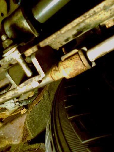

Just an update on the RSB issue.
I was determined to get it installed before I left there today, so I decided to unbolt the brake lines from the rear trailing arms and install the brackets anyway. I had planned to re-connect the brake lines after, but I didn't have anything with me to make brackets from, and the zip-ties that I had were shattering due to the cold. And because they were crappy zip-ties.
So the brake lines are now about an inch closer to the rear tires, which isn't that bad for now, but I was beginning to think that it could cause problems down the road if I were to go with wider tires on the rear.
All in all, it was a pretty clean install in the end. In addition to unbolting the brake lines, there was a sensor wire that ran along there as well. I had to remove the wire from its grommet, but was able to re-insert it after I was done tightening up the RSB brackets.
Here are some pics of the final install:
On the top of this picture you see the RSB bushing and the end of the RSB (Grey/brass). In the middle you can see the rear trailing arm, with the other side of the RSB bracket bolted around it (as well as the bolt). You can then see the brake line, and my back tire. Originally the brake line was bolted directly to the trailing arm, and well away from the tire, but now it sits considerably closer. I guess that I can't do anything about that for now.
Here is the setup from a different angle. Again, notice the offset of the brake line.
And finally, the RSB bracket from the outside with the brake line and sensor wire bending around it. Looks clean from this angle....

There are many mixed opinions about the spark plugs, and I can only tell you to do a search about them on the forum here. There are a lot of threads on the subject, and I actually took a full day one weekend to read up on the subject. Another important part about spark plugs are the gaps. Again, there are a lot of opinions and threads about this, so read up......It's good to know as much as you an about this stuff.
I ended up going with one-step colder copper plugs gapped to 0.037". I had to replace my stockers anyway, and I'm going to be running ~10 lbs of boost or more, so I judged accordingly. My only other real piece of advise besides reading as much as you can about the plugs, is to stick with the NGK plugs. Our engines were designed to use NGK plugs, and you should stick with them. They are good quality plugs. Note: You'll find a lot of threads about these as well.
I'll definitely be happy to answer any questions that you may have about the plugs after you do a little research, but to get into that right now would make for a long night.
