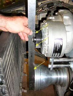

jordan, If you use a plumb bob dropped from the SC pulley, how far off is it from the other pulleys?

The spacers go between the SC pulley and it's driveshaft. How many get used depends how far out of alignment your pulley is w/respect to the other pullies. A plumb bob/straight edge is needed to check alignment. See pics.

When I first put on my kit, I shredded about 4 belts. Since using the spacers I have shredded no belts in 85,000 km of driving hard. (Broke lots of other stuff, tho!) Clearly there is a design flaw with the V2 plate, since this problem is so common. 2 spacers between the SC and pulley works for me.

There is an art to it Qnz! And I don't know that I can even put it into words. I'll try: You wrap the belt around the pulley, make it double back onto itself, wrap it around the blower/plate legs, lock it in place by looping the last bit of belt around the blower/plate or something else and go to town with an allen wrench. Hopefully the pulley won't spin any more. If that fails, repeat confusing step #1. lol

Ptatohed, did either one of us take pics of what you described when I dropped down to a 2.62 pulley or when you dropped down to a 2.87 pulley?
I think so. I think with your camera. Your old silver camera.

I looked at it again today and found nothing wrong except the belt had jumped across on the pulleys. I loosened the tensioner and realigned the belt.
After this I made sure everything was in line. It was. There is however something I have noticed. The belt seems to be tighter on one side than the other - however the tensioner seems to be square - wtf????? Has anyone come across this before?
Old Mar 13, 2008 | 05:27 PM
Not following you. What do you mean by "square"? Got a pic?
Take a pic of your tensioner assembly on and off the car. Maybe we'll spot something.

I think I know what you are talking about. Like maybe when you tighten your belt too much, one or more of the pulleys gets the "diving board" effect and is angled instead of straight off the car, right?
But it sounds like you are doing your belt tension correctly.
Did you say you dropped a plum bob from your SC pulley outer face plane to the floor? Are all pulley faces on the same plane?
Could it be the belt you are using? What brand is it?
Take a pic. of your adjuster pulley assembly like Wizzy said.

Wizard: What I mean by "square" is - everything is lined up and the pulley seems to be flat and not on an angle.

ok... funnily enough - everything seems to be lining up right. Checked it. The only thing that is a little off is the pulley on the charger. But i'm only talking like 1 - 2 mm of difference and the tensioner pulley is wide enough that it seems to route it ok. Eveything else underneath is lined up perfectly as well.
Could the plate be flexing under high boost? Remember, I've bolted the plate on with no stand-off bolts. My kit was second hand and didnt have any stand off bolts. The guy forgot to include them I think. Tried to find a replacement item and I was unsuccessful. It is a very specialist bolt.
Looks like I'll be going with a V1 conversion plate to be perfectly honest. I want a car thats reliable lol.
