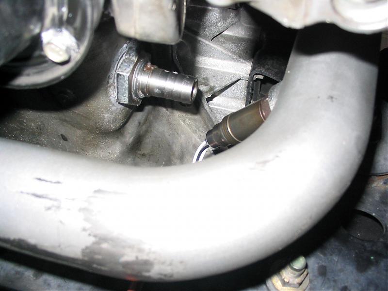

Attached is a thumbnail of the return line on my POS.
