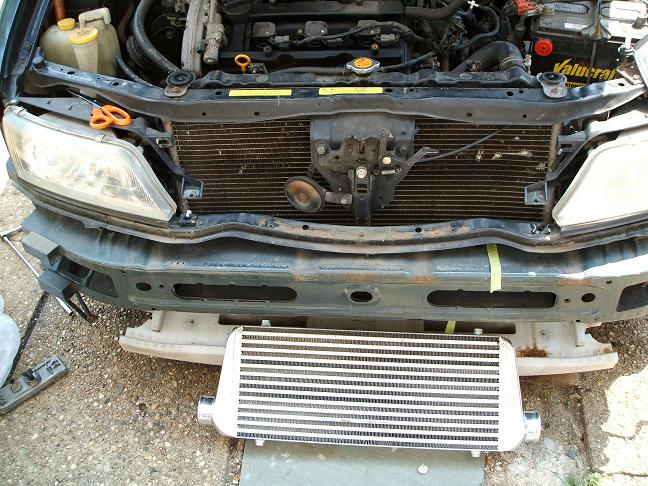

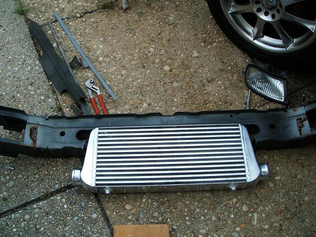

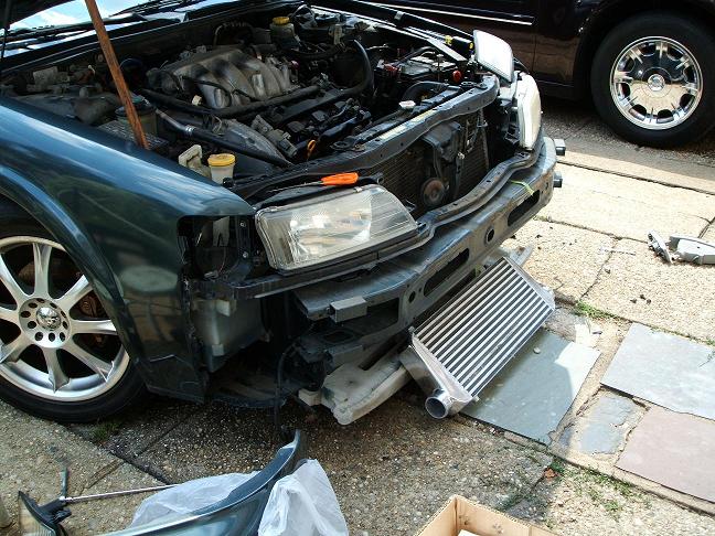

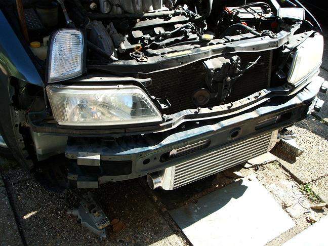

I finally decided to go turbo so here are few picture of my progress so far, I just install the IC and finished running pipes from the IC, just about to relocate the battery. Once that's done I'm going to start on feed pipe fabrication.

Originally Posted by maxgtr2000
Looking good, are you going to be using upgraded injectors? Check out my setup in my sig. You doing front feed or u turn feed pipe?
Well temporary Is going to be using stock 3.5 injectors, I'm doing the front feed similar to your set up.
Originally Posted by 95BLKMAX
did you dyno that 3.5 while all-motor to see how its working out so far before sticking the turbo on it? What turbo are you going to run and how high is your realistic power goal? List more of what your setup is going to be meng! lol
Looking good so far though!
Actually no I didn't dyno all motor, but another 3.5 that I did the person dyno it, his results where about 205 hp and 200 tq, Im expecting my car to be somewhere around there.
Im runing a T3/T4 60 trim turbo for now.
My realistic power goals are 300-320 hp, If ill get that Ill be happy.
as far as the rest of the setup
Tial 38mm wastegate, TurboXS BOV, Walbro 225 fuel pump, Inovative LC-1 Wideband, EB, Q45 Maf. Im probably forgetting something
