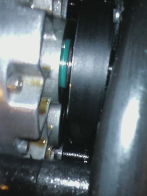

well, i got it all together today. install time was 6 hours. Im using a V2 kit. Install went very smooth. Hardest part was putting the alternator bolt in honestly. I have no belt clearance issues, everything lines up pretty good actually, no washers or spacers needed. The idler pulley is really close, but it seems to be fine. The captive bolts have me slightly worried tho. At first, the pulley was quite a bit aways from them, close but still enough space. Now after a few test drives, it seems something has shifted slightly, and the pulley is rubbing the bolts. I think its already grinded them down enough so maybe itll be ok, im just wondering what happened to my space that i had?
im not tuned yet. im running the 3.6 pulley, stock fuel. But so far the stock tune is actually not bad, its runs under 12s, until about after 6k when it reaches 7-8 psi it leans out to a little over 13, so ill tune tomorrow. and ironically enough, after all my NA days trying to get the thing to run at 14.7-15 while cruising and idling, it finally does that now on its own lol. It feels awesome tho. And this is only 7psi?? im quite scared of the 13 psi pulley i have!
few questions/comments/observations, this thing is LOUD. Im talking, i think im glad i didnt get a V1 afterall. i was thinking i can keep this sc on the hush around school, but thats not possible. i thought maybe something was wrong, but i looked up some videos on youtube, and it seems as loud as those so i guess im ok. I dont have a filter on the sc yet, so i need to figure that out asap. I need to figure out what to do with the ps lines now that its probably too damn late, lol. I have a little ps leak from the reservoir so i gotta do something there. and one last thing, i have a Blitz DD Bov, i cant quite get it to vent at idle. I did get it to vent at one point, and it worked for a bit, but it seems sporadic. sometimes itll vent sometimes it wont. all im doing is turning the screw on the top right?
But all in all, im excited as heck. it feels great to me. thanks to all who have helped me, huge thanks to potatohead/wizard for the writeup, thanks to my boys here who stood by and helped.

When you adjust the Blitz, you loosen the nut and back the threaded post out. Tighten the nut at your prefered placement to hold the threaded posts in place. Also, check your vac source, it could be playing a part in your issue as well.
Are you running the the OEM ecu? If so, be carefull, fuel may be somehwhat ok but timing will be an issue.
Also, how many miles are on your blower? Just curious as to why its so loud, or maybe its not really that loud but just loud to you since its not a sound your used to.
i can pull the threaded post all the way out and it still wont vent. its weird cuz it did for a little while yesterday. can the spring be too stiff? dont know if ur familiar with the dek manifold, but my vacuum source is off the nipple on top of the throttle body.
i am running the stock ecu. ill look into what i need to do with timing when i tune.
and supposedly the blower was rebuilt by the guy who sold it to me. and ur right, maybe it isnt louder than normal, but just to me. everyone so far has said it sounds like a normal supercharger.
Sounds like the vac source is fine, however your BOV may be toast. Someone may have tightned it down to much at one time and ruined it.

through some searching i found that a few have had this issue with the blitz, ewuzh had the idea of getting a softer spring from somewhere and he said it worked fine. so i went to ace hardware and found a spring today, i put it in and it vents at idle now. and it seems to be working fine. it still builds max boost so im assuming no boost leak. so hopefully that takes care of that one.
next, i understand the rules for adjusting timing on an N/A vehicle, basically not too much unless youre on a dyno to actually see whats happening. is there a rule of thumb here now that im SC as far as retarding goes? should i just retard a few degrees across the board? or at a certain rpm? etc, help on this would be awesome.

well, it is with deep regret that i post this picture, my first of the blower.
i was tuning tonight, and everything went well. when i got back home, i popped the hood to check everything over, and there was oil EVERWHERE! i mean, theres oil from the timing cover on over to the passenger fender everywhere. Theres oil on my trunk lid!! is that a seal behind the pulley, the teal colored thing? could it be the source of the oil explosion? its the only thing i found that was different. everything else seemed ok. i spent the last 3 hours pulling everything apart and for now im back to NA. what the heck is going on here?

fuxxxxx dude. the night i hit my 1st 130mph run your s/c breaks. speechless right now going to be pissed when i sober up

Check the drain back pipe. If oil leaks from there it could well end up on the belt and be sprayed everywhere

So you did check your drain/feed lines before removing everything, right? If one of those came loose it could have easily caused all that without being a hard fix.
Otherwise, you can get rebuild kits for pretty cheap, or maybe even buy the specific seal that failed.
I would have definitely topped off the oil then started the car to try and find the leak before taking everything off, though!!!
