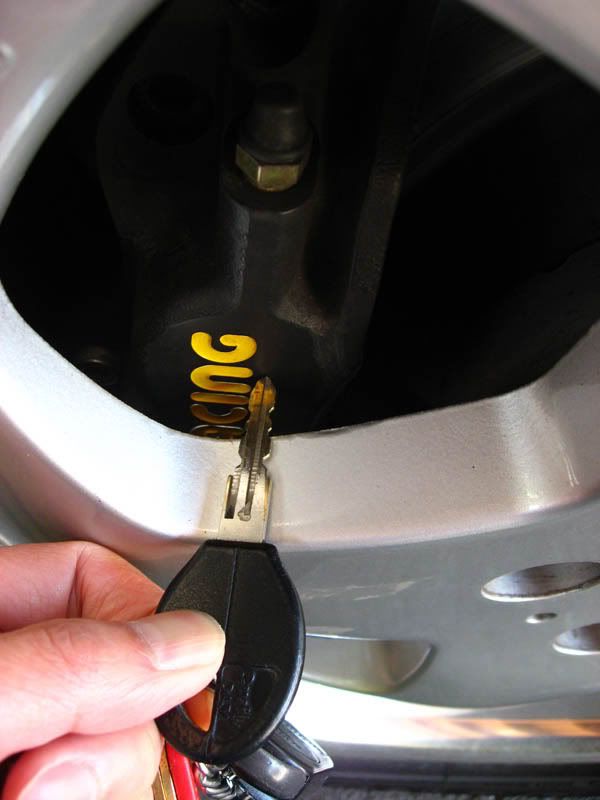

Those will clear an AP kit... I have the 18X8 (superleggeras) with 35ET... but there is alot of space for a 40ET... unless they changed it a LOT with the Ultraleggeras... BTW 40ET will have less space for the brakes (as does going down to 17") so i'm confused with TireRacks response.
old pic:
newer with AP:

I would show you a pic of the clearance but those are now on my 07 Camry Hybrid... but here is a pic of how much clearance with my LOWENHARTS.
