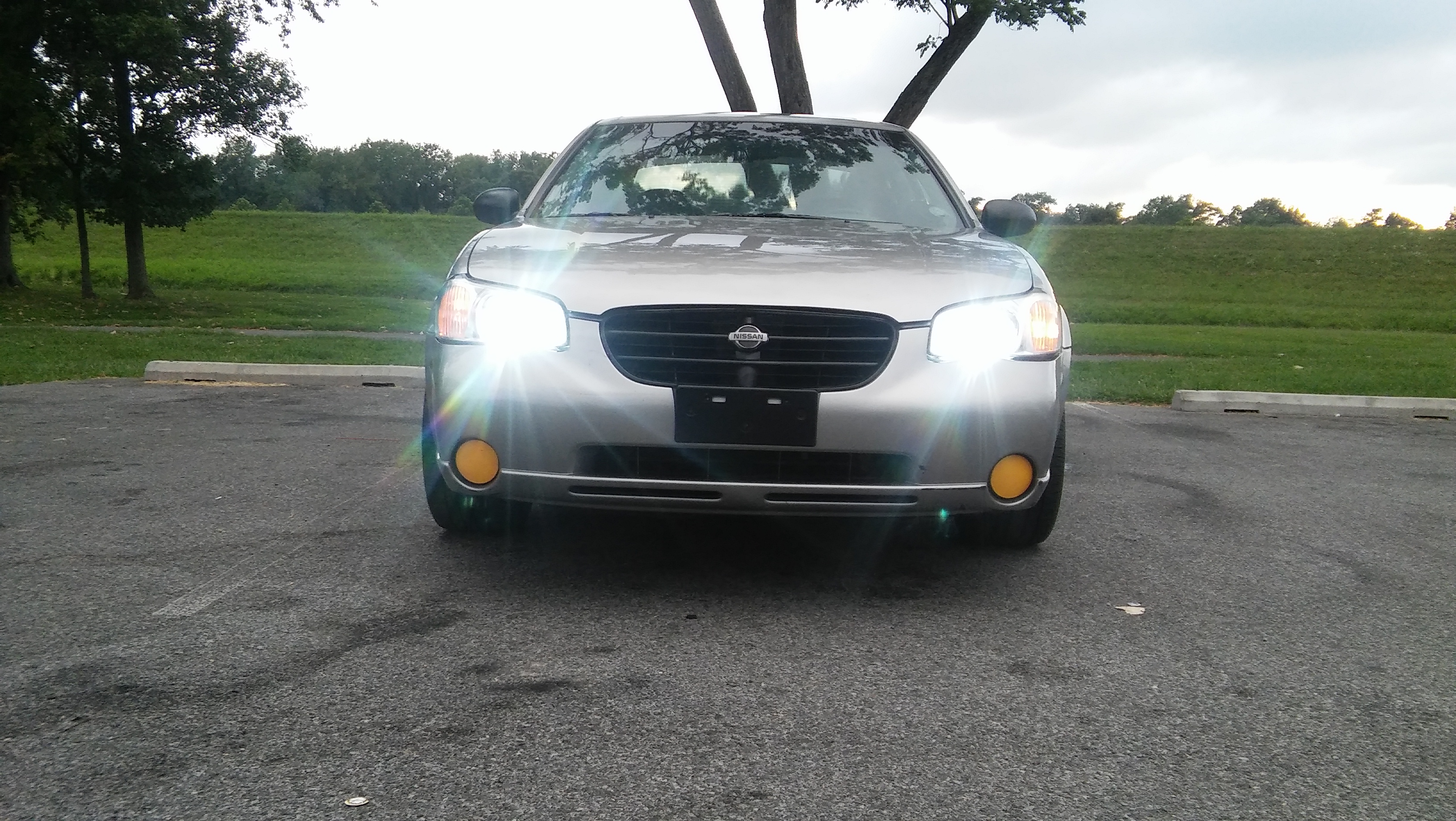

Enjoyed the new look
Please forgive the dirty car that has been in the garage for two months now.
Attached Thumbnails 5th Gen: What did you do to your 5th Gen today?-image.jpeg
