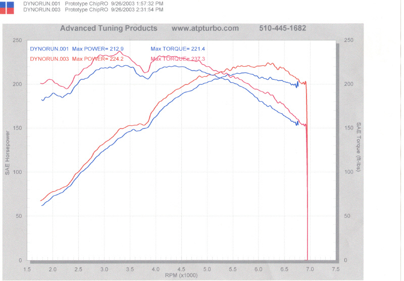

well possibly. The 3.5, from the dyno's I've seen, keeps hp close to peak up to redline, so I feel its better to let the engine rev all the way, then drop it into 3rd, where you'll land somewhere around 4000-4500 RPM, at which HP is lower than at redline. Also, letting the car get all the way to redline gets you a few MPH faster, so when you do drop into 3rd, the RPMs are higher so more HP is bein made. Here's a dyno to examine yourselfs. Looks like gettin up to redline is good right?
Note: the red curve is after Technosquare ECU flash, thats why the HP curve continues past 6600 RPM or so. The blue is for a Maxima wiht intake and exhaust, so it probly breaths a little better up top than a completely stock Maxima
