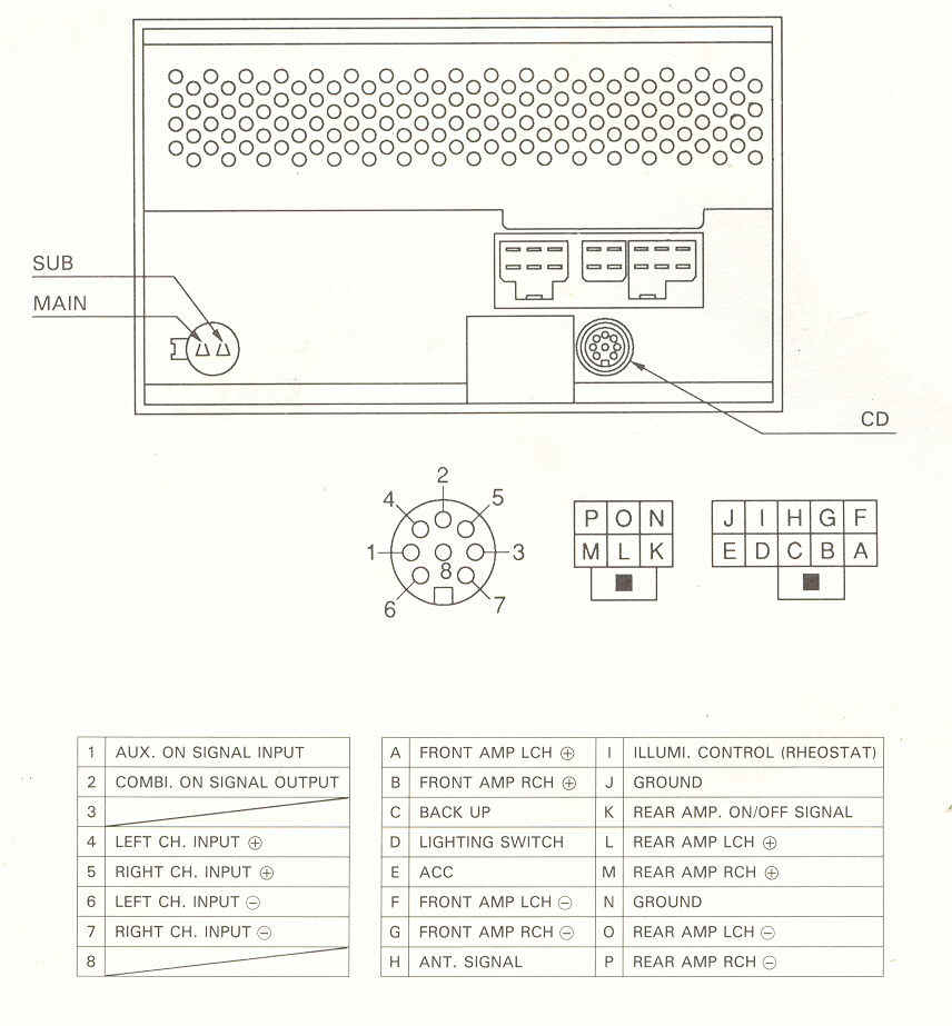

Ok so the previous owner cut all the plugs that would plug into the stock stereo. Now I have a bundle of randomly colored wires and I need to figure out how to hook up my cd player. Anyone know what those crazy colors mean?

Found this http://www.carstereohelp.net/images/...sNis121002.jpg
Just for future reference. I couldn't manage to find the wire that give 12 volts + only when the car is on so I spliced it from the cigarette lighter. It's good to have music.
