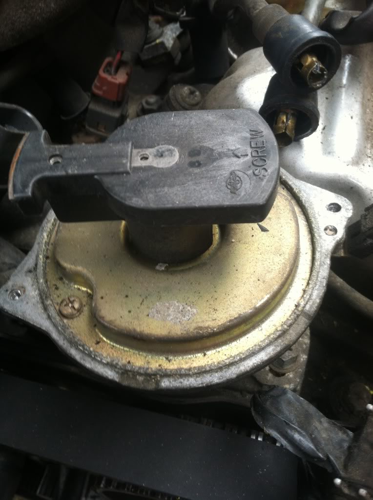

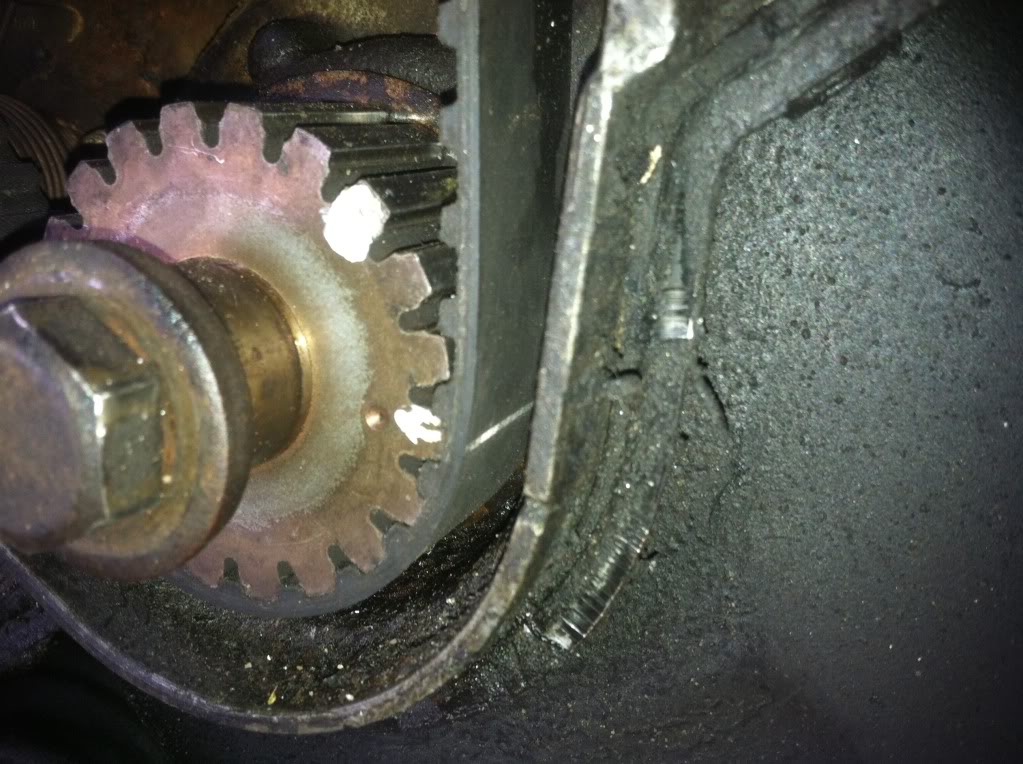

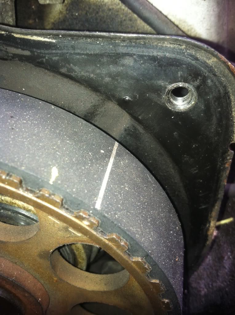

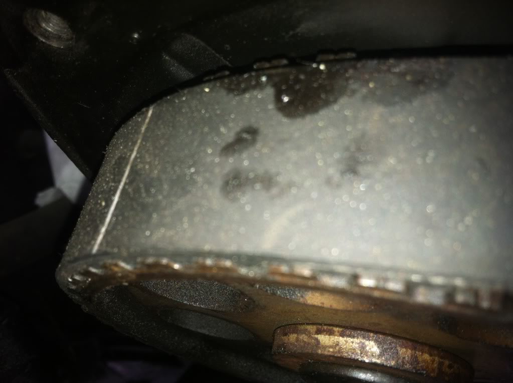

Okay, I reset to tdc pulled everything apart again, reset the timing and put the belt back on. Before I put everything back together I want to get your opinion to see if everything looks kosher.

Old Apr 19, 2012 | 02:09 PM
vernk's Avatar
Joined: Apr 2007
Posts: 1,323
From: Albuquerque, NM
yep that looks good, the sensor is the head temp sensor
