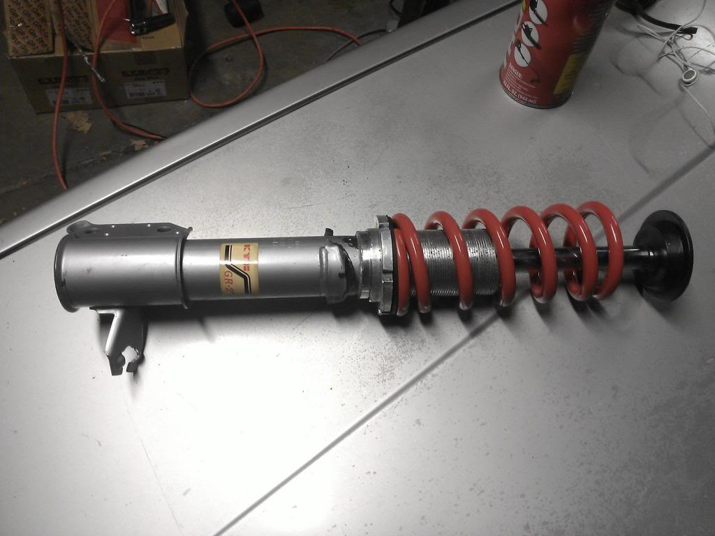

That's a lot of grinding... Is it really necessary to grind that much?

are you using the stock strut assembly that came in your car?

It's a KYB GR-2. Stock replacement.

I'm not sure about the grinding that needs to be done. I have mr2 front and rear strut cartridges in my stock housings and all I had to grind off was the spring perch and the cap that holds the strut in.

Yeah, I ground of the spring perch on mine but it still won't fit. I'm going to try heating the coil sleeves to about 250deg F and then see if the expansion will allow it to fit over the strut housing.

Finally made some progress with it.

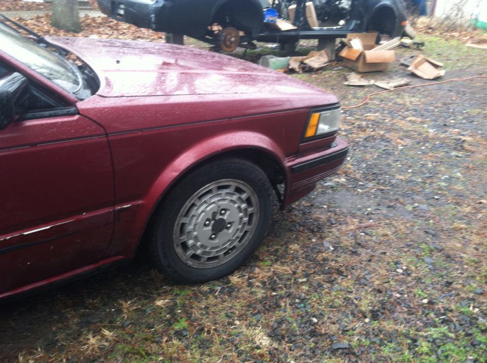

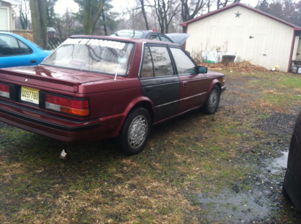

Haha that's what I got. I got the sleeves on and it doesn't lower it as much as you would think. It's kinda upsetting. It may lower it like an inch.

Post some pictures. From what I've measured it should drop it at least 2 inches. Probably close to 3. If it doesn't drop it as much as I want I'll just cut a coil or 2 off the sleeve spring.

lowered in the front only.

yeah, that's lower but it still needs more low. I'll put mine on as soon as it warms up. I've decided if I can't get enough low out of it, I'll cut the thread off and build a custom perch lower then the stock and just rock the spring from the coil sleeve kit. That should get me the low I need.
