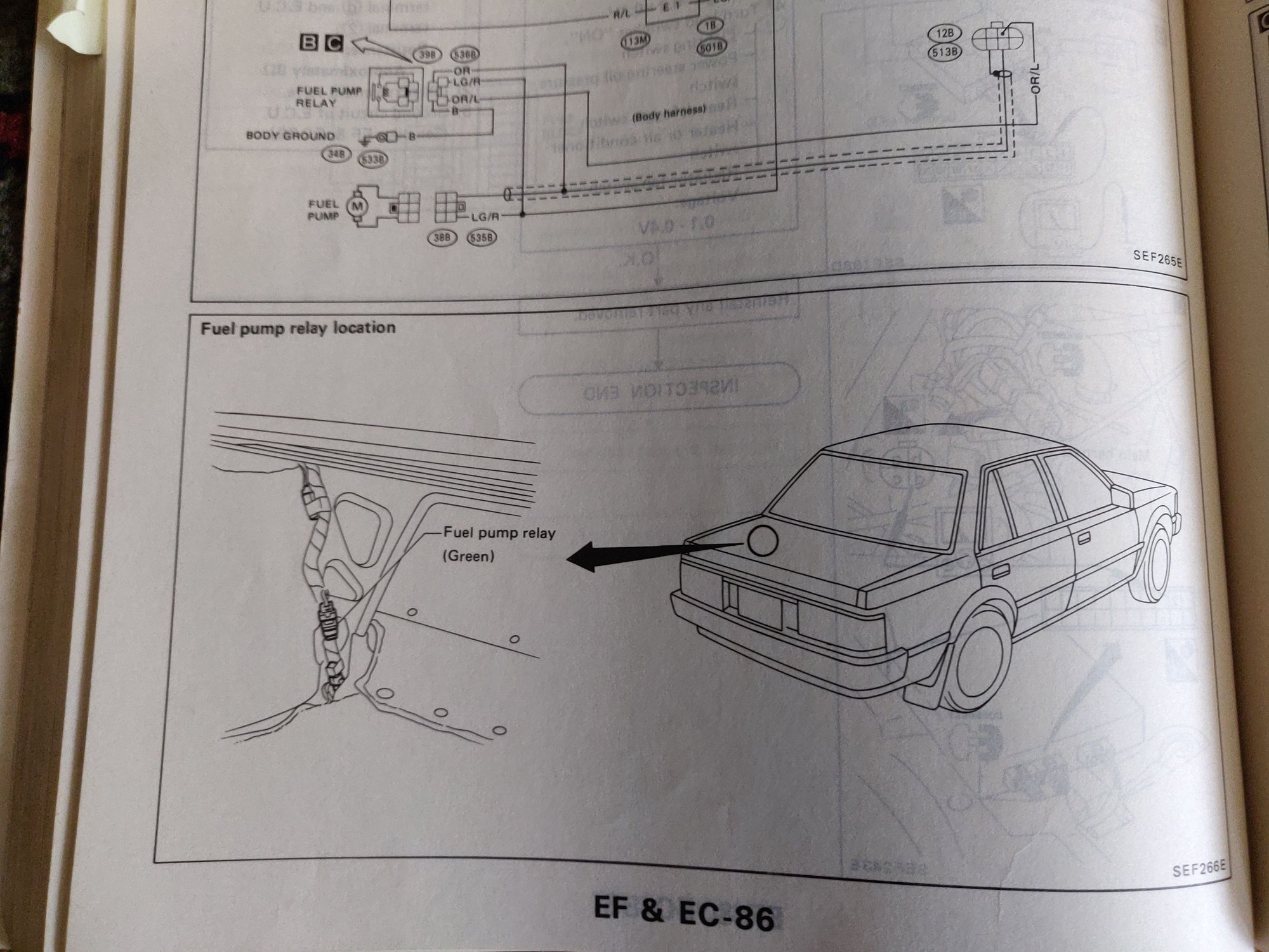

I’ve been researching for a couple days to find the location and different sites have a different location from being in the trunk, in the b pillar?, and by a driver kick panel. Is any of those the right and if not does anyone have a diagram or pic of it?

This help?

thank you so much after hours of looking and taking the back seats out I found.
