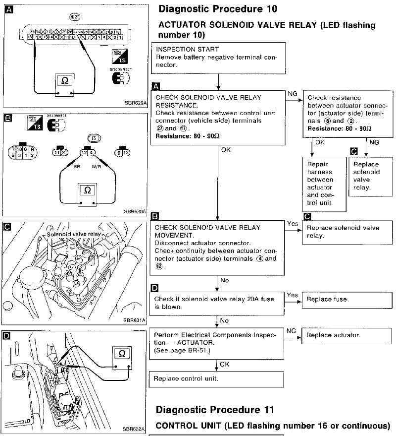

Does anyone have any experience with ABS codes? My ABS light is on, and I checked the codes on the control unit, it's coming up with code 10: ABS Solenoid Relay Circuit Fault. Has anyone had a similar problem, and can comment on the easiness/cost factor of fixing this?

A circuit fault could have several possible causes:
-Open/short in wiring
-Blown 20A fuse
-Bad solenoid valve relay
-Bad ABS actuator
-Bad ABS control unit
Remember, if the fuse is blown, there could be a reason, so simply replacing it may not fix the actual problem. It can blow again and again...
See this from the FSM: *LINK* Code 10 diagnosis
Good Luck!
