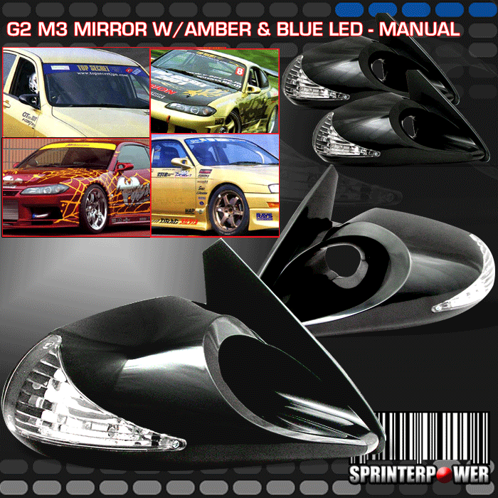

the exterior you might be able to get the grille to work and maybe the mirrors but other than that and the badging nothing else would work on the exterior

here is some pics so you cann see what i mean by the mirrors
if they do match up you know know you can do something like this. but pretty sure mirros will work don't quote me on it though!!!!
or
or
