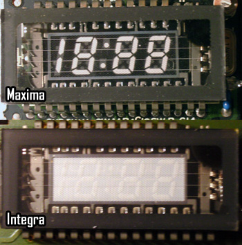

I know people occasionally wonder if it might be possible to do this, and I have as well. For a while I wanted to make the Maxima clock white to match the SE gauge cluster.
My answer has finally come, and the moment of epiphany happened when I recently rode in a 92 Integra, and saw how similar its clock was to ours, but with white digits. Same country of origin, same time period, possibly the same automotive electronic supplier. I decided it was worth the $10 gamble, and picked up a clock on eBay. The display looks identical to ours, I'm waiting until replacement capacitors arrive in the mail, and then I will transfer the Integra display to the spare Maxima clock I have. Here is a photo to hold you all over until the soldering begins:

good find. good luck on the swap, keep us posted!
edit: the q45 has a white faced analog clock built in

If you apply red tint to the display glass it will turn white, no need to swap displays.

but not as bright as he's aiming for, i'm sure.

Replacement capacitors were needed because the ones on my spare Maxima clock are busted. I got a clock from a 90 Integra, but that generation was around from 90-93, so any of those should work as long as they didnt change the clock part way through it.

well guys i just got done with the clock and it doesnt work...for me atleast maybe i did something wrong but it didnt work. I thought I did everything right but I guess not. Maybe one of you guys could get it working.
These are the pins that i had to solder

looks like you just swapped the displays...uhhhh...are you sure you didn't make any solder bridges??? did you solder it backwards??? no cold solder joints???

im pretty sure that they are all right cause my dad did most of the soldering, hes been working with electronics for most of his life so i let him to the soldering but i did the desolding

Was that clock working before? It looks different from my clock, which looks like this one:
http://www.4dsc.com/articles/interio...ages/face1.jpg
Notice there are 3 capacitors, and that long green thing which I cant recall the name of. And why do the buttons on yours look chopped off?

So... I transfered the display tonight, and it "works" fine. maxima_man, I think your dad probably did a good enough job, but you just had a bad clock to begin with, since it is missing parts.
The interesting thing is this: it is still GREEN. The exact same color as the oem clock. It must be the plastic in front of it which entirely determines the color.

kinda like in the integra, it is actually red....right? if it's the plastic outer screen, just replace it with a small rectangle of clear or clear black plastic maybe? I was 'hawking' this to see how it would turn out....also, upon taking apart the clock itself, did anyone ever happen to notice what color the clear plastic was, that the clock shows through?

I threw mine away too early, so I never looked at the color. You cant really reaplace the viewer part without making it look like crap, because its all one piece that snaps in and has the holes for buttons.

the plastic is a dark grey color. The whole thing is actually almost see-through if you take off the front cover. Be carefull though, I've broken 3 clocks trying to snap off the face to change the color. It'll crack before you know it, with hardly any pressure at all.
