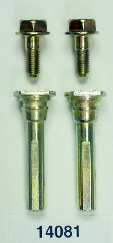

if it doesn't move then take the caliper off and lube up the slides. you may have to clean up the slides too. being in chicago they pit and rust.
