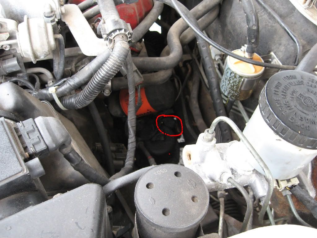

thank you for posting this!!! I have the same prob with my speedometer as well, i had a feeling it was the speed sensor. Exactly where is the speed sensor located and is it hard to get to ?
it's DIRECTLY under the S in "Sensor". when the tranny is installed, it's kinda near the oil filter but a few inches closer to you if you are leaning over the d-side of the car. manual model has it in similar location.

So I've been driving my car around with no speedometer for like a month now. I looked at this picture: http://i164.photobucket.com/albums/u...r/IMG_0013.jpg and there are two wires coming from the black thing, one is loose, one is attached to it. I'm not so sure what I'm supposed to do, the loose wire ran to this sensor looking thing, and everything was plugged in, the other part I dont know where because I would have to get under the car.
Can anyone tell me specifically, what I should be looking for??
