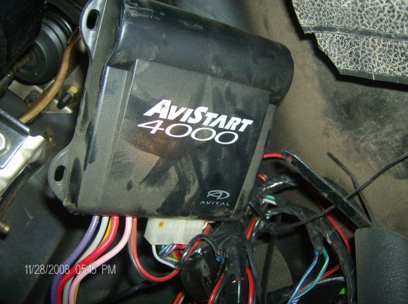

Looking at that pic it must be up under the dash to the right (from seat) of the steering wheel??? Does the dash have to come apart to get to it?
While trying to preztel myself in there to have a look, I find this...
No remotes tho..
on edit: Nevermind.. I've got it out..

You do realize that is not the factory door lock timer?

Hahahaha.. yea... That's aftermarket... I saw the sticker reminding mechanics of the remote start on the radiator support. Just thought it was taken out since remotes didn't come with the car.
